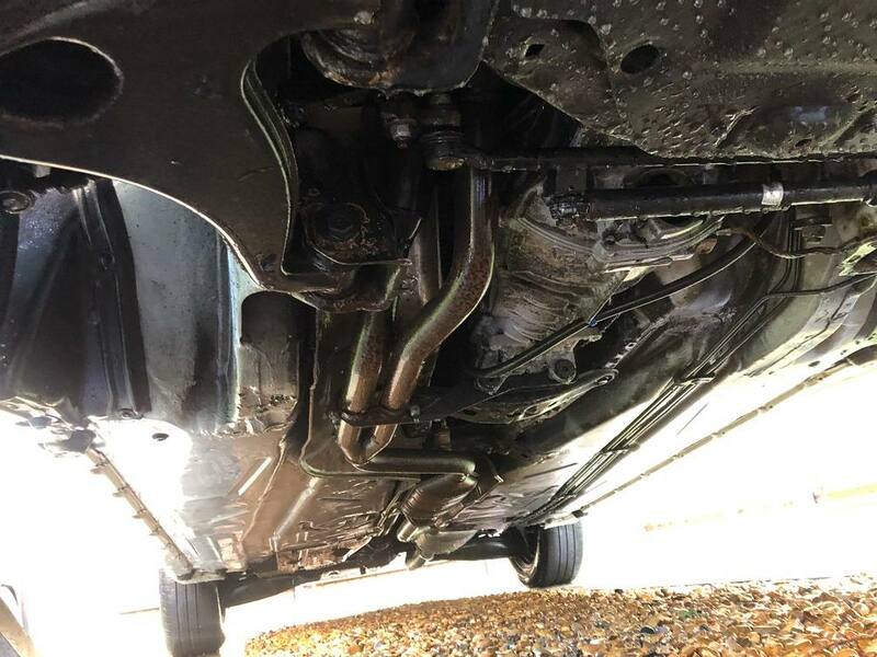

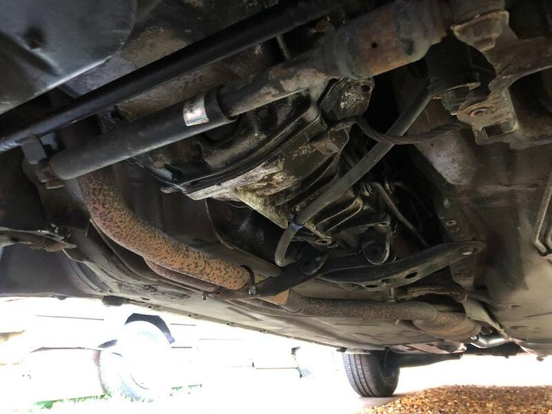

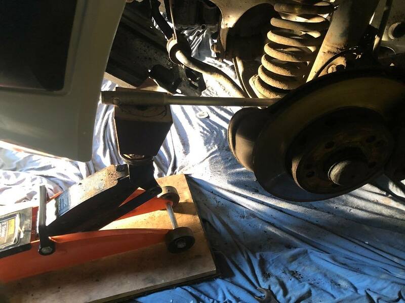

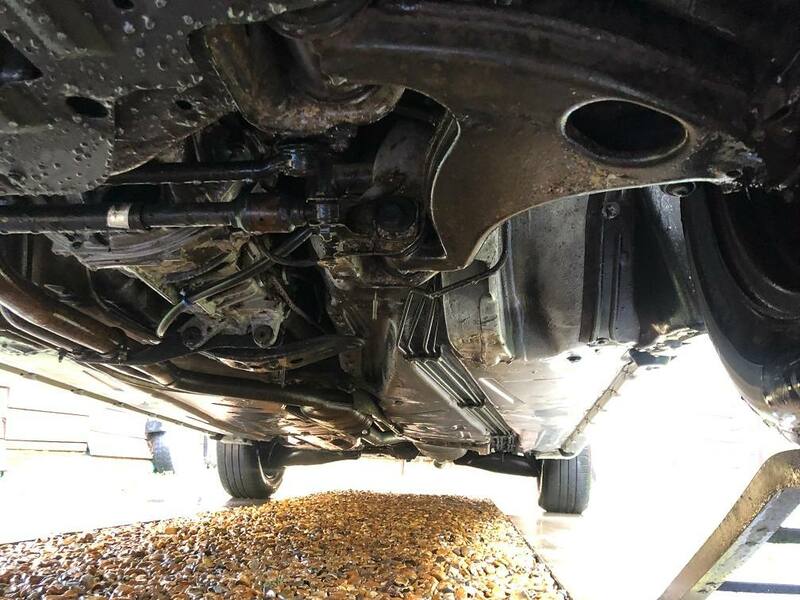

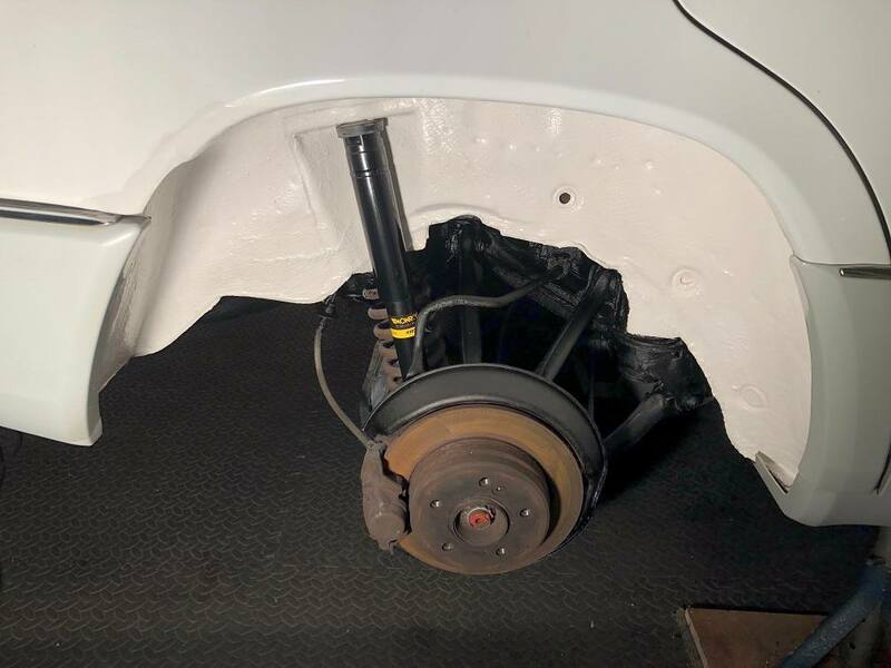

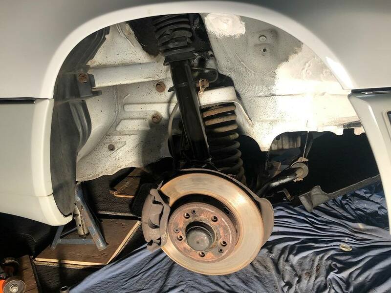

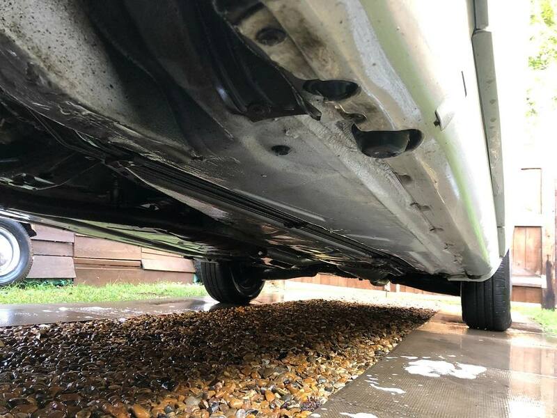

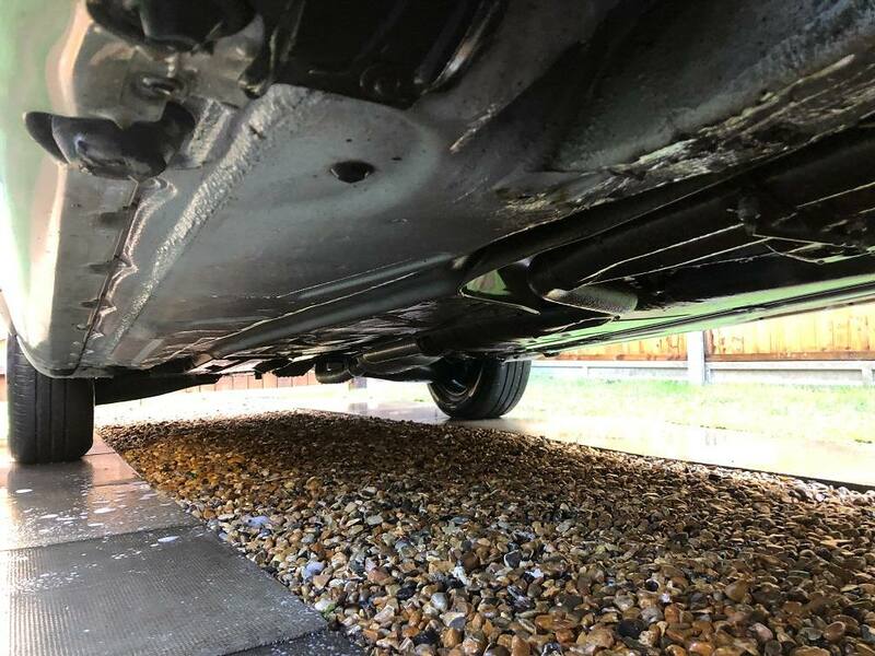

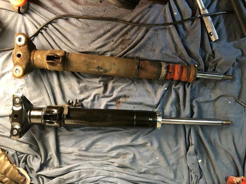

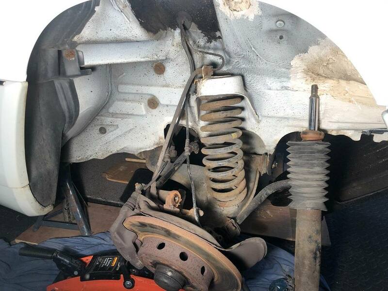

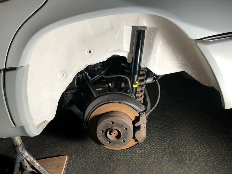

Peter C Posted December 29, 2020 Author Posted December 29, 2020 After two long days of painting, undersealing and re-assembling, the rear end is finally done. Everything went back together ok, the new shock absorbers were easy to fit and most importantly, there is no visible rust on the rear part of the floor pan and the rear subframe. The (cheap from Poland) replacement exhaust system was a doddle to fit. The exhaust came with a complete fitting kit, which included everything I needed. The centre and rear boxes took about 5 minutes to fit. Rather than calling it a day, I got the front of the 200E up, ready for more fun tomorrow. The front shock absorbers look more difficult to replace than the rears. Wish me luck. rainagain, Tickman, Dick Cheeseburger and 13 others 16

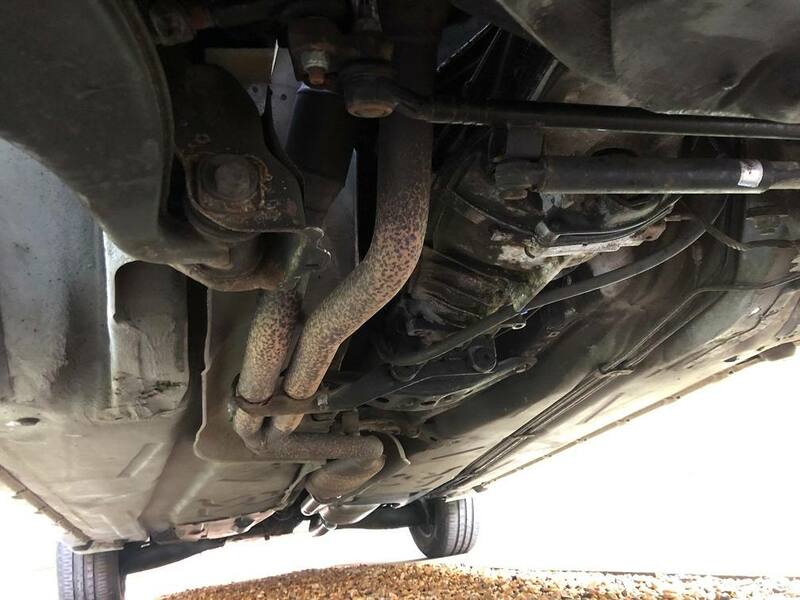

vaughant Posted December 29, 2020 Posted December 29, 2020 Looks fantastic on white stonechip, love it. Did this years ago to my series one and thought it looked amazing, took bloody forever though. I've learnt with exhausts it's far easier to replace the lot if possible and of course cost effective. In fact this week I'm revisiting an exhaust repair I carried out a few months ago to replace the one new part I forgot to order... Total cost of clamp (s) A fiver 🙄🙄🙄🙄. I am an idiot. Peter C and DSdriver 2
HMC Posted December 29, 2020 Posted December 29, 2020 Nice work all. Seeing that rear inner arch and the leading rear subframe “perch” reminds me of some rot there on a couple of my old w124s. Not easy to fix! Yours look nice and sound.

Peter C Posted December 29, 2020 Author Posted December 29, 2020 22 minutes ago, HMC said: Nice work all. Seeing that rear inner arch and the leading rear subframe “perch” reminds me of some rot there on a couple of my old w124s. Not easy to fix! Yours look nice and sound. Surface rust aside (now all treated), there’s zero rot on my rear floorpan and subframe. 😎

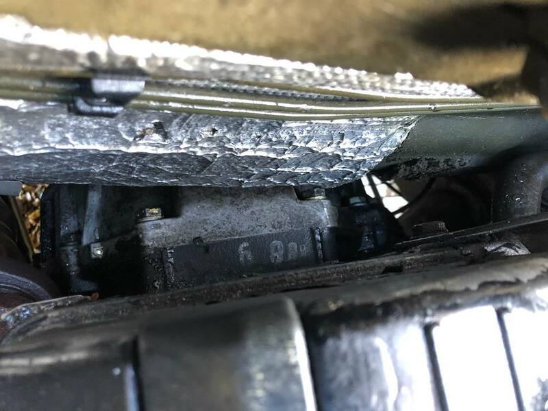

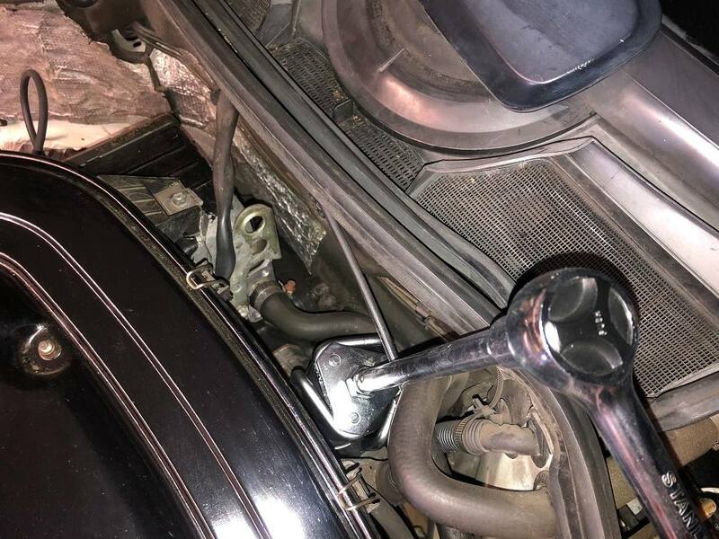

Peter C Posted December 30, 2020 Author Posted December 30, 2020 I bought a fancy oil filter removal tool to enable an oil and filter change on my TT. I used the same tool to remove the oil filter from my 200E today. The job took about 10 seconds, there was no need to remove the air filter housing and struggle with the chain wrench that I've been using for decades. Win. However, the sump plug, which I last removed approx 12 months ago (and definitely did not overtighten) was having none of it. I rounded off the 13mm head and ended up smashing a 1/2 inch imperial socket over the plug and eventually got it off. The socket doesn't wish to part with the bolt, which is not a problem. For the time being it can stay on the bolt, until I buy a new sump plug. Removal of the front shock absorbers looked a bit daunting at first, however I had the offside unit off and replaced within an hour. The nearside unit took longer to remove due to a couple of stubborn bolts. I let the trolley jack do the hard work. There wasn't much cleaning up to do in the front arches. Back in the summer I gave the inner arches a good clean and coated any flaky paint and surface corrosion and I was pleased to see that my efforts remained presentable. With the new shock absorbers fitted, the mostly original original arches look tidy. One of the wheel trims had a scratch on it and back in the summer I sanded down the plastic and sprayed the central ring. The finish of the acrylic paint that I used wasn't great so I took the opportunity to give the wheel trim another squirt of spray. This time the paint looked far more presentable. With all jobs completed, I rolled the 200E out of the garage. Tomorrow I'll give it a wash as it's covered with dust. I suffer from OCD when it comes to keeping my garages tidy. Grinding, sanding and welding created a fair amount of dust and dirt, which had to be dealt with asap. The process of cleaning the garage involves mopping the floor, which dried surprisingly quickly considering that I left the doors open and let the cold in. Squarepegroundhole, rainagain, Shite Ron and 3 others 6
bigfella2 Posted December 30, 2020 Posted December 30, 2020 Isn't the oil filter on the TT a cartridge one with a plastic lid? Or is it a regular screw on metal canister? Just every midernish vag I see (mostly tdi's) are cartridge.
Peter C Posted December 30, 2020 Author Posted December 30, 2020 6 minutes ago, bigfella2 said: Isn't the oil filter on the TT a cartridge one with a plastic lid? Or is it a regular screw on metal canister? Just every midernish vag I see (mostly tdi's) are cartridge. bigfella2 1

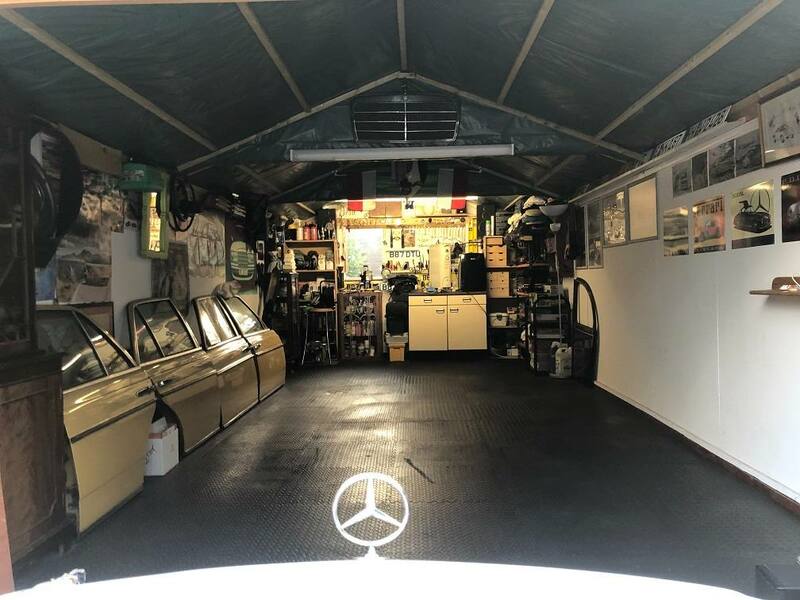

Talbot Posted December 30, 2020 Posted December 30, 2020 1 hour ago, Peter C said: I suffer from OCD when it comes to keeping my garages tidy. Grinding, sanding and welding created a fair amount of dust and dirt, which had to be dealt with asap. Nothing wrong with that. It was a breath of fresh air to work in a garage with an insulated floor and no "crap" in the way. I felt a bit bad about spraying hot metal and grinding dust all over the floor. BorniteIdentity 1
Peter C Posted December 30, 2020 Author Posted December 30, 2020 5 minutes ago, Talbot said: Nothing wrong with that. It was a breath of fresh air to work in a garage with an insulated floor and no "crap" in the way. I felt a bit bad about spraying hot metal and grinding dust all over the floor. With the floor cleaned and mopped, I noticed a handful of small burn holes. Not to worry, I’d rather have holes in my floor tiles than in my wheel arches. DSdriver 1
Talbot Posted December 30, 2020 Posted December 30, 2020 I guess one of the tiles we put down must have moved a bit. You only need a couple of mm and weld spatter will get through. Irritatingly.

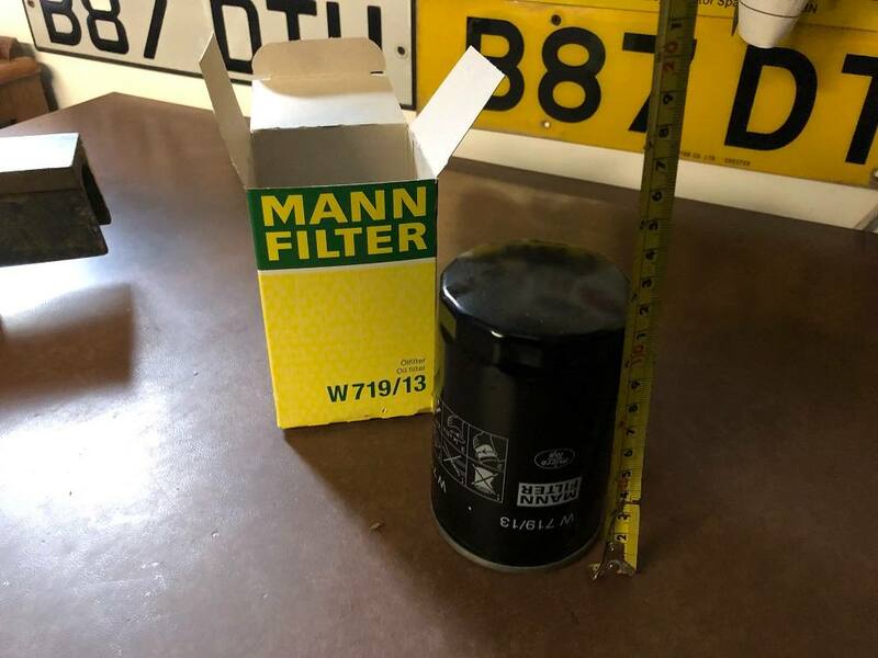

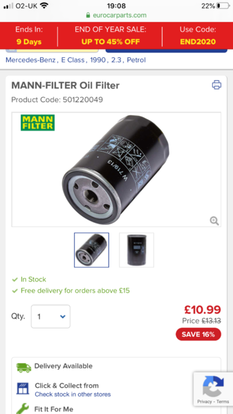

MJK 24 Posted December 30, 2020 Posted December 30, 2020 The original oil filter for your engine was twice the length of the one you’ve fitted. It made them very easy to change with no special tools and without removing the air box. Mercedes changed their own filter to one that was vastly shorter and then they became a mission to change. Mann can still supply the older, larger design which will make your oil changes much easier. You’ll also feel happy inside knowing you’ve got a bigger filter fitted! DSdriver 1
Peter C Posted December 30, 2020 Author Posted December 30, 2020 3 minutes ago, MJK 24 said: The original oil filter for your engine was twice the length of the one you’ve fitted. It made them very easy to change with no special tools and without removing the air box. Mercedes changed their own filter to one that was vastly shorter and then they became a mission to change. Mann can still supply the older, larger design which will make your oil changes much easier. You’ll also feel happy inside knowing you’ve got a bigger filter fitted! The oil filter presented in your post is exactly the same as the one that I fitted to the 200E this morning. The oil filter that I presented above is for an Audi TT. MJK 24 1
Peter C Posted December 30, 2020 Author Posted December 30, 2020 And considering how much force was needed to remove my old filter, there’s no way it could have been removed by hand with the air filter in situ. MJK 24 1
MJK 24 Posted December 30, 2020 Posted December 30, 2020 32 minutes ago, Peter C said: The oil filter presented in your post is exactly the same as the one that I fitted to the 200E this morning. The oil filter that I presented above is for an Audi TT. Fair enough - it looks in your photo like it was recessed far below the top of the air filter. The original Mann filter will be roughly level with the top of the air box.

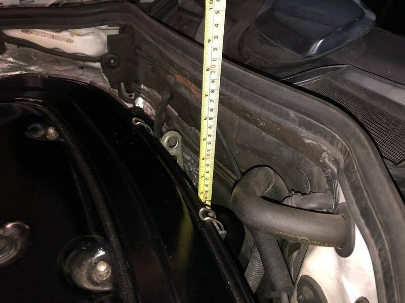

Peter C Posted December 31, 2020 Author Posted December 31, 2020 16 hours ago, MJK 24 said: The original Mann filter will be roughly level with the top of the air box. This got me thinking whether I am using the correct oil filter. I got my tape measure out, the distance from the top of the oil filter to the top of the air filter housing is 100mm and the (as far as I know correct Mann) oil filter is 120mm high. For the top of the oil filter to be level with the top of the air filter housing, it would have to be almost 9 inches high, which I am sure can't be right. I have photographic evidence!
Peter C Posted December 31, 2020 Author Posted December 31, 2020 Earlier today I took the 200E for a 15 mile COVID tier 4 compliant test drive. I am pleased to report that the new shock absorbers and exhaust system are all ok, nothing bangs or rattles. The ride comfort has not changed but the car feels tighter, especially the front end and less clunky. I guess that the original 29 years and 145k miles old shock absorbers were past their best. I dusted and wiped over the 200E (it was too cold to give it a full wash) and put it back in the (clean!) garage. The weather will have to improve drastically for it to see the road again. Happy New Year people. The_Equalizer, HMC, DSdriver and 5 others 8

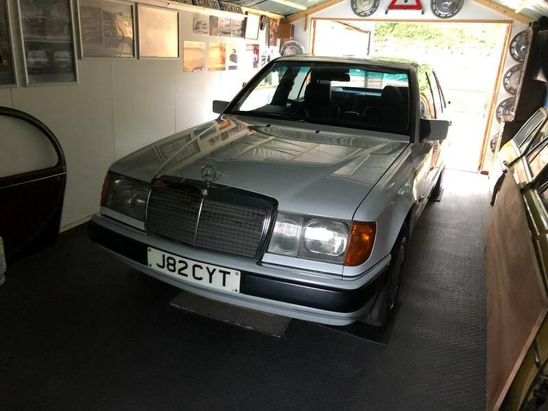

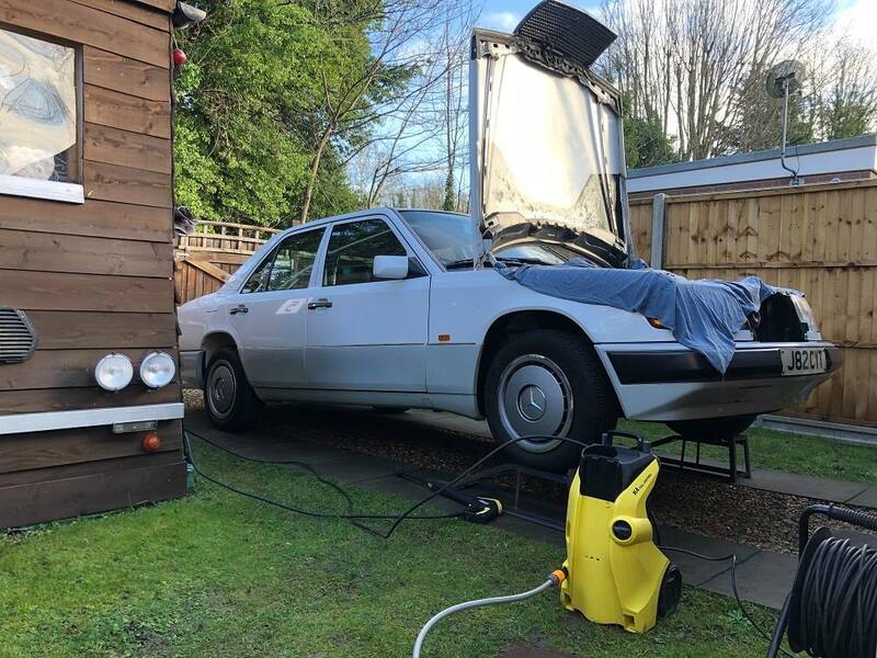

Peter C Posted January 17, 2021 Author Posted January 17, 2021 The 200E's MoT is due next month. I can't see it failing on anything (bugger, now I've done it) but I wanted it to present as best as possible to whoever does the test. The bodywork gleams, the engine bay is tidy enough and the interior is near mint. The only thing that lets the 200E down is the (replacement) oil stained gearbox. I decided to pressure wash the gearbox. I started by getting the 200E up on ramps and covering up the engine bay so not to splash the clean ancillaries with mucky water. The gearbox is just about visible from the engine bay, between the bulkhead and rear of the cylinder head. It was filthy. The underside was a bit grubby too. Amazing what you can achieve with a pressure washer in 10 minutes. The gearbox looks a lot better. I got slightly carried away and cleaned the floorpans too. The roads are wet and filthy and I don't want to get the underside of the 200E dirty before the MoT test, so the furthest I've taken it to dry the underside is outside my house. Hopefully the weather will drastically improve before the end of February. Shep Shepherd, Barry Cade, Coprolalia and 6 others 9
DSdriver Posted January 17, 2021 Posted January 17, 2021 What make are the floor tiles, I need to do my workshop?
Peter C Posted January 17, 2021 Author Posted January 17, 2021 49 minutes ago, DSdriver said: What make are the floor tiles, I need to do my workshop? https://www.ebay.co.uk/itm/Interlocking-Soft-Foam-Floor-Mats-EVA-Puzzle-Rubber-Yoga-Tiles-Gym-Flooring/324267920521?_trkparms=ispr%3D1&hash=item4b7fdfcc89:g:hTQAAOSwR7JfIKkT&amdata=enc%3AAQAFAAACgBaobrjLl8XobRIiIML1V4Imu%2Fn%2BzU5L90Z278x5ickk5v8gVt3hEWLVg%2F253w6XCb8YSPm4XU6yotv8yxbpPASJ%2BrhTezXAy1BKdl9MvhazQ82%2BWXmH8LcNK0WFmL0TAmdqxgq%2B9hwlJ4qp9Z6agdHXuE0XShk7reUiYSlB34%2Fy%2BVZE1mjnV0Y7tCei71p6Q7r%2B0z4uh6NlWqu%2F6Id4VJioKfhgLffBBB5DPoYcu%2FqiJaWbcCJKieTegI1AUYG2qteaCgvvQ0AthNS%2FJshdo9cMrO9WmU4kN%2F96%2B06qsdPoI8jww8JIrh5zgONz%2FGZLw4lnPU%2FWszk8yPc5uAddS%2FcO46VZuqqrLirYP9kNU1OLB8esir%2FZGNrtTTXCztBu24Ru4mYyOtt0mz%2BrW2A32pP2WhGLlDX8HOI%2BiDyJd3AJIcQymS2pWPzwHzM6rSrPTSB8GZsp81yw3ORrQDFsZ%2BVBZ5K87V2NnLtg0ZTGQ%2BB71fCgjEvuloGZnXYvjM6GZboUpafcbPgkkCl50ZIaiZdl1h1sfuYC4qOAlFfQtd%2Bv3Sb49XFK2W0%2B1NAOErgxETBSpmsO1YES3OvG75MAEpevuI9Fs13grRnTak6ehntDqxCe7VXhFUYqCKzqGKVBqGLbhINgxLXgYYFmW1TVN1scZnr5UqsPBu24j%2BTYC8uxf%2FnSiOKGyPlqaJVVykF4nQ%2FbEn7bfysbhMPTouw%2FeMqg7YJCeVeQrBMnxntMnBk6e0Z04YQSPRSPFG0AvK9HeDJBWEvfyZaklCIc0K3kMIj%2FLqoSw04hW%2F3WkR8dRKUc3KwFswQw2Mto19ut6eMfvwR4VLjTMgvrGPA9UYIC1%2Bg%3D|cksum%3A324267920521c76fdea928bb42a8b29225b506145663|ampid%3APL_CLK|clp%3A2334524 DSdriver 1
