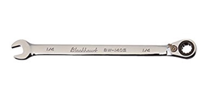

OK it's just a ratchet ring spanner, but because it's 1/4" you can pop any hex-drive screwdriver bit in and win battles with screws in very awkward places.

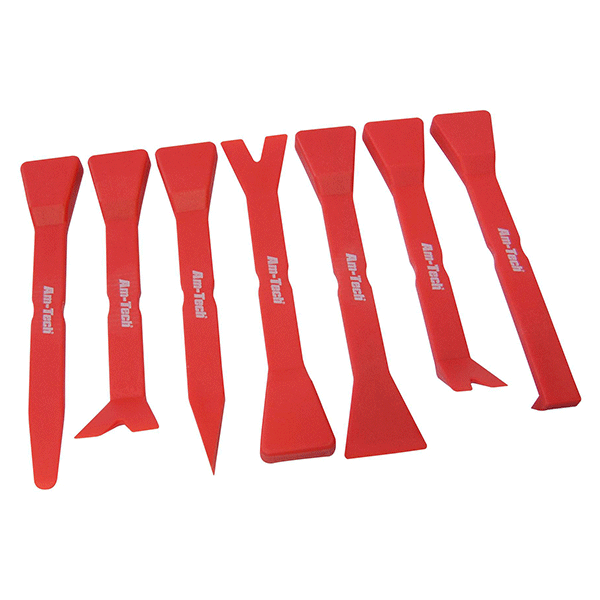

Trim removal tools. Because you just know if you use a screwdriver to remove that fragile A pillar trim, you are going to end up with a broken A pillar trim.
I used some like this removing bits of my moderns interior, and nothing got bent or broken in the process - much better than using a butter knife or whatever is lying around

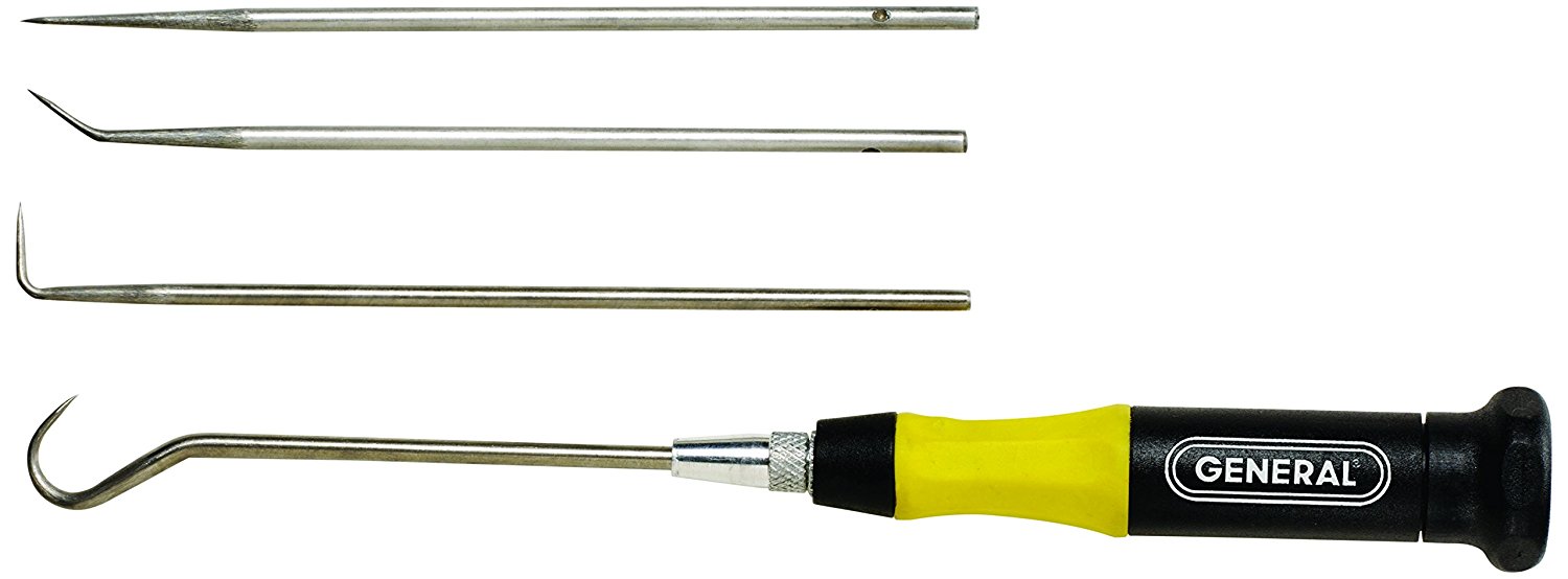

Spring hooks. Until recently I had a set of 5 that were held in a propelling pencil-type holder that was also the handle with a chuck at one end in which you mounted the spring hooks. Brilliant, had it for years since I was a copier tech and used it for just about everything EXCEPT hooking springs: retrieving things dropped down holes and cracks too small for fingers; cleaning crap out of threads; cleaning paint out of screwheads; scratching markings into just about anything; cleaning screen washer nozzles.
A bit like this:
Lost it recently fitting kitchen units. It's probably behind a kick panel somewhere...
