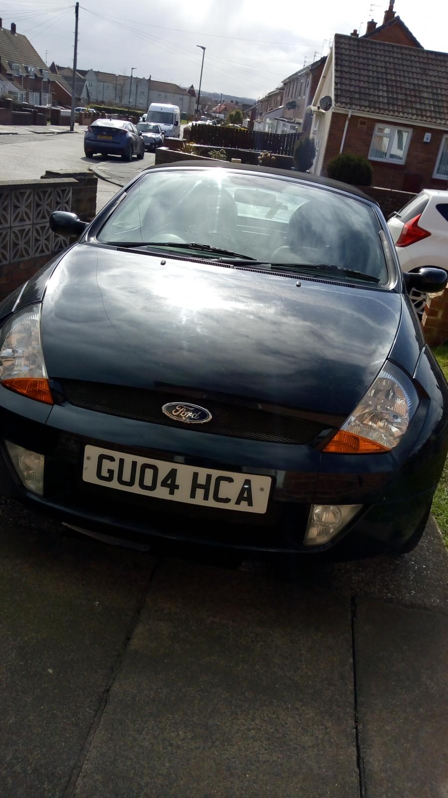

I don't remember buying a Streetka, but this is what it would read like if I did.
Please note the invisible mending performed on the rear screen. I'm quite proud of that workmanship.

Has a couple of rust scabs at the bottom of the doors and paint is a bit shabby from close up.
Plastic rear window is borked. (120 quid to replace)

Apart from a couple of little scabs on the doors its remarkably rust free. Sills and major weight bearing bits are sound

Second-hand replacement roof will be easier and cheaper than new rear window, 3x17(possibly 19?)mm-headed bolts behind each door (take one out, loosen the other two I think) and lift it off. Replacement drops on, put in place onto header rail and tighten bolts up.

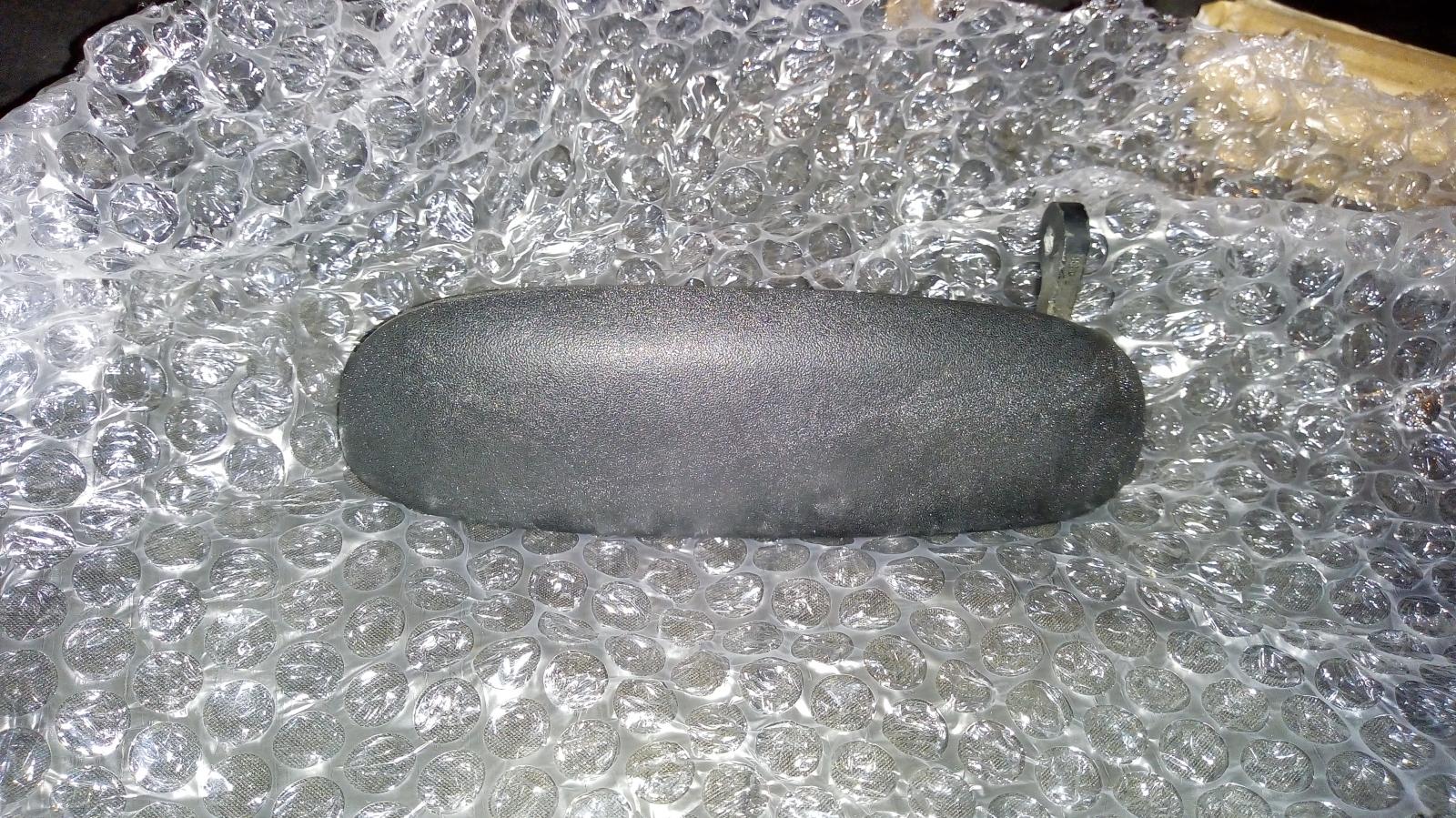

In an attempt to annoy me, my Steerkaks passenger door handle has ceased to work when operated from the outside. Still works fine from the inside though. A bit of googling reveals this as a common problem. I don't know if I can be arsed to try and sort this, it's not as if I carry many passengers anyway.

I've sourced a pre-loved handle from the bay of evil for 6 groats. Bought a dozen of those little ford trim screws as well as these seem to be made to self destruct every time you take a door card off...
Ignore my earlier malaise. I'm definitely* going to sort the handle out next weekend
