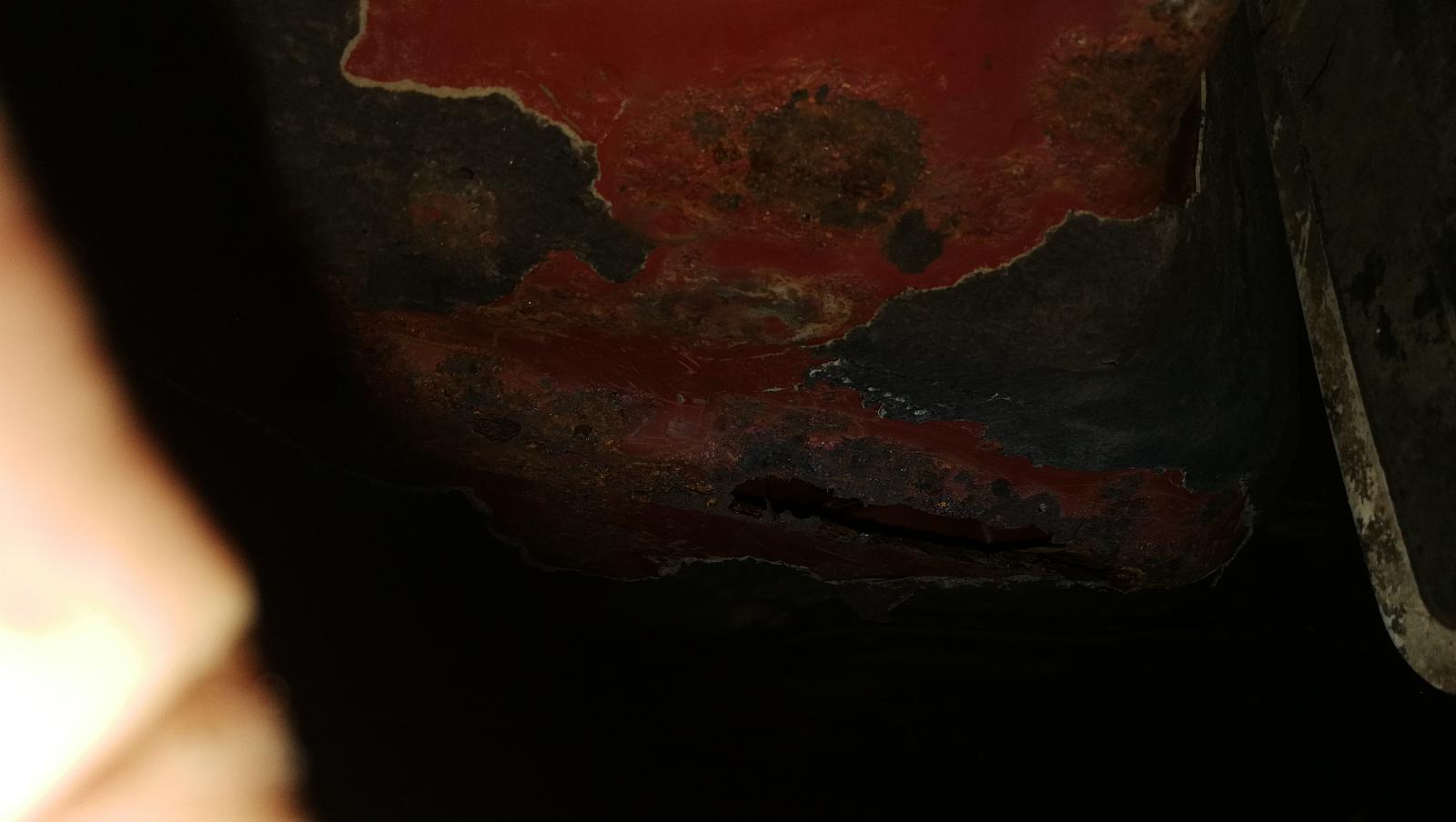

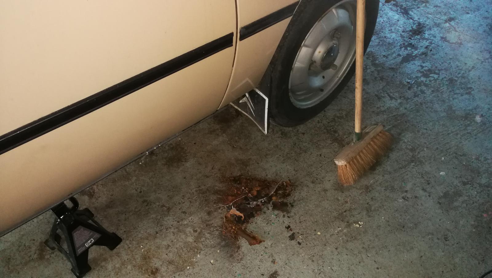

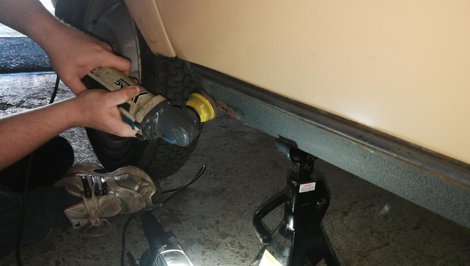

320touring Posted May 29, 2018 Author Posted May 29, 2018 Got the opportunity to get the MOT fail items sorted on this at the weekend.. Firstly, the right rear outer sill got cleaned, cut and patched. This was a nice easy repair - set car to high, place axle stand appropriately, set car to low. Marvellous. Patch was let In, tidied up a touch and covered in Vactan and underseal. Next up was the outer skin on the front floor. It was a classic case of underseal splitting and letting water in. The patent "Oxford" method of corrosion assessment (grinder mounted wire brush followed by screwdriver) revealed 3 holed sections. 2 were small 1" X2" patches, but the third was a relatively long, thin strip. Some swearing, cutting and grinding later, we had clean surfaces to weld to, and some panels available. Once these were welded in, it was a second case of "Vactan n spray shoot". All done, I'll get it in for the retest on Friday, all being well. Skizzer, Mrs6C, Cleon-Fonte and 8 others 11
