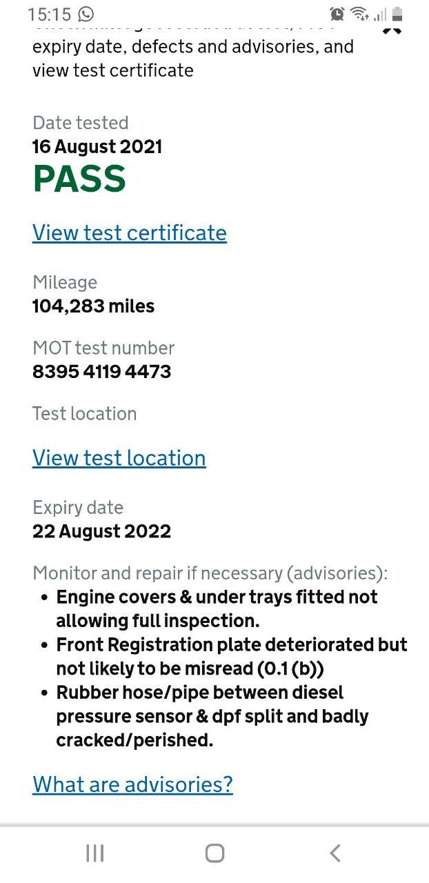

And the cheapo mk4 passed with 3 advisories, only one of which really matters
Get that perished pipe replaced asap.
Otherwise it won't regen and you'll run into dpf trouble.
I will. I'm hoping it will last a week, because garage can't fit it in till then.
