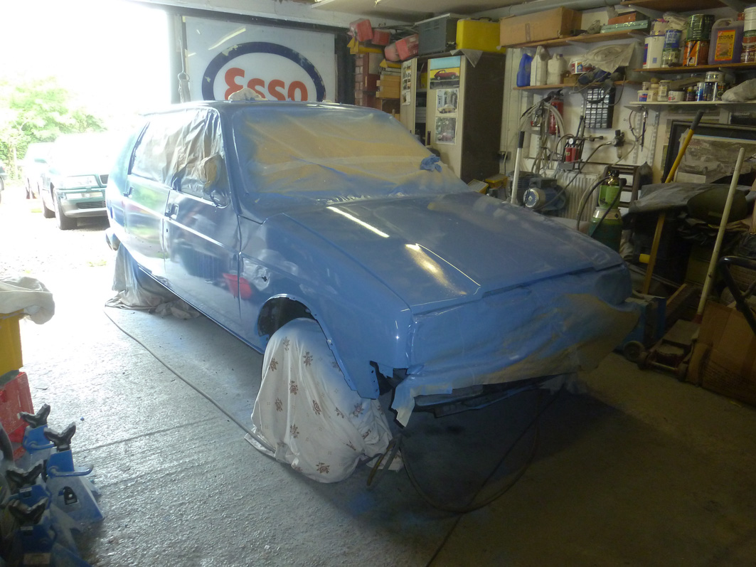

I have done this a few times both using an electric earlex spray station
Here is one I did. Painted everything except the roof
You can spray a car in a garage.
