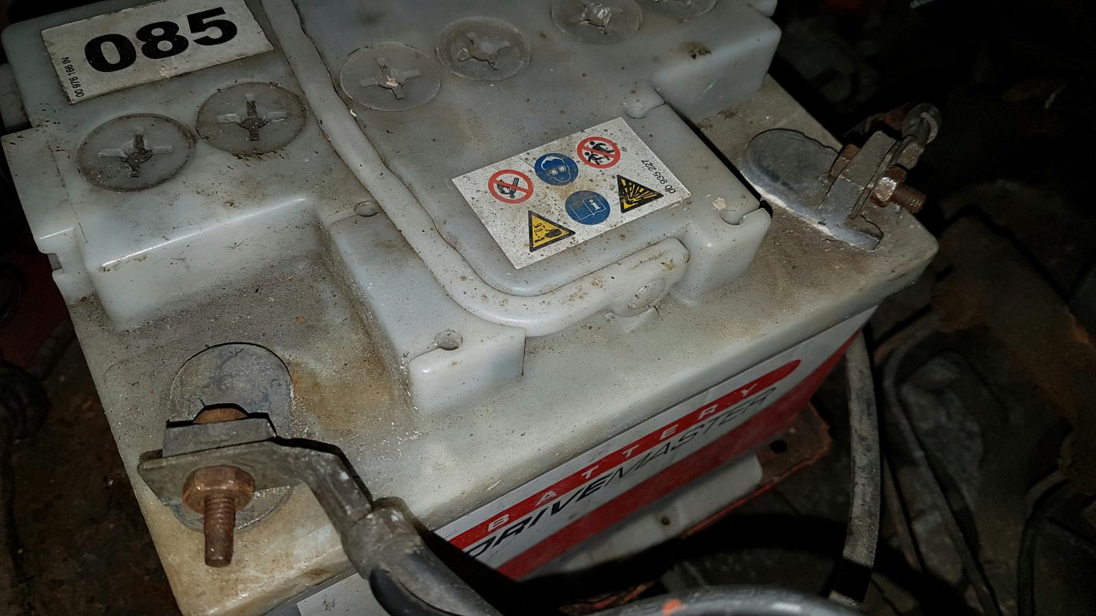

I gave up on the steering column and double checked all the battery. Made them mega tight.
Car started as the recovery guy got there
Now you are mobile when you get home take the connections off the battery clean them and make sure they are gripping the battery posts firmly - you might need to widen the slot with a hacksaw to enable them to close up more they need to be tight but not omg I'm going to snap the terminal off tight..

I'll be taking it all apart tomorrow giving it a scrub and covering it in copper slip.
Lol can't make them go together tighter as someone says above

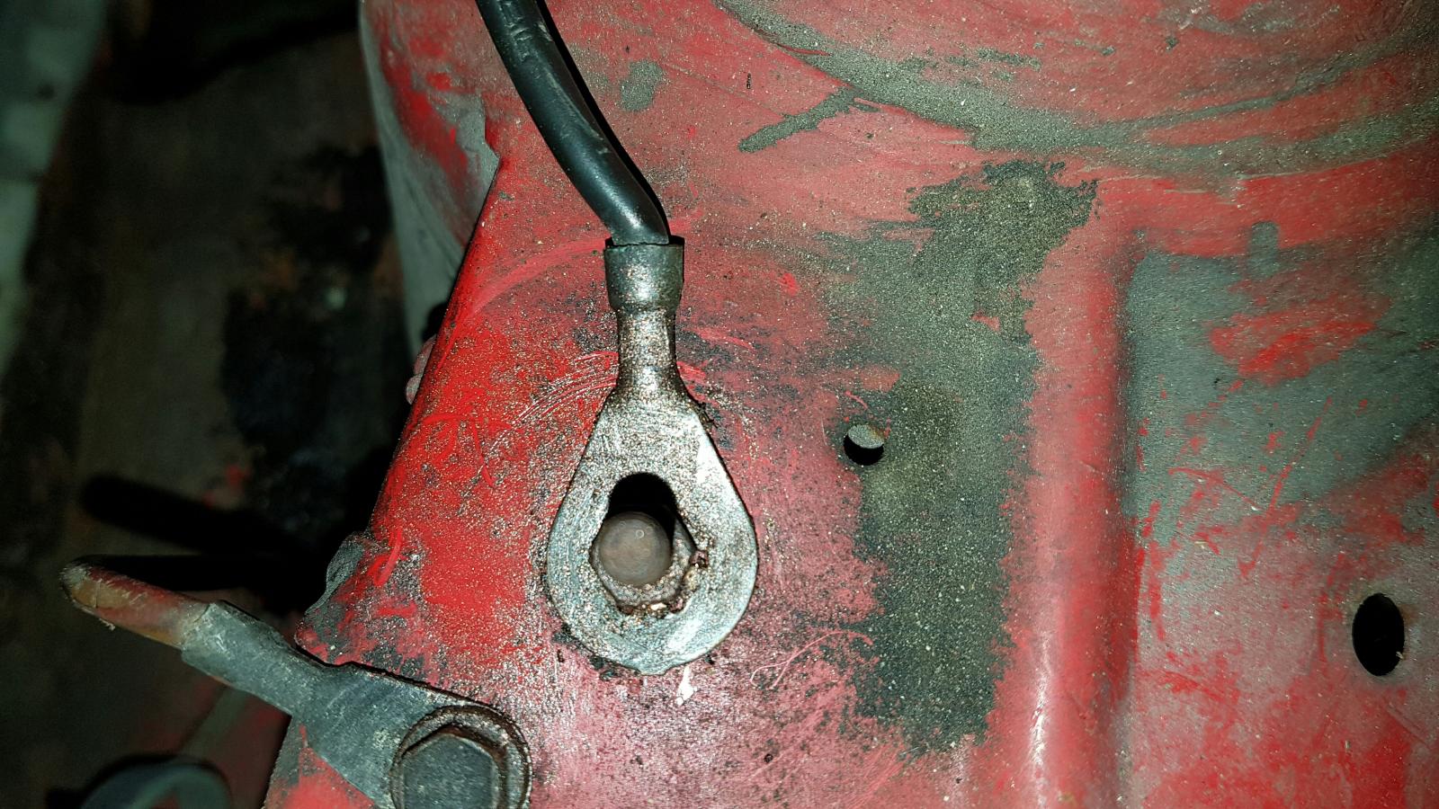

This is the earth, sort of grease and rust. Looks worse in real life. I'll have to move it but it's a bit short.
Just clean the connections. The dirt is holding them apart. They don't need to be tighter. Just a better contact
Clock will work as it works off a constant livr and draws fuck all current. Shouldn't need to be megabastard tight, a clean connection is more important.
Won't hurt to clean the battery with detergent too.  Some say it stops leakage, not convinced at 12 volts but they sure look nice.

1. That earth doesn't look original, possibly moved from the inner wing if there's been a repair there previously?

1. It is the original but I moved it to there as it has rotted through where it was attached on the inner wing. I didn't reattach it to the new metal I stuck on.

That battery earth looks pathetically small.  It should be at least the diameter of the cable to the starter motor, if not larger.  Any resistance in ground cables will result in big issues starting.
That's not the issue you had here, clearly, as a small earth won't stop the ignition or (weak) cranking, but if you're going to the trouble of having the cables off the battery, put a decent size earth cable on it.
Also, small dirt on the terminals will be random and may turn into very high resistance corrosion upon application of high current (starter motor, headlights)
Enough that things that draw hardly anything will work but all other symptoms point to a bad battery.
See also connector that Herr JM refers to, same issues, smaller connector, less current required to heat up terminals enough to form rapid surface corrosion.

No. I literally attached Tommy Walsh's finest pound shop spanner to the nuts on the battery and tightened the shit out of them and the car then had power and started.
DO NOT copper grease where the connections are until AFTER you've reconnected everything, seen many people make this mistake in the past and ice even done it myself on my old Vanette. A quick test with a multimeter revealed a high resistance despite it being a new cable, copper grease cleaned off, zero resistance, started perfectly.
