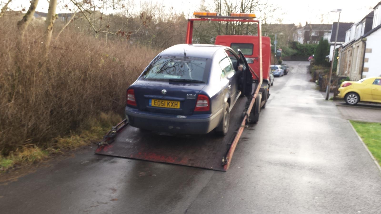

Did you strip much off it ready for the next one?
That is a sad picture though
It has been raining since September so ahv done fookall..
