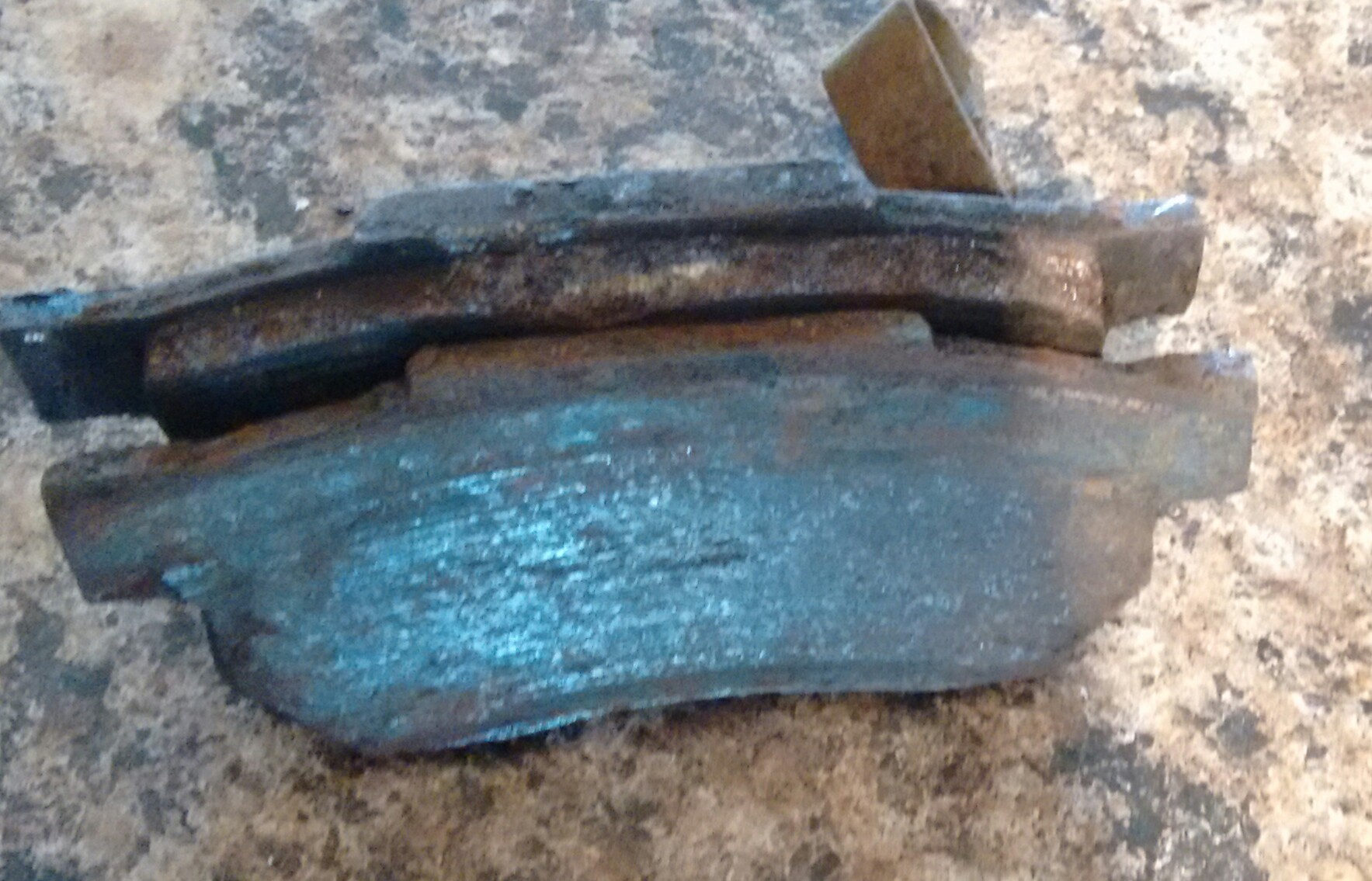

Tried taking rear caliper off the civic to do the brakes. After much swearing gave up and phoned fitquick. Rear discs and pads fitted £265. Ouch
Been back out and applied brute forcek with success. Zero friction material on one side.
Of course ECP have sent me wrong pads. Will have to fix it later on in week.
LS:  before buying an aerial, remove the radio and check the aerial is still actually plugged in properly.  For some strange reason they can work loose when other jobs are done on a car.
Mr moog, without teaching granny to suck eggs but check the caliper sliders for seizure . Lube with cv grease or rubber grease . Also make sure you align the cross in the piston with the tit on the back of the pad before you refit
Will be doing that before goes back on. It's just crusty back there, I assume not been touched for a while.
Top slider had slightly rounded so will need to clean and file t flat before refitting

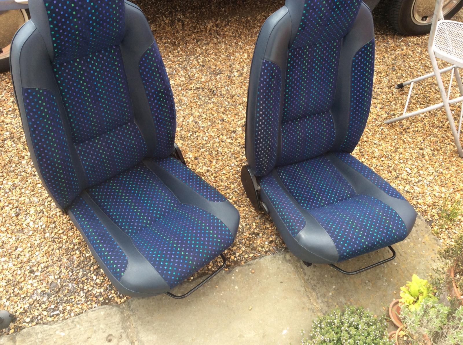

Drove the 2cv 85 miles to a little village outside Stroud this morning to pick up two seats for the X1/9. After a bit of a faff with him not answering his phone for two hours, I went for lunch in the pub and one of the locals offered to go and get him:-)

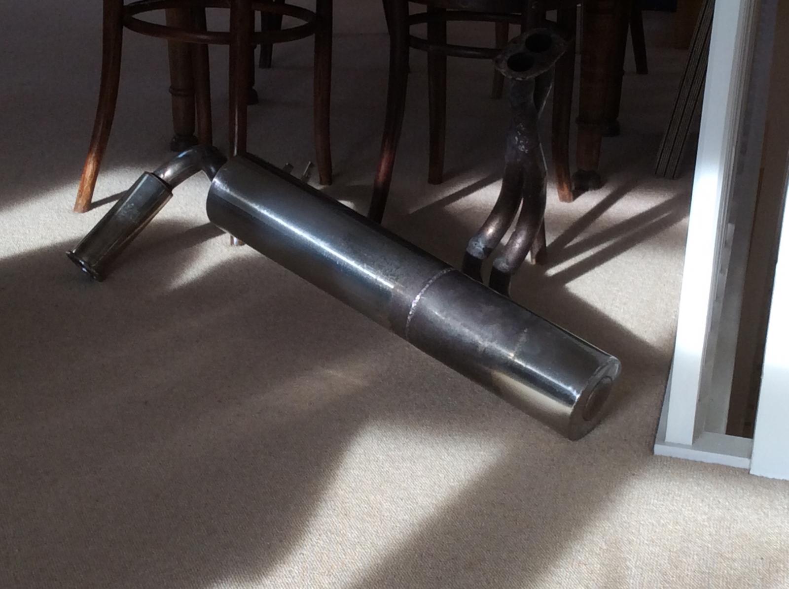

I also bought on spec a custom stainless exhaust- now a "feature" in my living room after a quick polish. For £40 I didn't think I could go wrong, given new mild steel ones ar £180. I don't plan on fitting it until the current exhaust fails so wil store it away for a few years.
