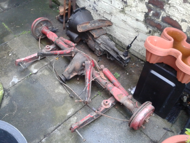

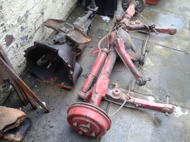

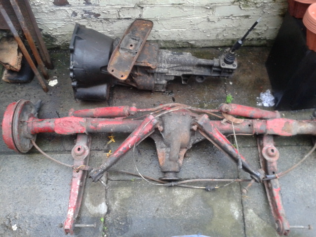

Axle isn't an atlas, but the diff isn't rumbling it's tits off like my current one and it also appears to have had all new bushes ( solid top voids for the win!) so every cloud....
The box is just chock full of win selects gears easily and comes with the release fork, bell housing, crossmember and stick. Not bad for £115.
