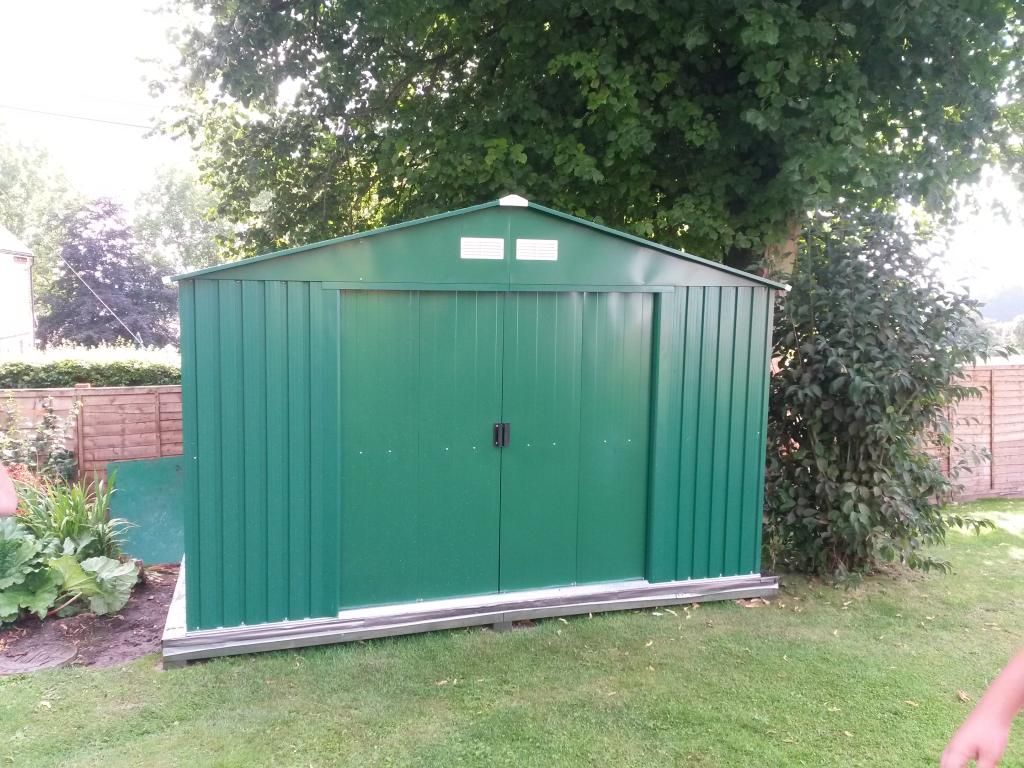

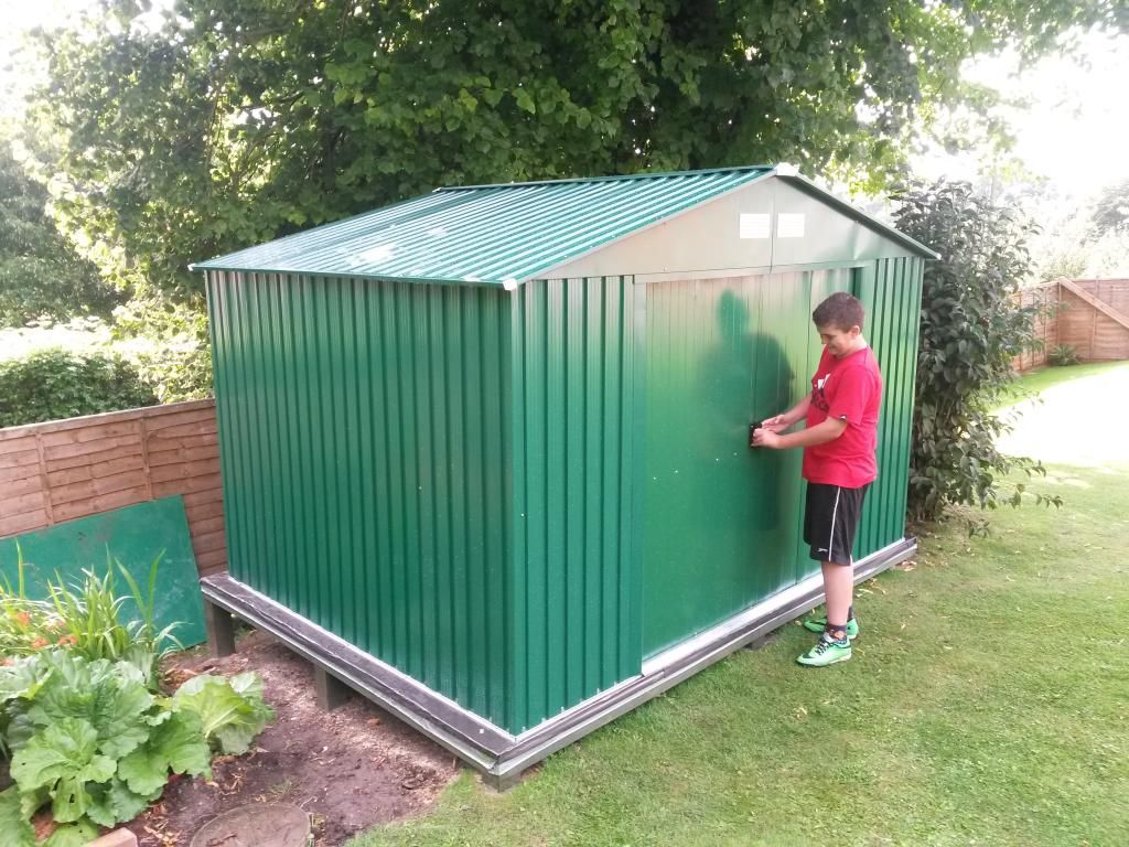

helped a mate build his shed...
and hanging the door i did this..
Where theres blame theres a claim.....
