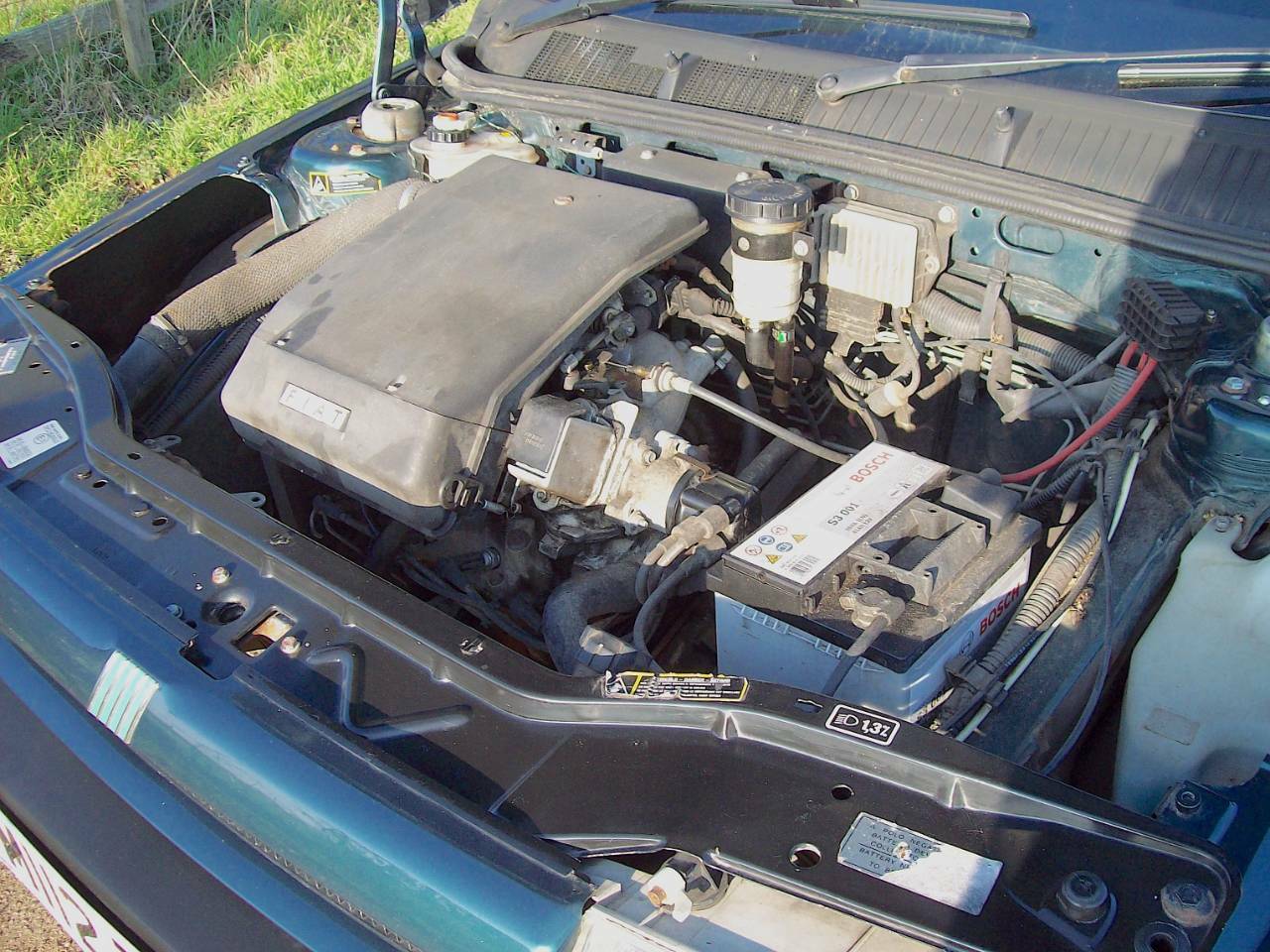

Still no joy with my Tipo which FTP'd back in July.  It is still at the garage.  A new coil had no effect on the lack of sparks and earlier this week a decent, correct 2nd hand ecu was sourced at an Italian cars specialist. We fitted it but symptoms remained unchanged - no sparks.  I'll try to get over to the garage with my multimeter next week to carry out pin checks on the ecu connector in accordance with a Digiplex manual that a chap on the Fiat forum forwarded, plus a few basic continuity checks on other leads e.g. the ignition king lead.  If these checks don't show anything untoward, I won't have anything else affordable to try to replace.  The Fiat's days could be numbered.  If it comes to that, I'll see if anyone wants it as a spares car for scrap money and if that fails to attract anyone it will go to a scrappy for £150 (assuming we can tow it there) or whatever the going rate is.

The PDF that was sent to you looks useful, however I do note that the coil wiring is different in that document to what yours is. I.e. the PDF shows a standard three wire (pos/neg/HT) coil where as yours has four wires plus HT. So possibly the wiring is different. Also interesting that manual tells you to remove the complete engine head to get accurate timing for it to run properly - how ridiculous.
Given the sudden nature for it to fail and not restart after a shutdown, it does suggest that there is an internal electronic failure somewhere - whether module or sensor.  When you said you got a second hand ECU, was this a Digiplex module or fuel injection module?
From what I can tell from the info about, your car has the Digiplex for ignition and then a Bosch MonoJetronic for injection. Presumably the Digiplex feeds a RPM signal to the MonoJetronic so that can do it's calculations. So wondering if the Digiplex module may have failed internally but the replacement ECU was a MonoJetronic that hadn't failed?
Is the engine a FIRE unit? I.e. can you get hold of a points dizzy that will mount on it?

Good points (pun not intended).  It was the Digiplex 2 model 439M which we replaced - like for like.  Yes, the other ecu controls the single point fuel injection but that has not been touched or investigated as the symptoms of the stoppage did not put any suspicions there.  Earlier versions of the 1.4 engine in the Tipo had a carburettor with the  distributor mounted on the side of the crank case,  on the front of the engine.  My engine has a blanking plate or it may even cast as a blank (not machined to accept a distributor) as the distributor is at one end of the camshaft rotating on the same axis.  Without doing a lot of research, I do not know whether there are internal differences to delete the earlier distributor drive set-up or whether the monojetronic inlet manifold differs from the carb inlet manifold.  I have not seen any references to my 1372cc unit being a FIRE series type.  The 1.4ie engine is shared by the Tempra and some Uno models, the Tempra 1.4 being virtually the same as my Tipo under the bonnet for obvious reasons (Tipo with a boot = Tempra). There are other closely related engines in other Italian marques but these generally have numerous detail differences in ignition and injection systems and use different ECUs.  I'll carry out my multimeter checks to confirm or otherwise the correct resistances for the sensors.  The one you mentioned which requires the head off to access or set-up would immediately sentence the car to being moved to a new owner or scrapped. I am unable and unwilling to take on that task or pay someone to do it.  Fortunately, that particular sensor is not a common failure and tends only to shake out of adjustment, ruining performance but not stopping the engine from running.  My engine has always performed absolutely fine.

 We've spoken to a couple on the 'phone.  They were not keen to take it further because, although there is a rudimentary diagnostic connector on the loom under the bonnet, no-one (including long established Fiat dealers) has the original Fiat diagnostic device or anything compatible with it.  It would be a project to get anything to read it.  There are a couple of UK companies who could repair or clone the Digiplex ECU if that was found to be the problem.  Prices start at £200 .... much more if it proves a difficult one.  The car is worth £600.  I'm not an eBay optimist who would try for £2K.  My preferred budget is <£400 to fix the Tipo.  I'll update with my findings after waving my multimeter leads about next week 😁

I've had a quick Google around. I think that PDF referred to the original Digiplex. The Digiplex 2 only has one sensor from what I can see (crank presumably).
Found this info on a Russian site (Google translated):
https://www-drive2-ru.translate.goog/l/3078242/?_x_tr_sl=auto&_x_tr_tl=en&_x_tr_hl=en-US&_x_tr_pto=wapp
Obviously can't guarantee it'll be correct but the title and description seem to check out okay.
Things of interest:
There is a feed from the starter relay to the control module. Possibly this signals to start the module up? I.e. if someone leaves the ignition on, it stays off to save burning it out? I'd check this wire hasn't broken. This would be the first thing I'd check as could definitely give the symptoms of a sudden non start.
Tacho is connected to the coil. Possible the tacho has failed, shorting this and causing it to not send a spark? I'd probably disconnect this for now if possible.
The round circle near the battery is presumably the ignition switch? It looks like the 12v goes to the coil first. Off the coil goes to the Digiplex 2 module. Make sure 12v is going through here.
Wire marked 9 should be the ignition drive signal. This will tell you if the Digiplex 2 is even trying to drive the ignition coil. Multimeter on voltage mode should hopefully show a fluctuating voltage when cranking. Ideally connect a oscilloscope to check.
Injection control is separate to the ignition. So it does reduce the possibilities of what can be wrong to essentially around this system. With only one input sensor (crank), it should work if that's coming in and that starter signal has triggered it.
OK so no kind of generic OBD1 tester like my Gunson 4127 would work?
I've just checked the instructions- and although it covers loads of makes, seems not fiat  :-(
@egg  We assumed this was the diagnostic connector shown in the appropriate wiring diagram as existing somewhere in the engine bay.  The Digiplex 2 ECU large connector is disconnected and out of view in this shot.
That doesn't seem to correspond with any of the connectors I have, unless you just push in the 3 flat pins one.

That looks like what it should be from reading the Tipo and Uno wiring diagrams on Haynes I've found on the internet.
The Tipo Haynes only shows Digiplex 2 for the 1.6. Uno shows it for the 1.4 i.e. So presumably the Tipo Haynes doesn't have your runout model (it is a scanned in copy of an old book by the looks of it).
Both the Tipo and Uno for the Digiplex 2 seem to line up. Also line up with that russian description. Tipo is DGT which I assume means carb, if so the extra line (pin 7) to the idle cut off on the carb.
Probably the Uno 1.4 i.e. wiring diagram is more accurate because of it being fuel injected? (Is "i.e." fuel injected in Italian??)
Anyway I'd definitely check on the Digiplex 2 connector:
- 12v power on for power input pin (pin 5)
- 12v power on the Starter relay input signal (pin 3) when cranked on the ignition switch
- Ground by checking Resistance between Pin 10 and battery negative
- Resistance/continuity between pin 11 and coil position (pin 1 on coil).
- Test light between pin 11 and ground will tell you if Digiplex is triggering the coil
 - TDC sensor resistance between pins 7 and pins 8
- Pin 4 goes to the throttle body for idle detection. I believe this should show shorted to ground at idle and open circuit when TB is open (continuity or resistance check). Shouldn't cause ignition to not fire though.
- Pin 7 goes to the diagnostic connector, so don't worry about that
All the above is about it as far as connections to the ignition module goes. I did see an article about repairing the Digiplex 2, so it does appear they're not infallible. However if you've got a known good unit, it's unlikely to be that.
I was also wrong reading through the diagram that is connects to the Bosch ECU. It doesn't as far as I can tell the ignition system is completely independent from the injection system.
Does your car have a rev counter?
@SiC  Thanks for that.  We know where the crank sensor is but not the other one - probably because there isn't one!  My Tipo does not have a tacho. Trim level is too basic.  Electric front windows is about all it's got above a base model.  I'll look for the starter relay to ECU wire condition/continuity.

Digiplex 1 had two sensors. Digiplex 2 had one sensor.
Easiest way I can see to tell the difference is looking at the connector. Digiplex 2 has no connections on Pin 1 and Pin 2.
The two unit typed aren't interchangeable, even though the connector maybe similar/same.
Should be able to connect a test light between ground and Pin 3. Starting should light the test light. While there, probe pin 5 with the same probe and check for 12v input.
Probe pin 11 and it should light. That's going through coil so dimly as there will be some coil resistance.
Change the test light lead to battery positive terminal. Probe pin 10 for ground - should light up. Might as well check pin 4 for idle detection on the throttle body. Again it should light.
Then check resistance across 7 and 8 for TDC sensor.
All that should determine if the connections and power are good. Test light possibly more useful here as the brightness also gives you an indication of high resistance on those pins. If all checks okay, some more figuring may need to be involved. (i.e. waveform of TDC sensor)
Sorry if this has been mentioned before, but what year is the car? Because Multiecuscan (Vagcom for Fiat's) list the software as suitable for Bosch Monomotronic Tipos through the 3pin connector.
There is a limited free edition of Multiecuscan.
https://www.multiecuscan.net/SupportedVehiclesList.aspx
Year of manufacture 1994, first registered August 1994.  The fuel injection system has its own ECU.  All indications on mine (symptoms, wiring diagrams etc) point to an ignition problem which is controlled by a Magneti Marelli Digiplex 2 ECU.  The 1.4ie 1372cc engine in my Tipo has,  according to all information unearthed so far,  got a late configuration set-up which is listed in many sources as being very similar to the 1.6ie.  With the help received from the Fiat forum and more recently from a few posts back on this thread, I now have sufficient information to carry out a number of straightforward checks (mainly continuity/test light)  and measurements (mainly resistance) without needing to find diagnostic equipment compatible with the Digiplex 2 ECU.  I hope to do the checks and measurements next week.
