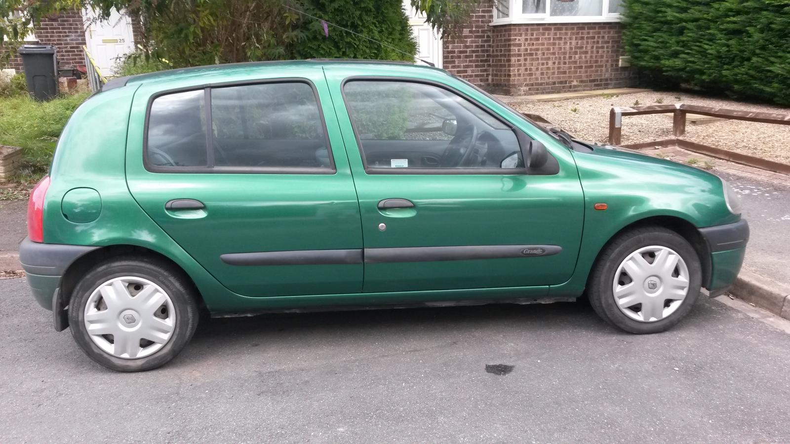

The exhaust on my Clio developed an annoying rattle from the mid-section this week. On inspection the bolt that tightens the clamp between front and rear sections has given up.
Still haven't got round to sorting the exhaust clamp out, although the replacement has now arrived. This week's procrastination did result in a rare visit from the bucket & sponge though.
