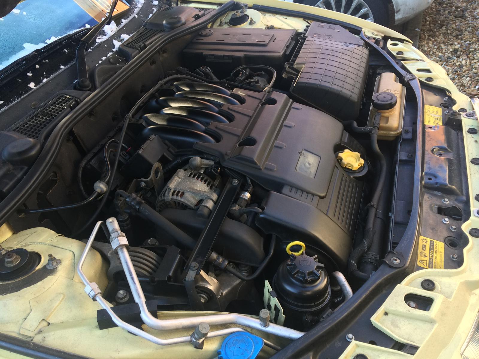

Day off today so I thought I'd check all the levels on the Rover then take a pic for Mr Bornes air con non econ setting.... except the thing was frozen shut!! We don't often get such hard frosts in the tropical south east, eventually got everything open and took the chance to grease all the latches and bonnet catches, then checked levels that seem fine, then spent over an hour de icing and cleaning it. So much for popping outside for 2 minutes..
