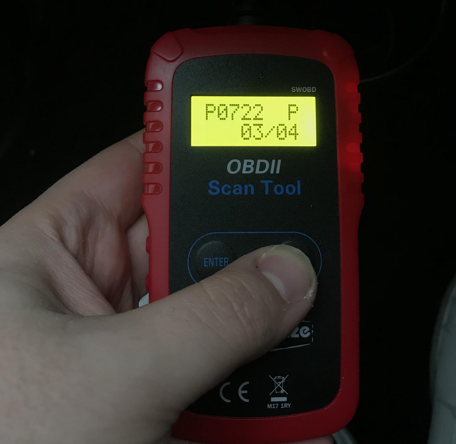

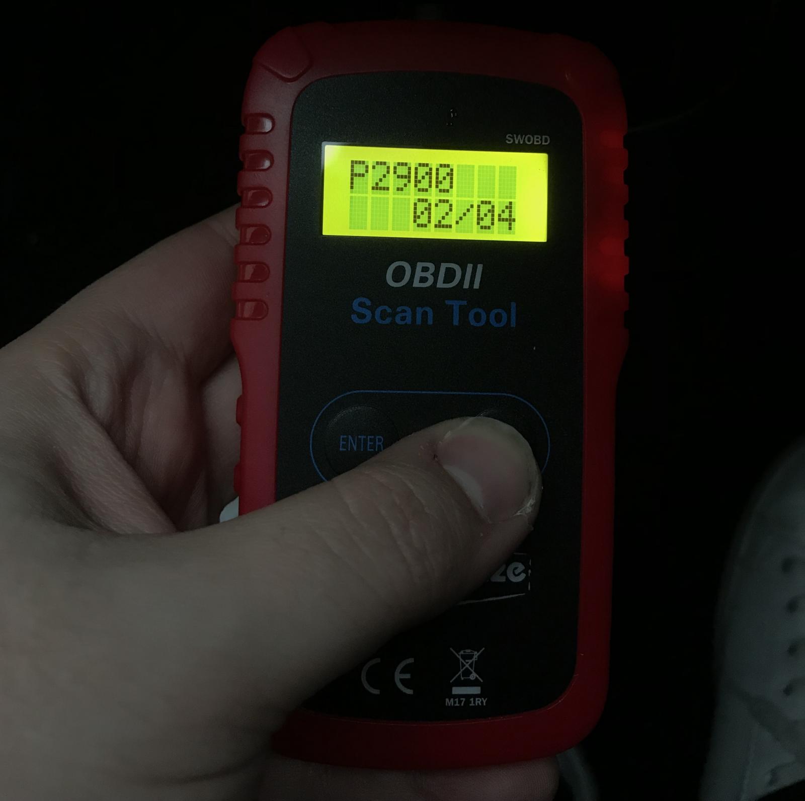

Couldn’t find my fucking Delphi scanner but I’ve found a cheap generic one. Will try in a bit but not hopeful
post-17393-0-37749700-1512832363_thumb.jpegpost-17393-0-39353000-1512832374_thumb.jpegpost-17393-0-25468700-1512832383_thumb.jpegpost-17393-0-99290600-1512832392_thumb.jpeg
Clear function doesn’t work and a couple of the codes aren’t in the book that says what they are
Really need to get it on something proper like Delphi :(

p0322 looks like crank sensore
P0322 Symptoms
  • Check Engine Light will illuminate
  • In many cases, no abnormal symptoms may be noticed
  • Hard starting/no start
  • Engine hesitation or stalling
  • Engine dies and will not re-start
P0722 is a weird one - reads like the speed sensor but surely the speedo wouldn’t work if that was broken?

Deffo more info needed . It's no good saying " crank sensor fault " when there are loads of sub codes that will tell you if it's open circuit , mechanical fault ( damaged pick up wheel ) , short circuit etc etc
Yeah I know it needs a decent diagnostic kit hooking up to it for sure - the cheap generic one I have had on it doesn’t give anywhere near enough info
