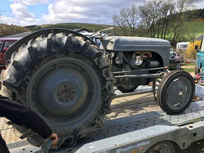

Back in April of '22 I decided I needed* a small tractor for moving road materials along my drive to repair potholes since the LDV tipper is very dead and it is a long way with a bucket load on the Kubota. This decision might* have been influenced when I was offered a non running grey fergie for a fair price. When collected it looked like this:
Apart from being a non runner, one rear wing and the grill were missing, the rear lift arms seized and the original petrol/TVO tank rotted beyond repair. On the plus side, it supposedly had a rebuilt engine ("the timing slipped and stopped it starting"), 4 new tyres and a homemade petrol tank that would not look out of place on the Titanic!
The petrol tank is staying as it will never work hard enough to build up enough heat to run well on TVO, but it is not possible for the timing to "slip" on a fergie as the distributor is driven by a dog onto the camshaft, so if the distributor itself is tight the timing once set is either right or 180 degrees out. An intial look showed the timing well out, so I set it using a pin into the flywheel for 6 degrees btdc or whatever it is. The engine refused to start! In desperation I tried a sniff of brake cleaner, and it remained dead. Time for a cup of tea.
The next day, I went back to it and started again. A check of the timing again showed it to be miles out! A lot of investigation (OK I pulled the distributor) showed the distributor had not been seated into the dog so was operating only on friction.  Once reset, I was confident and of course it remained dead! A sniff of brake cleaner however saw it burst into life and promptly filled my shed with smoke! I began to doubt the rebuilt engine story, but it had come with a box that contained a set of used pistons, so the jury was out! I was encouraged enough to order a few bits, including service items, a new grill and a pick up hitch for the rear.
A strip and clean of the carb was called for, and never having worked on this type of Zenith I was carefull and took loads of pictures. Several hours later, it was all back together, and joy of joys, it ran on petrol, if dog rough and smokey. Convinced I had missed something, off came the carb again and everything cleaned again, apart from one jet which somebody had tried removing and chewed it up. I checked it was actually clear so could see no reason for it to affect running. The next day it was refitted to the tractor and whilst improved it was still not running well.
Being a follower of Mustie1 on youtube, I decided an ultrasonic cleaner was required :-) so one was ordered. A week or so later it arrived, so the carb was again removed, stripped and put in the cleaner. A remarkable amount of dirt from what I thought was a clean item came off the carb, and once done it was re-assembled and refitted to the tractor. This certainly improved things, and it became possible to take my first drive up the track, but constant fiddling with the throttle and choke was required and it was still very rough.
Enthusiasm for the job was beginning to evaporate, I was convinced the carb was still at fault but could not for the life of me figure out exactly what. New ones were listed at around 300 quid but were out of stock. I could not find a secondhand one for sale anywhere, so I did what I usually do in these situations and put it back in the barn until a suitable carb became available.

First we had a look at my fergie. The carb was removed, Dave took the top off and burst out laughing. One jet was completely missing! A lot of the rest of the carb was badly worn, so with mine and the one from Daves' stash, a good one was assembled. It instantly fired up and ran smoothly. Once warm, the smoke stopped and it ran like a sewing machine. We now think the engine was rebuilt but never run due to the previously mentioned distributor problems, and the excess smoke was just whilst the rings bedded in. With that done, the pick up hitch was fitted, the lift arms freed off and adjusted, the new grill fitted, new fan belt, footboards fitted as it only had the ankle breaker studs, a wing off a red 35 was painted grey and fitted and the bonnet properly secured.
Brakes were stripped, cleaned and adjusted and the job declared a good one. I will take some better pictures in the morning.

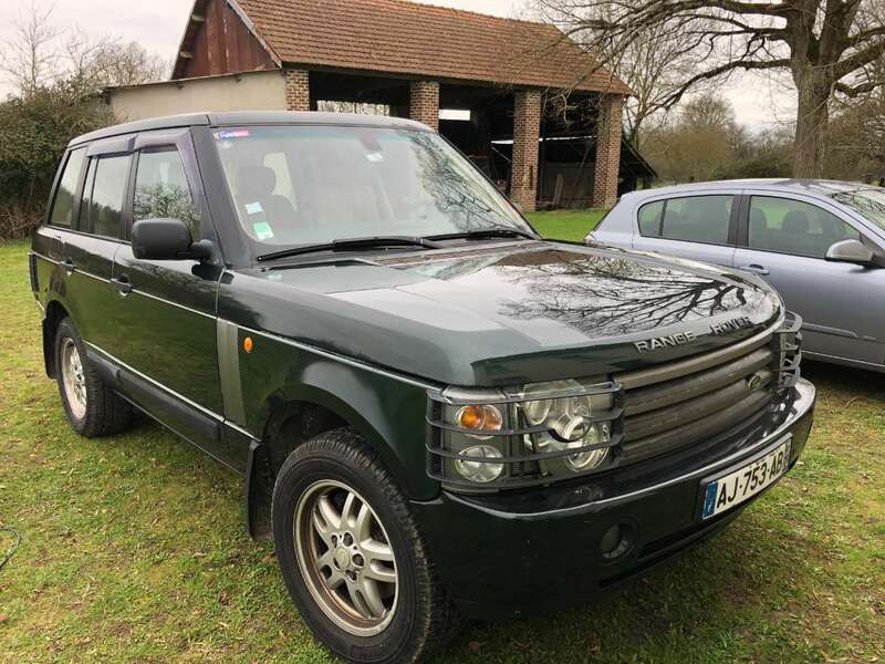

A good start to the new year, an actual reduction on the fleet! After advertising the two Disco 2s on facebook, I had the usual flurry of idiots asking questions to which the answer was then ignored. Another made an offer for both, which was accepted, arrangements made fo collection followed by radio silemce. Two people came to look but they wanted new ones for less than a grand. Eventually, yesterday a sensible bloke made contact, turned up when he said he would, looked the blue one over and gave me some cash. i lost a fortune on it but at least it has gone!

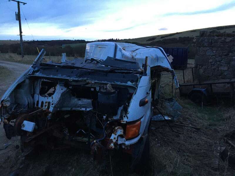

The last few days I have been rehoming the old Iveco van, which I am sure will please @Cavcraft as this is the new home:
First the doors came off
Then the roof
This resulted in a lightweight racing Iveco
The aforementioned ice has resulted in a lack of traction so progress has halted, but it is getting there at last. I have learnt that Iveco vans are heavily reinforced and this is the first and last time I decapitate one!
