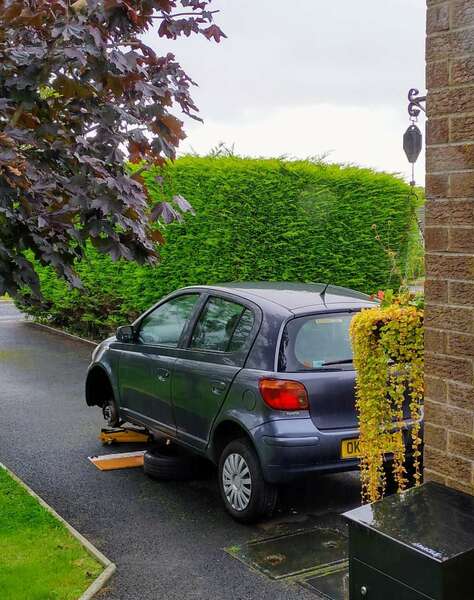

Okay, so - second verse, same as the first.

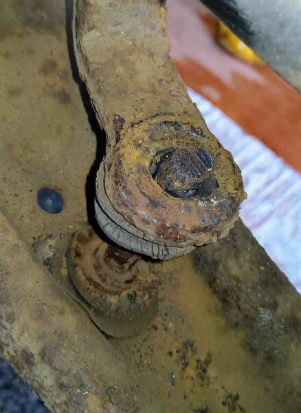

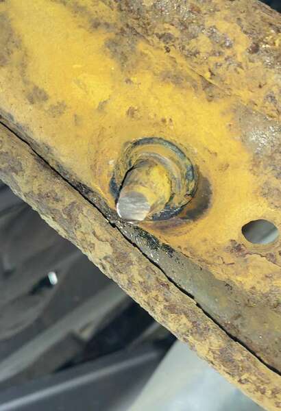

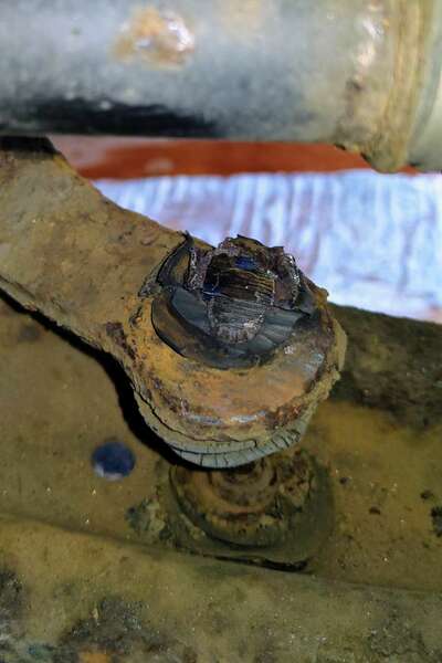

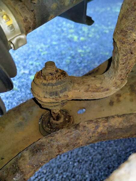

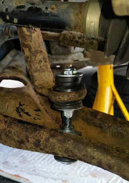

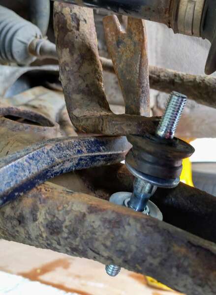

The link on this side is undoubtedly in a heinous state, but not yet utterly ruined.
And on this one, it's vaguely reassuring to see that the lower cup washer is sitting at about the same angle as the one I fitted last night.
It's not quite equal all round, with the front raised up anyway.

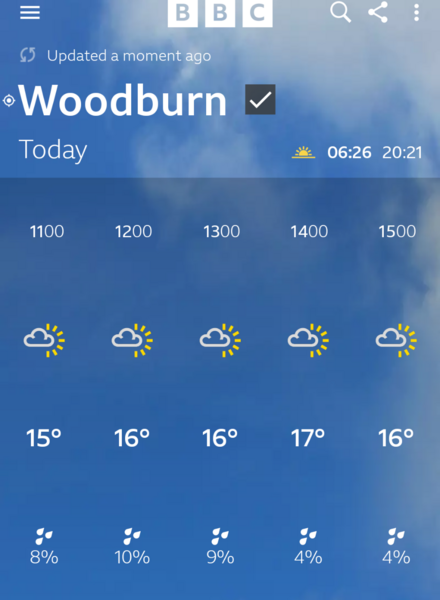

And so, despite a fairly upbeat weather forecast...
It's now started lashing out of the heavens.

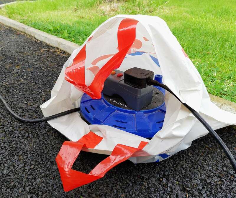

Work involving electrical extension reels and angle grinders is hereby postponed until dryness resumes...
I fear another bout of arse-sogginess is coming my way.

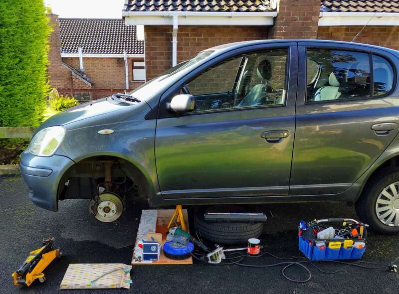

The other droplink is finally on.
I mean, it probably needed doing.
But for much of the afternoon, I've been kicking myself for managing to immobilise the car completely by carrying out work that wasn't strictly essential, thereby jeopardising the whole MOT.

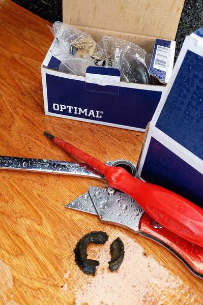

Things started off fine, cutting away the old bits of rubber to make it easier to get the angle grinder in there.
I find it a bit more awkward working this way round, for some reason, but progress was being made.
And then, of course, the rain started up again.
Marvellous.
HSE APPROVED TO IP65 STANDARD M8

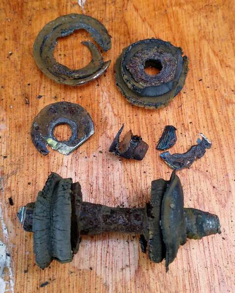

Much sparkage, and plenty of acrid rubbery smoke later...
Well, good stuff.
And a bit of jabby-jabby with the pliers persuaded the rest of the rubber to come on out.
Getting at the lower end of the link was more of an annoyance - the car wasn't lifted particularly high, and I had to get my face rather closer to the spinny blade of death than I otherwise might like.
MOAR PPE NEEDED
I'm quite sure this forestry mask wouldn't do a lot to help in the event of white-hot bits of disc shooting out at me, but it felt like the more layers between me and instant maiming, the better.
So that came off too, with somewhat less effort, and in the event no-one was maimed.
Grim.

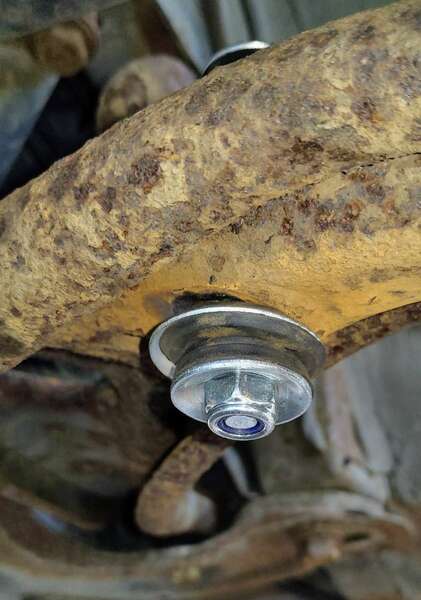

Still, that was the hard bit. Getting the new link on was the easy bit.
Or so I'd thought.

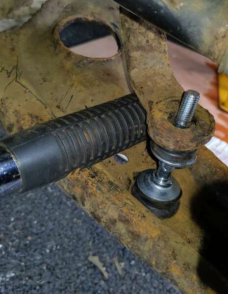

For some reason, pulling the ARB up to give clearance to the link spindles was rather harder than it had seemed yesterday.
Levering it up resulted in the lifting bar slipping just as I was easing it into position (mashed finger #2), and this jolly game continued for rather longer than I'd have liked.
A short bar couldn't give enough force to lift the arm high enough, while a longer bar hit the ground before clearance was achieved.
Eventually, I was forced to return to the exciting pics from last night to figure out what I'd done.
Ah right.
Apparently jamming the rubber end of an extendable wheelbrace is the way to do it.
And it did it.

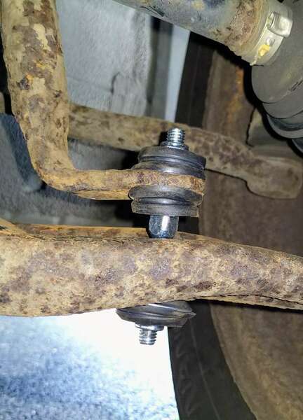

The scent of victory now in my nostrils, all I needed to do was whack on the locknuts, add the wheels and drop it.
Top nut was fine, but the bottom nut...
No.
Not having it.

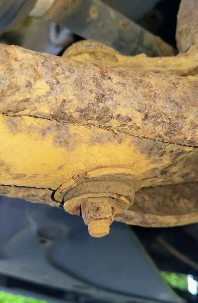

I just couldn't get enough threads on the lower half exposed to get the locknut to catch. I spent hours trying to compress it, trying to soften the rubber bushing in hot water, attempting to press the nut up tight to the threaded shank using the trolley jack beneath a wrench (hey, I was getting desperate).
Still the damn thing wouldn't catch.
I stamped, I swore, I threw things.
I watched a plethora of YouTube videos showing smug, dry people with tidy garages just popping the nut on by hand and giving it a quick spin before taking a ratchet spanner to it. Easy as that.
But it was not easy.
There just wasn't enough shank protruding out from the sandwich of two metal cup washers and a thick rubber bush.
My efforts became more unhinged.
More and more tools became drawn into the campaign, tools that had no business anywhere near a car - plumbing wrenches, woodworking clamps, tiling tools.
Still the bugger would not catch.
It was like the shank was too short.
But then - the other side went on okay.
You'd almost think there was something different about this side.
Like someone had driven it at low speed into a verge one snowy morning in 2014, doing some damage which didn't look that bad but had creased a few vital things.
But of course, that had never happened.
Eventually, while yelling like one of those World's Strongest Man competitors, I managed to compress the rubber bush with my mangled fingers just enough to get the end of the nut to catch.
Nearly sobbing, I nipped it up until the nyloc bit in.
Yeah, that took me about three hours.
These jobs should not be so difficult.
I chucked the wheels back on, dropped it down off the axle stands, and nipped the wheelnuts up good and tight.
An inspection at ground level indicated that they were actually fairly level.
I used my torque wrench to try to set the accessible lower nut to 13Nm, but couldn't get it to register and was worried about damaging the rubber through overtightening.
The YouTube smugglets didn't mention torquing it up, anyway.
Other side done, and we were finally going for it!

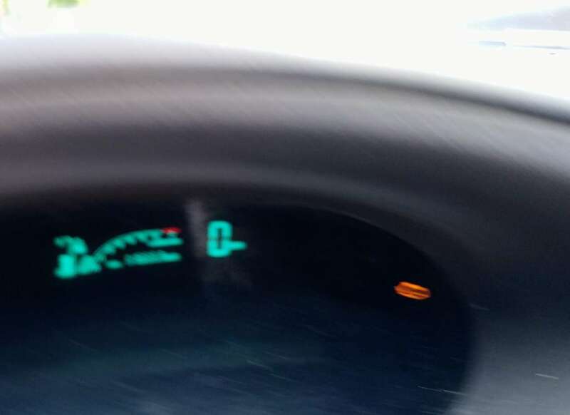

The EML's back.
Unlike before, it's not staying off for a while after being cleared.

The EML did not illuminate this time when I got into the car and drove off for my date with destiny.

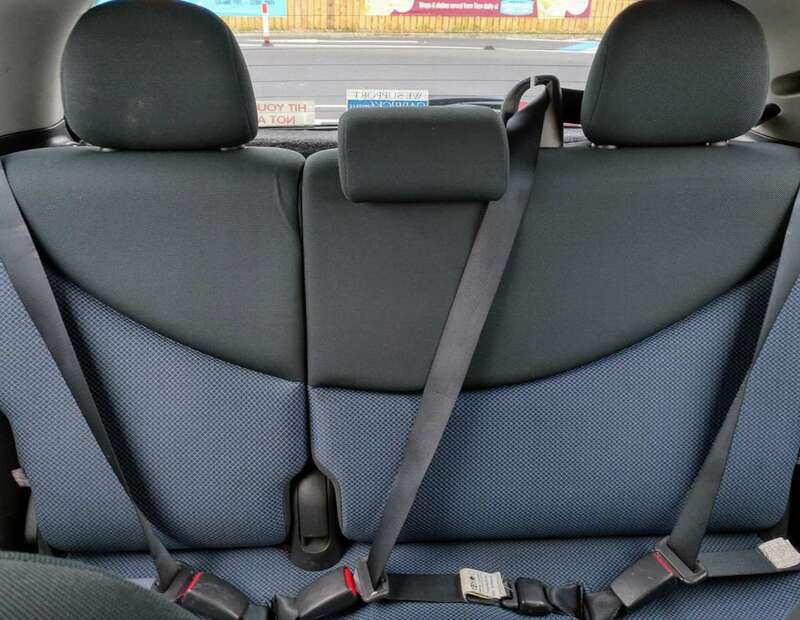

I also remembered to clip the seatbelts in at the back, since I get a feeling this somehow curries favour with the tester - as they don't have to guddle around down the back of the rear squab for the lap belt clip, and get all covered in grot and old sweetie wrappers.
I believe this to also be good.

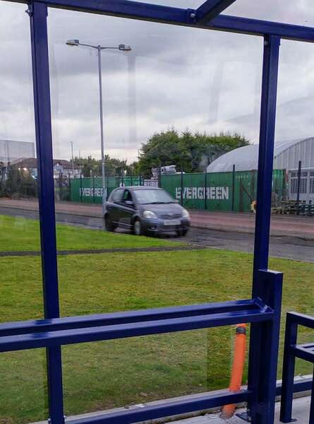

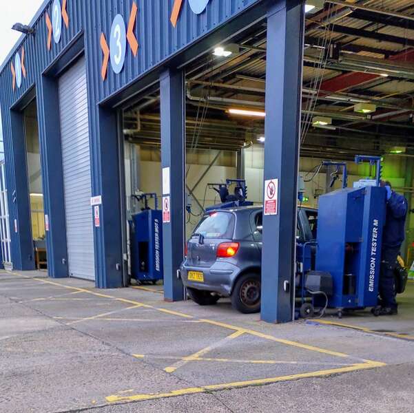

The tester did pip the horn on the way in, and it worked - which was good, as I hadn't checked it earlier...

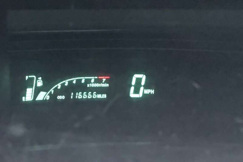

EML still was still remaining OFF when I hopped out... but is this an auspicious mileage?
Pre-Covid, you used to have to go through the test centre with the tester - them driving, you in the passenger seat like a muppet. Then you got to go and sit on a little chair at the side while they hoicked it up on a ramp, and all the testers gathered round to laugh heartily and knock bits of car off onto the floor.
Actually, that last bit was usually just my cars.
But now the punters have to stay outside, in a Greenhouse Of Shame, to prevent spreading lurgee.
There was an 02 plate Volvo V40 in just before the Yaris; and it's just come out.
It had a two-page fail list.
Oh lumme.
I'm next.
  • Like 8
INCOMING
Daaaah.

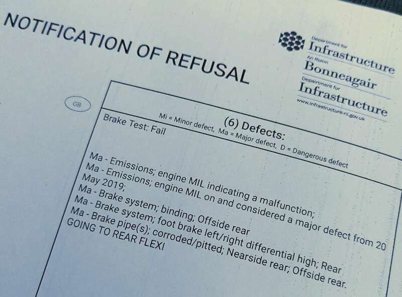

Okay, not ideal.
But not too bad.
The bloody EML must have popped back on during the test. Shitbiscuits.
The brakes at the back are binding, hence the imbalance.
I swear I had the back brakes fully rebuilt not that long ago, with new drums and everything, so I dunno what's going on exactly.
But then that could have been five years ago...
Meh. But still - coulda been worse.
Home to lick my wounds, then...
And then - I get to do all this again in a fortnight's time!

Commiserations on the fail, but either way that doesn't look like a bad little list really.
On the P0117 error code, what is the reading given by Torque? Presumably it is correct?
Googling says these are the reasons it throws it on:
So either wiring shorting or the sensor is dodgy.
