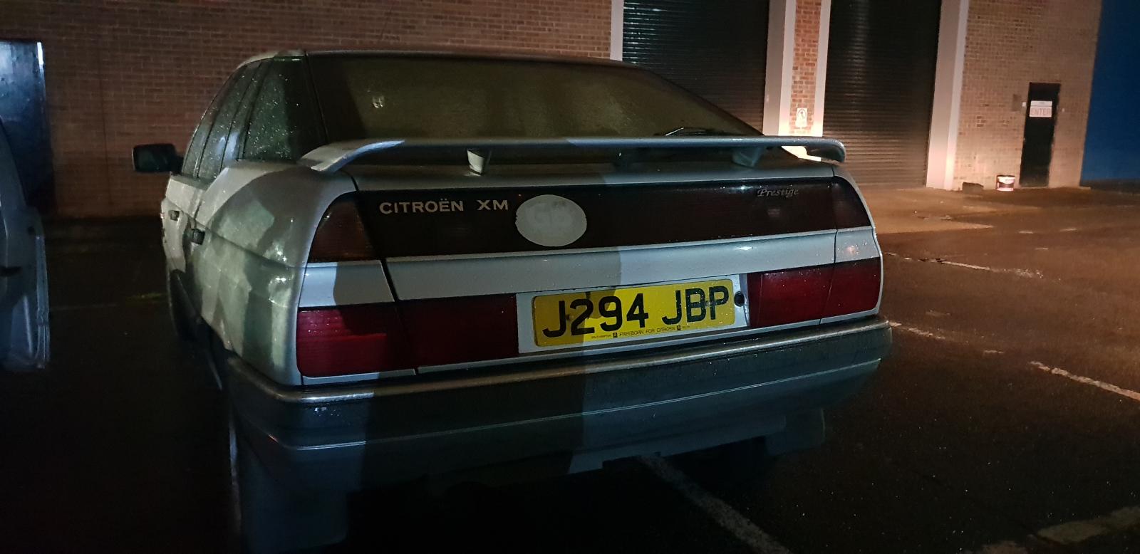

So as alluded to elsewhere, Wingz went and collected an XM from North London for me yesterday.
The seller had spent ££££ buying it, only to then decide he didn't like it as much as he'd hoped, have the water pump fail, and someone use it as a reversing aid in a few weeks. It was offered up for £300 on the CCC FB page, and at the time I'd decided I did want an XM, but ideally a diesel.
A few days ago, the seller posts again. No one had committed to it yet and he was going to scrap it if it wasn't gone soon...
Okay, it's got issues, but then I realised that even ones at the top end of my XM budget probably would.
He didn't even want any money for it, but I insisted paying him something, so £100 was agreed.
AFAIK, the Prestige was a very high spec car when new. Full leather, electric seats, that privacy glass in the boot...it's just a NA 2.0 Auto but in the time I briefly drove it, it didn't seem bogged down in weight.
Now at the local garage for assessment and repair quotes. I did notice the ABS light was on, which could be a dodgy or dirty sensor. I had a curious look on Chevronics website for new ones....ouch.
I did think it might need welding as one of the sills had been scraped along a kerb, but in the dark last night it just looked dirty.

Garage just rang. Definitely the water pump being the leak, they reckon it's been leaking for ages too.
It does have holes in the outer sills that need welding too...
Otherwise not too bad. I've found a gates kit to give them to use, so I'll order that. The ABS light was mentioned too, does anyone know what causes it to come on, is it likely grubby or a broken sensor?
XM ABS sensors are painfully pricey. Leave that for now.
Depending on where the sill is, it may not be structural but will need doing for the MoT.

I am hoping its just dirty....but hey, again it's just about within budget to sink the £216 (!!!!!!!) Chevronics want for a sensor if needs be.
Anyway, found a Gates kit online, so ordering that and garage will fit it all. I rang them back and said lets just get it done, at the end of the day it was £100 and spending £££ (or even ££££) is much more tolerable than one costing 10 times as much, am I right?
Jesus £216 for an ABS sensor is gonna hurt, I would defo say wait till the last possible minute before buying that mutha!!
If you are adamant it is a sensor, get it in the air, wheels off and measure the resistance of each sensor with a voltmeter so as to spending such a collosus amount on a sensor if it is not needed....
My one piece of advice after saying, well done in getting an XM they are great, anyway advice is this .... buy a Lexia diagnostic kit and an old laptop. It is very useful when you own these kinds of Citroen.
As for the abs, have you checked the readings at the connection points in the sensor loom? It can be corrosion in connectors or break in wires rather than the sensor itself.
