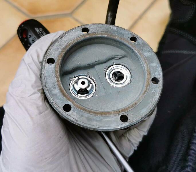

Tentatively calling this one resolved.
Had a look earlier on today and there was definitely an eccentric on the cam, and it looked to be intact from what I could see.
The arm on the pump looks to be fine.
Bit of wear but nothing I'd expect to cause issues functionally.  No plastic end piece or anything on here on any of the new pumps I saw on sale so I don't think anything is missing.  I do wonder about a spacer on the block as it really would help with heat management, but looking at how the rigid fuel line lines up it doesn't look like there was ever one there.  Plus I can't see one in any of the diagrams I have.
A bit of experimentation continued, and I discovered something.  The pump would expel fluid through the outlet with great enthusiasm - however what it wouldn't do was suck anything in through the intake.  Leaky valve...
Said valves were changed when the pump was rebuilt - that was a pig of a job without a vice to hold the pump body in as removing the old ones eventually required quite a bit of violence.
What did I eventually discover on closer inspection?
A bit of bloody dog hair wedged in the suction side check valve.
I blame my "helper" who was assisting me during the rebuild process.
With said hair removed, the pump reassembled (again), and refitted (again) I'm glad to report that we had a proper flow of fuel at the outlet again.

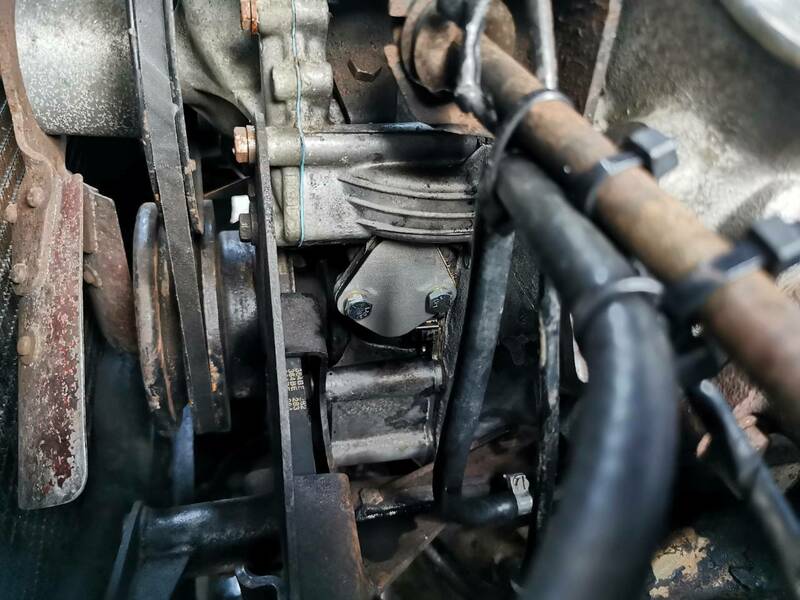

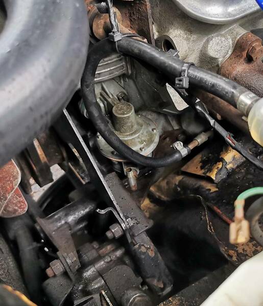

You know I called that fault resolved?  Yeah... about that.

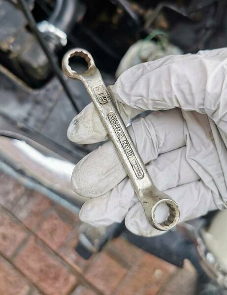

First thing today I wound up swearing at the fuel pump again as I discovered that it was now leaking from the base gasket.
Thankfully it stopped once I got in there with a stubby wrench and got a little more tension on it.  Without having to remove it from the car yet again.  A job I am thoroughly fed up of doing!
With my confidence boosted by yesterday's good running we went out to drop off a whole bunch of oil at the recycling centre.
Aside from the temperature getting higher on the gauge than I would have liked before the stat opened (the joy of aftermarket parts?), things were going well.
Right up until about 90 seconds after that photo was taken.

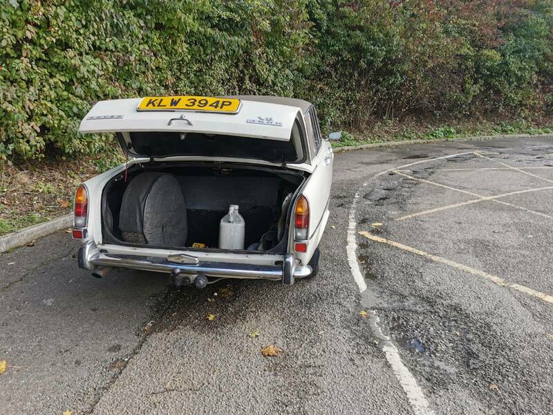

That "fixed" fuel pump has only gone and completely stopped pumping now.  Previously when it was playing up I was still getting *some* fuel, so you could nurse it along even when it was acting up.  Today, nope.  Nothing.  My guess is that I'm going to find that one of the valves has unseated itself.  That however is purely going to be to satisfy my curiosity, it clearly just doesn't want to live, so that pump will shortly be getting chucked in the scrap metal bin.  Not without a certain degree of vindictive pleasure I might say given how much time I've wasted on it.
Electric pump and blank off plate have been ordered, along with a few other bits and pieces.
Thankfully a friend of mine only lives a few minutes away, so salvation arrived driving a Nissan Pixo and gave me a run back home (seriously, I was like five minutes drive away) to grab a couple of things to hopefully get me going again.  Especially as recovery was estimating about two hours of a wait.  Made it clear to the operator that we would be trying to get the car going in the meantime, and would call them up to cancel recovery if we were successful.  I also asked for them to get the recovery agent to give us a call for an update before actually dispatching.
Grabbed all of the testing setup from a couple of days ago - which thankfully I hadn't reattached to TPA yet.  One very quick and dirty get-me-home bodge was thrown together.
Janky as all hell, but it worked.  Car didn't miss a beat on the way home.

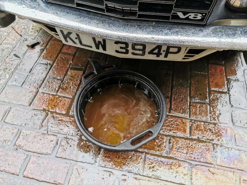

However the overwhelming stink of raw fuel whenever even vaguely near the P6 told me that the mechanical fuel pump was likely leaking (again).  Discovering upon checking, well over a gallon of fuel in the drip tray meant this was something I couldn't just leave until the weather got better.
Especially given looking at the forecast it looks like that will be sometime around June 2024.
So in we went.  Again.
This utter pain in the tail has now officially been permanently relieved of duty.
Well, aside from plugging the hole in the block until the new pump and the blanking plate get here anyway.
Temporary electric pump has now been secured reasonably solidly by attaching it to the washer bottle with several zip ties.  I'm not proud of it, but it's only going to be in here for about a week or two and it's not going anywhere.
Also brought some sanity to the wiring - which literally was just stuff I had grabbed from the box of random bits of wiring to test the theory that I had issues with the mechanical pump a good few days back.  I'll be completely redoing this for the new pump once it's installed (and I figure out where power will be sourced from), so I just chopped off the excess and routed things a bit more sensibly for now.
Oh, and added a fuse - which makes me somewhat less nervous.
Apologies for the duct tape.  Didn't have any insulated connectors on hand and given it was absolutely tipping it down when I did this, getting out the heat gun and necessary extension lead to run it seemed a poor decision...so duct tape it is.  Note again, this is a short term workaround, NOT a proper fix.  It may end up getting attacked with heat shrink tubing anyway as it's making my teeth itch.
At least as things stand it's in a state where the car can safely be run like this until the new pump is fitted and even more importantly is no longer actively leaking fuel.

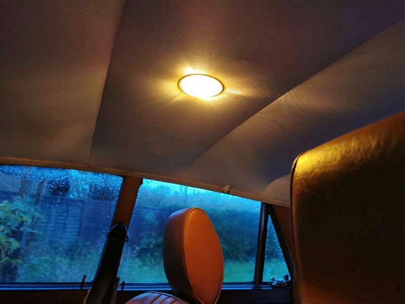

Speaking of lights, this one randomly decided to start working again today.
It's not worked on either of the door switches until today.  I like self-healing faults!

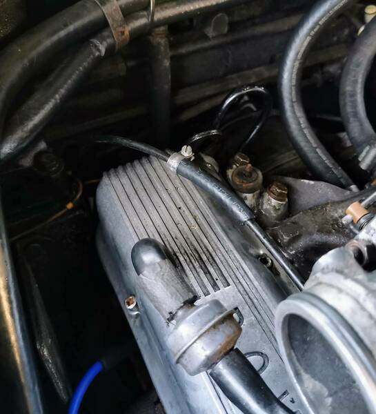

The mechanical fuel pump has now been removed and the blanking plate installed.
I found a convenient hole in the inner wing to mount a bolt to (looks like it was originally intended as a wiring pass through - guessing for the marker light which would have been on the wing on US spec cars) which has basically decided where the new fuel pump will be living.

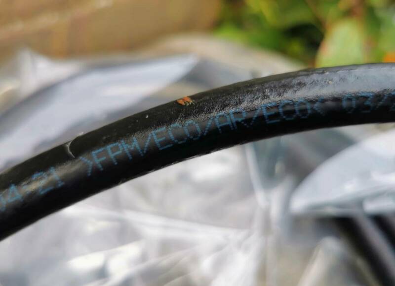

The hoses need to be redone, particularly the discharge side line to the carbs as it's now too short.  That one is an old line that came with the car anyway so would be getting replaced as a matter of course - I just don't currently have any the right size in stock.

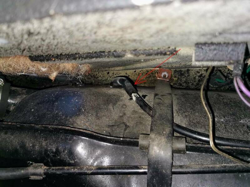

The immediate problem though is a clogged tank return line - and short of replacing the whole thing (which is most likely what will eventually be necessary) I'm not sure what to do about that.  As with everything else aside from the bit between the fuel pump and carbs, this is all made in nylon and metal lines.  I have tried the obvious thing, blowing back through it with the air line, and 115psi air didn't even touch it, so it's a pretty solid blockage.  I've also tried rodding it out at the engine bay end (as the line does make a near 180 degree bend immediately so I was hoping that might be where the issue was), and it's definitely clear for a couple of metres (the longest bit of stiff enough wire that I had to hand).  The lines are easy enough to access under the car as everything is in one bundle that runs along the offside chassis rail until they vanish upwards somewhere in the vicinity of the rear axle.
I pulled a couple of the trim panels inside the boot off to see if I could clearly see where the lines went - the answer being no.  However I did discover more work I'll need to do.  I'd commented on a couple of occasions that for a 70s British car that I had found the wiring in this thing to contain a surprisingly small number of bodges.  Apparently I need to revise that to clarify that the *front* of the car is surprisingly free of bodges.  The rear, not so much.
Given the telltale holes in the parcel shelf, we know that there's been an aftermarket audio setup in here at some point.
I'm hoping that between that and the tow bar most of this hackery is accounted for and as such will be pretty easy to tidy up/re-run as necessary.
That green wire that's been cut and is just flapping around in the breeze between the fuel tank and trim panel is green with a brown trace - which I believe marks it as the feed for the reversing lights.  Which would definitely explain why they don't currently work.  I remember it being mentioned that there had been issues with the tail lights on this car in the past so finding this wasn't entirely surprising really.  However it's a job for another day as I've neither the time nor energy to go chasing that any further today.  Sure with a bit of time, a wiring diagram and a multimeter we can make sense of it.  I'm sure once I've deleted obsolete speaker feeds and the dodgy looking tow bar wiring it will make far more sense.
Unfortunately you can't (as far as I can see) get to the feed/return lines on the fuel tank from in the boot.  Guessing that's an under-the-car job then...Yay, that will almost definitely ensure that I get a face full of unleaded while investigating things.

Starting to feel *slightly* more human today so spent a few minutes poking the fuel return line issue.
I'm assuming that there is an orifice somewhere in the return line to ensure that there is sufficient pressure delivered to the carbs.  The absence of anything at the engine end to that effect leads me to believe it's probably at the tank end.  Most likely in the arrowed fitting.
Looking at that more carefully, I see that it's actually feeding the fuel back to the tank via the feed for the reserve pickup.  Actually not a bad idea...it saves having to have another pass through into the tank, and should also help prevent debris from gathering around that outlet.
Now I know I have good flow through the reserve outlet from the tank, so that's fine...the issue is going to be likely in that metal line going into the fitting.  Which I've confirmed based on a couple of photos does need to be accessed from underneath the car.  So that's going to be quite a faff - as I'd be willing to bet good money that the back axle is going to be precisely in the way.  However it needs to be dealt with.
As a workaround in the meantime I *may* be able to cobble something together using one of the vent lines.
I have tried applying vacuum to the line as well in the off chance that it may be able to pull anything back out of it, but no dice.  So we'll need to continue doing some battle with it.

Fuel line I'd ordered arrived this morning to replace the rubber lines up front on the P6 which are unlikely to take kindly to ethanol.  These on the other hand shouldn't care.
Bought through Glencoe.  Not the cheapest, but with so much counterfeit stuff floating around and all of the motor factors I've found so far just selling at best R6 rated hose, just seemed the safe option.
Fuel line routing has been tidied up a bit.
Not saying I won't revisit it in the future possibly, but that will be some day when I'm feeling less under the weather and it's not looking as though the heavens are about to open.
That jubilee clip on the top connection on the pump needs replacing with a proper fuel hose clip aside from anything else - I just couldn't find one in my stash the right size.
Had a look to ascertain precisely how awful access to the fuel return line was at the tank end today.
Well at least I've now found it!
Lines from left to right are return, reserve and main feeds.
Access with the car on the ground though is basically non existent.  Our target is basically in the centre of this photo.
I do not fit through that gap.
Think with the car on the ramps it should just about be doable, albeit still bloody uncomfortable I'm sure!  Alternative I'm pondering is jacking the car up and pulling the offside rear wheel - not sure if that would give us sufficient access.
The plan such as it is at this point is basically to crack that connection off and see if fuel comes out.  If the answer is yes, the blockage is in the line between the engine bay and the tank - if not, hopefully we can clear it by poking a bit of wire into the fitting.  Failing that, I'll need to get a whole bunch of fuel cans and drain the tank so I can pull the whole lot out to attack off the car.  Sure that will be a barrel of laughs.

This is a job which is inevitably going to result in the spillage of at least some petrol - so doing the work from a position where it's landing next to me rather than directly in my face if possible definitely sounds more desirable.  It doesn't half sting if it goes in your eyes.  Being able to deploy a catch pan under the car is a bonus too, I obviously can't do that if I'm where the pan really wants to be.

Turns out there are two breather lines attached to the tank, I'd not spotted the one to the left.
Some quality metal work by whoever put the speakers in evident there too - which I found when I stabbed myself on it.
Turns out that the breather line on the right is blocked somewhere.  The tank fitting is fine, but I can neither blow through nor suck through the line which vanishes into the car.
The one to the right on the other hand is properly open to both atmosphere and to the tank.  This arrangement is quite different to the setup shown in my manual, likely as this is a later car.
I think based on the fact that we clearly do have one working and emphatically not working breather, I'm just going to make my life easier and steal the tank port for the clogged one entirely for my return line and to cap the breather line off in case they are connected together elsewhere behind the tank and it ends up being a route into the boot for fuel vapour or raw fuel.
