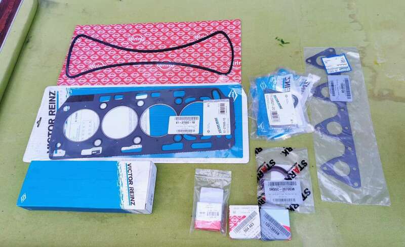

Couple of packages were waiting for me when I got home from that little afternoon exercise in getting sunburnt.
Carb rebuild parts for the Rover.
Also the remaining head gasket parts are now here for the Renault.
Already had the timing belt kit in stock so that's not shown here.
Hopefully get stuck into that in the not too distant future - but the Rover is getting sorted first.  That will be tomorrow afternoon's task most likely.

If things go well over the next couple of days, getting stuck into the Renault's head work will be the next big job.
