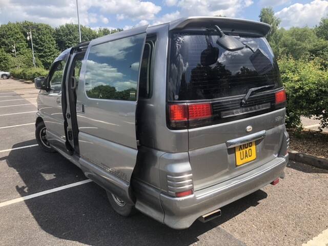

That was a nice stroll.
Luckily enough, there was actually a vehicle for sale so we decided it would be rude not to.
We are now enjoying* an overpriced Ginsters in the car park at Clackett lane services as everywhere is shut other than that well known, Michelin starred purveyor of fine quality pastry snacks, W.H.Smith esq.
Living the Autoshite dream here, chaps...
PS spot the big feck off rectangular exhaust outlet.....not only for show but attached to a bloody great stainless system that makes the most hilarious sounds whilst the 350ZX engine propels you towards the scenery ??

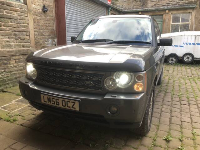

Anyway, I digress. Whilst nattering about all things Land Rover, I may have mentioned I was in the market for a cheap RR.  ‘That one there is my dads old one...he may be selling it’ said the chap. ‘Hang on, I’ll go get him.’
Ten minutes later, they started emptying all their stuff out of it whilst Mrs NM and I retired to the nearby Tesco for a quick coffee and sandwich before returning to complete the paperwork.
So, welcome to the dearest set of Defender seats you’re ever likely to find....
It’s an 07 Vogue 3.6TDV8 with the later six speed ZF auto box and 270odd BHP to play with.
In shite defence, it was very cheap indeed due mainly to the slightly* dog eared paint finish in places, mainly on the roof but also a bit on the bonnet and a couple of doors, where the top coat has lifted in spots after a respray 8 years ago.
Mechanically though, everything seems ok...the dad did a full engine rebuild last year including new pistons etc after a turbo let go. It’s since been used daily including a trip to Austria and back with no issues, everything works including the air con, there’s absolutely no sign of corrosion anywhere at all including the underside, it’s never failed an MOT and the interior will clean up very nicely with a bit of elbow grease.
The plan is to give it a bloody good clean then run it for six months or so. Assuming nothing falls off, it’ll then be into my mates paint shop for a bit of a tidy up or even possibly a wrap which may turn out to be more cost effective.
Either that or it’ll fail in a spectacularly expensive way at which point I’ll admit defeat and go buy a Santa Fe.
I’ll endeavour to update this thread accordingly as to how viable it is to run one of these things on a Ford Focus budget.
WCPGW?
PS It also has the obligatory Xenon lights for burning the retinas of the poor bastards in front in true ‘get out of my way’ fashion...

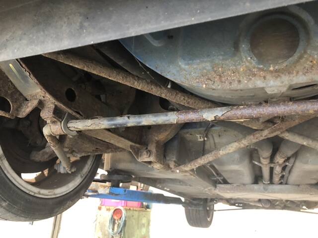

Had a bit of spare time this afternoon so I stuck yesterday’s arrival up on the two poster to see what we’re looking at.
Badge of much forward momentum...
Exhaust of much excessive noise...
Time to order a new bottle of Vactan...
It has the all important stopping devices...

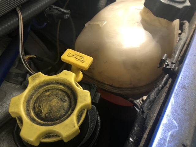

The coolant is still there after a somewhat spirited trans pennine jaunt yesterday afternoon...
Although we were limited to 4th gear, almost certainly because of this...
The rear gear linkage has a hell of a lot of slop. I’ve ordered an upgrade from a well known MG TF specialist mentioned on the original sales thread so hopefully once that’s fitted, the gear change should be improved no end. The cables actually seem ok so we will see.
The underside coolant pipes appear to have seen better days too so we’d better stick a pair of stainless steel ones on the list whilst we’re at it...
Josh, the previous owner, mentioned the corrosion on the sill ends and arches. There is a little there but it’s purely surface...a good clean up with the flap disc and some vactan/primer/paint should see it back to almost factory fresh...

The gear change bits for the MG TF arrived today so it was up on the ramp for a bit if TLC this afternoon.
After a bit of degreasing, we found the true cause of the lack of 5th gear...
There should be a little horse shoe shaped clip on there which has fallen off so the cable outer keeps falling out of the bracket. One has been ordered so once that comes, I’ll fit the uprated linkage at the same time.
Then, I turned to the exhaust. It’s actually the flange on the cat that has rotted away to nothing so it’s impossible to get a good join to the back box...
...so a new cat is on order too.
With the exhaust off, it seemed a good idea to start doing a bit of cleaning and rust proofing of the rear subframe...
...managed to do around half with the bit of vactan left in the bottle so had to order some more of that too. It does look better, though...
That’s about as far as I can go with it at the minute. I would have fitted the new window regulator but that will be a lot easier on the four poster in the other workshop so it can wait until Monday when I’ve had a move around.

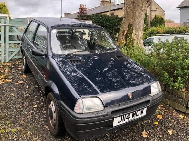

I know there’s a few Metro lickers on here...took this in p/x today...
Pretty clean at the business end...
Slightly below average mileage for the year...
It needs a bit of welding around the front jacking points and on the inner sill at one side by the rear subframe mount, as well as a very small hole on the subframe itself, which may get replaced if I could find a cleaner one. It’s a shame as the rest of it has been extensively waxoyled from new and really is like new underneath.
God knows what it’s worth but I’m sure it’ll be somebody’s cup of tea. It really is a very pleasant little thing to drive!
