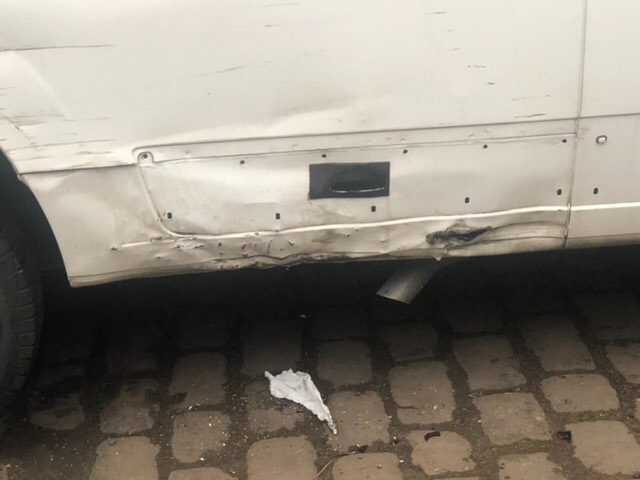

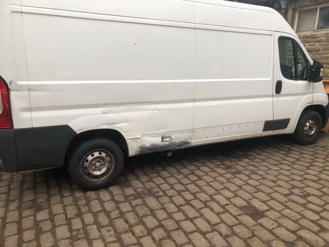

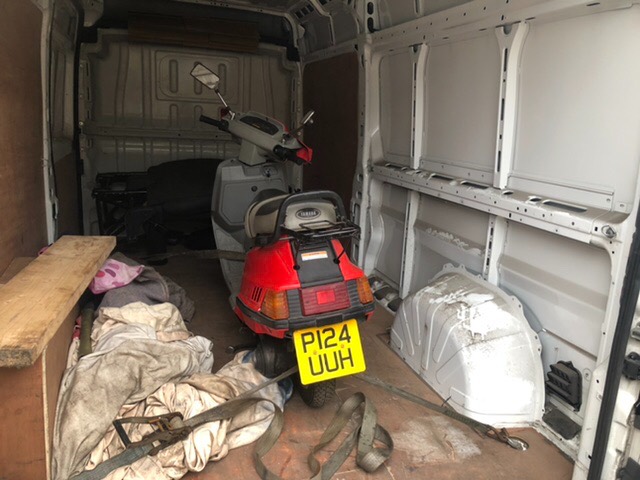

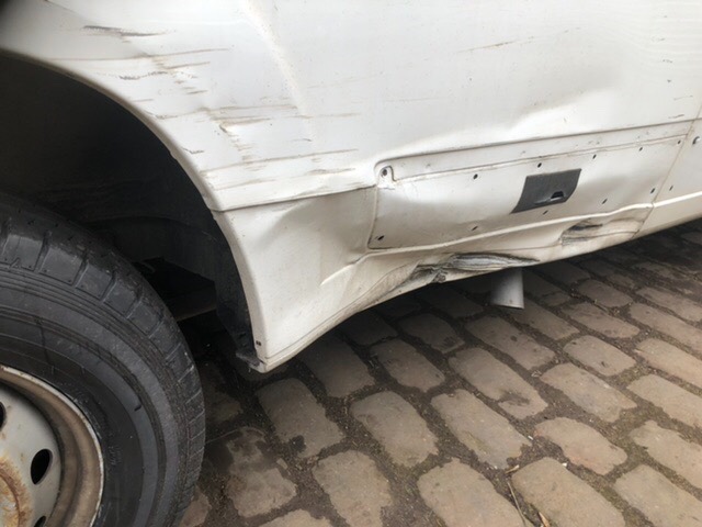

NorthernMonkey Posted March 3, 2021 Author Share Posted March 3, 2021 Decided to have a play with the van that I bought from here a few months ago. It needed some new tyres so 4 new Falkens were procured the other day and have now been fitted... Since then, it has proved itself extremely useful as a van in its own right... (anybody want to buy a scooter? 😂) However, the elephant in the room was always going to be the caved in side... Having weighed up the options, one of these was bought from Machine Mart for £95ish... ...and was today opened up and put to use... It’s by no means finished yet but it’s a whole lot better than it was. The grey in the second pic was how I’ve left it tonight with a bit of zinc primer to protect it from the elements for the minute. The van came with a replacement section of body that’d been cut out of another van. The actual structure behind the outer panel on mine however is practically untouched so I’ll probably just cut off the outer sill cover from the repair section and fit it to this one rather than spend hours trying to shape and fill the creases at the bottom. Oh yes, I got a little delivery a couple of weeks ago courtesy of @worldofceri I haven’t had time to even look at it yet other than a quick peer underneath whilst sticking it on the back of my truck. It does look remarkably solid under there but hopefully I’ll get it up to the workshop soon for further investigations. dome, LightBulbFun, puddlethumper and 10 others 13 Link to comment Share on other sites More sharing options...

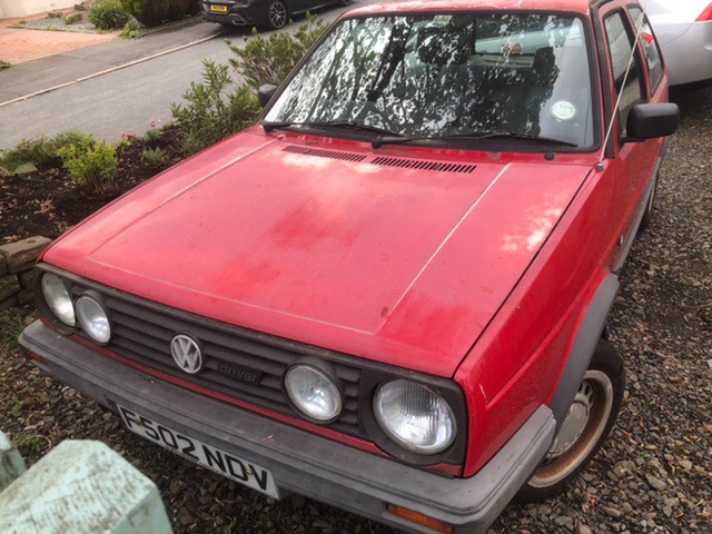

NorthernMonkey Posted May 7, 2021 Author Share Posted May 7, 2021 Saturday is delivery day....new arrival due in the morning courtesy of our resident shite shifter, @worldofceri Any guesses? It’ll be good company for Moxy... The Moog, Jim Bell and dome 3 Link to comment Share on other sites More sharing options...
hairnet Posted May 7, 2021 Share Posted May 7, 2021 YOU BOUGHT MOOGS CAMPER BUT YOU DIDNT TELL HIM YET? The Moog and NorthernMonkey 1 1 Link to comment Share on other sites More sharing options...
Inspector Morose Posted May 7, 2021 Share Posted May 7, 2021 I KNOW! I KNOW! I KNOW! I may* be cheating though as I dragged it half way up. dome, NorthernMonkey and The Moog 3 Link to comment Share on other sites More sharing options...
loserone Posted May 7, 2021 Share Posted May 7, 2021 Is it that tasty red hatch? Link to comment Share on other sites More sharing options...
NorthernMonkey Posted May 7, 2021 Author Share Posted May 7, 2021 29 minutes ago, loserone said: Is it that tasty red hatch? It’s red and it’s a hatch. Not sure if I’d describe it as tasty, well perhaps once it’s had the planned engine transplant.... The Moog 1 Link to comment Share on other sites More sharing options...
loserone Posted May 8, 2021 Share Posted May 8, 2021 AUQ? Link to comment Share on other sites More sharing options...
NorthernMonkey Posted May 8, 2021 Author Share Posted May 8, 2021 10 minutes ago, loserone said: AUQ? 😂😂 Am i that predictable? Link to comment Share on other sites More sharing options...
loserone Posted May 8, 2021 Share Posted May 8, 2021 It's what I'd put in it, should make an excellent sleeper NorthernMonkey 1 Link to comment Share on other sites More sharing options...

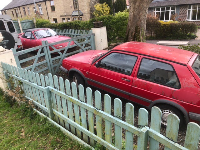

NorthernMonkey Posted May 9, 2021 Author Share Posted May 9, 2021 We seem to have a surplus of red 90s cars with a less than optimal amount of topcoat remaining. I could do to rename myself lacqu...oh, too late. Jim Bell, dome, worldofceri and 7 others 10 Link to comment Share on other sites More sharing options...

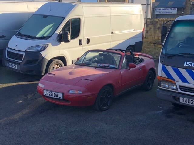

NorthernMonkey Posted January 20, 2022 Author Share Posted January 20, 2022 Today, I did a thing. I dragged out of long term hibernation the legend of the Darwen services bin area that is BAL… Following a chance discussion earlier with @The Moogabout how much fun a small, slingable car can be, I decided to bring the noisy little bugger down to the workshop with a view to a spot of recommissioning. Also, thanks to BoJo, the divine MrsNM is back in the office a few days from next week and will be commandeering the Lexus so I need transport, at least until I’ve wrangled a new turbo through a seven inch rectangular gap in the inner wing… I’m not sure what it is with the MX5. It could be the little stubby gear lever that just snicks in and out; perhaps it’s the proximity to nature with the roof down or possibly the ridiculously loud exhaust that makes old ladies at the bus stop frown? Whatever it is, the fun factor when driving it is a substantial multiple of its monetary value. Proper Autoshite?! Flat4, Dave_Q, Wack and 17 others 20 Link to comment Share on other sites More sharing options...

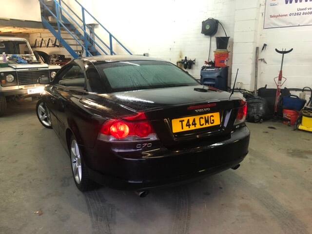

NorthernMonkey Posted January 27, 2022 Author Share Posted January 27, 2022 I decided today that, whilst the dead Range Rover is challenging to a degree, what I really need is something to properly get my teeth into. May I introduce Mrs NMs summer beater of distinction for the year… A C70 D5 sport with a random current drain and a dead roof. They certainly don’t build them like they used to…. Broadsword, Jim Bell, dome and 7 others 10 Link to comment Share on other sites More sharing options...

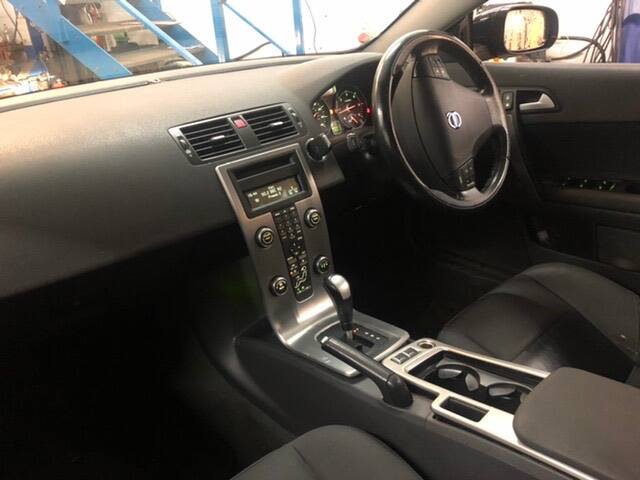

NorthernMonkey Posted January 27, 2022 Author Share Posted January 27, 2022 Nice dash, though. Straight out of IKEA. theshadow, dome, gm and 3 others 6 Link to comment Share on other sites More sharing options...

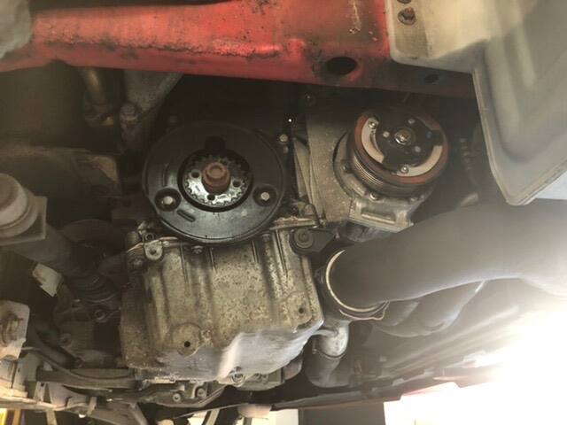

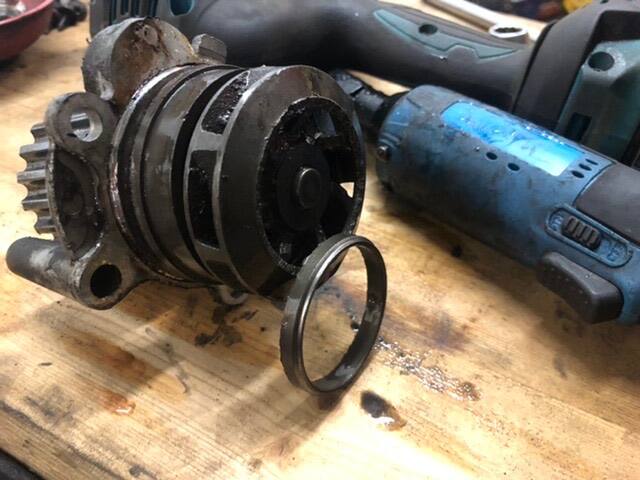

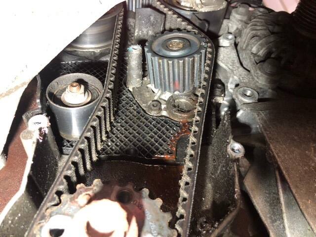

NorthernMonkey Posted February 22, 2022 Author Share Posted February 22, 2022 As posted on the News24 thread yesterday, this landed in the workshop this morning… Bearing in mind it came in as a non runner having had the timing belt let go, I first of all pulled the top belt cover off only to find the belt appear intact and nicely tensioned. Up on the ramp this afternoon for a bit of investigation… Front wheel, arch liner, aux belt and crank pulley off… Hmm, a bit of coolant splashed around. That water pump doesn’t look quite right… Nope. That has been a water pump quite long enough, I reckon… Not not that but it’s actually managed to neatly grind off a piece of the impeller and deposited it nicely in the thermostat housing! It’s testament to the awesome Bose stereo and the sound proofing under the bonnet that the previous owner didn’t hear that! Unbelievably, all the belt teeth are perfectly intact and the timing marks seem to line up ok. It’s all stripped down now awaiting the delivery of a new OE timing belt kit and water pump in the morning. Once that’s fitted and assuming it turns over ok with no locking up on the crank pulley, it’ll be time to cross everything and pray to the VAG gods 🤞🤞🤞 Mally, cobblers, The Moog and 12 others 15 Link to comment Share on other sites More sharing options...
