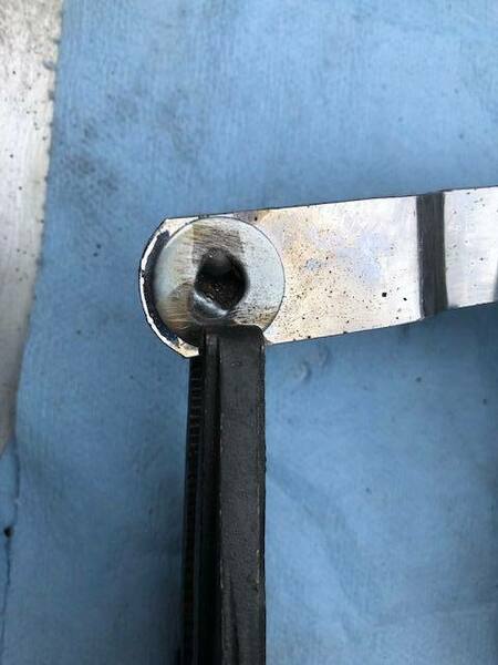

SiC Posted October 3, 2021 Author Posted October 3, 2021 Next up was Sidmouth. Then finally Lyme Regis Watched the Lifeboat do an emergency launch. I imagine someone got stuck walking between places on the coast with the tide coming in. Then the 2 hour drive back. 170 miles without a hitch. Except I decided to tighten up the boot hatch springs. Left one sheered off. Then decided in my infinite wisdom to tighten the right hand. Which sheered too 🤦 Removed them completely as I didn't want them exploding while under tension and smashing the screen. So now the boot has nothing holding it up. busmansholiday, Jenson Velcro, mercedade and 4 others 7

Tomtom Posted October 5, 2021 Posted October 5, 2021 A quality MGB fail there! Looks like you can get new studs from Moss though. Boot Lid - MGB & MGB GT (1962-80) - Boot Lid & Fittings - Body & Chassis - MGB, C & V8 - MG - Shop by Model (moss-europe.co.uk)

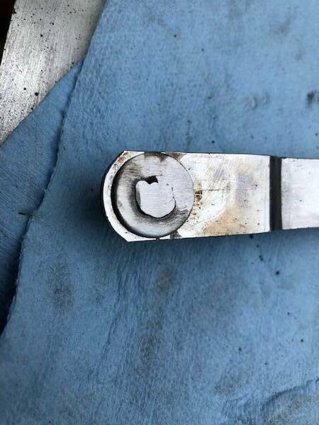

SiC Posted October 6, 2021 Author Posted October 6, 2021 14 hours ago, Tomtom said: A quality MGB fail there! Looks like you can get new studs from Moss though. Boot Lid - MGB & MGB GT (1962-80) - Boot Lid & Fittings - Body & Chassis - MGB, C & V8 - MG - Shop by Model (moss-europe.co.uk) Its item 39 Pivot that has sheered. NLA and has been for a long time unfortunately. Annoyingly it must still be made as you can buy new replacement springs. Given the price of them, I find it hard to justify spending that much for two. Instead I'm going to give welding on a new thread a go and see how well that works.

SiC Posted October 6, 2021 Author Posted October 6, 2021 19 minutes ago, MorrisItalSLX said: As an alternative to the springs, is there a gas strut kit out there that would be a direct replacement? There is but I personally think it looks a bit rubbish on a BGT. https://mgbhive.co.uk/product/mgb-gt-tailgate-telescopic-gas-strut-kit/ Requires the mounts at the bottom drilling and bolting in. I'd probably weld them but I guess they wouldn't sell many kits if they did that. To me it feels like a kit that exists for those that want to save money, more than anything else. Tomtom and MorrisItalSLX 2
Tomtom Posted October 7, 2021 Posted October 7, 2021 Good plan. I managed a surprisingly neat welded repair to mine at the top pivot a couple of years ago. SiC 1

SiC Posted October 8, 2021 Author Posted October 8, 2021 Stuck another coat of wax on. This time I did a small square instead of doing the whole thing. Much easier to polish off when it's slightly wet still.Decided to have a go fixing the boot struts.Ground off the remaining stub.Chopped the end off a bolt and then welded on it onSpent a lot of time grinding it down to make it fit. Both so it slid into the bottom piece and also so the top could turn. I did pad out the gap with washers. Right on the edge of fitting the spring on.I need replacement caps as these are all broken up.The other side I welded the stud on while in the arm. Not sure this was the best idea as ended up having it too far out and harder to weld. Was rather difficult to not catch the arm when grinding.The arm itself had worn down.Welded on a washer. Again I buggered up as should have welded on the side less visible. Couldn't put another washer on as the gap is too wide and catches the trim in the boot. Also lopped down the stud as it was too long.But the boot is now holding up. Also the rattle that always used to be in the boot has gone. Still needs some fettling as when fully open the angle isn't quite right to push down to close. Mally, Coprolalia, grizgut and 15 others 18
Tomtom Posted October 9, 2021 Posted October 9, 2021 Looks like a good job in a fiddly location. The mountings on the body are slotted so there is some adjustment available there. (At least they're slotted on mine either by design or years of wear.) The car paintwork looks great. If the BiL gets cold feet he can always say you had to phone the AA from the nearest pub... SiC 1
