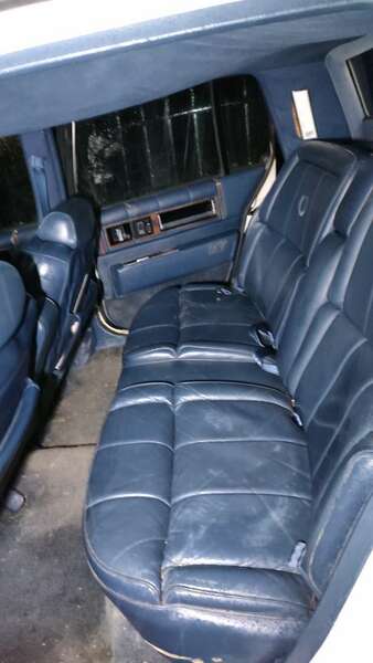

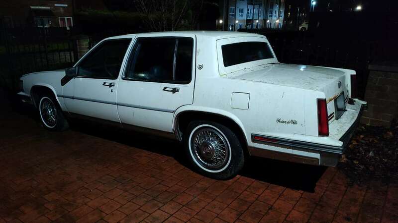

On top of that I just viewed the '87 Cadillac DeVille I posted in the ebay tat thread before. The pictures below are absolutely flattering it, it's a straight car but it's filthy and needs almost everything to be in somewhat decent shape again. A friend in Germany is interested in it, not sure if that's still the case after seeing those photos.It would easily cost over a grand just to get it shipped over to him. Great parts car for someone who owns one though. And you gotta love a blue interior.

So somehow a friend of mine is still interested in the Cadillac I viewed above despite the transport to Germany being several times the purchase price.
The seller says the car was never registered here despite a GB sticker on the back. No plates either. Is there a way to check whether a car had been imported and registered in the UK based on the VIN alone? The lack of registration documents would be a much bigger issue there than here.

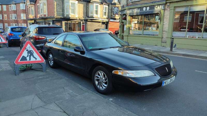

Well, with the A6 gone the black Lincoln Mark VIII is back in daily use for a little while, at least until I pick up the GS300 again. The car runs well despite having stood for the entirety of winter, a few minor things to sort however and it badly needs a clean inside and out.

Great news! The seller of my latest purchase has finally replied to my messages... Turns out he somehow didn't realize that I bought the car... Apparently he had so many messages from people that mine must have gotten lost in his inbox. This is only natural for the fine example of an automobile that I have purchased...
Of course the car doesn't have an MOT, or would make it far in its current condition so no collection caper for this one unfortunately. Just getting a few quotes for transport now, it should hopefully be here by mid next week. Feel free to go ahead and have a guess!
