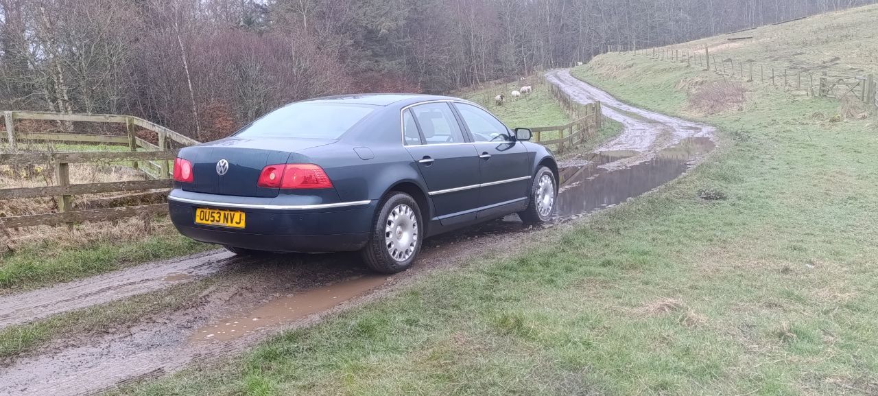

We've been away for a few days visiting the area around Jedburgh and the Phaeton was the vehicle of choice.
I mainly wanted to find out whether replacing the oil pressure switch 100% removed any related warnings and after a couple of hundred miles of various drive cycles it hasn't come back. I'll consider this one fixed and hope that the S8 will be a similar story! It means I can start sorting out the Phaeton's many little cosmetic issues now that I know I'm not throwing money into a furnace.
It was the first longer trip over a few days in it as well. As you'd expect its a great car over long distances, quiet and comfortable. I found out that it does have power folding mirrors after all (I couldn't figure them out before and they were an option on the VR6, at least in Germany). I've tried the adjustable suspension options as well, as usual sports mode changes little other than making the ride firmer. The offroad mode that raises the air suspension slightly came in very handy on the farm track leading to our Airbnb tough!
The VR6 could use more power when overtaking, it usually has sufficient power but the slightly higher than expected rpms at speed and lack of oomph when you really want it are somewhat noticeable and the real difference between this and the V8 which would be the ideal powerplant for the Phaeton.
I very much enjoy driving it though. It certainly has a stealth wealth factor (at least when it was new) that I can very much appreciate. Compare it to what it would look like to most people at first (Passats, Vectras, even A6s of the time) and it's in a completely different league, however without shouting about it.  Only the proportions would tell you that it's a proper luxury saloon. That makes it an incredibly good "normal" car.

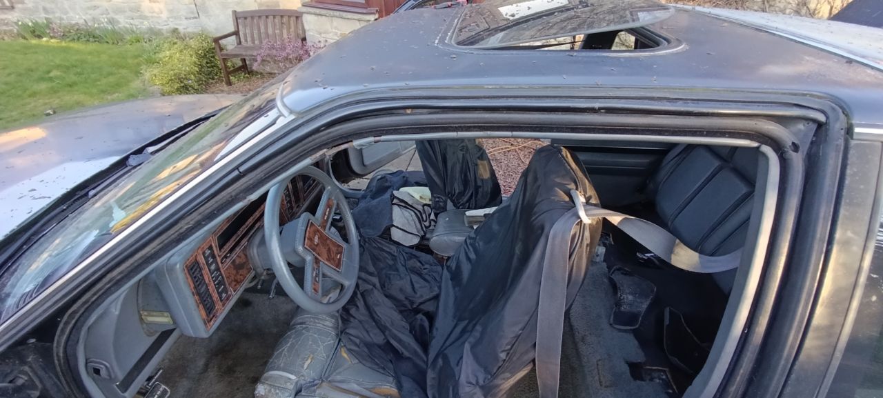

Before we left I had a chance to have a good look at the Riviera though! I reattached the passenger door panel which was taken off because the door lock was acting up, which it seems to do again despite me drenching it in lithium grease.

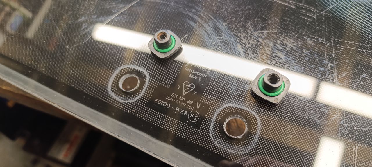

Its only a bunch of screws that really hold it on so I might have another look at that lock if I need to. The passenger side taillight was cracked so I swapped it with the one I got in Nashville over a year ago:
It's held in by two of these long bolts without any accessibility from the inside:
They came out without too much trouble, unfortunately I can't say the same about the driverside taillight bolts which someone stripped the heads on. Thats also the side I got a burnt out bulb in and I can't really see a way of swapping that without smashing the light...
The messy headliner was sorted by putting the A-pillar trims back on, naturally all the tabs were broken on them and whatever idiot removed them in the first place managed to snap the driver one in half. It looks a little tidier now at least, nothing hanging down in your face as you get in the Buick:

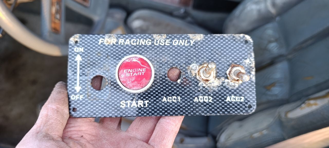

For whatever reason I found an assortment of switches that came with the car, including this panel...

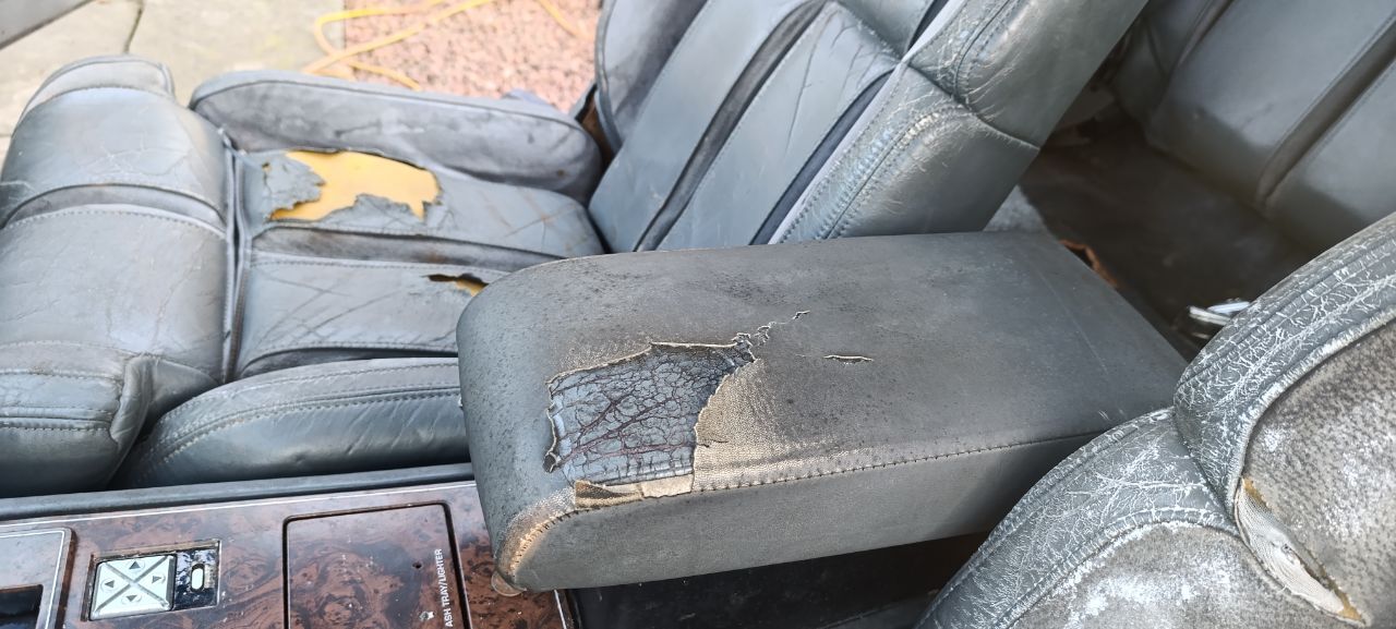

The center armrest had a cover that didn't really improve the looks. Removing it revealed another cover that also wore right through to the original layer of leather. I guess 195k miles of hard use do that. I'll see if I can find a matching replacement at some point.

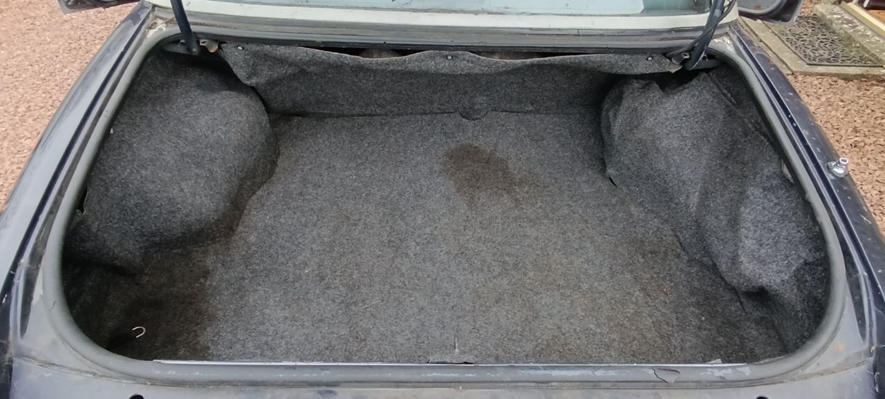

The boot was tidied and everything put back in place, much better now:
I've cleaned the interior with my steam cleaner so things are looking much better already. The list of MOT relevant/must-fix things is getting longer though (tyres, non-retracting driver seat belt, parking brake, passenger door lock, front shocks, dead blower motor - no demist, leaky sunroof etc.) so it'll take a little while. It seems to run fairly well now so I'm probably going to go for a short test drive in it tomorrow. It'll be the first time it's been driven in quite a few years I reckon!

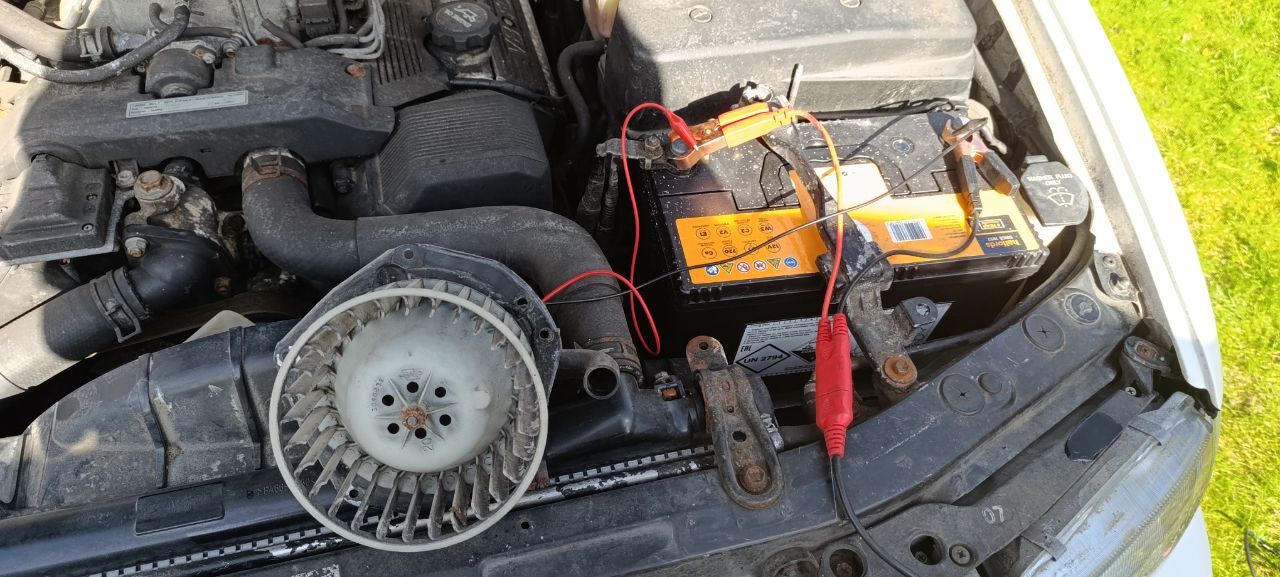

I've also tested the blower motor which, at 195k miles, has pretty much nothing of the carbon brushes left and therefore struggles to spin. You can still easily get one on Rockauto so that'll get added to the shopping list.

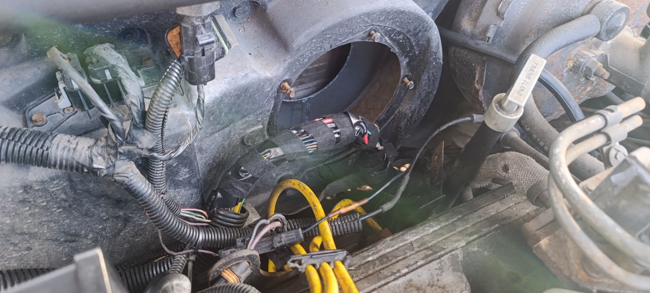

I've cleaned up the mess that was the half molten engine wiring harness as well. I replaced a few sections of wire and wrapped others where the insulation had halfway melted off. I have no idea how that happened, it really looks like it was on fire at some point! Not anymore:

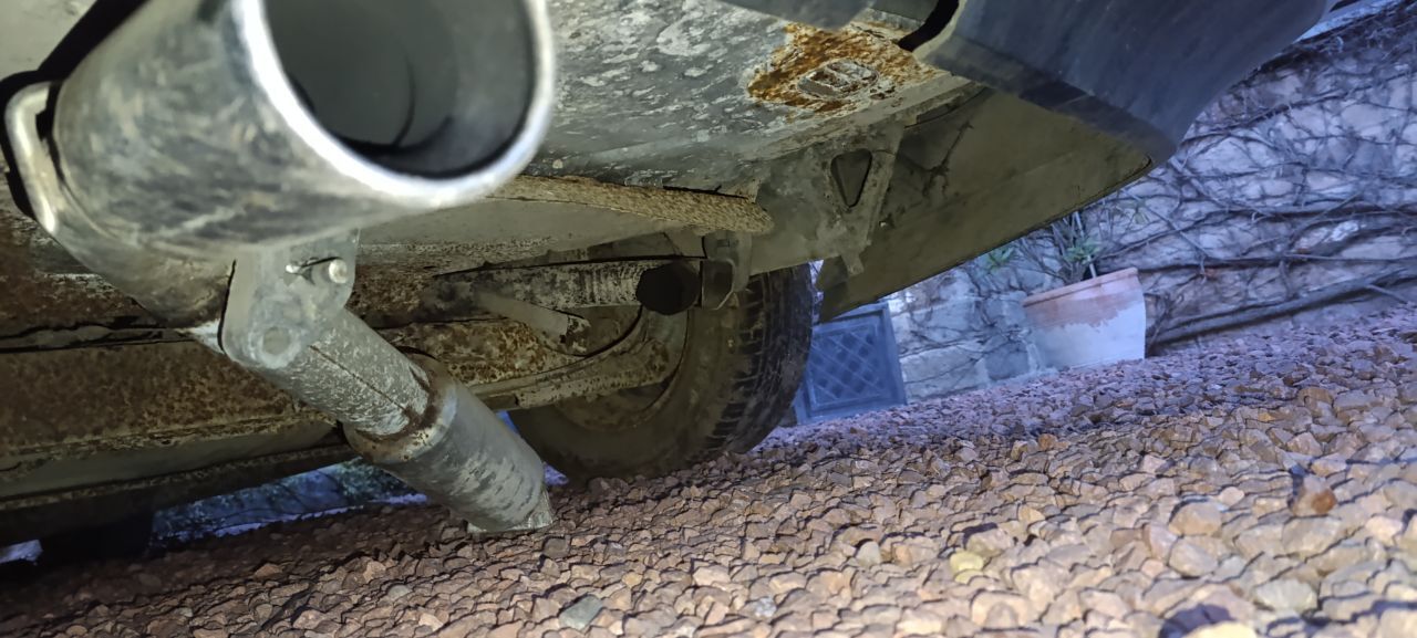

I think I'm slowly figuring out why the car was taken off the road. While trying to get it running last week I noticed that the spark was oddly inconsistent at times. I didn't think much of it as it was idling perfectly fine eventually but I now keep running into the same issue of the engine not wanting to fire at all sometimes. The fuel pressure is there, its just doesn't ignite, probably because the lack of consistent spark. Cranking it over and over eventually resulted in a loud bang, the result of which you can see here:
I didn't like that aftermarket backbox anyway... But it does confirm that plenty of fuel makes it to the engine (and out again), it just doesn't ignite. This also explains why the plug wires, ignition coil and ignition module have all been replaced already, just not with the highest quality stuff. Whether the issues I see now are down to one of these components failing again (not at all unlikely) or something else I don't know. It's just odd to me that the car can run perfectly fine in one moment and not at all in the next.

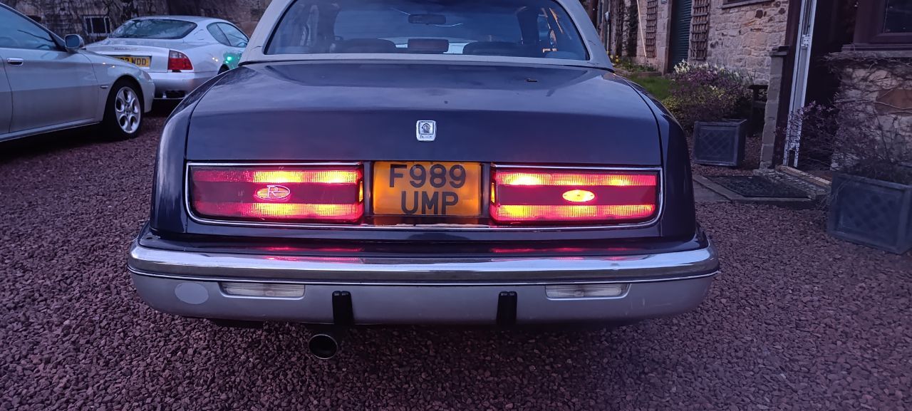

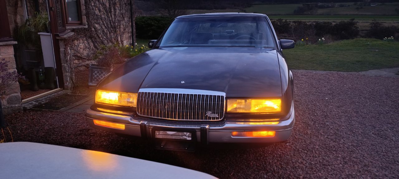

It got dark quickly so I've done a lights check:
IMG_20260314_183045.jpg.b1935d76db1bb36aafac2f112c009108.jpgIMG_20260314_183110.jpg.a9baca322048f906a682a9bd0e7220c9.jpg
The aforementioned taillight bulb will be an interesting one but at least the tail/brakelights/indicators use 2 bulbs in each light cluster. No side repeaters on the Riviera so I'm not sure how it passed a test in the past. There are side markers so I could wire them up to be indicators if needed.

Was going to say cam/crank position sensor issues for the Riviera, though thinking about it I'd expect that to kill fuel too.
Given you've already found damaged wiring - and it's not a million miles away from the distributor if memory serves - I'd be looking for a supply or earth to the ignition that's dropping out when it's misbehaving.  Give everything around there a good wiggle and see if you can make it misbehave.
I've actually managed to find the previous owner to the person I bought the car from on FB. He replaced pretty much everything ignition related, plus the cam and crank position sensor, fuel pump etc. and whatever was related to it. He dailied it for a year but I'm not sure if that was before or after he replaced all these bits.
A loose connection or earth therefore seems plausible.
I've cleaned the fouled sparkplugs today and the car ran fine again. I'll have to sort the exhaust next as it's quite loud now.😂

Worth starting with the ground point at the ECU(s) itself.  If that's iffy it can cause all sorts of mayhem.  Easy one to check and bit of grease on the lug means you can forget about it for the next 30 years then too.

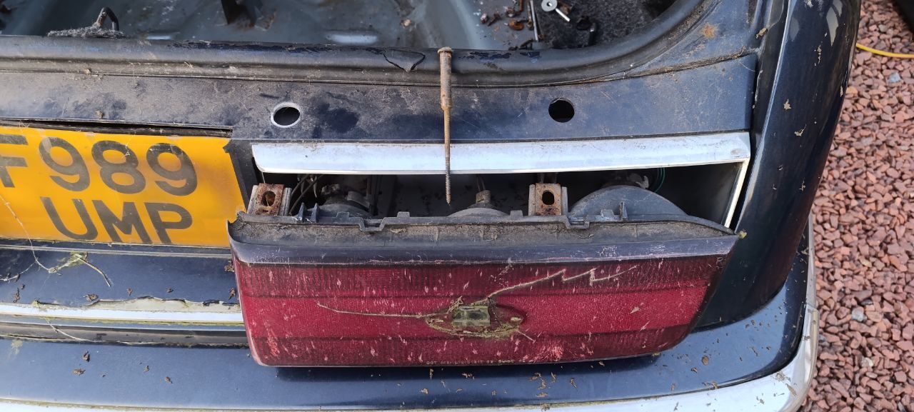

As far as side indicator repeaters goes I agree that repurposing the marker lights is probably the way to go.  Or find a tester who's not too picky about things like that on imports, which I imagine is how it's got through however many tests already like that.

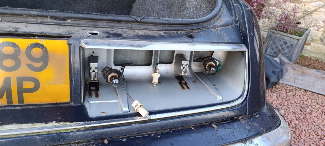

Do you have a photo of what you can get at for the tail lights retaining screws?  Is there enough access to cut a slot in the head of the screw with a Dremel and thin cutting disc so you could use a flat head screwdriver to undo it?

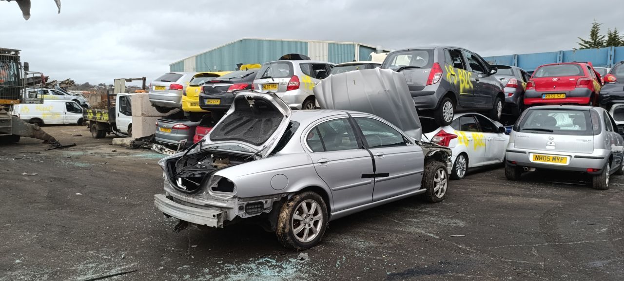

In other news, the X-Type has made its last journey today.
I've pulled anything worth something before it went, unfortunately similar to the Rover 75/MG ZT there aren't all that many enthusiasts that are willing to pay anything for parts, most of these are only getting used up until run into the ground so interest was very low. It's not like there's a shortage of rotten higher spec X-Types either.
I still managed to make my money back and have plenty of bits still available for sale. Shame about the decent tyres on it but even they wouldn't have fit any of the cars I own.

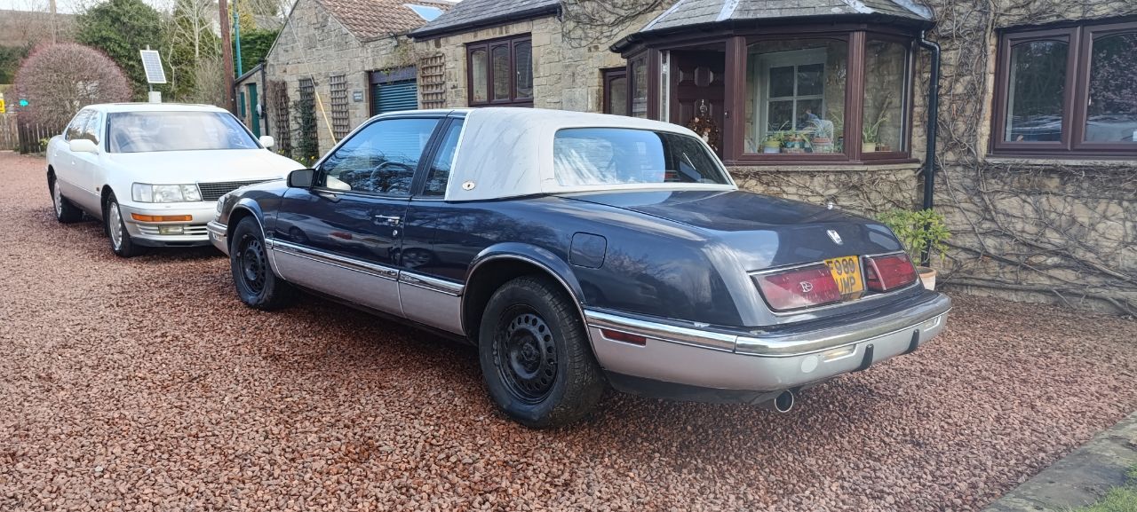

Buick update! I may* have sorted the random stalling/loss of spark issues, at least I wasn't able to reproduce them again (naturally having said that they will surely happen again tomorrow). I'm fairly certain it was the spade connectors for the wiring underneath the coilpack. They are sandwiched between the ignition control module and coilpack and one of them might have been just about loose enough to lose its connection when hot. That's the only way I can explain the issues I'm seeing.
I've used my pliers to tighten the connectors to the point where they will never be loose again. I've started the car several times since, both when the engine was hot and cold. It's now starting without any issues at all so I'm probably going to order more essential parts for it soon. It also meant it was time to go for its first drive in what must have been about a decade!
It drives fairly well if you ignore the fact that the front dampers have about 0.0% of a damping effect right now. The car bottoms out over relatively minor bumps and hops like a lowrider, much like my E39 down below did when I first got it! The gearbox shifts smoothly and through all gears though, I think with new front struts and a few suspension bits (all of which are fairly cheap) this could be a really nice riding car!

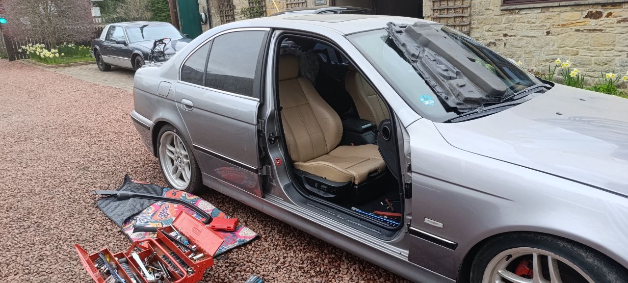

In other news, with the E39 parts car possibly having found a buyer (he only really wants the engine) I've been busy swapping bits into my original 528i. Parts cars as complete as what I have are invaluable really. Not only do they have all the covers, clips, fasteners and trim you'd never find separately, they also show you exactly how they all come together. In some cases I had no idea certain small bits and pieces were missing from my car, and I've spend years tidying it up to avoid exactly that!

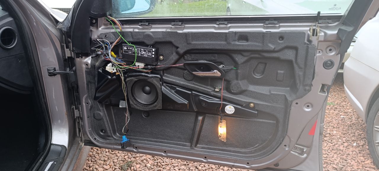

I've also used my freetime to finally swap the front doors which I had waiting for this for years. I think one of them must have moved houses with me twice! The old door were getting a little crusty at the bottom edge and swapping in clean panels is usually the best way of resolving corrosion issues permanently. In this case it required me to completely disassemble them and swap over latches and wiring looms. I replaced the cracked speakers with those from the parts car as well.
I've left the door cards off for now. I have several of them, with a complete set with the extended leather package as well. Since the pressed chipboard backing material is prone to wearing out with every removal, especially if the weather barrier has been leaking for years, I want to puzzle together a pair of immaculate door cards before I install them again.
