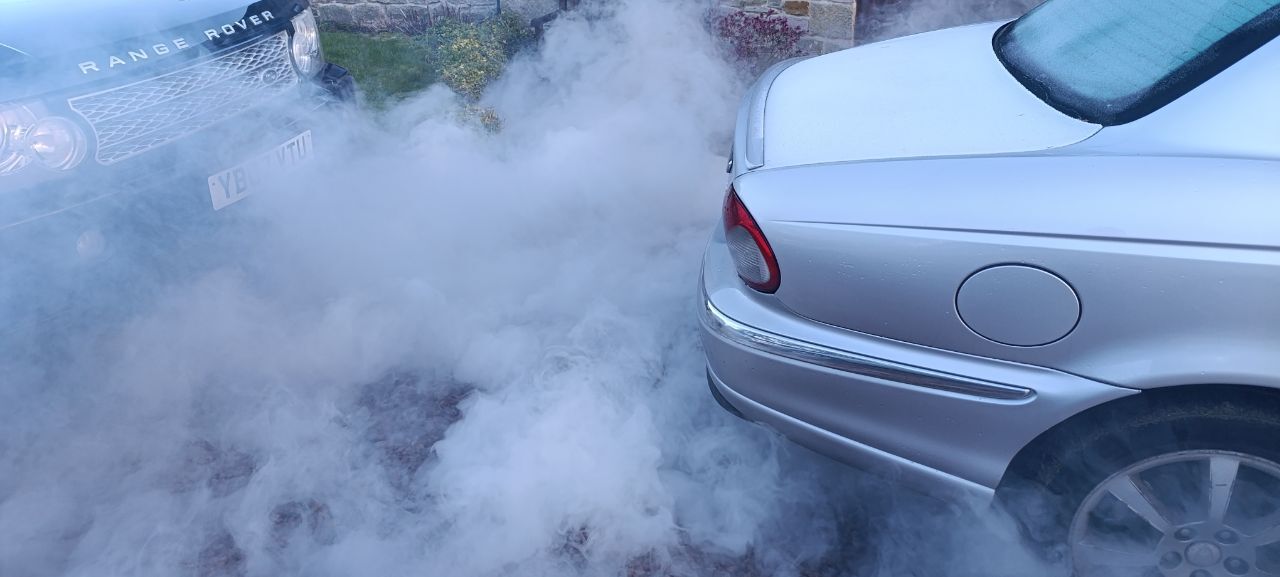

27 minutes ago, Brigsy said:
Id be checking the turbo has not self destructed if its smoking like a trooper.
I was going to say Turbo.
Do you have a scanner with live data ? Taking a look at the air and fuel sides will help determine what's going on, which is better than guesswork !
I've had a look with my generic scanner to check fuel rail pressure, just to make sure the supply isn't the issue. I didn't seem to have any live data for boost pressure though. My guess is that there is a tear in a hose somewhere, the engine doesn't trigger a code because it thinks the turbo just isn't supposed to boost and it's now dumping too much fuel into the engine for the small amount of air that goes into it. Aside from the pipes going into and coming out of the intercooler I'm not really sure where that tear would be though.
Sounds like the next steps would be to check the turbo - is there axial play ? does the actuator move when you start the engine ? - and then the EGR.
Is EGR working right? Does it regain a bit of power as it warms up? Last time I had something akin to that, it was an EGR blanking plate that burned up, resulting in no power and tons of smoke.
It almost definitely sounds like a boost leak based on the symptoms and how it came about. As you say it sounds like its dumping loads of fuel in to compensate.
Is there something you can spray on/around the intercooler pipes to detect a change in revs? I'm wondering if one is split right at the end next to a clamp which would be hard to feel?
I suppose a vacuum line to the actuator being split would just result in no boost at all but no other symptoms so can probably rule that out. I wonder if there's a split in a PCV / vacuum hose elsewhere though that could somehow cause the fuel delivery to go crazy.

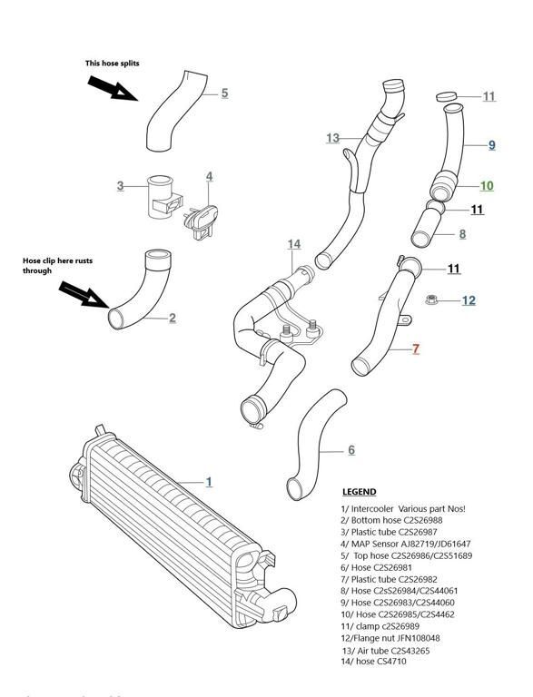

Here is a diagram of the intercooler pipe system, not that helpful in terms of where it is on the engine but its a start. I think you said you tried disconnecting the MAP sensor or read the values on a scanner? That would have been my other thought for something drawing in excess fuel.
Is it possible for the intercooler to be cracked or burst somewhere?
EGR blocked, they do this for fun. Or split hose at the bottom. Is it not throwing up any codes?
hook up a smoke machine to confirm there are no splits in any hoses anywhere
Another thing these love doing is baking the actuator on the turbo, there should be a rod poking down, it should be moving freely. If it’s sticking at all that’s generally due to the turbo being caked to fuck in carbon.
Is the glow plug light flashing?
Hose 6 or 2 on that diagram are prime suspects.
Used to split all the time.
Edit: They also go soft and suck in under load sometimes (yep, not expand!) causing a loss of power.
Turbo actuator fault usually triggered glow plug lamp to flash if it had failed.
Well, whoever assumed it was the turbo, you are a winner!
I should have checked straight away but didn't want to believe it until I've removed all boost hoses and checked them thoroughly. 2 hours spent on faffing around only to feel the turbine wheel flopping around in the turbo housing. At 108k miles and about 2 miles into my ownership 🤦‍♂️

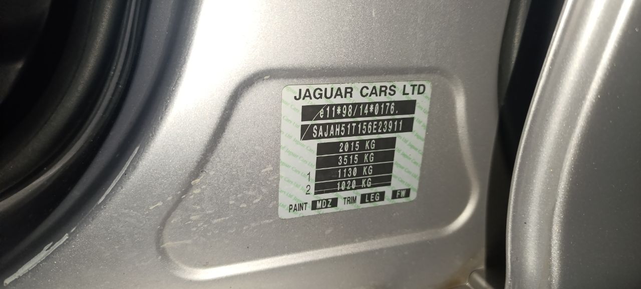

What's the paint code?I'm after a rear bumper for a 2006,so pre facelift,saloon.
MDZ, couple of scuffs that won't polish out but good otherwise.

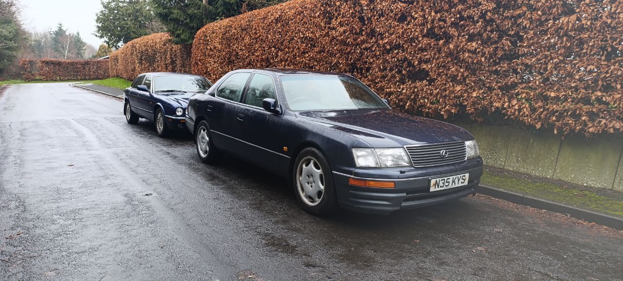

Someone owns an LS400 locally I haven't been aware of at all! Second generation but same color as my Celsior. Great to see one still in use! Even more shocking however was that the same person has an S13 rotting away in their driveway!IMG_20260117_102720.jpg.7651bf12969e1dc7630e16dc581c0512.jpg
Now that's a sight you don't see everyday! Largely unmolested and only 60k miles! Off the road for 13+ years, I'm almost tempted to leave a note...

11 minutes ago, Schaefft said:
On the way back I made an important discovery:

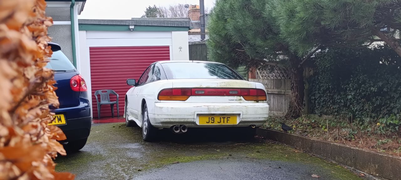

Shame to see the S13 like that.
Wheels on the LS400 off a Mk4 DHP?
Agreed, but I'd be very surprised if its ever  going to be at threat of being scrapped. Someone would save it.
And yeah, I thought they are DHP wheels.
