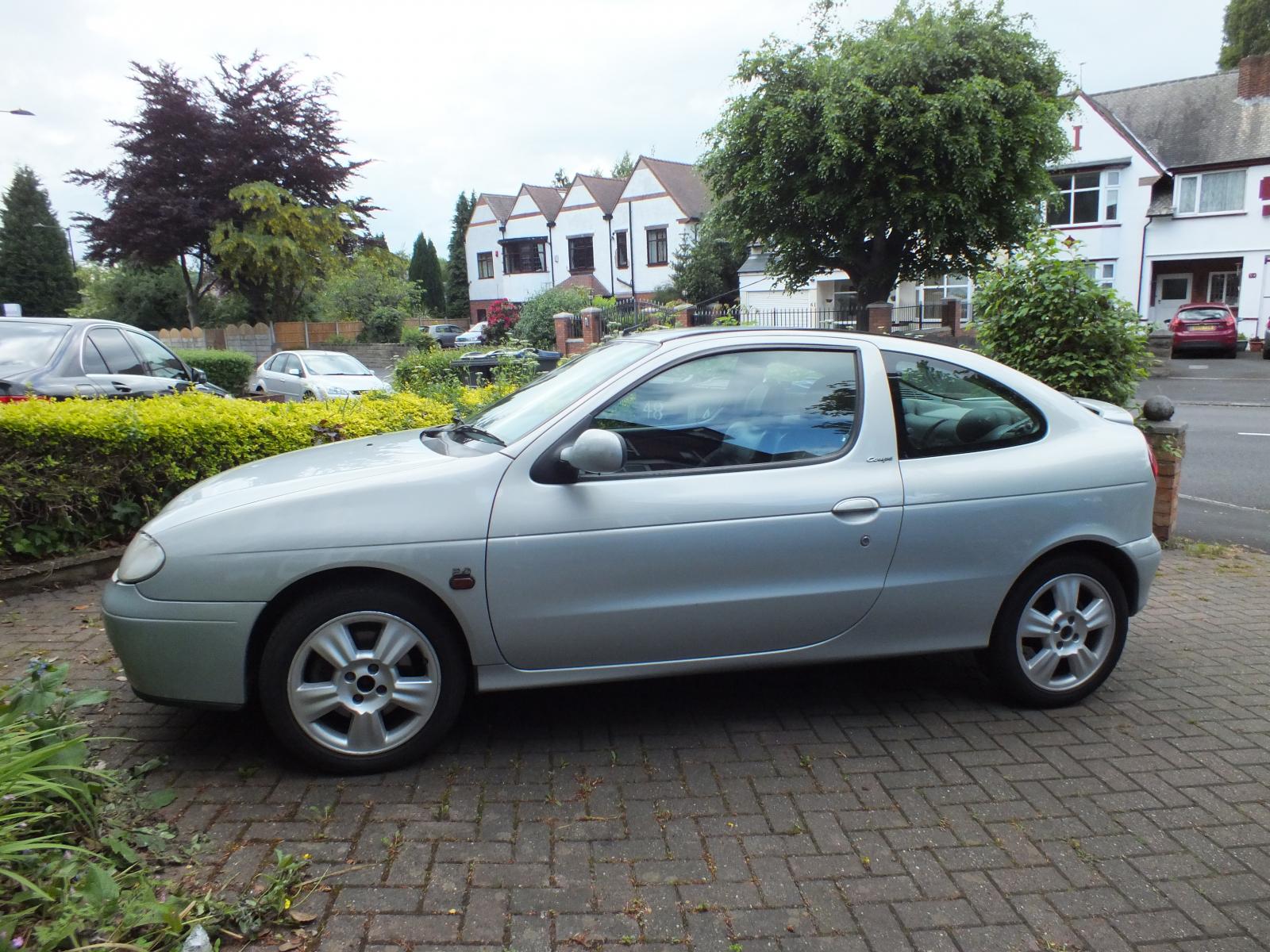

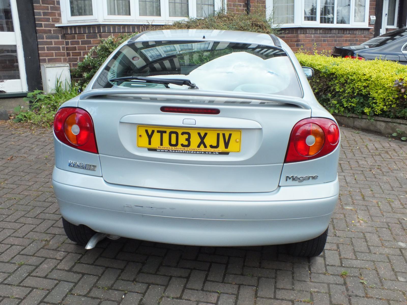

Pretty, love the side view of these

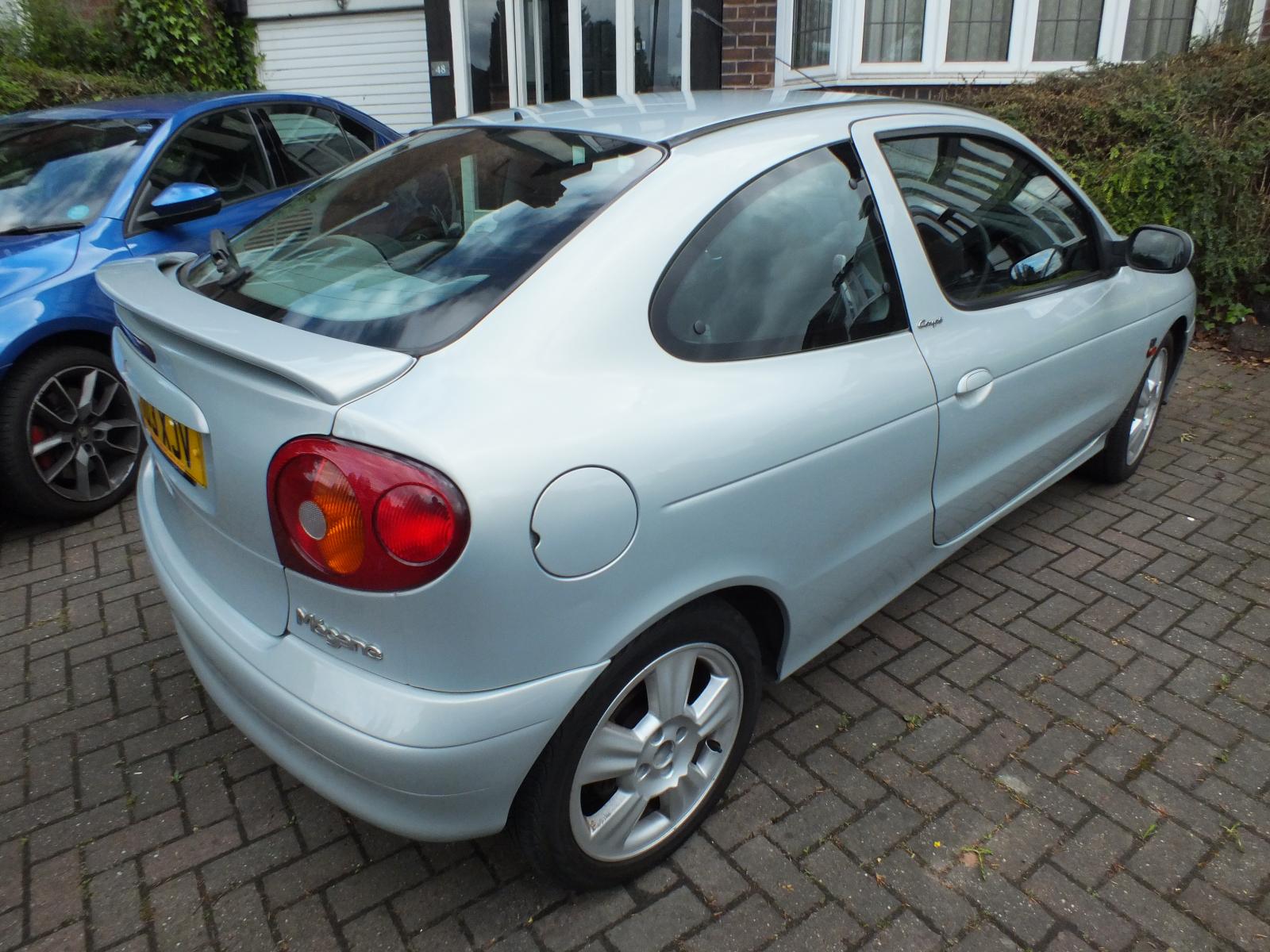

Back, not so good
Rear 3/4 view gets better again

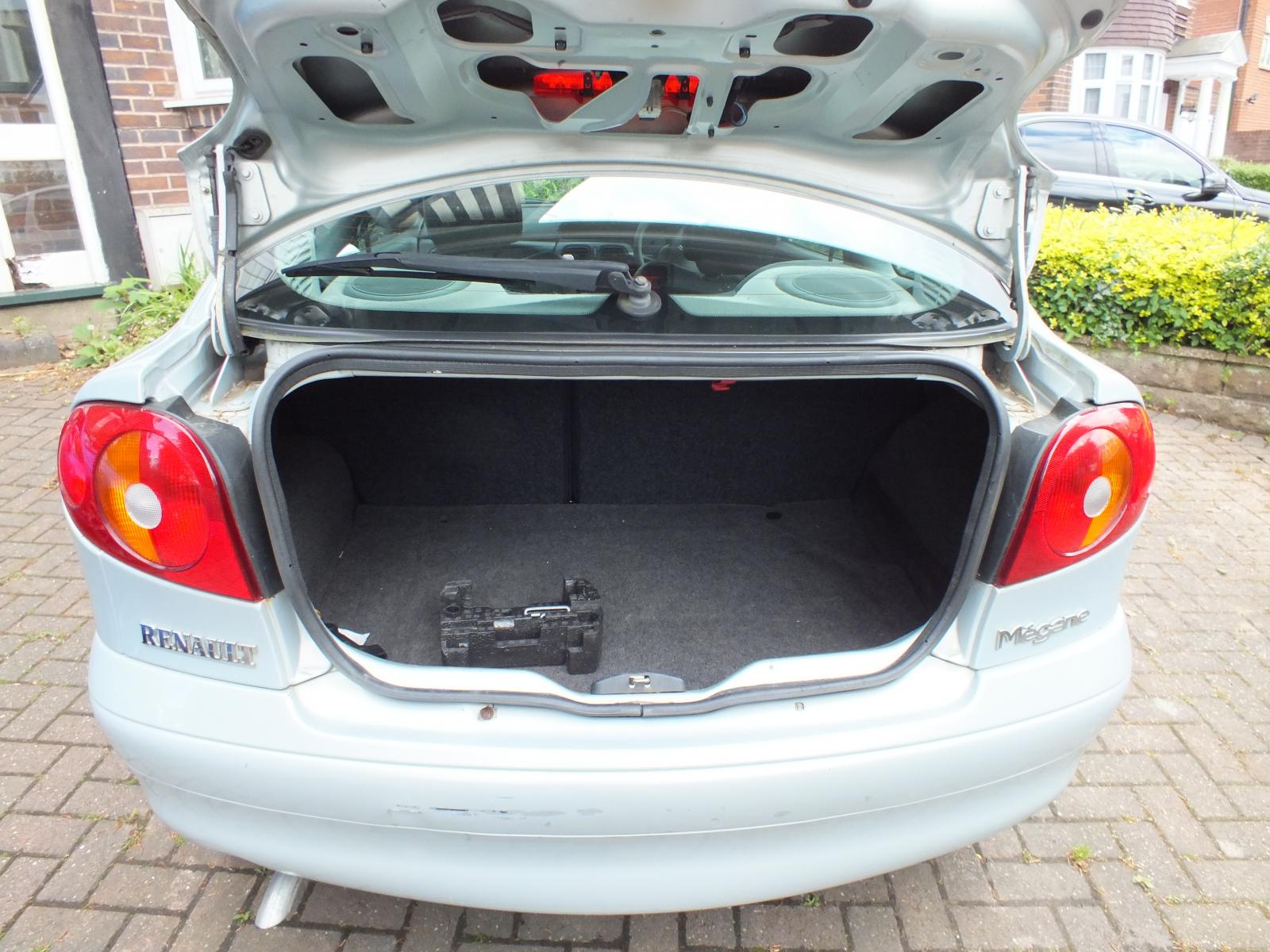

Boot, rubbish

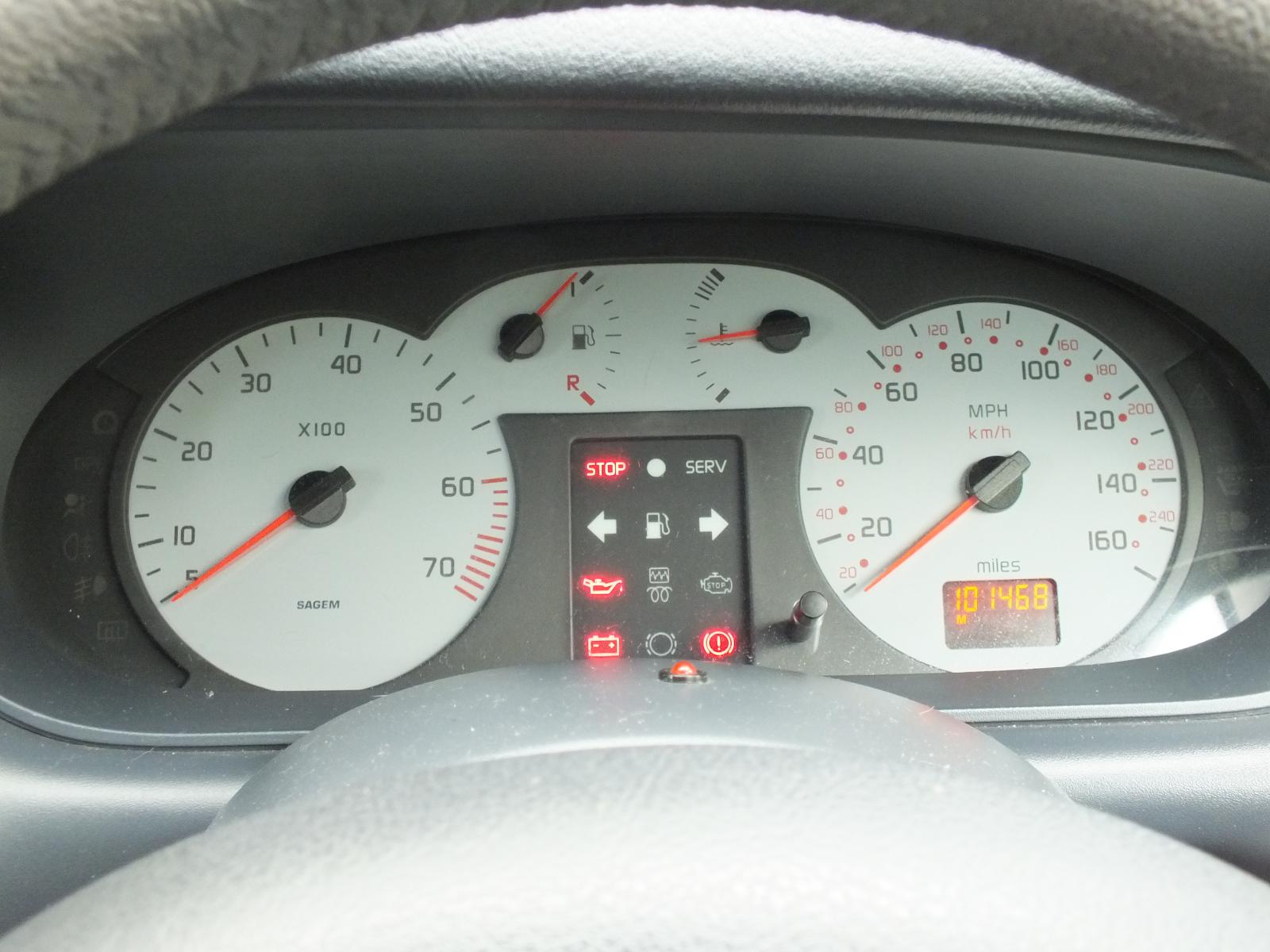

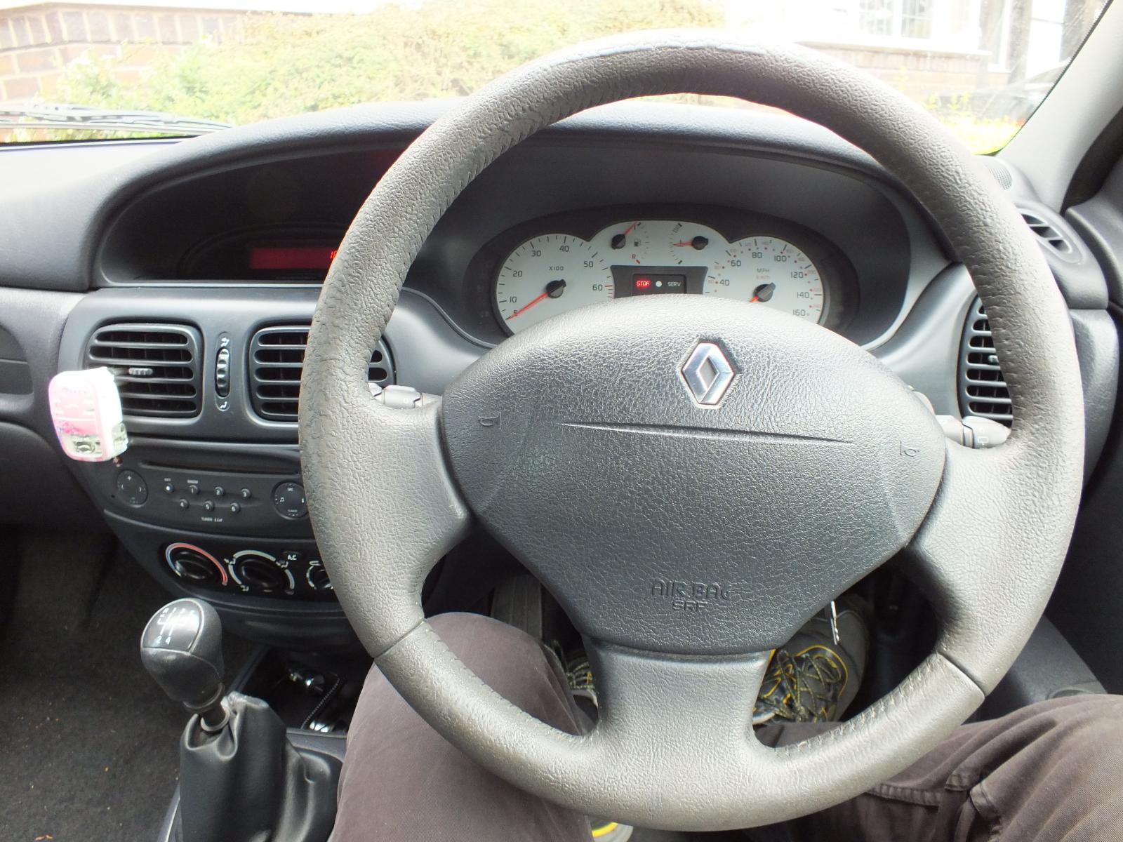

Dash, meh
Seating position, comfy, but I would love to pull the wheel an inch or two towards me

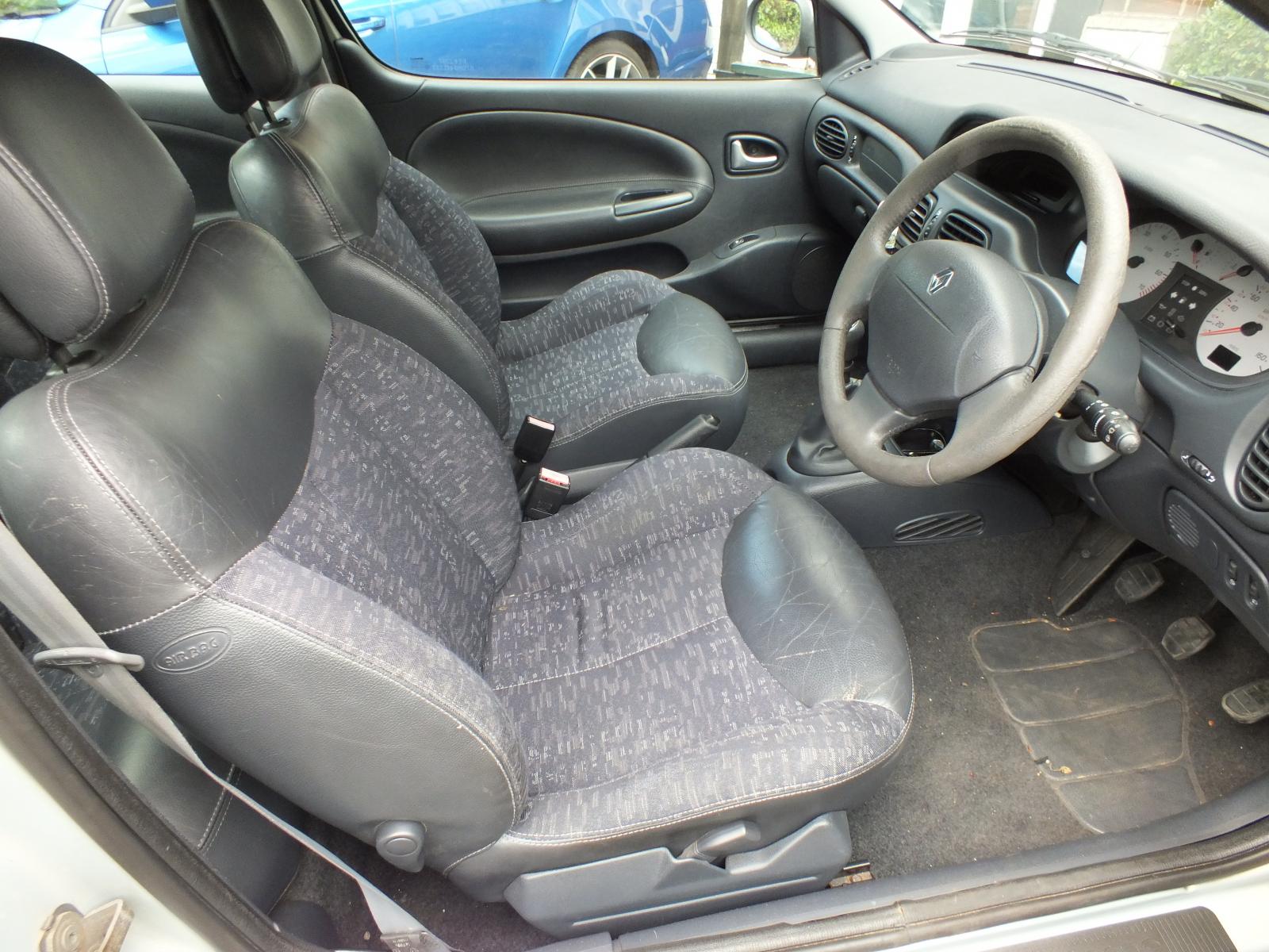

The front seats are ok, and nicely soft, but the support behind the shoulders is a bit to low for me and I'm only 5' 10"

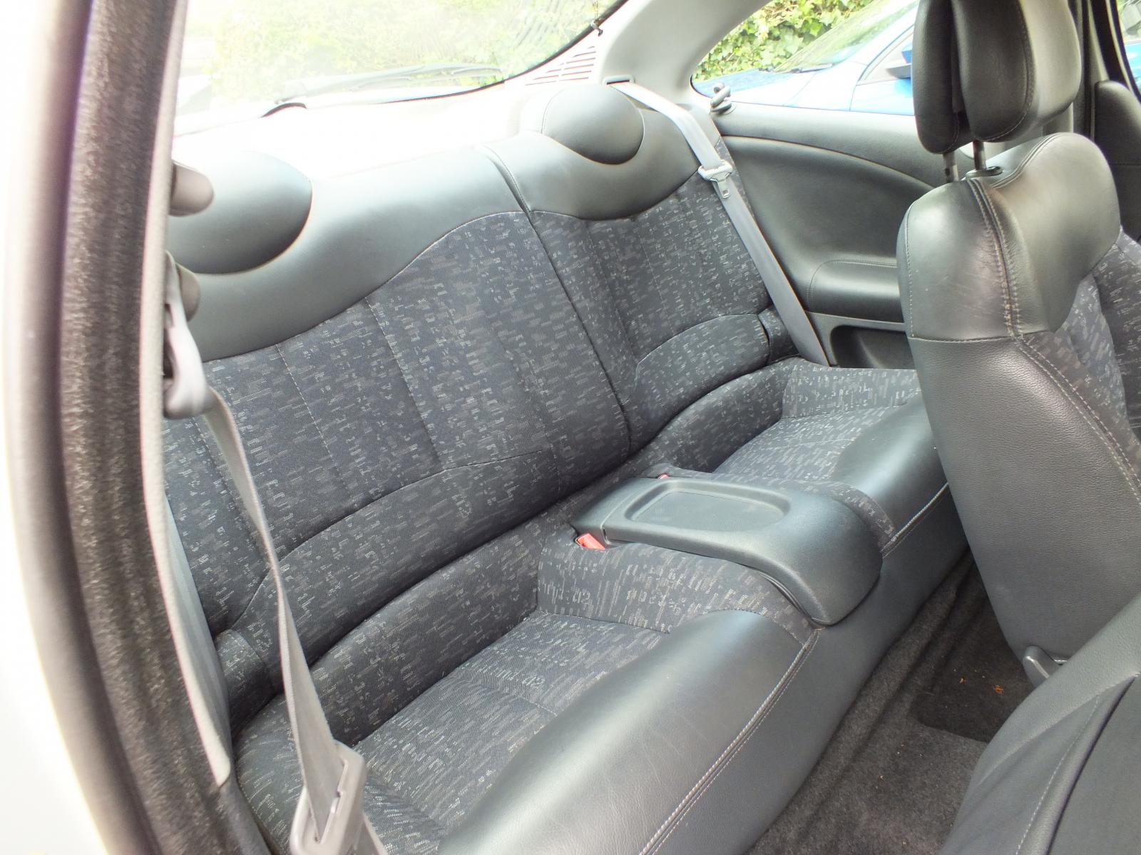

Rear seats, no use for anything

Buy some scrubbing wipes man and sort out that fooking steering wheel - I can see the dead skin from here :(
Seriously, it will scrub up well with a touch of elbow grease.

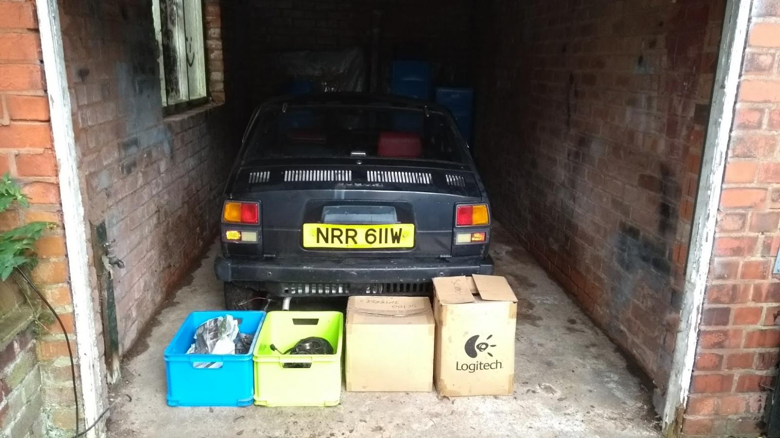

New member of the stable fills* it's stall
Thanks to James for the chance to purchase this and also for helping out when the garage door fell off it's frame.
Tomorrow afternoon will be 'fix the door' afternoon.
Great news!! Even with something as slim as a SC100 in there, that garage still looks a bit tight for width.
