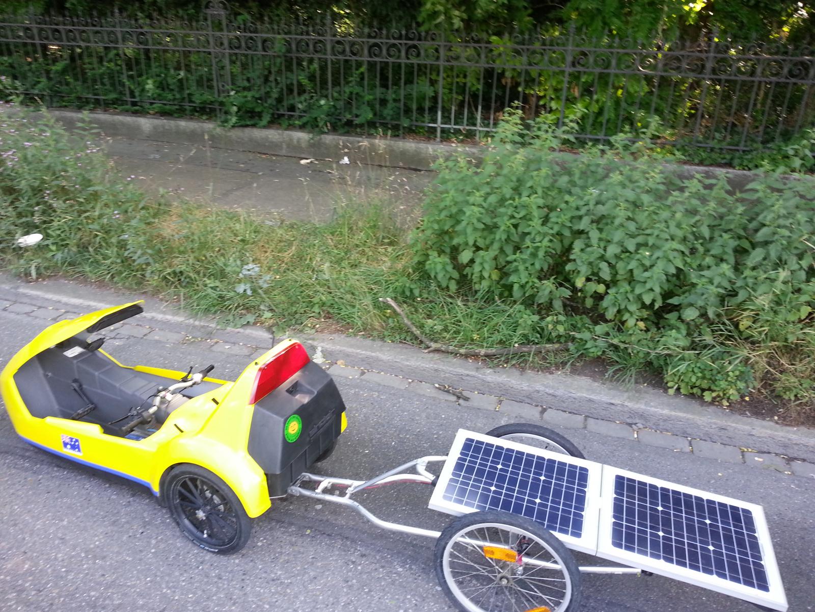

Nice accessories on that with the mirrors and indicators.
Picture courtesy of Wikki............. haven't got one of hers - can`t remember if it has the indicators and mirrors

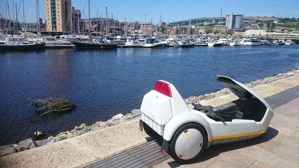

How's that one coming along? :D
I'm still looking for a wing in black...in the meantime, it's quite a pleasant place to go and sit with a coffee whilst watching a DVD on the sat nav.... :-)
