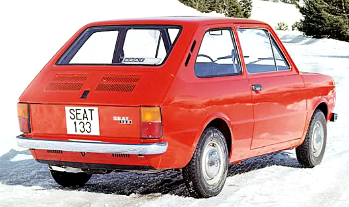

So thats what the engine cover should look like!post-17481-0-20326800-1490296879_thumb.jpeg
(google image from a gumtree advert of 167 days ago. £500, Spalding)

Not much to report as work getting in the way. I have emailed a Spanish ebayer who has the engine bay lid for sale. Just asked if he'd be willing to post out to the UK.

Oh bollocks to it. I enquired about the cost of postage to the UK re: that bootlid in Spain. 45 Euros. Didn't think that was too bad really.
Well bootlid is bought and on it's way to me. It's a NOS item, so no lock.
Not that fussed currently re: lock but having a bootlid will make it look a bit more complete and is a morale booster.

Engine bay lid turned up today from Barcelona. Great!!! :)
