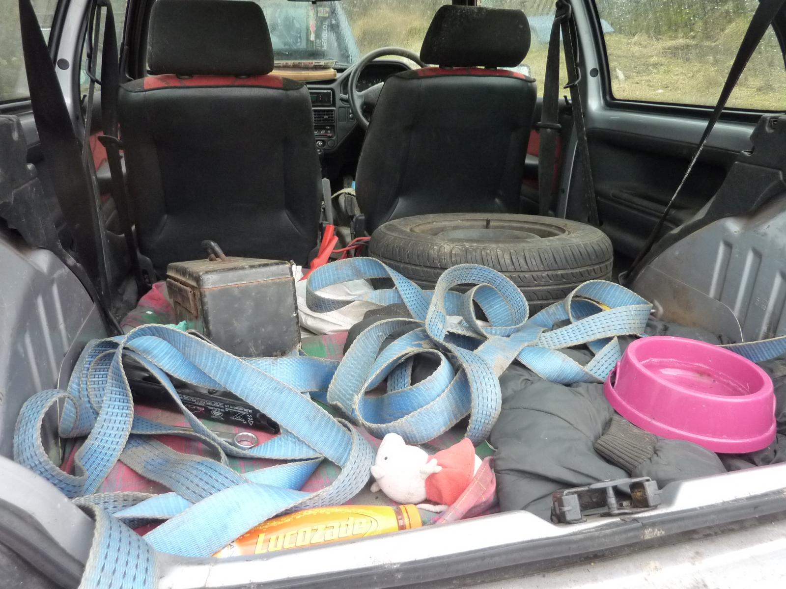

Parky Posted March 5, 2017 Posted March 5, 2017 Urgh at that interior. Can I suggest a stick of dynamite in a bucket of soapy water might be the best way to get that interior habitable?
Richard Posted March 5, 2017 Posted March 5, 2017 The interior isn't that bad, it's just slightly more than averagely grubby with added mould from sitting unused. Most cars will grow mould if they are unused and a bit damp.
Split_Pin Posted March 5, 2017 Posted March 5, 2017 My Corsa seats had more mould than that when it was covered. Cleaned off fine.

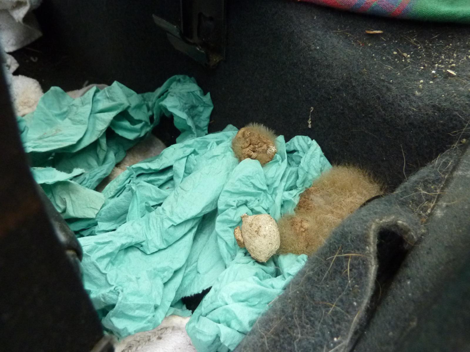

KruJoe Posted March 5, 2017 Author Posted March 5, 2017 By popular* demand: More treasures. Dave_Q, The Moog and strangeangel 3
SiC Posted March 5, 2017 Posted March 5, 2017 Sell it to the BBC for them to use on the next topgear challenge. A car that might spice up the series a bit. KruJoe 1
purplebargeken Posted March 5, 2017 Posted March 5, 2017 I just hurled and now have a headache. Thanks. KruJoe 1

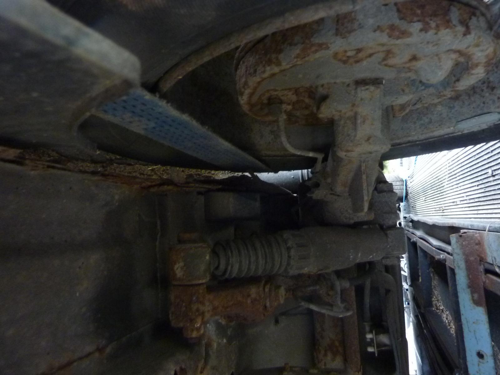

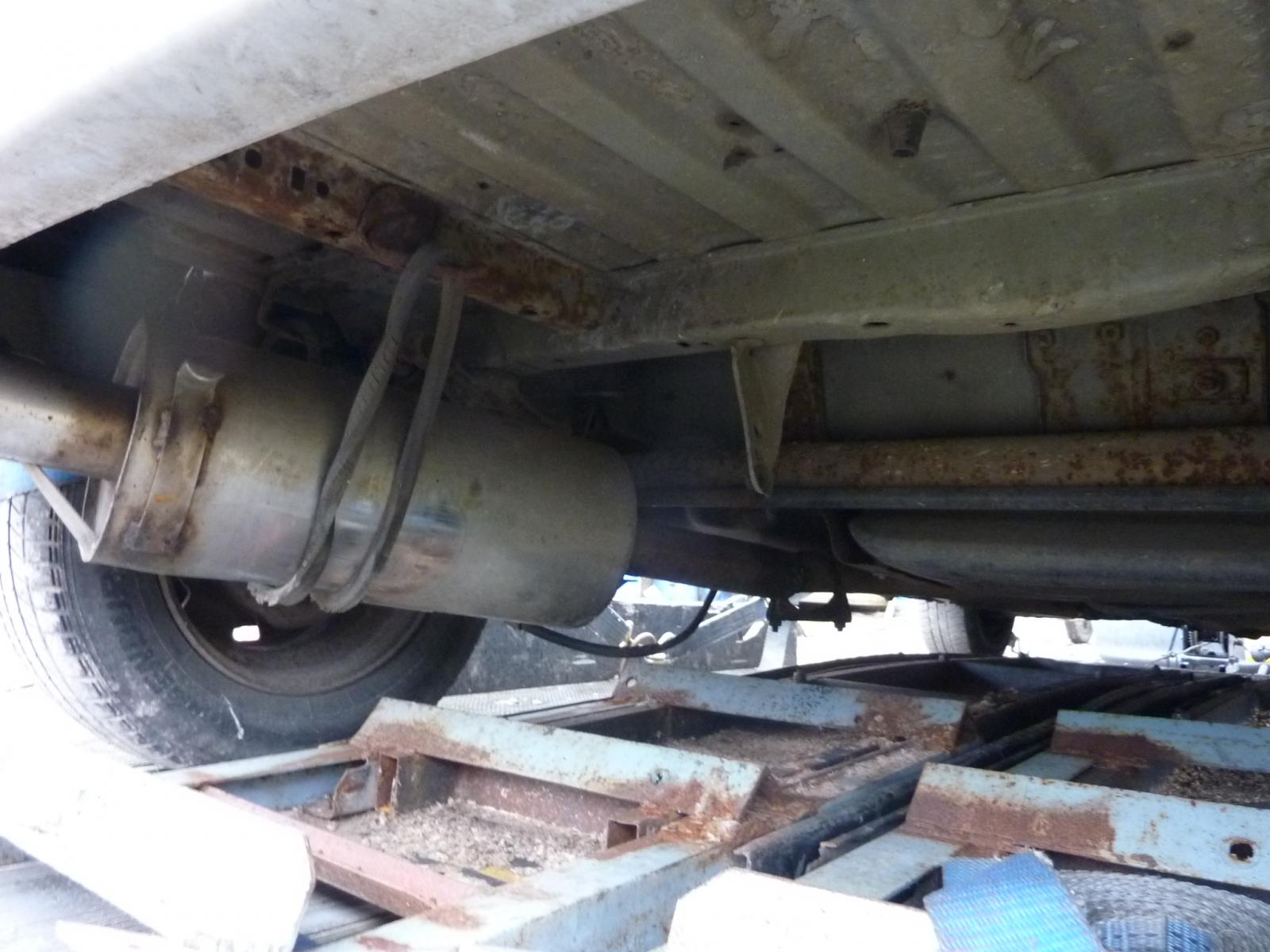

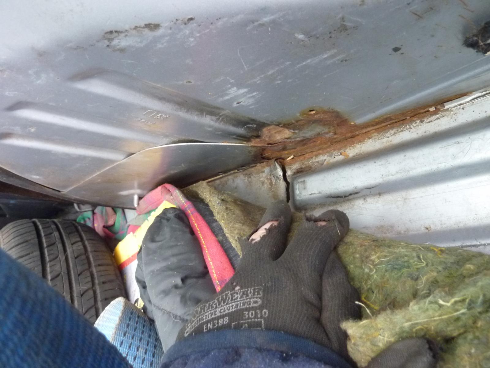

KruJoe Posted March 5, 2017 Author Posted March 5, 2017 I thought it felt a bit tight getting the straps behind the back wheels. Not much life left in this beam.
KruJoe Posted March 5, 2017 Author Posted March 5, 2017 This'll explain the flappy back end: (Cracked / torn boot floor!) M'coli 1

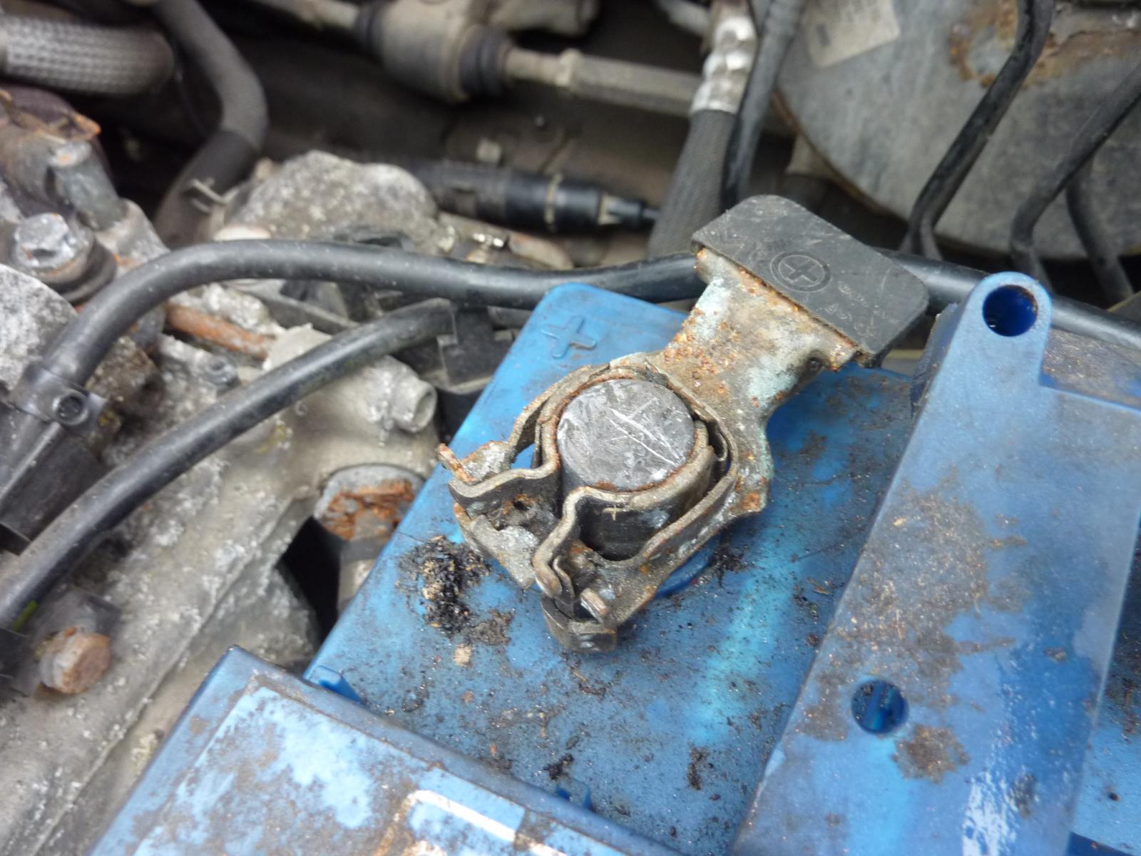

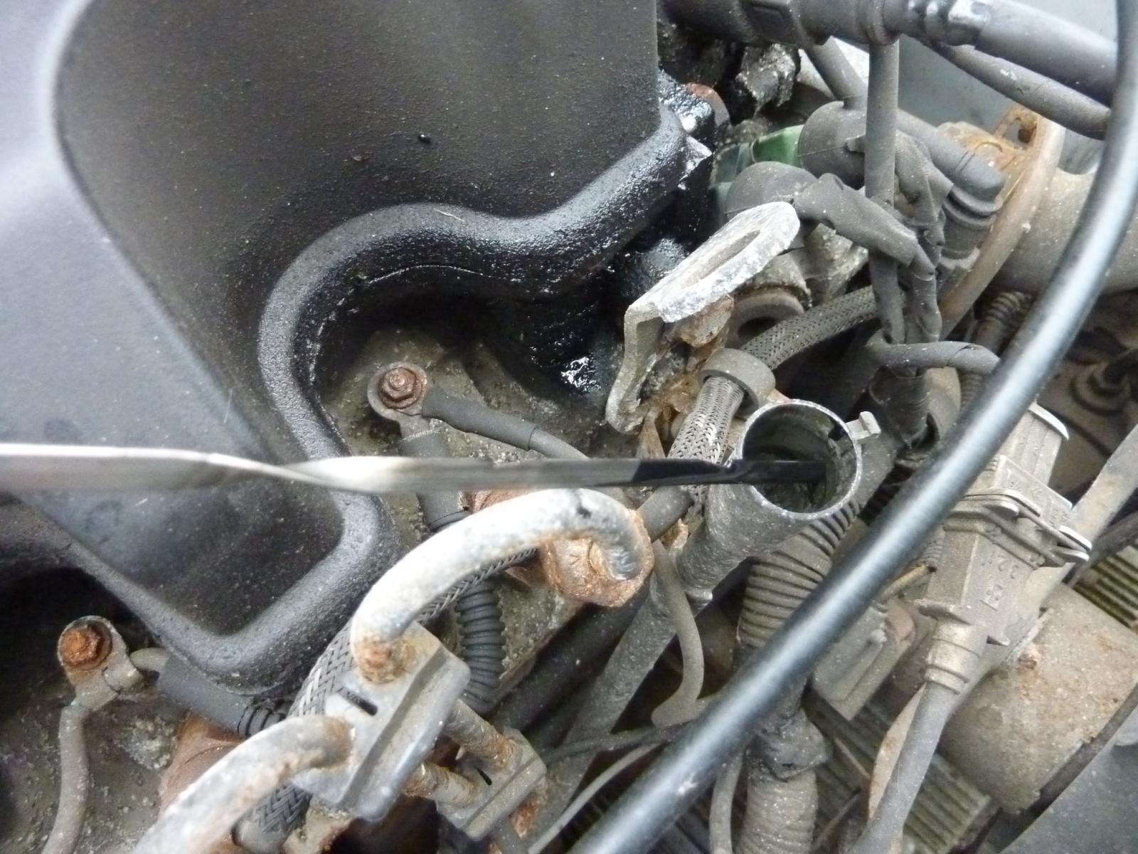

KruJoe Posted March 5, 2017 Author Posted March 5, 2017 Let's get cracking. Borrowed the BX's batt... I've not seen these nifty quick-release clamps before: I could feel diesel* in the primer bulb, so... Well, it was trying on one. A bit. But slow, and howling. Top of the engine dry? Any oil in it? That looks oily enough. Booster on to help it, and... ...how can a 20 second vid clip take an hour to upload? Welcome to rural Yorkshireshire. strangeangel and Dave_Q 2
Eddie Honda Posted March 6, 2017 Posted March 6, 2017 I've not seen these nifty quick-release clamps before: P1170549.JPGThey aren't "nifty", they are shit and the work of Satan.
KruJoe Posted March 6, 2017 Author Posted March 6, 2017 Oh? Well this one works ok - certainly better than the usual green/red screw-top clamp* efforts from PSA. Next try, it fired up! It squealed like a pig when it first caught, then it started running away on itself (sticky throttle cable) but I scuttled to the front and pulled the lever back to idle: The batt light stayed on, so I guess the earlier squealing was the swan song of the aux belt being killed by the seized alternator. It's done a Shitpeas. Sounds well, eh?

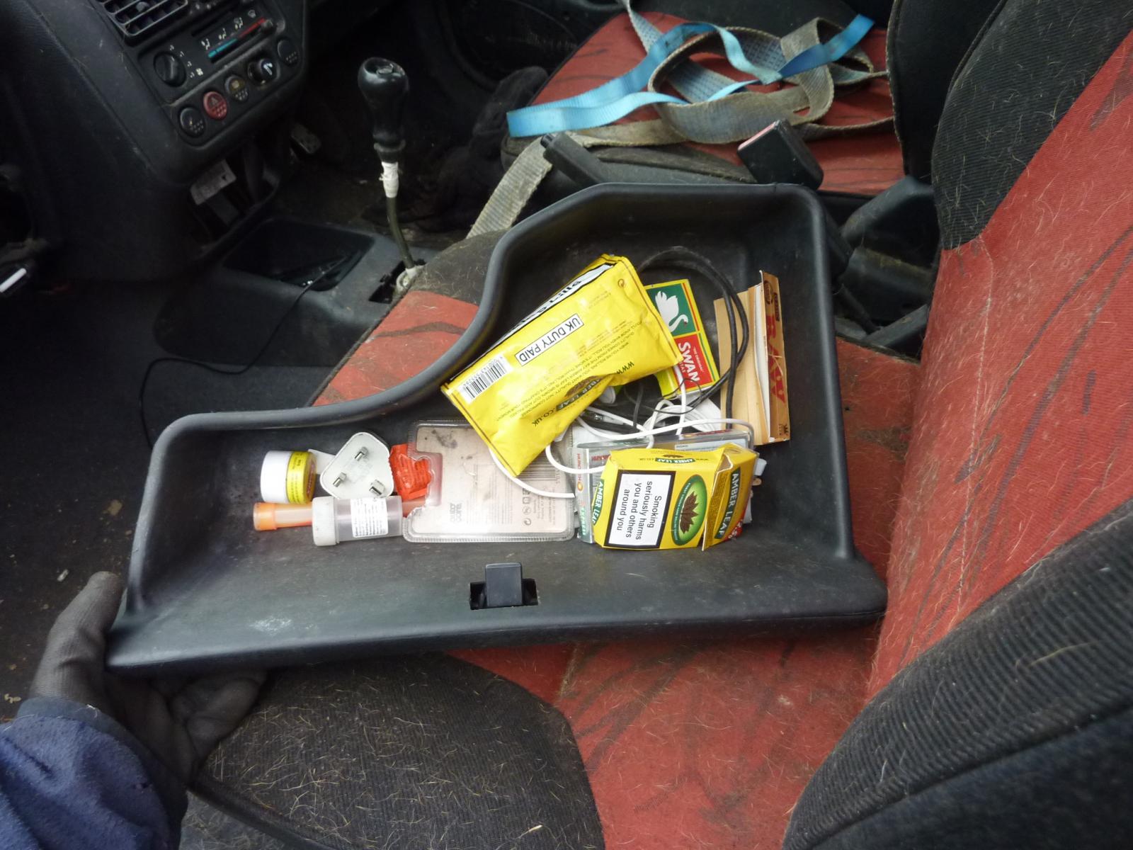

John F Posted March 6, 2017 Posted March 6, 2017 So... features more mouldy dog eggs than undented panels, the rear end is making a serious attempt to secede from the Union, the interior contravenes the Biological and Toxin Weapons Convention 1972, value with a fresh MOT would be less than the cost of the paraphernalia in the glove compartment... I predict a future for this that involves bean tins. </mystic_meg>

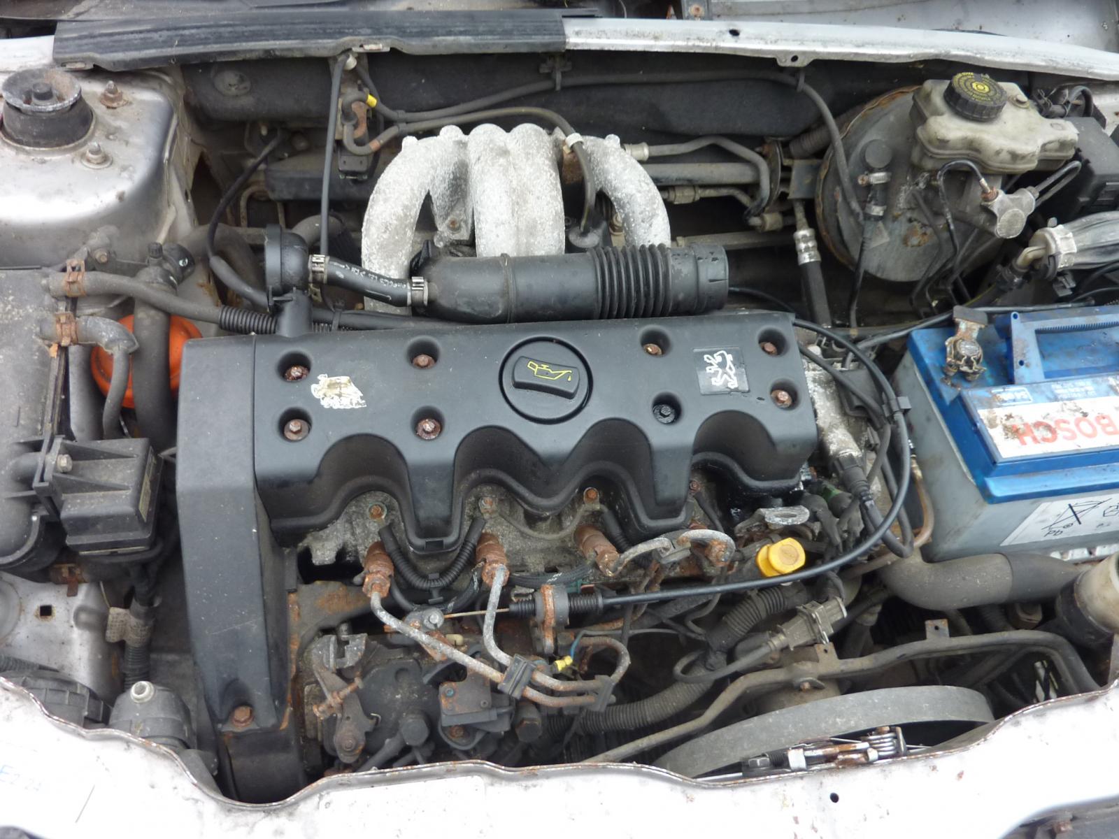

Lacquer Peel Posted March 6, 2017 Posted March 6, 2017 KJ has an early 106 1.4 diesel with a Lucas pump. Engine swap?
M'coli Posted March 6, 2017 Posted March 6, 2017 That's pump-of-darkness too, by the looks of things - which is an utter pain in the arse as I could do with decent photographs of how a Bosch pump's cold start cables and that are connected because they're not on the ex- explosive-cabbage 106.
Lacquer Peel Posted March 6, 2017 Posted March 6, 2017 It does look like a Lucas pump, I thought some of these later 106 diesels used Bosch pumps. The cold start devices rarely work anyway.
Rusty_Rocket Posted March 6, 2017 Posted March 6, 2017 Yes, Lucas pump on that one, which is odd because I thought they were all Bosch by that age. It has no immobiliser either? I have a complete Bosch pump, injectors, pipes and bracket for a TUD5 if anyone wants to convert theirs.
