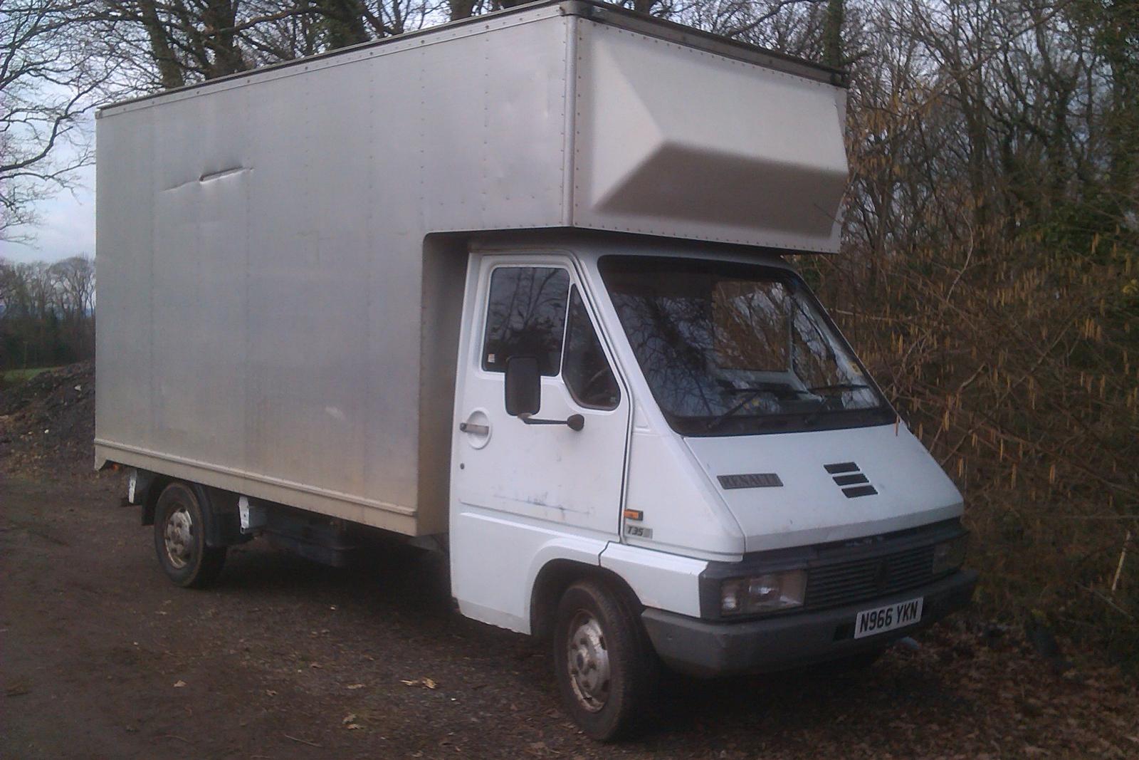

Bought this old thing in Bristol t'other day never want to see that place again.
Drove it back to Sussex with one wing mirror that kept blowing out of view and the other was an old pug 206 one sellataped on so I couldn't take it on the M4. Poxy back roads. Busy bits of Bristol and that Bath hellhole.
Especially bad when the gear linkage is broken, sounding quite metallic as I try and define neutral so I don't have to hold down the extremely stiff clutch with all those west country traffic jams. 'Go west' said the wurzel's I think too many people listened.
It was also a case of timing belt roulette but I've found a sticker for that. Only 40k miles back but 2008 I will chance it.
The gear linkage was an easy fix knackered rubber ring round the bottom of stick. It was metal on metal.
The handbrake is very stiff and it will fail when I get an MOT.
The worst thing is the clutch , the cable was changed recently after the previous snapped. Adjustment on the cable doesn't do much. Could it be because it's a cheap aftermarket cable ? Or is the problem more likely to be the clutch itself ?
I can put up with the clutch but it won't do when I take it over to the continent. Could snap again. ??
If i get bored of the luton I could always put a little recovery body on it being a LWB.

If you do remove the body, I'd convert it into a compact and bijou glamping retreat which you can let to trendy people

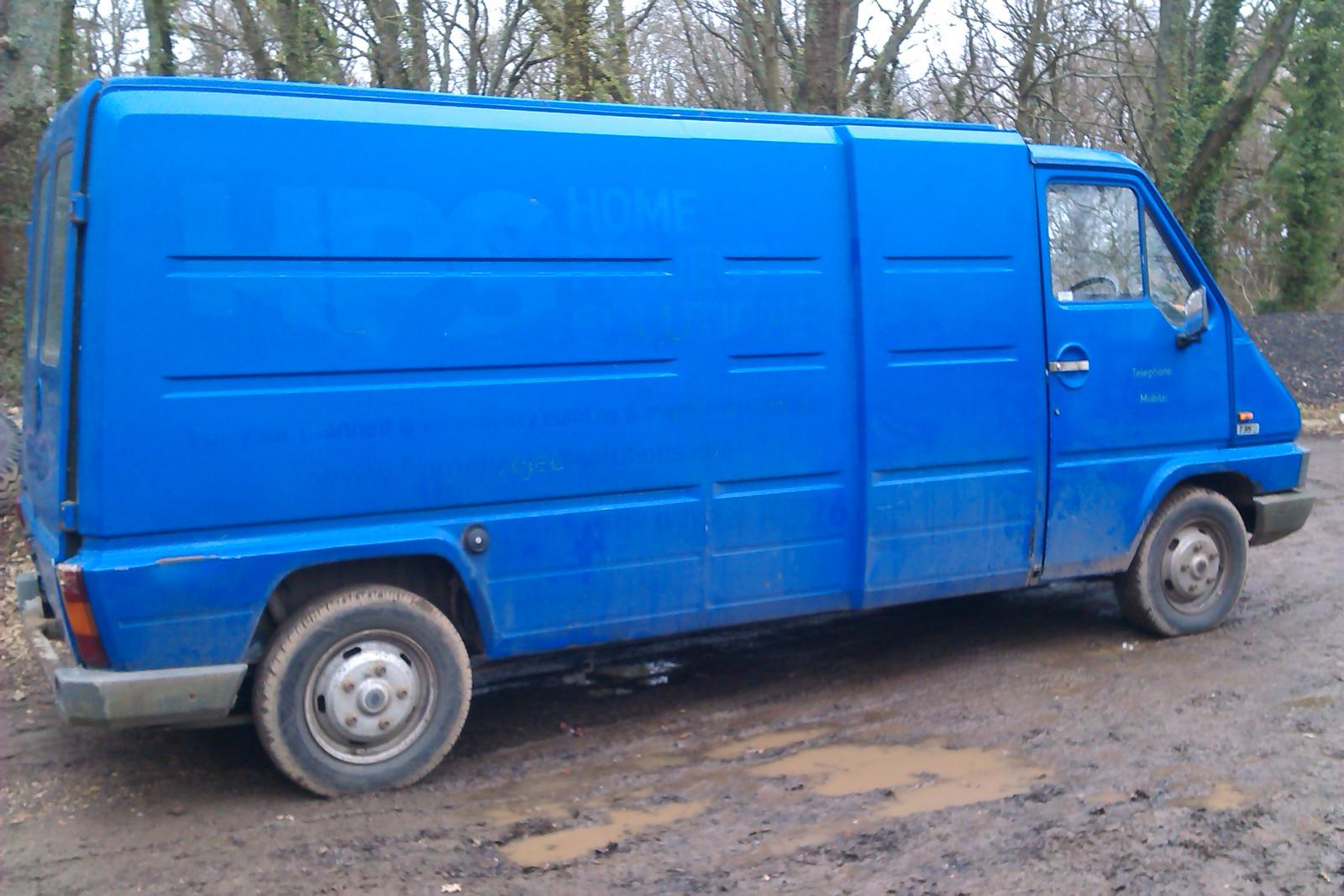

I hired a Master Panel Van once. Thought it was ace!
They're called T35 so Traction = FWD .RWD's do exist although v rare here called P35's. Then theres the 5 tonne versions they're RWD.
I also have a panel van
Unlike the luton everything works nicely except the rustproofing. Bodging it up slowly. Was going to use it for spares but it's just too good. I've been to France in it 9 times loaded it up to the roof with heavy furniture/engines/motorbikes.

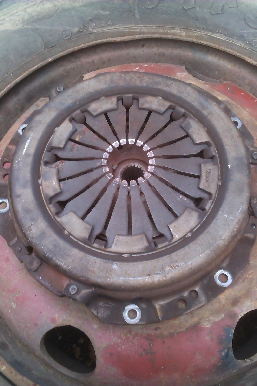

The clutch on this was getting on my wick so I thought I'd investigate.
I've never done a clutch before but it's actually quite easy with this. The box sticks out the front.
Chock her up, roll pins out of d-shafts well one anyway the other is still stuck.
unbolt everything else and pull ...
Now I can get a good swing at that d-shaft roll pin.

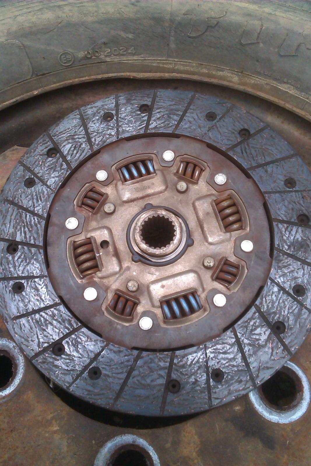

I'm a bit lost because I expected to see some part somewhere worn out, a cause for the clutch stiff-ness
It all looks alright though, I don't have much of a clue though.
Even the clutch pivot my main suspect
All I can do is replace it all . Put it all back together and test it.

Yeah, the one that came out of mine was pretty much as yours, albeit that the friction plate was nearly at the end of its life. Replaced everything, and it was exactly the same!

Tired springs cause a heavy clutch, and French stuff seems particularly prone to it in my experience, perhaps because the clutch plates themselves seem to last quite a long time (100k miles considered well within reach of stuff like 2CVs, XUD diesels etc). Will be interesting to see how it feels once all back together again.

Well I changed the clutch on this and the pivot thing.. The van was blocked up for about a month in the process. I took it slow made a few mistakes like using a tapered punch on a driveshaft roll pin. As vehicles go I think the job was quite easy with alright access. I've never changed one before.
I then had to change all the bjoints and track rod ends which I had well erm ripped with caveman fork tool.
The CV gaiter was a bit fooked to boot but oh well.
Hardly any change with the clutch after all of this. bastard thing.
Changed the clutch cable and all was solved it took 1 and a half hrs.
