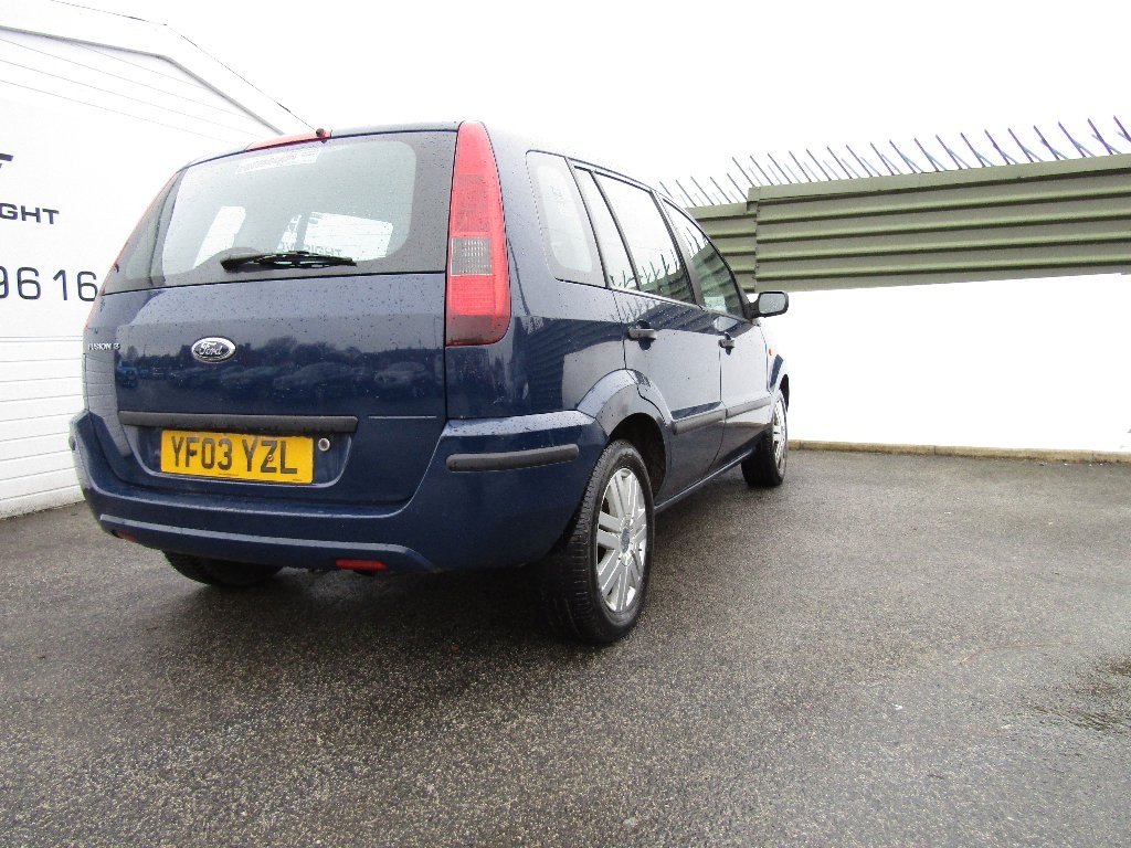

pictures soon,mot due sun,well it drove ok,noisy rear shock,pissing fliud out,eml came on,seems just be speedometer sensor,yes its oval badge,gone to get cheapie £14. shocker,
interior a bit minging,but ok £50,had to make quick dash to get it taxed,still had the old style logbook,not recognised on dlva car tax section,due to only having 11 numbers,and not the usual 12sprayed lower rear shock bolt with wd40,will do it later today,just hope no locking wheelnuts..

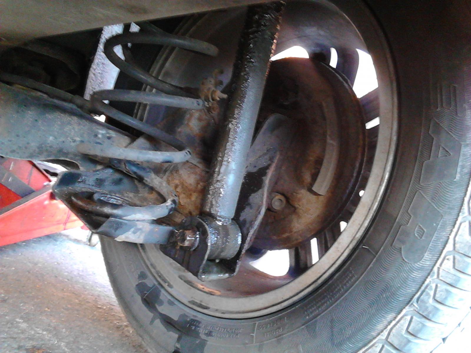

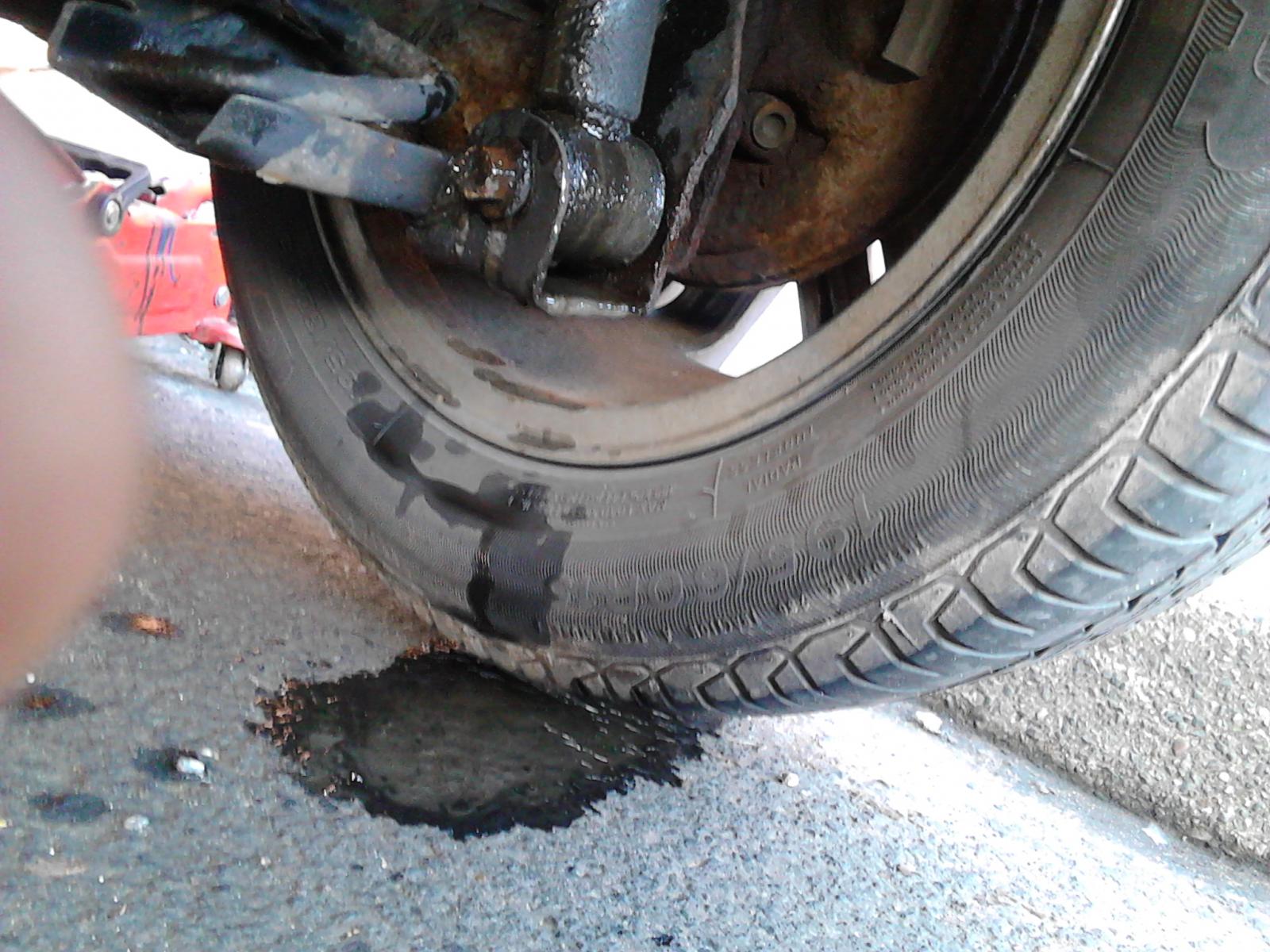

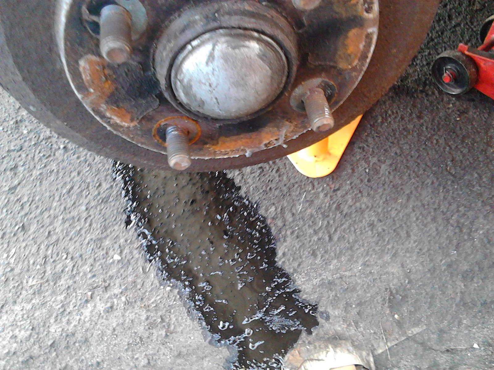

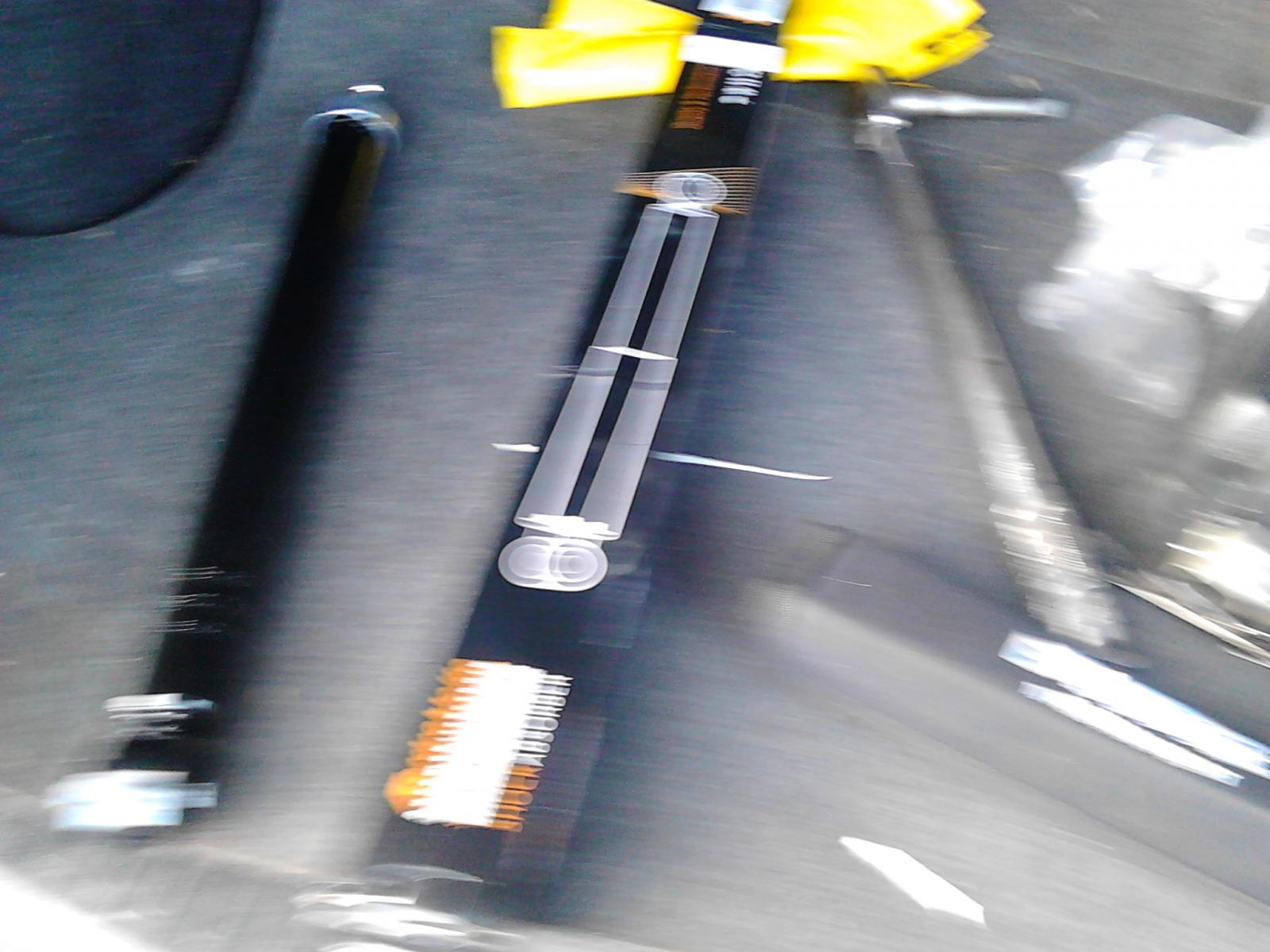

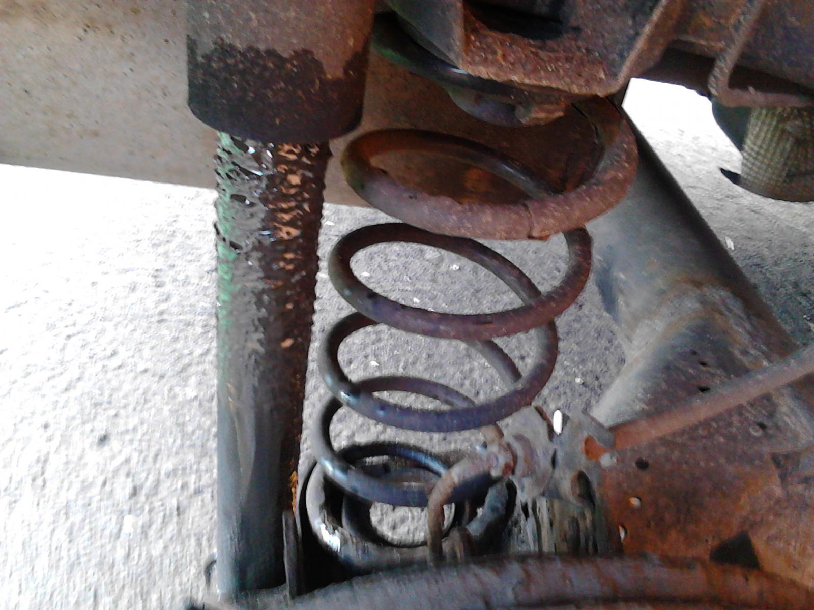

right changed the rear shocker,than slapped on some leftover blackhammerite unseal,on rear chassis legs,etc,previous advise,was rear brake pipe,sanded down,sprayed with anti-rust primer,than matt black paint,than dolloped on some grease,,lower rear shocker bolt came out ok,coated in copaslip,torqued back up,see pictures,as you can see it was well leaking..

the other is fine,looks like it was done few years ago,looks like i will have to tackle the front top strut mount,that shock is leaning,was previous advise,

mot goes in tomorrow,drover over speedbump,crack,drivers side went down,spring had broken in 3 places,top strut mount was no good,shocker was well knackered,got a sachs front shocker,new spring,nw top mount/bearing,so all now done,
