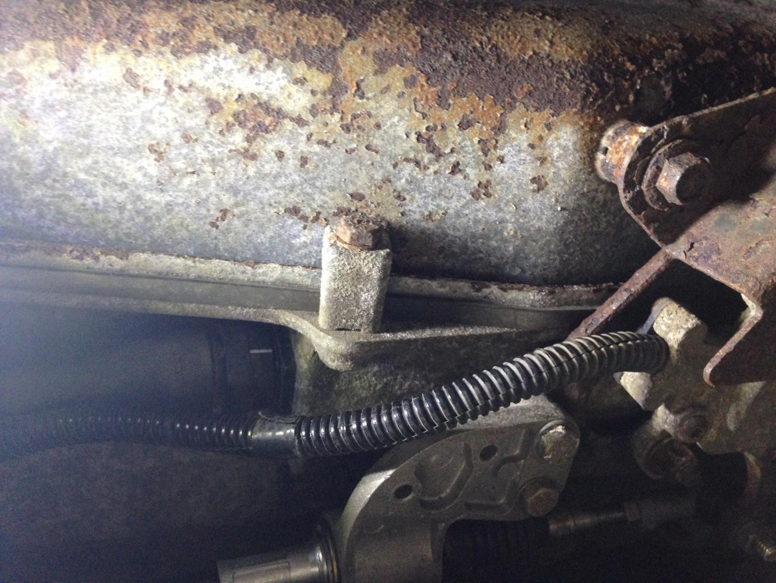

Magnificent Rustbucket Posted August 16, 2017 Posted August 16, 2017 Did you ever check the electronic plug which links the transmission to the electronic Transmission control module in the car? These Jags use the ZF4HP24 transmission, which is a strong, reliable and robust unit. Corrosion on this plug is a bit of a weak spot however. It is far from uncommon and can throw up all sorts of strange behaviour in the transmission. If you remove the plug and clean the contacts, you may find the transmission will work properly. The location of the plug is shown in the photo in this post - the car is being viewed from the left hand side. The plug is the round thing below the two other cables and immediately above the sump. This is an XJ40, but the X300 will be very similar. I'm sure the Haynes manual will detail how to do this too. https://www.xj40.com/viewtopic.php?t=6659 oldcars 1
Cheezey Posted August 16, 2017 Author Posted August 16, 2017 Just nipped out for a look and a crawl underneath. Found the plug. It's pretty tight. Not sure I'm brave enough to try taking it out and getting it back in again. I'll see how I get on selling it. If the gearbox is holding back selling I'll try and get it on a ramp to get at it properly.
Guest Hooli Posted August 16, 2017 Posted August 16, 2017 There's the problem, your gearbox is upside down!
Cheezey Posted August 16, 2017 Author Posted August 16, 2017 It's the plug with the white line on it.
Guest Hooli Posted August 16, 2017 Posted August 16, 2017 Yeah I spotted that from Ruskbucket's post, I've never done the job so no idea if it unplugs/clips/just pulls etc

Magnificent Rustbucket Posted August 16, 2017 Posted August 16, 2017 I haven't ever done this either - my car was the same as Hooli's in that it had the ZF4HP22 with a transmission cable. Do you think it might be held on with a collar which unscrews? If you do decide to tackle it, Haynes may say if it unscrews or pulls out. I have the Haynes, but have no idea what I've done with it! Good luck with the sale, either way.
Cheezey Posted August 16, 2017 Author Posted August 16, 2017 I suspect it unscrews. I had a quick look at the Haynes gearbox bit the other night but couldn't see anything. Might look again. Thanks for the sale best wishes. I'd be up for a swap but not sure I can be bothered with crazy gumtree offerings. eddyramrod 1
