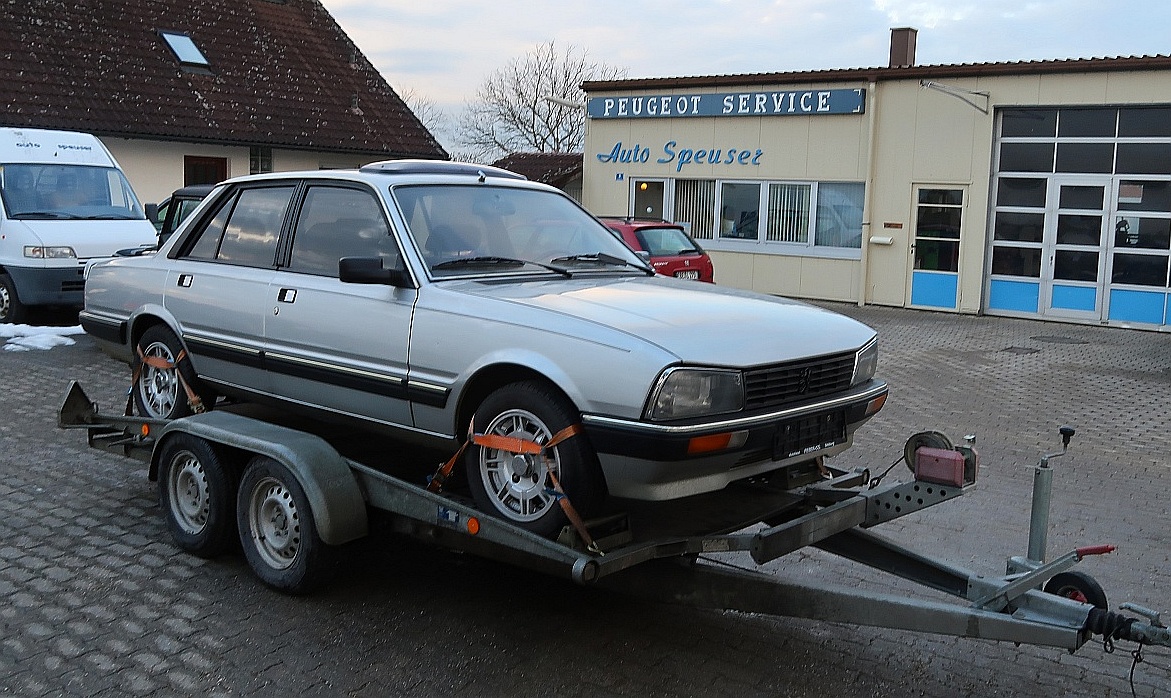

Home!

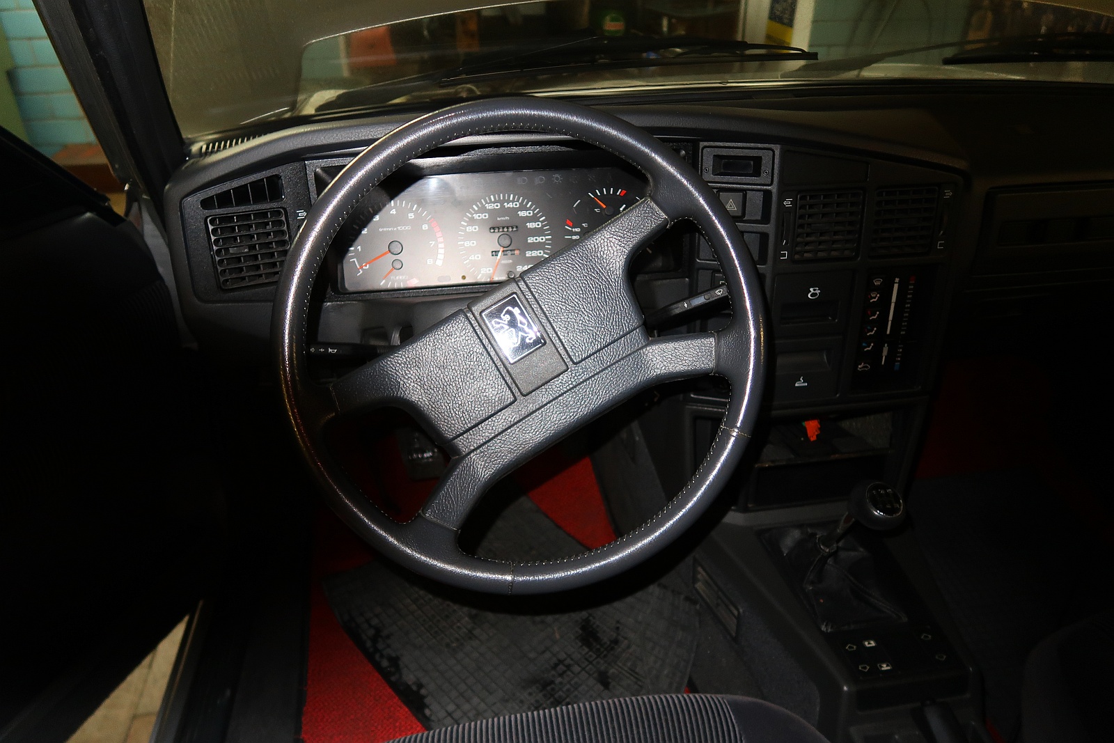

Careful examinination finds nothing wrong. Faultless all over, even electric windows, central locking and speech synth thingy work.

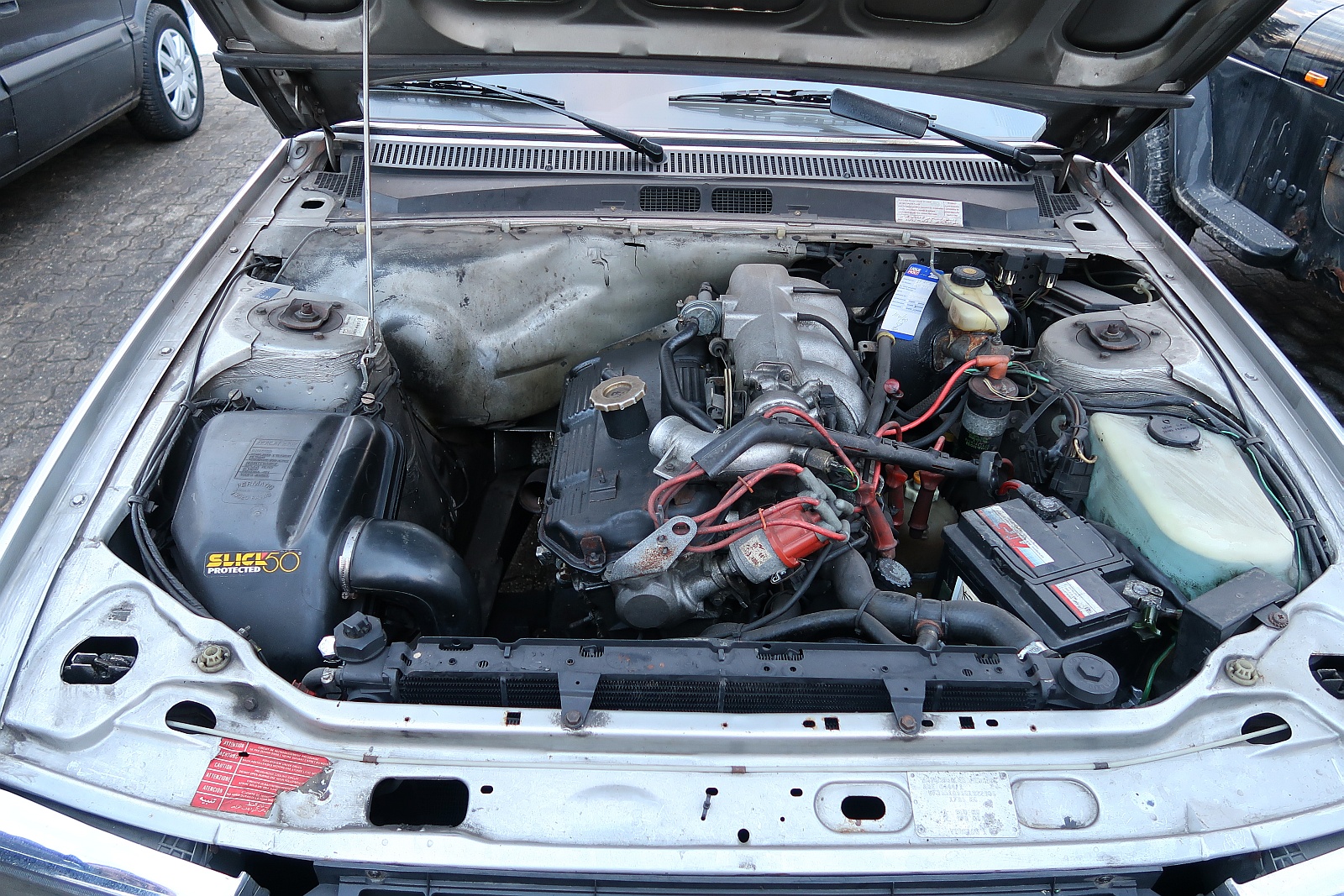

So what did we expect to bring home today? According to the previous owner, a 1986 Turbo 505 with the second version of the engine, 160hp with intercooler. Paperwork confirms this.
The first generation was without intercooler at 150HP. There was a later variant with 180HP which is pretty rare because it quickly dissapeared in favour of a catalysed version taking it back to 150HP. At the very end of the 505 Turbo  career, a catalysed version with 174 HP appeared 1998 with only few cars being delivered in Europe.
So what did we actually get? A car with chassis number 1922905.
This clearly makes it a 1986 model, even though a very late one.

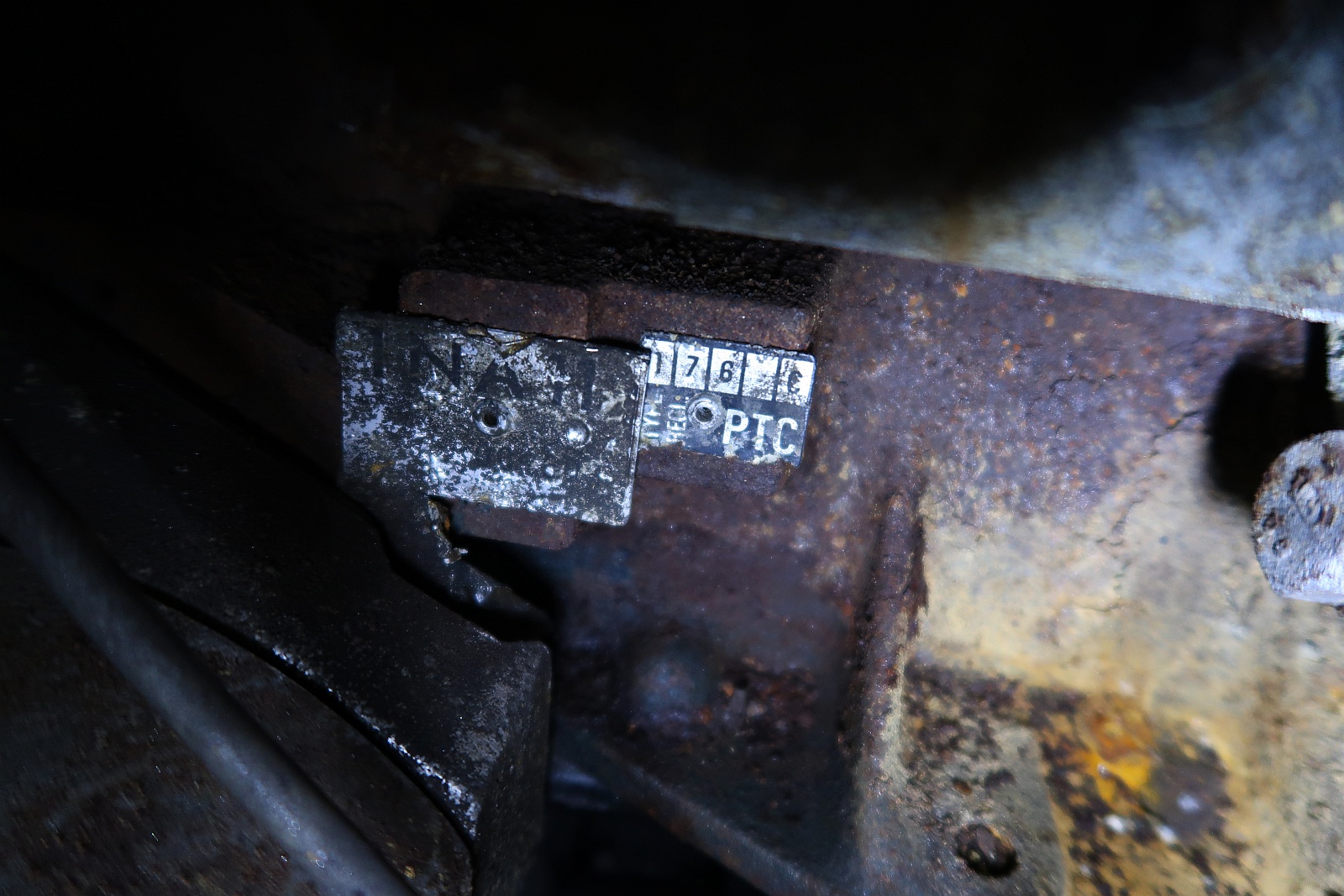

Let's check that engine ID plate:
1NA11 176 C it says.
Quick look at the reference book:
Seems Peugeot was so kind to install the 1987 180HP engine into the last of the 86 models.
Grin, smile, happiness.

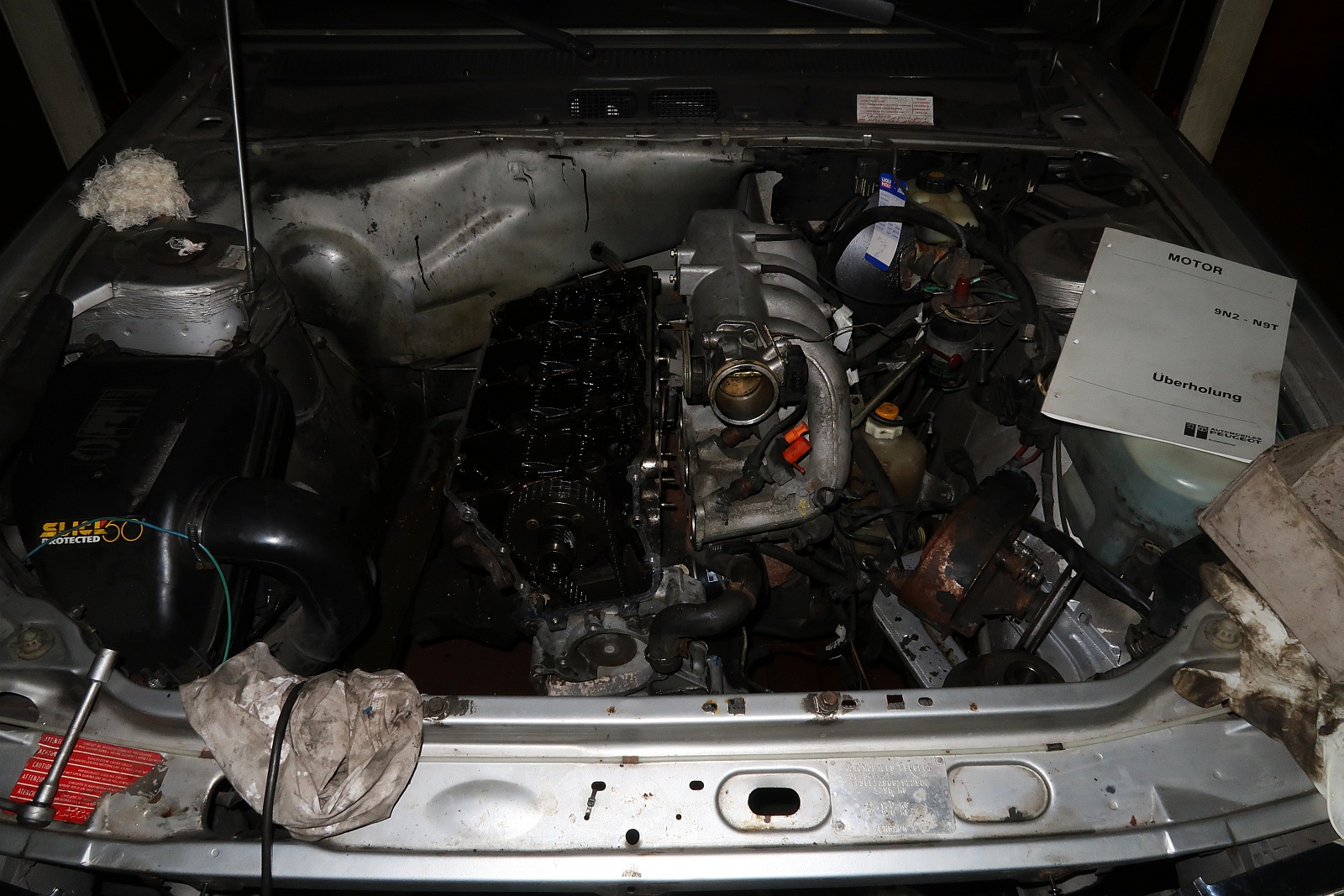

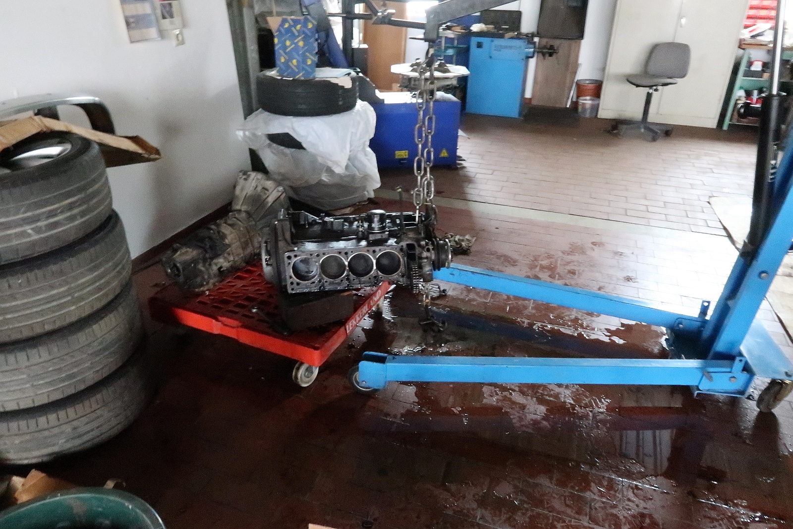

head off...
cylinder 2 converted into a swimming pool.
Is it maybe only the gasket?
nope...head cracked

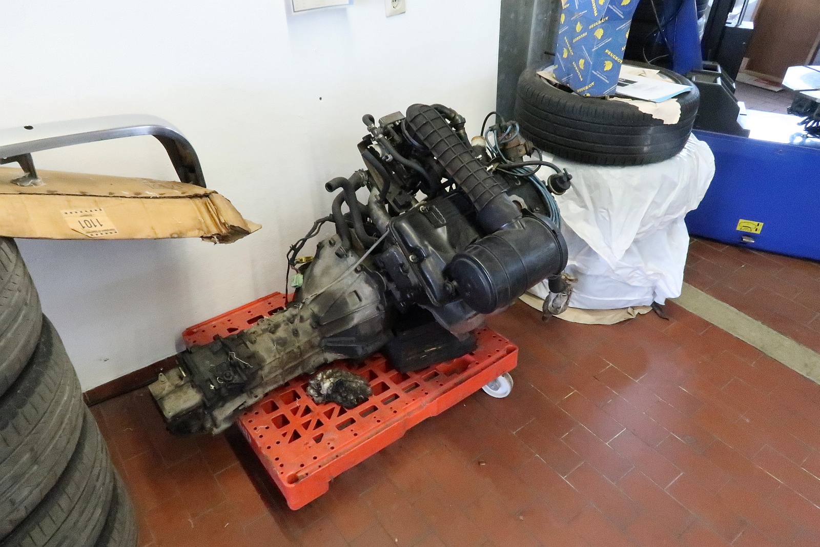

Good progress made today.
Tagora donor engine...
is now headless.
505 preped and eagerly waiting for the "culasse".

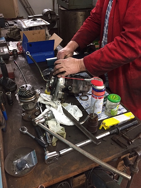

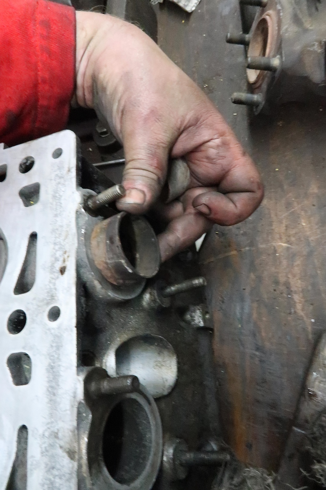

Now things started to not work out as smooth as we thought.
Nothing here to fix that last bolt?
We decided, it's a typical case of french overengineering! if 8 bolts are good enough for a Tagora, 505 will run just fine with that.

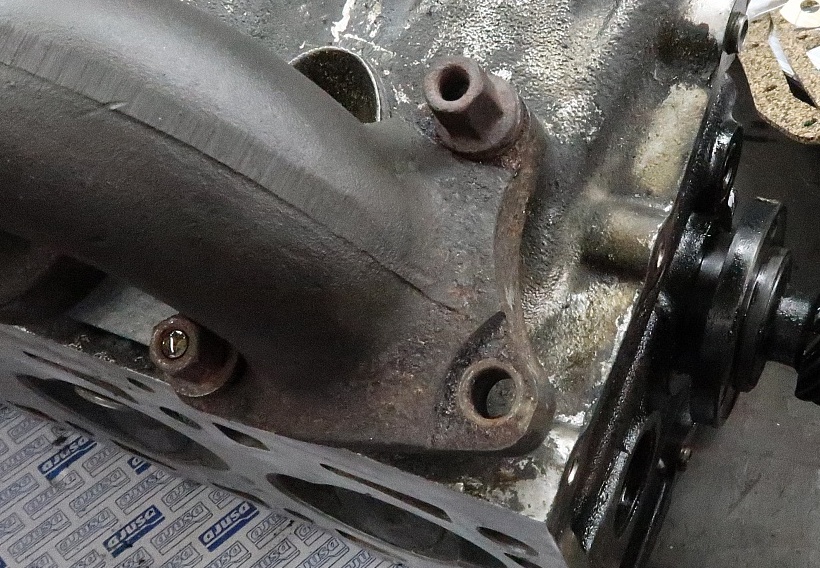

We found those rings in a box. To strenghten the exhaust manifold that holds the Turbocompressor?
Won't fit,  no groove milled into the Tagora head! That Garrett turbo is not that heavy, is it? French overengineering!
One more... spot the difference:
505
Tagora
Yes, you got it, 9 bolts to fix the injection is french overengineering, 8 will do.

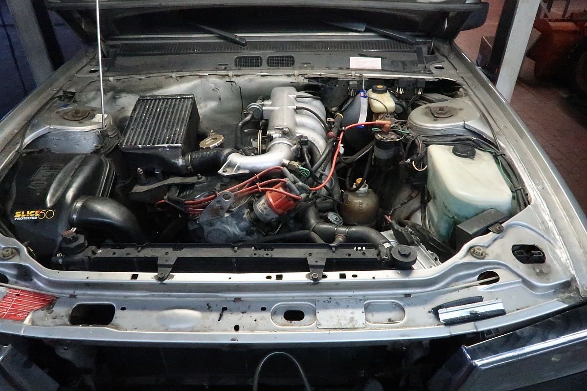

Moving ahead today.
All the Turbo bits and some more came in a box, puzzling puzzle..
At the end, all is in the (hopefully) right place.
Time to turn the key...
Yeaahh! Its back to live!
