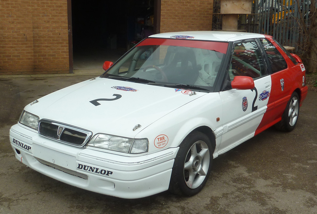

I have a friend who has a 216i race car and asked where you managed to get your head gasket from at short notice?

Six-cylinder: it was thegasketshop.net. They have an eBay shop too.
For my D-series, it was about £33 delivered within two days, for rocker cover, both manifolds, HG, spark plug bore holes in the rocker cover, and a couple of other bits I'm not quite sure what they do.

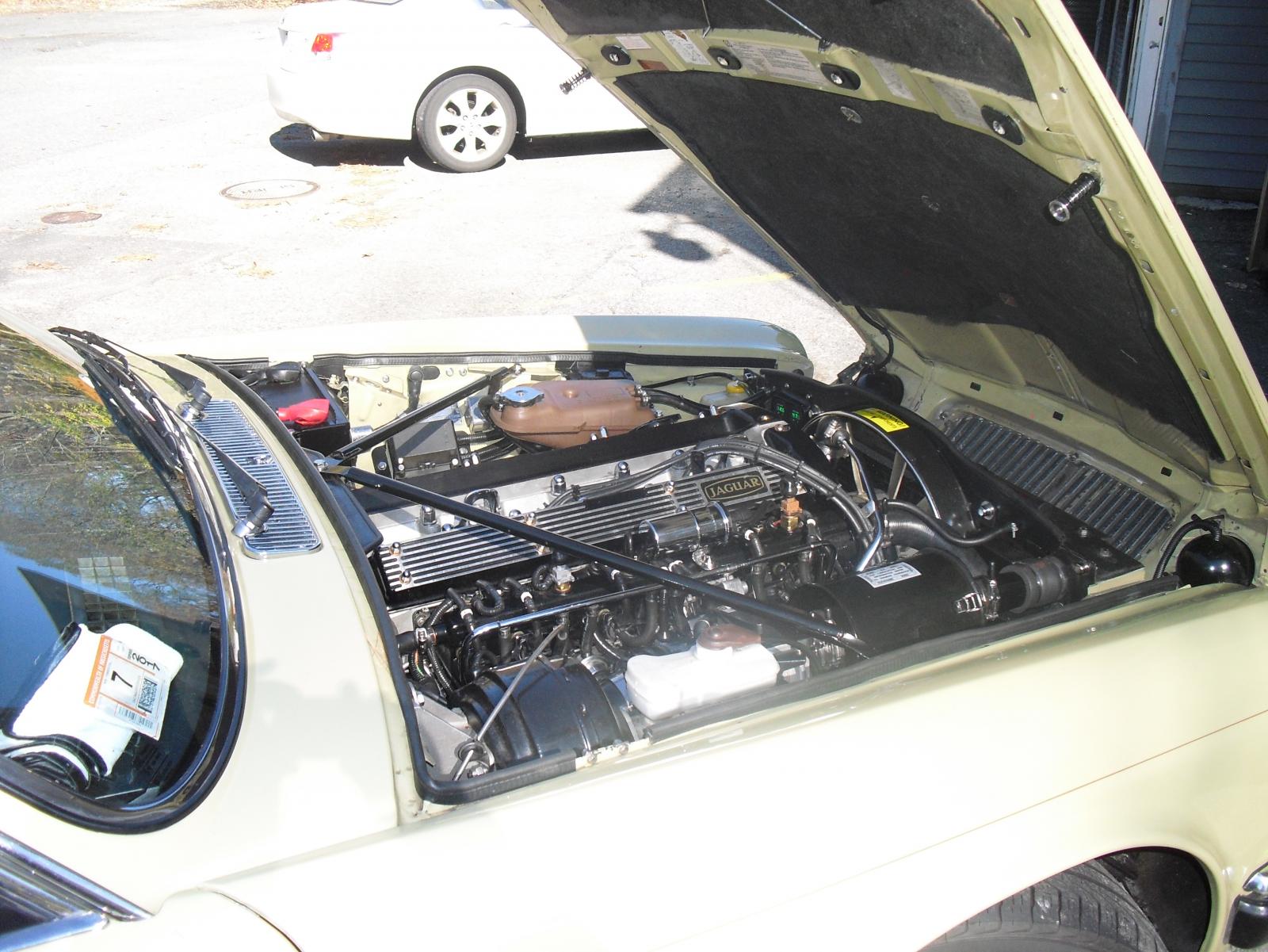

Yup, a buddy of mine did during the summer. Rebuilt 4.2 straight 6 jag engine with about 10 thousand on it..........It started to leak at every single pipe joint on the engine, heater matrix even the temp sender. It searches like fook and we couldn't cure the leaks, then it even found its way past the head gasket. Some research revealed special sealants required and on some engines the head skimmed and block decked to super fine finish..............AVOID.
