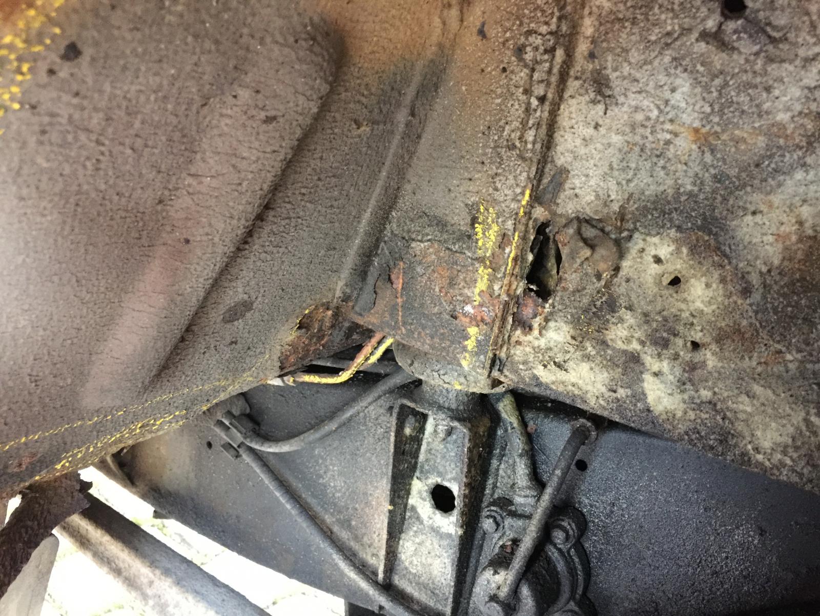

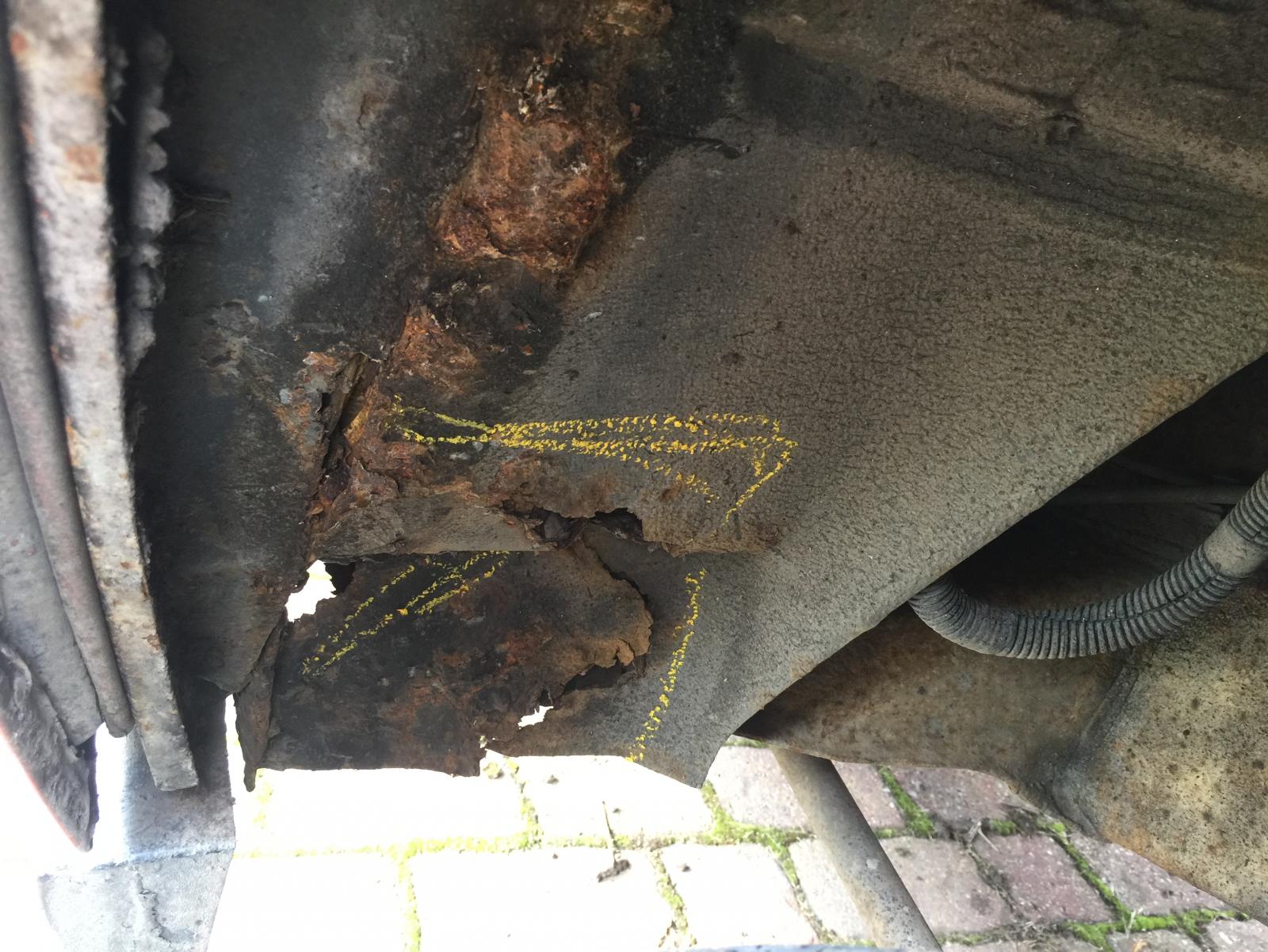

there seems to be a lot of duplication in that report, were they making a separate note for every single hole?
It is just the body that is rusted or does the chassis need remediation also
Reading inbetween the lines;
rear crossmember,
both sills and probably all 4 sill mounts,
rear wheel arches,
front footwells, bulkhead mounts?
and front inner wings (which are NOT structural)
Plus a couple of brake lines and need for a new air filter and italian tune up
Boot floor as well, by the look of it. The inner wings are a fail if they support brake lines IIRC.
All in all, I suspect that would be hundreds of hours of grinding, welding & fabrication (less with aftermarket panels but they're expensive & often gash) for a DIY welder.

I've had some rusty old Discos before, but even the most unfriendly non-LandRoversavvy garage has ever condemned one that badly.

Problem is when you start pulling bits off you will find more rot.

I would get it on ebay. For someone with the time to weld it, it's not a costly fix it's mostly labour so would still be relatively attractive I think.

I think it's had a rather harsh MoT and doing most of the 'usual' RR repairs will have this one back in the black quite easily..
I've welded worse.
.. and I'm not joking.  A friend's RRC that was a right bitsa:  It had a 1986 "C" chassis, with a 1994 body on it and the 200tdi out of a 1992 Discovery 1.  He put it in for MOT and got a fairly similarly long fail list.  That needed a new body rear crossmember, a new rear floor (and they're not available, you have to modify a Discovery one, and they are not the same) and a fairly large amount of fabrication on the rear arches and rear door slam panels.  It used almost an entire 15kg reel of welding wire to do so, and about 3 months of odd weekends to get it done, but it is all do-able.
I think he realised it was going to be a big weldathon when I tugged on the rear seatbelt bottom mounting (the one into the top of the rear wheelarch) and pulled the 4" square stiffener plate clean out of the car.
Don't feel bad AMC! There's a week of welding and fabrication there. I'd go with entire sills from YRM and patch up the rest. It's not a quick fix by any means, but an enthusiastic mental could sort it.
At least you know what the death wobble was now, the body clonking around on the chassis  :mrgreen:
The inner wings only have to be solid within 30cm of the pedal mounting point, or front body mounts behind the bumper- an odd patch here is fine.
