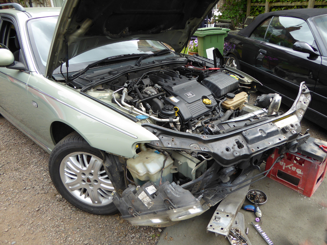

Not ideal I know, but fan replacement with all the gubbins is a front bumper off job.
Don't worry, I have a list of jobs to get done on mine somewhere and it looks like a new loo roll, the fan replacement is on there somewhere near the top!!

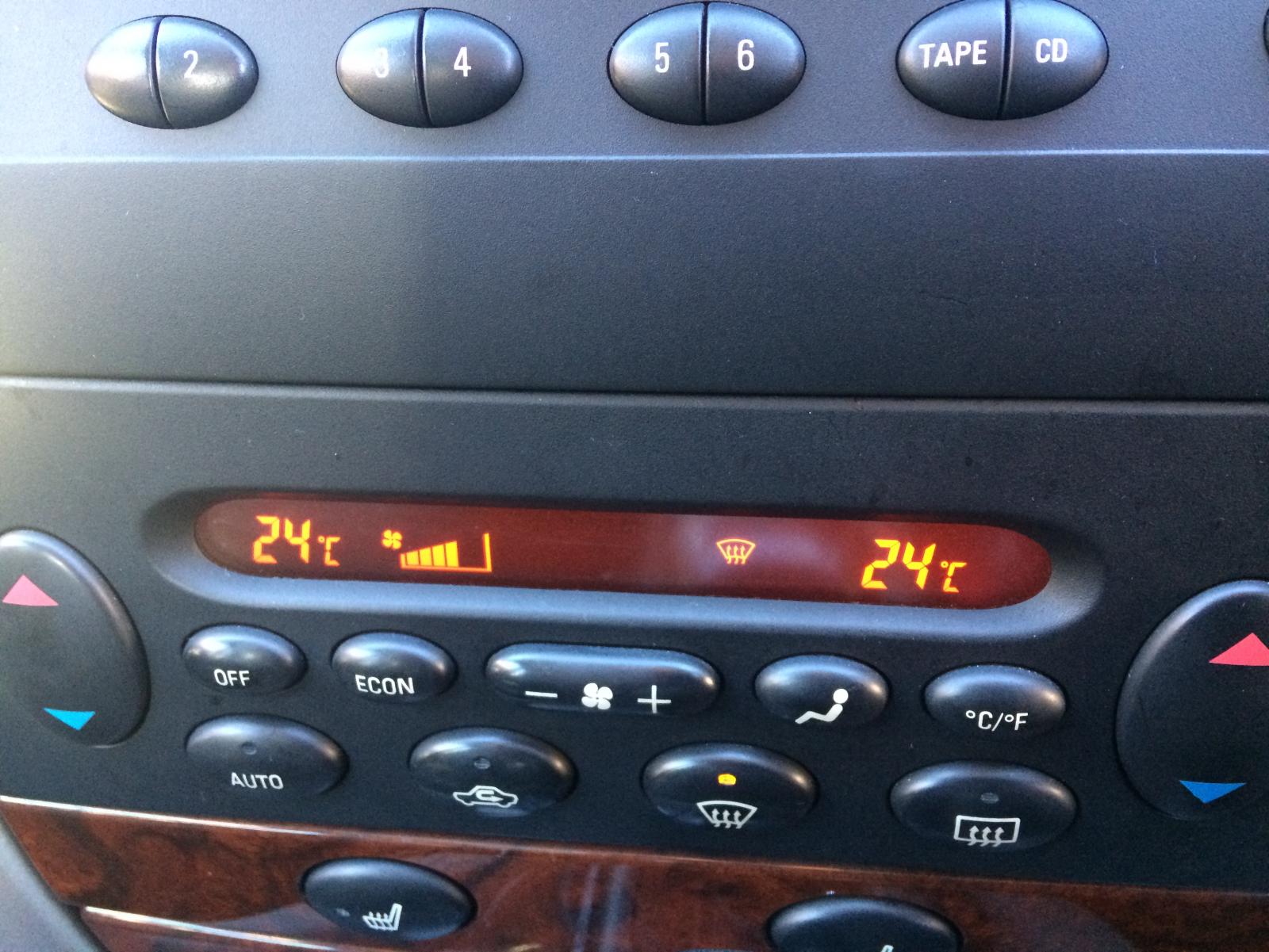

Did the fan come on with aircon switched on 'LO' and econ switched off?  Not ideal in the middle of January but this should force your fan on Mr Borne.

Excuse my ignorance, but the air con. Is it always ON unless you hit ECON? I need to read the manual really, but I'm tied up reading the book on BMWs take over of Rover. (!)

Yes air-conditioning only off when Econ showing :)
If you press auto it will revert to aircon

I am going out in mine tomorrow, i will take a snap and show you what you should have displayed Mr Bourne for the aircon to be ON and econ switched OFF which should give you some KV6 hardcore 'fan action.

Right, I have been fiddling about with this today, so as I did suspect you don't actually need the aircon.
Press the demist button (lit up 2nd from the right) then press the 'econ' button to switch off econ so you see the same as below, this forces my fan to come on.
If this does not work then try taking both temperatures right down from say 24 (or whatever yours is on) to 'LO' and see if that makes it come on.
In all cases econ must be off.

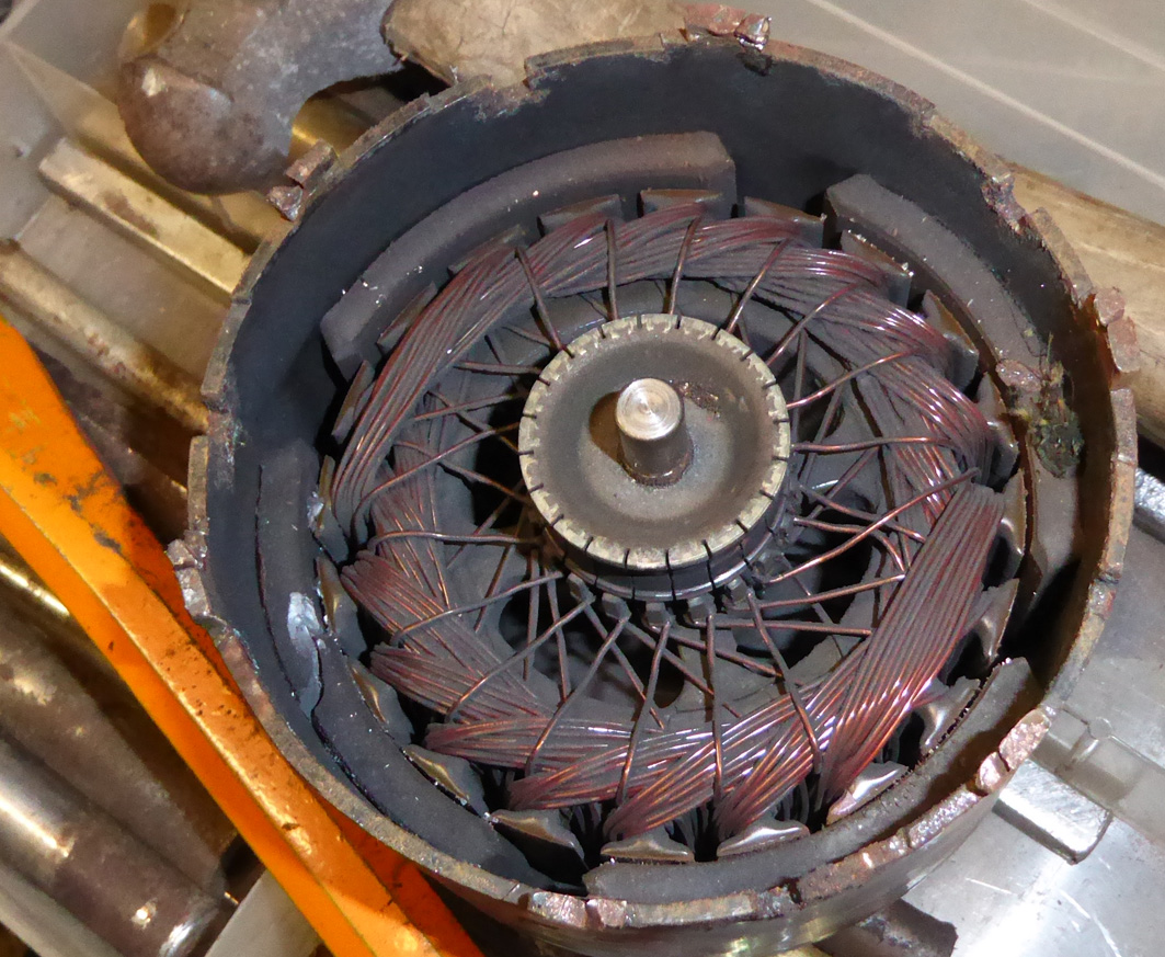

I have only just caught up with the fan story, In June my 75 was used as a slave car for Shitefest 2016, in July I went to Aylesbury queued in traffic and everything was fine, 2 days later I lent the car for a trip to Buckingham and fan had stopped working. I called for an Auto electrician who said he needed to take the front of the car apart to check it properly and the verdict was dead fan. After he had finished it looked like I had crashed the car!
I managed to get the motor apart and found the brushes were very worn. I managed to buy some replacement brushes much to my delight, but when I went to reassemble it I found I had cracked a permanent magnet the motor. In my defense the motor is not designed to come apart and has heavy metal tags that are slit and splayed and take a lot of force to move them. I had to give up with that motor.
After several weeks of searching I found another fan assembly and had the Auto electrician put it back together for me. It all works perfectly now and seems no harm done in spite of boiling when the fan first failed.
