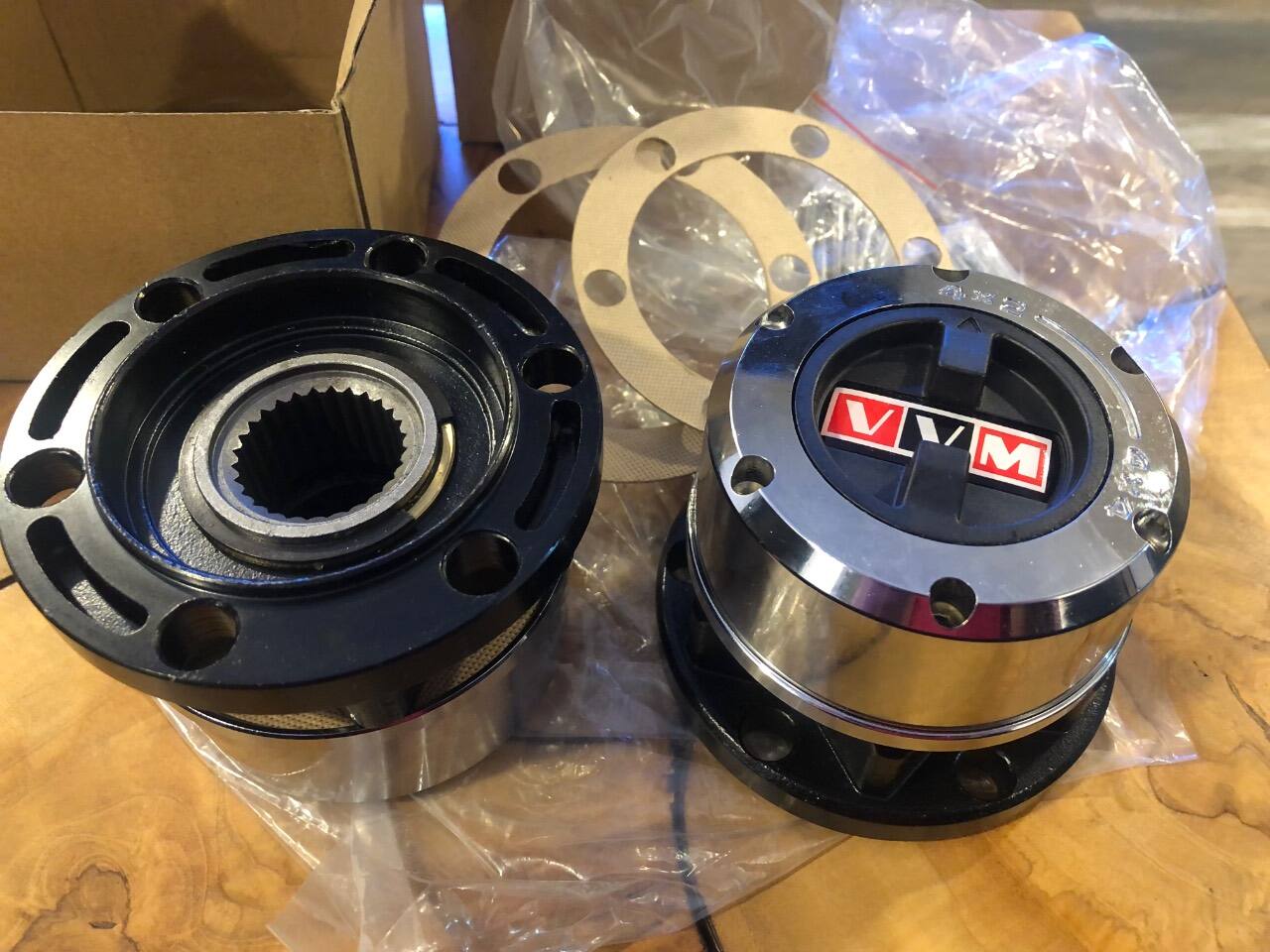

Out Run Posted January 21, 2022 Posted January 21, 2022 Fitted the freewheel hubs and have been out for some local green laning. Fully functional 4WD again. All is well. China's finest. 👌 I need to remove the towbar and it's desperate for some taller tyres and a lift. IMG_6250.MOV Jim Bell 1

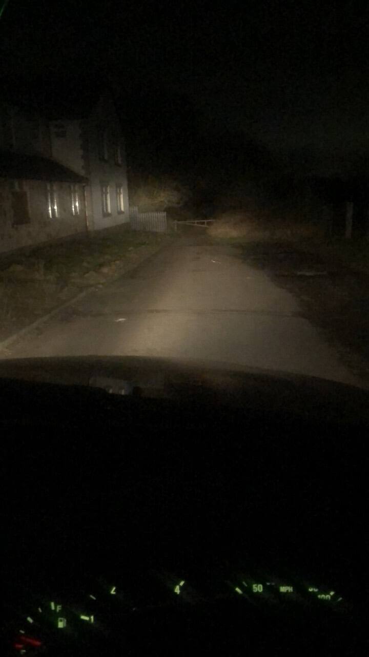

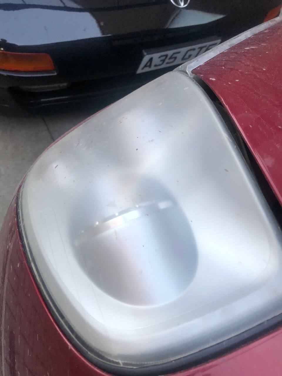

Out Run Posted January 29, 2022 Posted January 29, 2022 So, old, plastic headlights... I had restored these a couple of times before, but I never protected them. So they degraded again and the light output was laughable. The first time, properly and then In September '21 I done a so-so job on them and UV lacquered them for protection. A mistake. This does not work. So I bought another 3M drill kit and completed the stages. But I was also keen to protect them again. I settled on another 3M product; Quick HEADLIGHT CLEARCOAT. This comes in the form of a folded wet wipe of sorts, you apply two coats, the clear film hardening to an invisible finish. Hopefully it lasts a while. You can see how 'frosted' the lacquer had made the surface and check the output from the dipped beam when the lenses were lacquered (van pic) and now. ERMAGHERD, you can even see the beam pattern in built up areas. Just like a real car - with ancient headlights. I'm calling that a win. Asimo, dome and Jim Bell 3

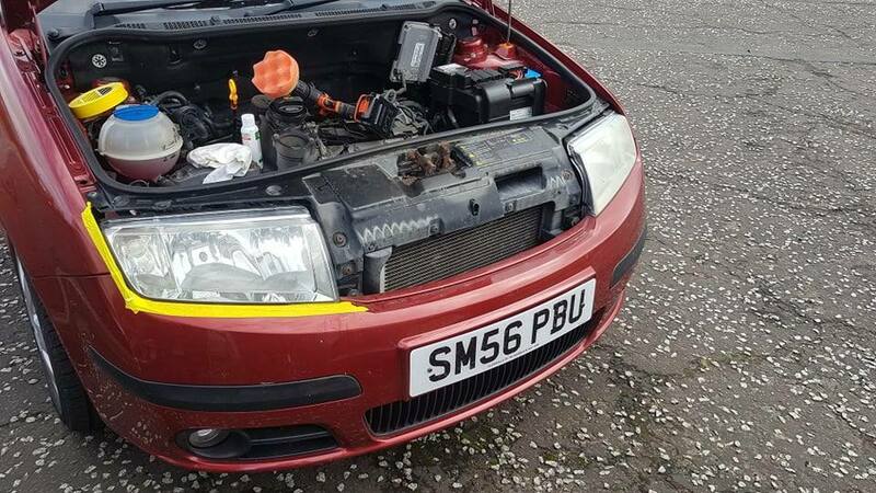

AnnoyingPentium Posted January 31, 2022 Posted January 31, 2022 Good call on polishing headlights. Makes a world of difference... However, the best choice was to just do this... I don't know if you can do such a thing as replacing light units on the Rexton, as I don't imagine they make new units for the car. Out Run 1
Out Run Posted January 31, 2022 Posted January 31, 2022 1 minute ago, AnnoyingPentium said: Good call on polishing headlights. Makes a world of difference... However, the best choice was to just do this... I don't know if you can do such a thing as replacing light units on the Rexton, as I don't imagine they make new units for the car. Good shout, mate. Worth doing if you can, for sure. TBH, you probs can get new ones. Or maybe Aliexpress has my back with some crazy LED things. I'll have to look. I'm more than happy to spend an hour on them, as they come up like new - it's just when you can't seal the protection in, that sucks. Hopefully those 3M wipes do the bizzo! AnnoyingPentium 1
AnnoyingPentium Posted January 31, 2022 Posted January 31, 2022 1 minute ago, Out Run said: Good shout, mate. Worth doing if you can, for sure. I just changed the units since although the polishing made the difference, the reflectors were getting a bit past it. 1 minute ago, Out Run said: TBH, you probs can get new ones. Or maybe Aliexpress has my back with some crazy LED things. I'll have to look. DRLs? Be like a yoof. Haha. Out Run 1
Out Run Posted January 31, 2022 Posted January 31, 2022 3 minutes ago, AnnoyingPentium said: I just changed the units since although the polishing made the difference, the reflectors were getting a bit past it. DRLs? Be like a yoof. Haha. Ah, dying reflectors is basically game over, yeah. Ze Germans could learn a thing or two about build quality from the South Korean's. 👀 Found some. Bargain* AnnoyingPentium and Jim Bell 1 1
