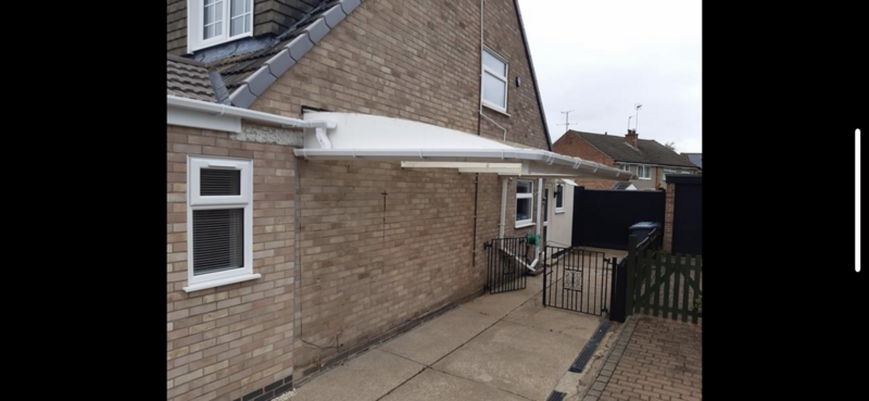

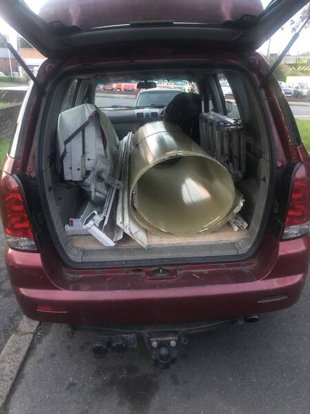

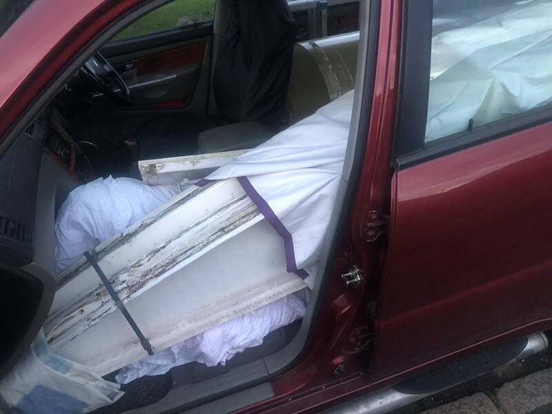

Out Run Posted July 14, 2020 Posted July 14, 2020 Went for the single seater configuration today. It doesn’t look like much in there, but that’s a 5m x 2.5m fibreglass car port - swallowed. This will do me a good turn, for sure. Cheers again for all the help @Jikovron Onto the next challenge, Rexton! ProgRocker, Lacquer Peel, Dave_Q and 3 others 6
Cord Fourteener Posted July 14, 2020 Posted July 14, 2020 Someone needs to scrap airliners now no one uses them. Reckon an Airbus will go in there? Out Run 1
Out Run Posted July 14, 2020 Posted July 14, 2020 3 hours ago, Jim Bell said: Is there nothing that won't fit in it?! Maybe another Rexton? Jim Bell 1
Out Run Posted July 14, 2020 Posted July 14, 2020 2 hours ago, Tim_E said: Someone needs to scrap airliners now no one uses them. Reckon an Airbus will go in there? I reckon so. Wings poking out of the rear door windows, tail out of the tailgate glass - only an A320 though. Jim Bell and Cord Fourteener 2
Cord Fourteener Posted July 14, 2020 Posted July 14, 2020 4 hours ago, Out Run said: I reckon so. Wings poking out of the rear door windows, tail out of the tailgate glass - only an A320 though. You can't squash in an a350 then with your foot, ratchet strap the boot over the tail? ?

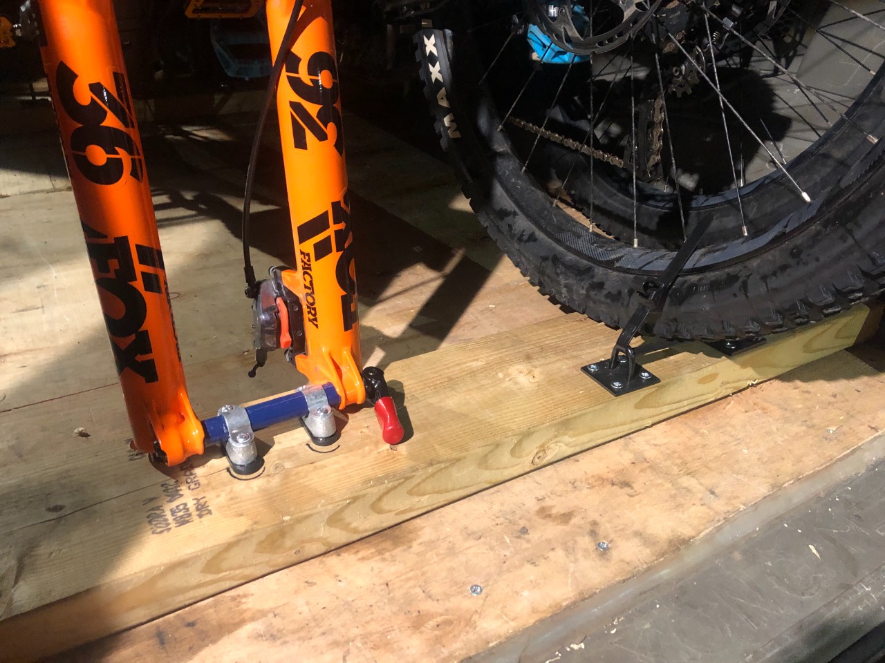

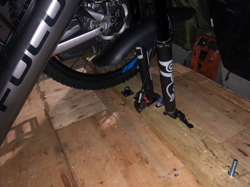

Out Run Posted November 20, 2020 Posted November 20, 2020 Remade the bike carrying system. Now loads stronger, easy to remove and just as importantly, EMTB friendly. Happy with that. Ghosty, Mrs6C, dome and 3 others 6

scorchio69 Posted February 11, 2021 Posted February 11, 2021 Oooooooo kashima coated forks , nice unusual bike carrier and makes a change from the usual VW,s . So is this the OM605 engine ?

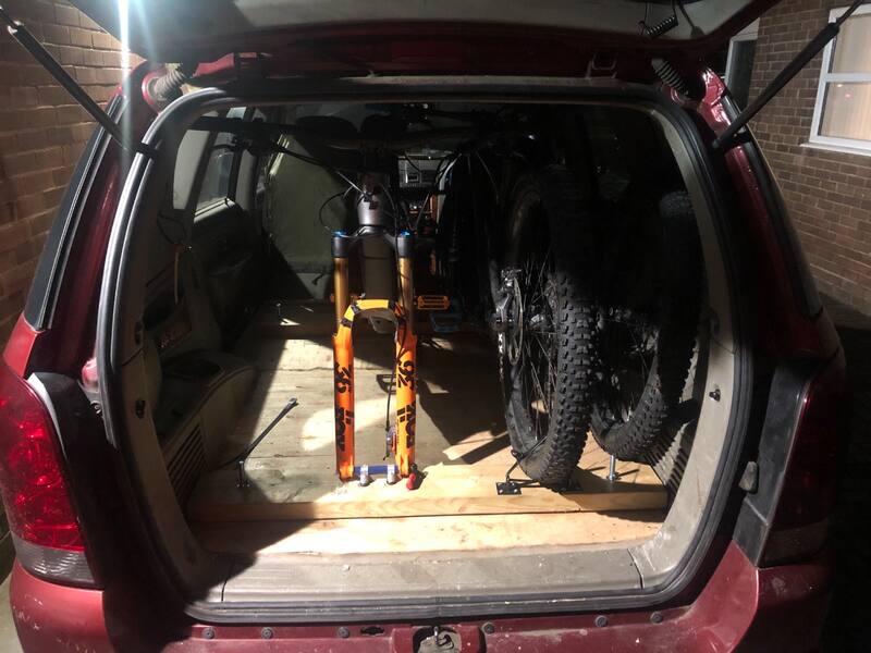

Out Run Posted February 11, 2021 Posted February 11, 2021 43 minutes ago, scorchio69 said: Oooooooo kashima coated forks , nice unusual bike carrier and makes a change from the usual VW,s . So is this the OM605 engine ? The Fox Factory's are on my mates Cube. Mine is the Focus. Both very different bikes. He has Kashina forks and seat post, I have Di2. His has a removable 625wh battery, mine has an internal 376wh and a piggy back 376wh, he has 36mm stanchions but a heavier bike, I have 34mm. His is Bosch, mine is Shimano etc lol. The truck has an OM662. They seemingly only exist in Ssangyong's. Minus 6 this morning. One cycle of the glow plugs and she purred into life. mk2_craig, Jim Bell and Lacquer Peel 3

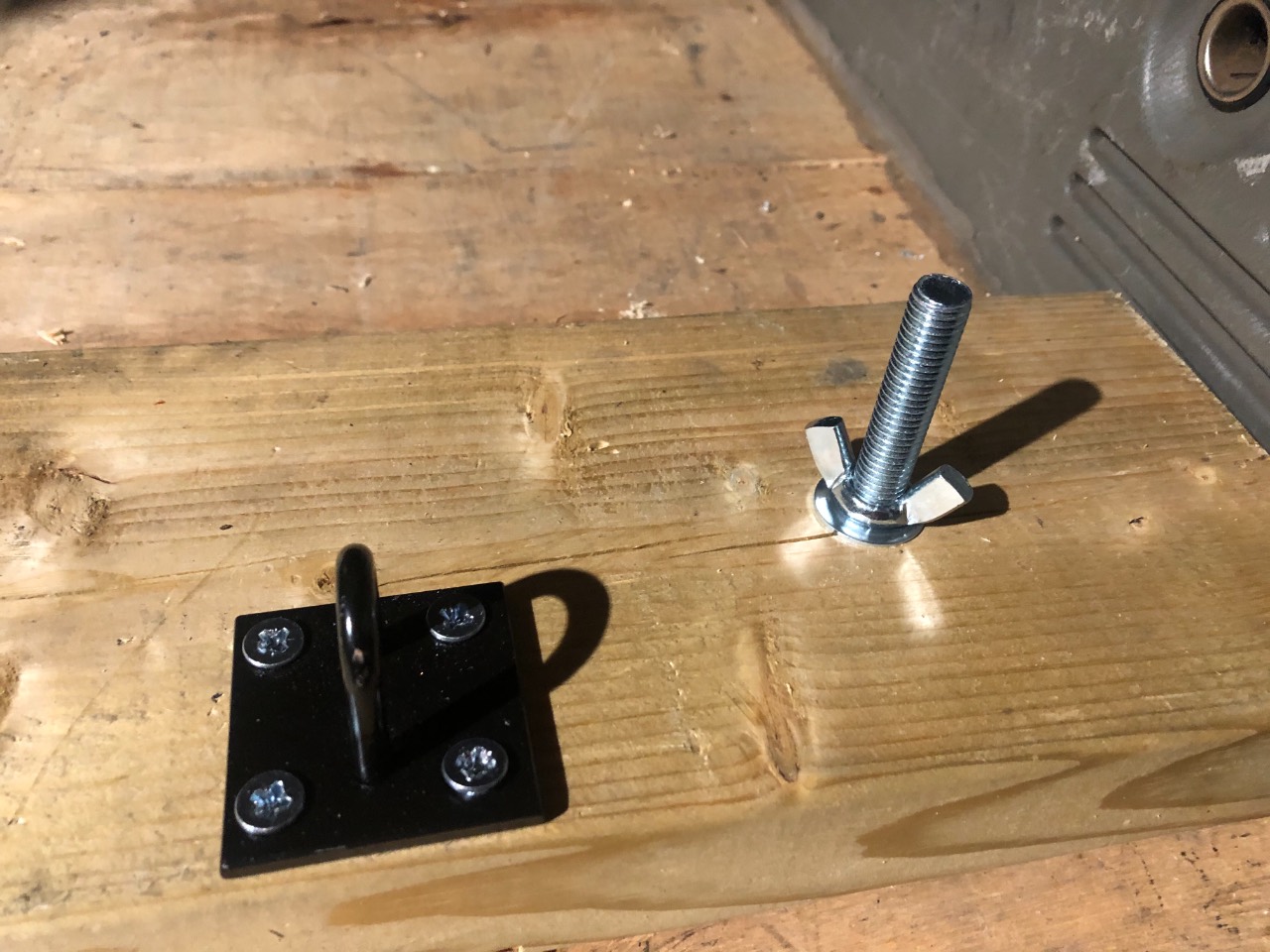

tom13 Posted February 11, 2021 Posted February 11, 2021 Is that a plastic sleeve you are using to protect your thru axle. Get more pics up. I assume they are 20-25mm pipe clamps?
Out Run Posted February 11, 2021 Posted February 11, 2021 3 hours ago, scorchio69 said: Only got a Commencal meta HT the now as the canyons are not yet available, but I have put up a few pics Cool, mate. I'll have to take a look.
Out Run Posted February 11, 2021 Posted February 11, 2021 2 hours ago, tom13 said: Is that a plastic sleeve you are using to protect your thru axle. Get more pics up. I assume they are 20-25mm pipe clamps? It's the steel tube that used to comprise my loft ladder handle. Turns out to be the perfect I.D. Yeah that's the clamps. Toolstation's finest. I'll grab some more pics. Cheers. tom13 1

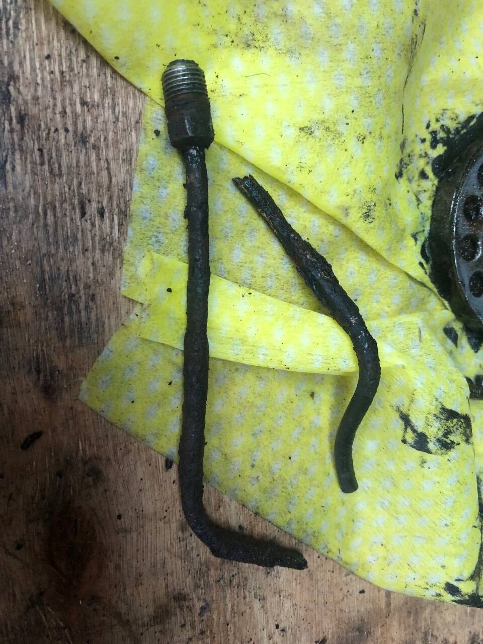

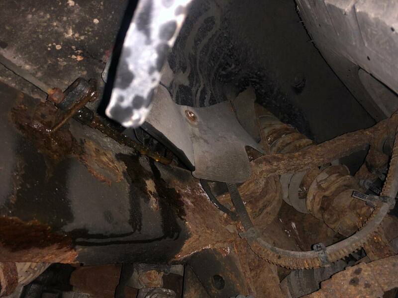

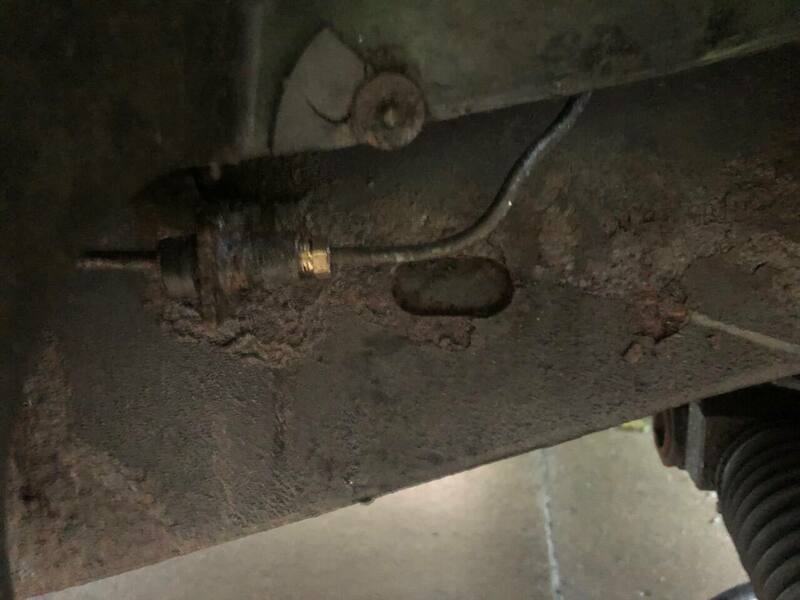

Out Run Posted December 28, 2021 Posted December 28, 2021 Had a look at this, today. The knackered brake pipe snapped when I undid the union. Turns out though that the pipe was only shot, where it is exposed for a short length and the Korean kar maker was kind enough to coil the steel brake lines up in just that area, so I pulled some more down, flared it and job's a good 'un. Maybe a bit gyppo, but it works. Compliments the manky high viz jacket I was wearing, nicely. The rest of the pipe seems decent, but I do intend to replace them all, in the better weather. Flash is on in the 'before' pic. So far from flattering. 😬 Coprolalia, Jim Bell and Dirk Diggler 3

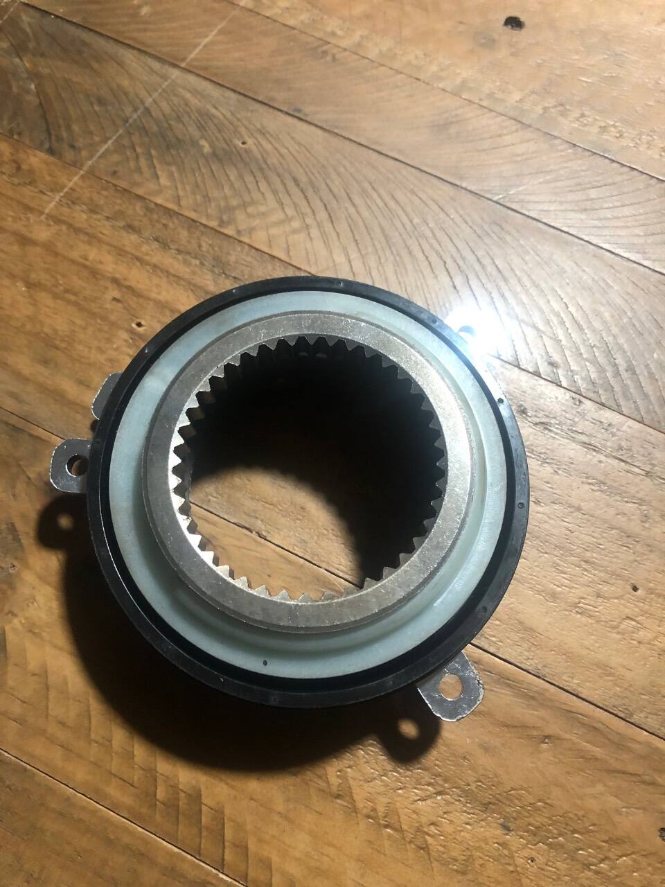

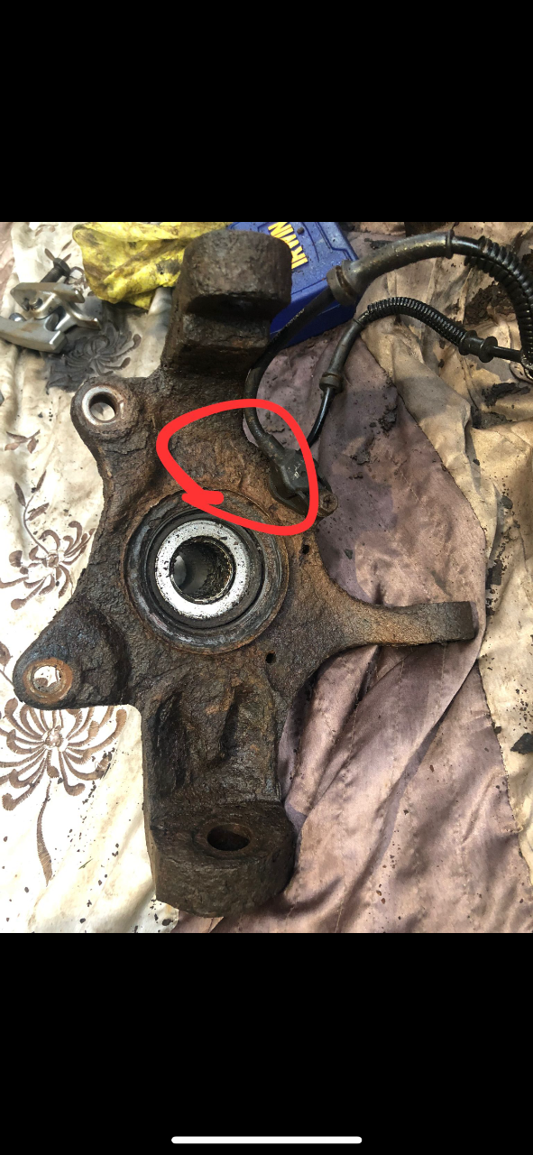

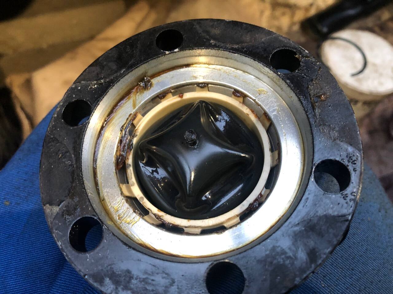

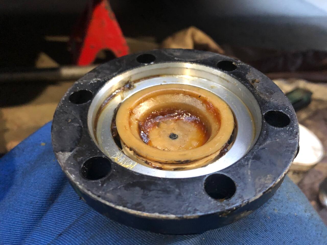

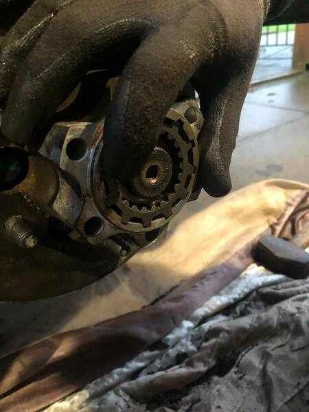

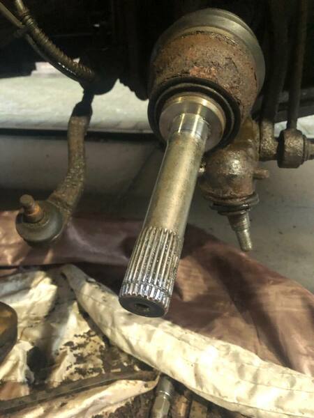

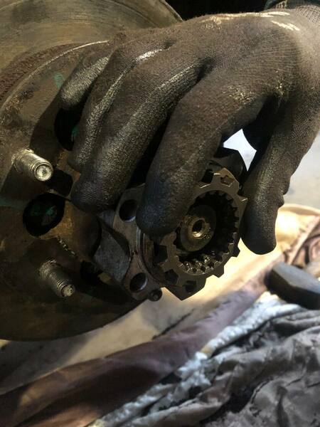

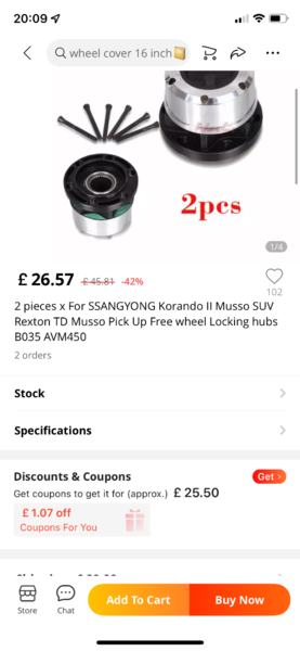

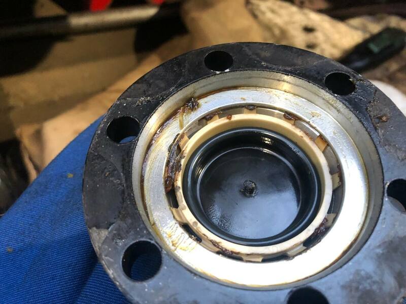

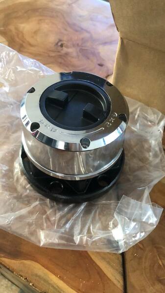

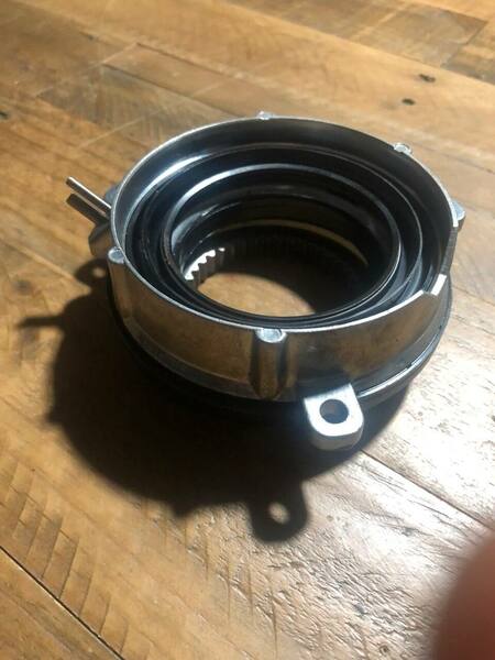

Out Run Posted December 28, 2021 Posted December 28, 2021 Had a look at the vacuum locking hubs, too. Turns out, that despite research, I have bought the wrong ones and this car uses nothing like what I have. Oh, well! I stripped the OSF down, to remove the driveshaft from the hub carrier and expected to be met with a knackered version of the shiny new vac hubs in the pics. Instead, mine runs a similar system, but it is as I first remembered, the nipple for the vac pipe is part of the upright and as can be seen, mine has rusted off - red circle in pic (both sides are the same and they fell to bits when I replaced the bottom arms, about 3 years ago). Shame it's not like the design I bought, as can be seen, the nipples are part of a replaceable part - and it also requires 2 vac lines. I KNEW mine only had the 1... The original plan was to drill out and tap or inteference fit a new bit of small OD steel tube into the uprights and reattach the vac lines, but as I reassembled it, I was thinking it would be better it the hubs locked manually. 4X4 stuff is all alien to me (aside from what I have done on this car) and as you can see, the end cap of the hub contains a diaphragm, which along with other plastic washers etc playing nicely, will act upon the hub and lock/unlock, when the dash button is pressed. CBA with attempting to sort all of that. So I'm gonna order some of the manual lockers and we should be sorted. As well as just being better, it's a lot less work and initial searches put them at £150/pair on eBay, but after 10 mins searching, I'm pretty sure I can get them for £60 delivered, from Aliexpress. Win win. Jim Bell 1
Out Run Posted December 28, 2021 Posted December 28, 2021 As can be seen, that bolt-on vac hub is never gonna fit this 28 spline driveshaft. Luckily, there is an alternative. loserone, yes oui si and Jim Bell 3
