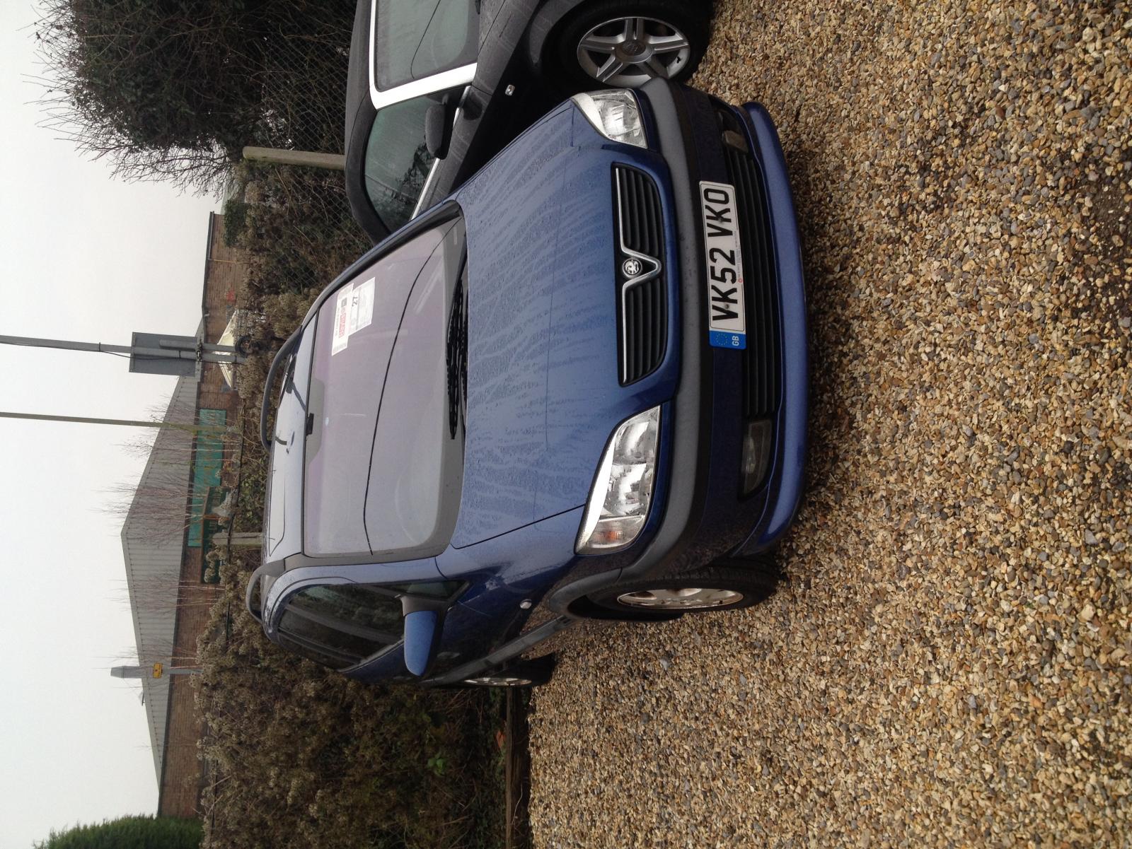

There she is!!!!
post-20636-0-55924400-1482660151_thumb.jpegpost-20636-0-55924400-1482660151_thumb.jpeg
Oooooooh is that a GENUINE IRMSHURRRR SPLITTTA I spy? Shamazing?
And a genuine exhaust? Man alive this seems to be getting better and better!!!!

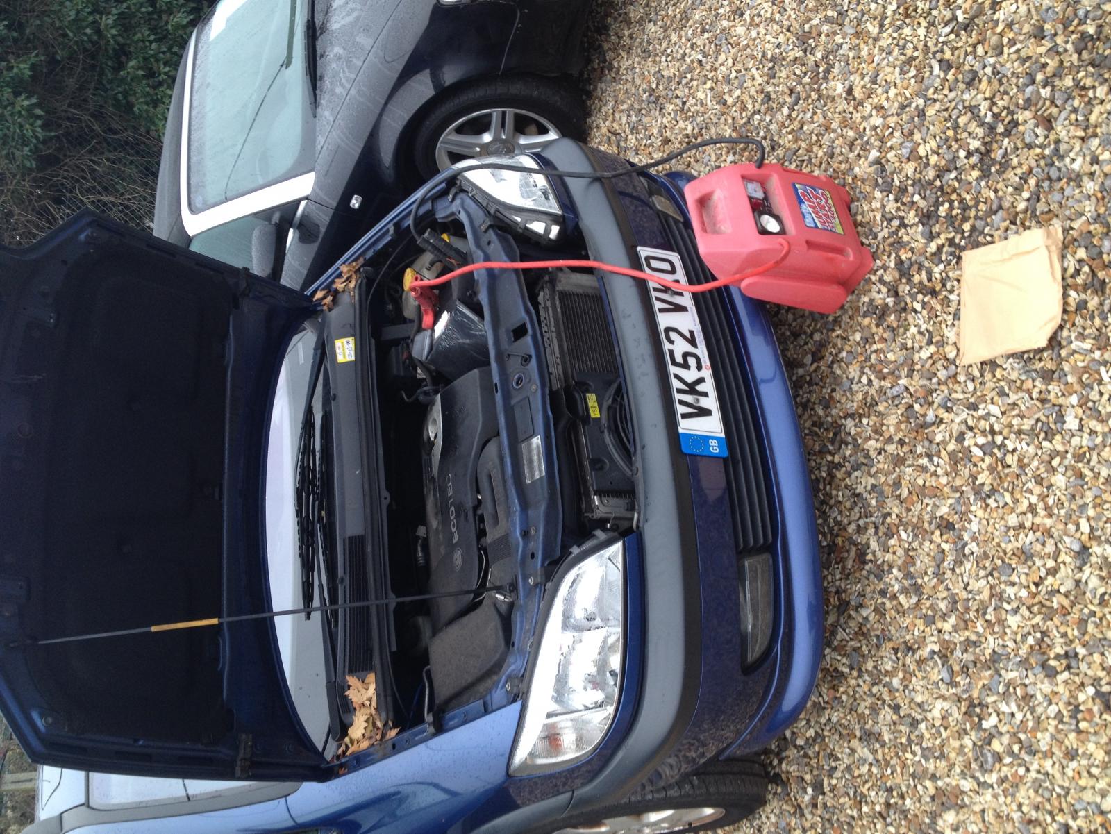

So after getting me home and the starter failing I took it off Xmas eve as you do and found it pretty much packed with grease 😩😩
Despite a good clean as soon as I dismantled it two brushes just broke off, time being of the essence a new one was ordered from euro for £85 which I thought was fair.
However with the festivities etc collection was not available until the 28th of Dec, ironically the day I was due back into work for a 3 day shutdown and I work in Swindon 120 miles away starting at 6am.

So changed starter in the street, lying in leaves, on a freezing foggy December day with only a constantly failing iPhone 4s for light, frozen hands etc but despite that it did work ok, started it up, still missing like a pig.
Read codes, cylinder 3 misfire.
T'internweb seems to all point to coilpack, makes sense.
Euro want £100 which seems fair but I've seen a few for sale 2nd hand that maybe worth a gamble if it's something else?
Haven't ventured beyond checking anything else as my hands had literally frozen up.
Any ideas/suggestions of a suitable coilpack donor or bite the bullet and buy new?
