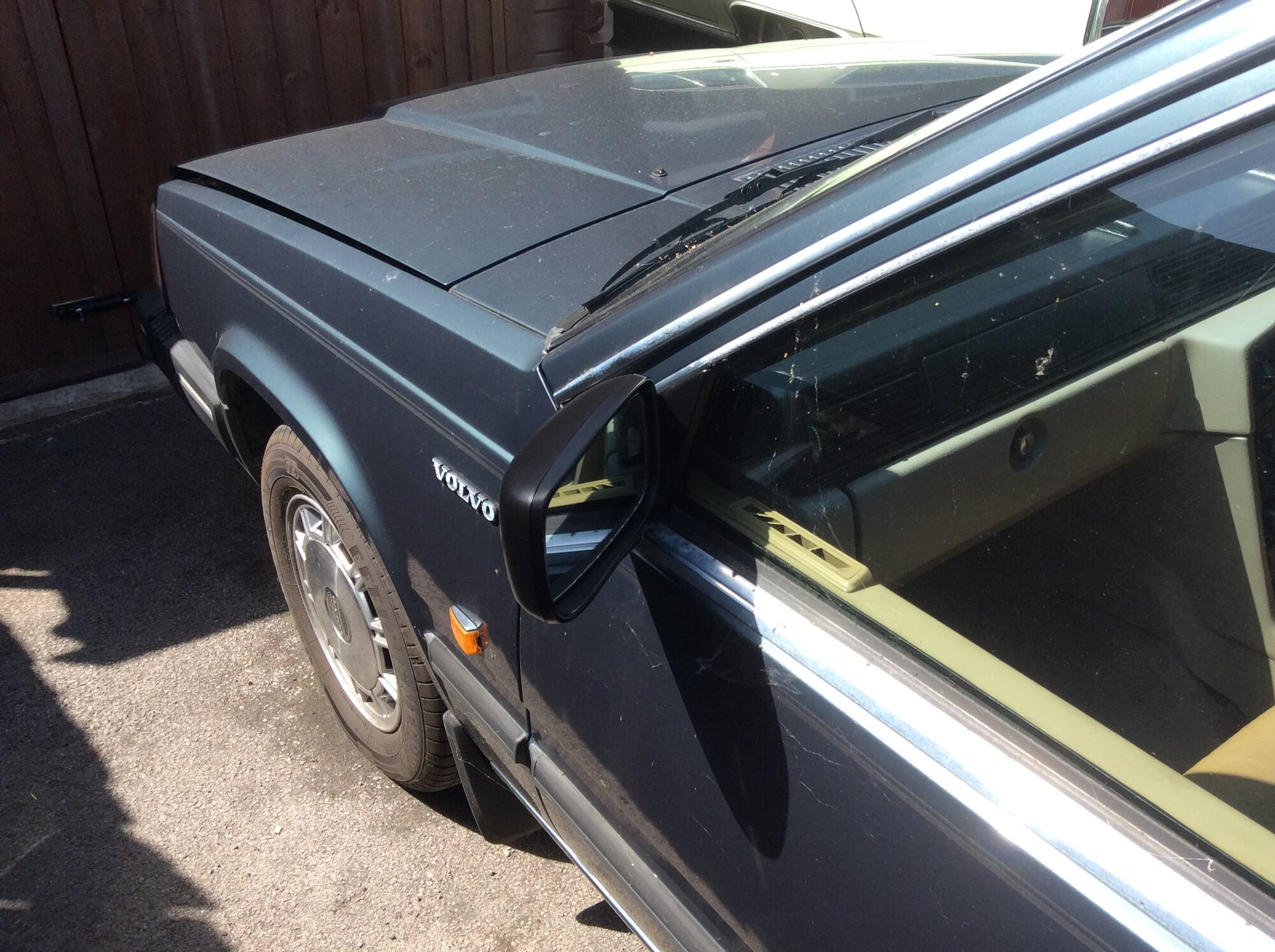

Sadly though the other day it took a bit of a knock. I was on a narrow lane and some idiot coming the way decided to overtake a bicycle as I was coming the other way. There’s plenty of room for two cars normally but not if one car is half way on the wrong side! Anyway, he just about squeezed through but the two door mirrors clashed!
Mine lost it’s glass and one of the little tabs that moves the electrically adjustable bits. His though was smashed to bits! Volvo - 1 Golf - 0. It could well have been worse of course and I also had my window down when it happened and got showered in bits of smashed mirror, lucky it didn’t go in my eyes!
Heres the damage. I’m surprised it didn’t take the mirror off completely tbh or at least crack the casing. They’re solid old mirrors though on these.

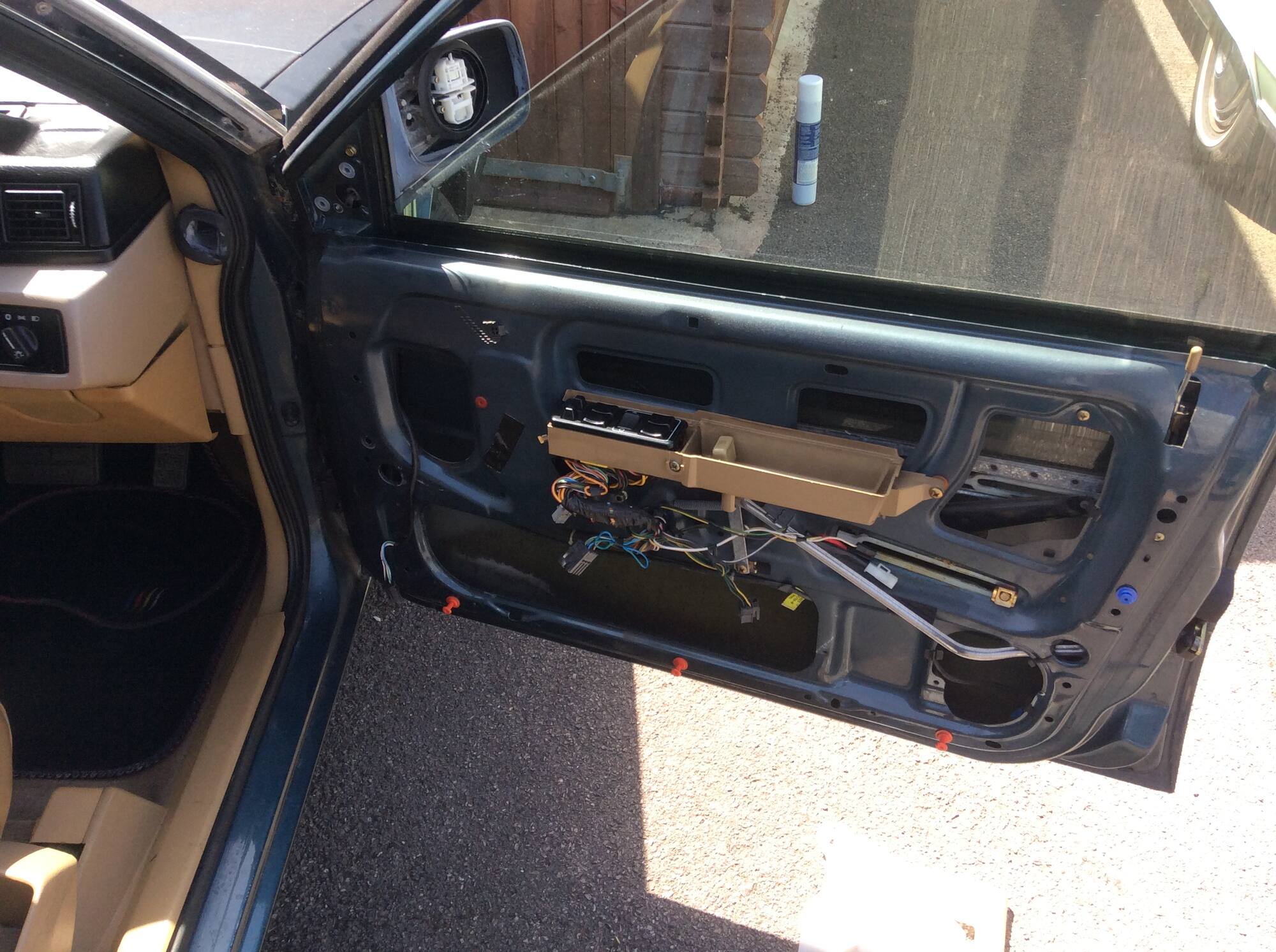

So, not one to do things by half’s I decided now was a good opportunity to replace both my mirrors. The old ones are very faded and scuffed after over 30 years and the mirror glass was starting to fade and go a funny colour underneath. You can still get brand new (non oe) ones if you look for them, however the drivers side ones are much thinner on the ground it would seem. I’ve found one but it’s coming from Germany and I’m still waiting for it. The passenger one though I got off eBay for £35 so I’ve fitted that one this morning.

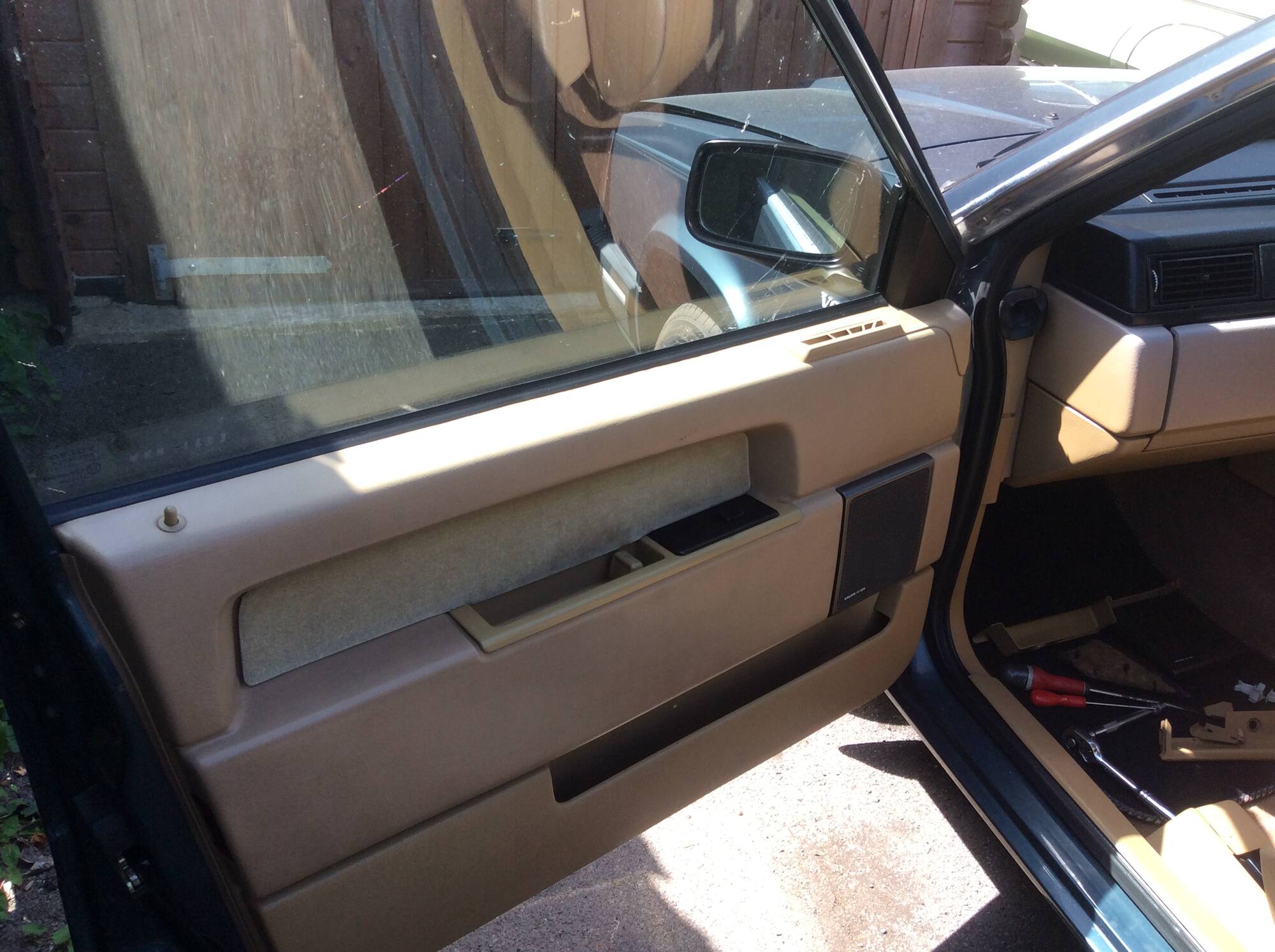

To do it you’ve got to remove the door cards, and wiring for the door light, speaker and mirror, and the trim around the interior door handle. Then it’s a simple matter of pulling off the interior mirror trim and undoing 3 bolts that hold the mirror on.
This is the drivers side stripped down. I’ve done both sides so once the new drivers mirror turns up I can get it straight on.

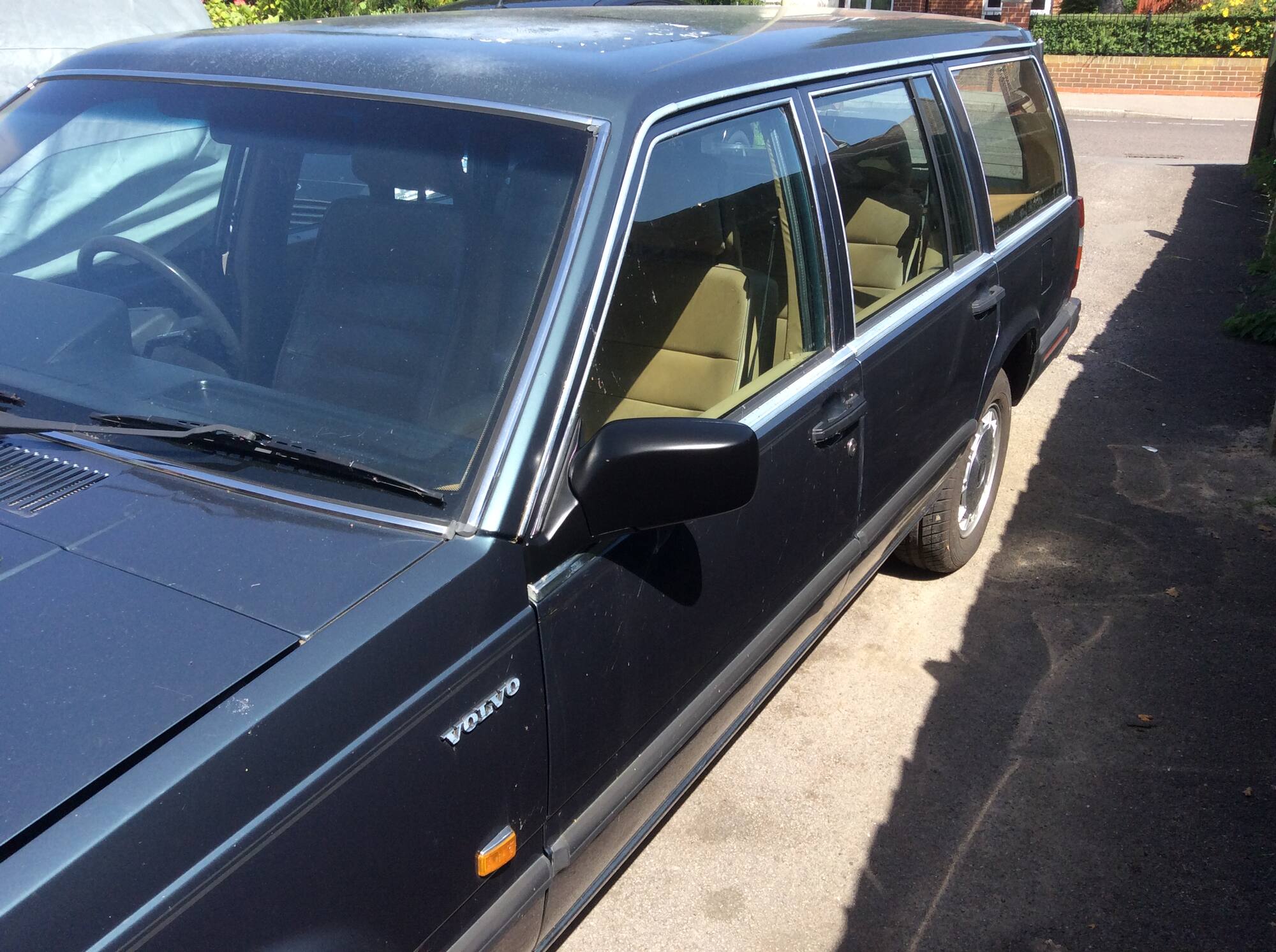

And here’s the passenger mirror back on. Lovely and shiny with crystal clear glass! Mines electrically adjustable and heated glass too but even so, they’re not expensive for new parts.
While it’s all in bits I did the usual and took the opportunity to clean everything and then re-grease the locks, power window mechanism etc etc and also I hoovered out the door bottoms inside. There’s no trace of any rust, so I sprayed both door bottoms with a good coating of Dynax S50 cavity wax to keep it at bay.
I noticed while doing this that these cars actually have their door skins both folded onto the frames like most other cars but also glued with seam sealer around the edges. It’s probably why even after over 30 years there’s no rust on the doors, moisture just can’t get into the joint. It’s good weather to do waxing in today, baking hot! It thins the wax and lets it soak into the seams better.
Then I just reassembled the complete passenger door.

Excellent job, the new mirror looks great. The casings on these are extremely durable it seems, I recall FATHA_RML having a similar incident to yours some years ago in a 940 which decimated the mirror on a Fiesta. Unfortunately as in your case the motor and glass fared less well.
much the same story with maestro/montego/216 mirrors
Given what the plastic on these cars interiors are like I’m surprised these mirrors can take such abuse. It took a hell of a hit but the casings just got a little scuff mark on and that’s all. The bit that attaches to the car is metal though. The Golf’s mirror was annihilated!

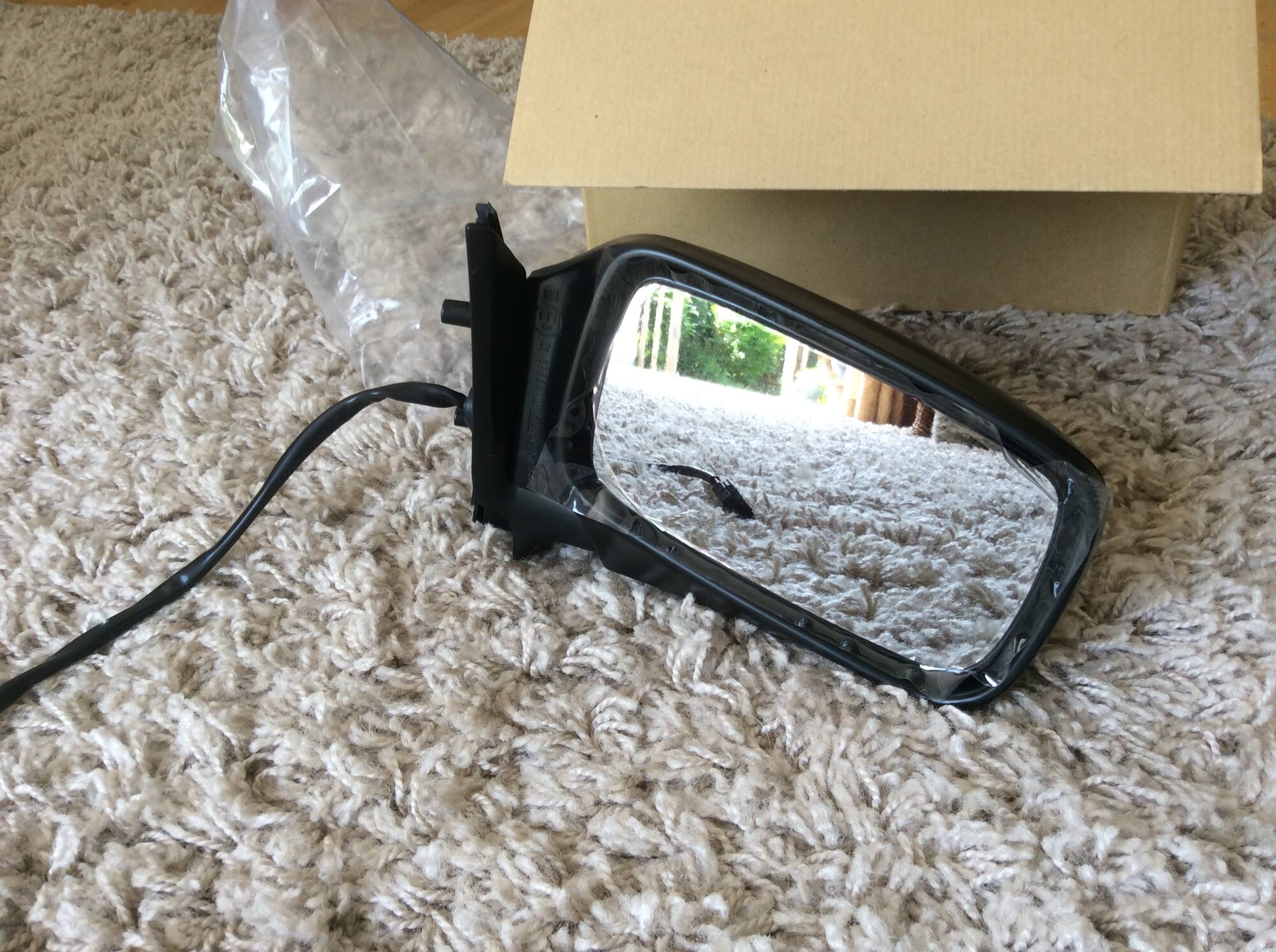

The new drivers mirror arrived yesterday so this morning I’ve got it fitted. As is often the case with old cars though, things weren’t quite as easy as they might have been.
This new mirror came from Germany and although it looked identical on the sellers eBay listing when it arrived it was clear there was something not right! This mirror is for the earlier 700 models so it’s got a small round electrical connector instead of the later square type my car has. My previous 740 saloon was an 87 model year and that car had the round connectors but this one is an 88 so I’d guess that is the change over year. Other than that it’s exactly the same mirror though so it’s not the end of the world.
Heres the connector difference.
As you can imagine, the way to fix this is pretty obvious. Chop off the wrong plug from the new mirror, chop off the old (correct) plug from the old useless mirror and simply reconnect the two together.
Old mirror off, new one on and bolted to the door I did just that. Luckily I anticipated problems here as the new mirrors wiring loom has different colour wires to the existing loom in the door and the old mirror. I temporarily joined all the wires just to test it and see what it did - joining them together in the most logical way only gave me any movement in the mirror upwards and outwards! Arse!
Based on the fact this was going to require a bit of trial and error to get all the wires joined in the right order I crimped on some spade connectors just to avoid accidental shorts between wires and make it quicker & easier to swap the wires around until I got it right.
Once I’d got it right I could chop these connectors off, strip the wires and solder the ends together permanently for a good long lasting repair. I also used some heat shrink tubing over the joins then the plastic trunking and a bit of insulation tape over the top.
Testing it again and all working as it should be!

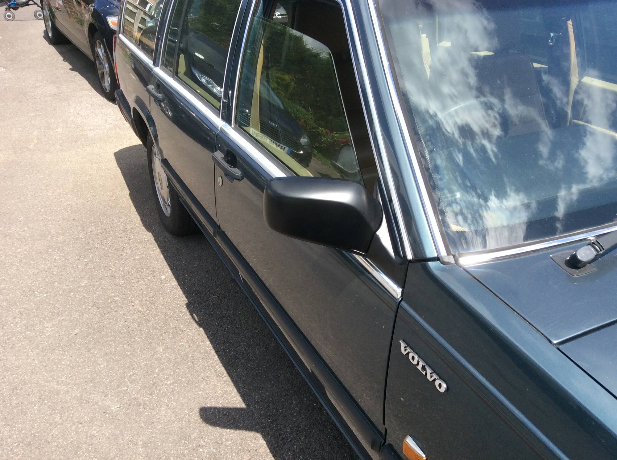

Finally, the door interior trim etc etc went back on same as the other side. And I finally took the chance to replace the badly broken plastic trim around the switches and door handle on this side. I’d already done the passenger side ages ago, I just didn’t do this side for whatever reason. The new ones came from the US and fit perfectly and look 100% better than the old smashed ones.
Heres the new shiny mirror in place.
Looks much better than the old faded horrible mirrors I think. Only thing I might need to do is get a new drivers mirror glass to replace the one on this mirror... the one on it now is the German one so the RH mirror would be the passenger side whereas here it’s not meaning it’s not the wide angle mirror glass. It’s not a huge issue as it still works fine and I can see with it like that but it does mean I have to set this one to its maximum outward travel to see as well as I want to. That’s a job for another day though.
