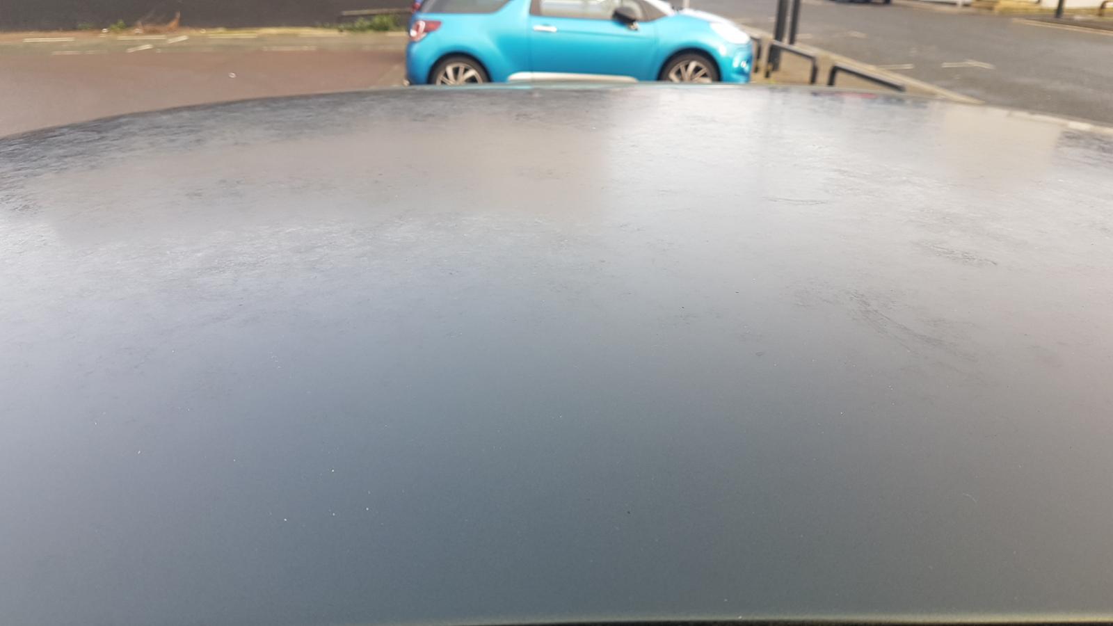

Paint has patina all over from tree sap.  Only really noticable up close but I'll post some pics.
