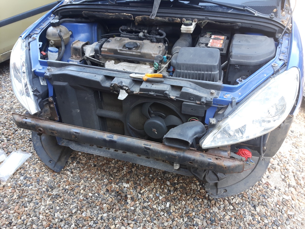

Matt thestag, #1 son, was complaining that his car was all hanging down at the front. refused to admit that he had hit anything.
it was looking a bit sad though. cut through the dozen tie wraps that had replaced the psa plugs to hold the front bumper and inner wings on
Insisted that Matt helped, which he did so by taking the piss out of my beer gut and playing with his phone. Made him get on the floor to help remove it which caused the correct level of irritation to satisfy me
Found the washer bottle hanging from the electrics. "ah is that why my washers dont work" Matty boy asks. Still denying that he has nudged anything at all.
Remounting the washer bottle was a piece of piss, bending brackets that are made from cheese and then securing them back in place.
Alas the pump is open circuit so another has been purchased. as has a couple of dozen psa plugs to replace the tie wrap fetish thing that is going on.
re secured the bumper so be can smoke around in it for a few days

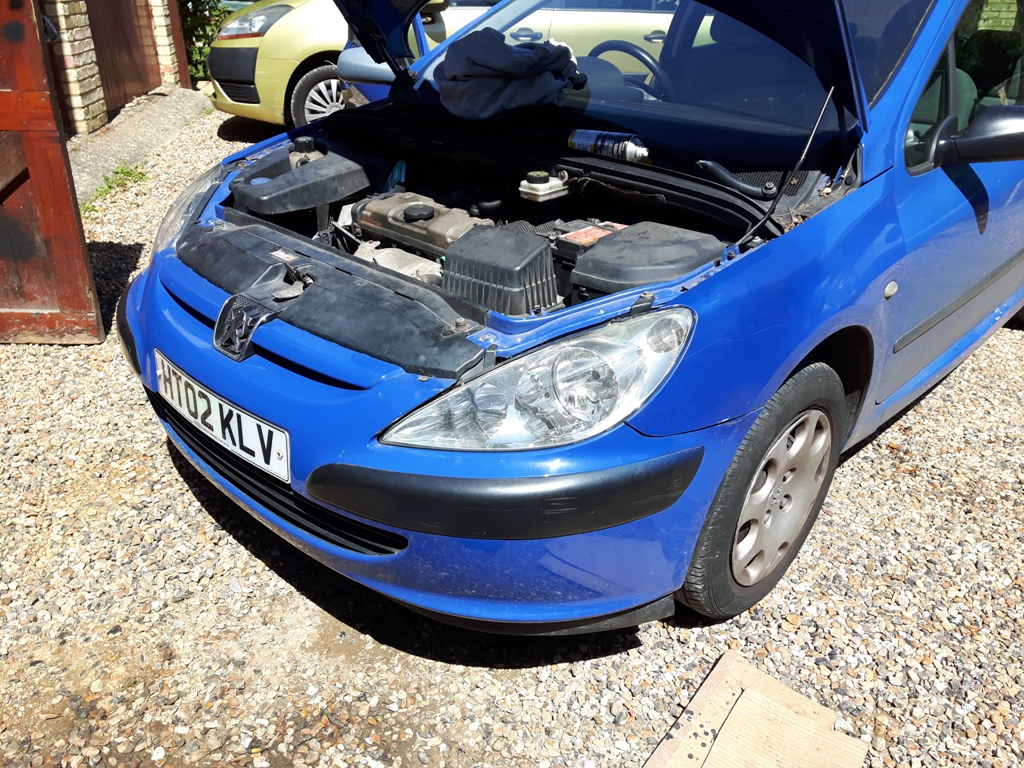

updatez on the 307
Needed to fit the washer pump, car has been on sorn ;) because Mattyboy thestag spent his £16.68 RLF money on pringles and full fat Doctor Pepper.
He had a nasty Friday of A levels so I took pity on him, taxed his car and today fixed the washer pump, the nearside wing mounting and fixed all the inners in with plugs rather than cable ties and bit of old wool.
Bumper cover is off in a jiffy
small creature wanted to help
Washer pump in and connected
squirting is resumed
PSA plugs come from PRoChina ... predictably... but they cost pennies
Splash shield reinstalled
and secured
next is the plastic wing and bumper mounting, the front edge of the wing has been flapping about like Katie Hopkins pants since way before 83C ownership. Reason was because of poor driver skills bending the support and breaking the original mount
Headlamp had to be removed because captive bolt was spinning
2nd hand jobby was bought from ebay breaker for an Ayrton. fits and secures the wing, yay
Headlamp back in
bumper secured and undertray refitted, job done, and you certainly have been
