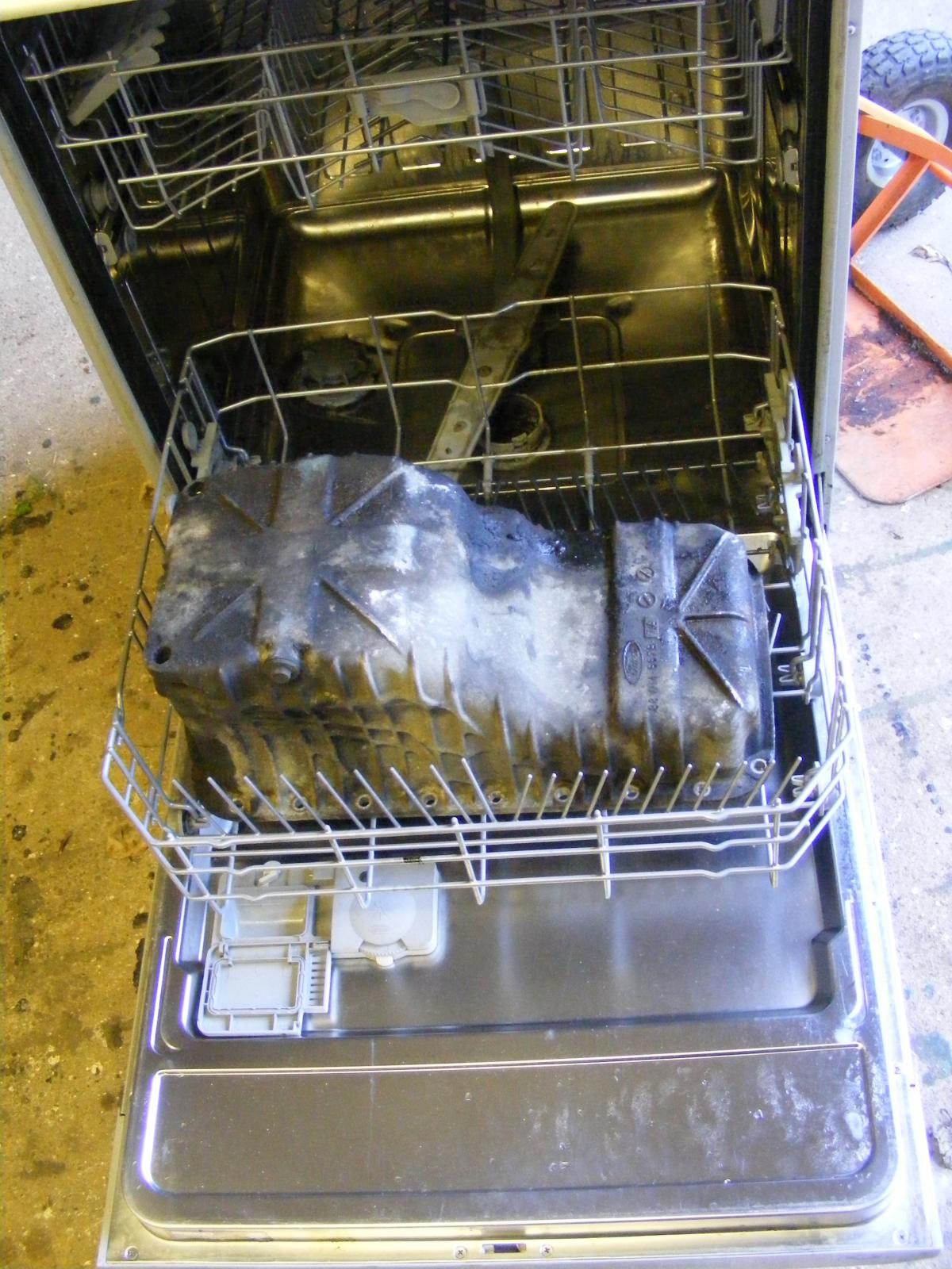

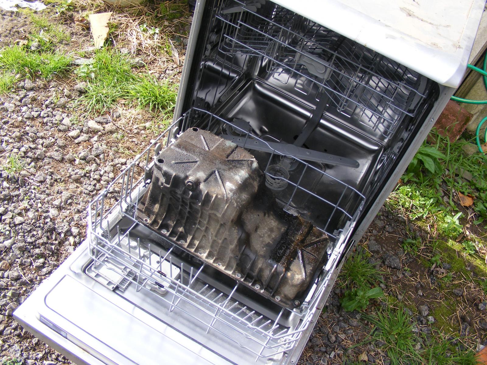

Just rigged it up  and loaded it
so just have to wait
Will post results  when its done
Just had a peek and it doesnt look like it going well   on a 70deg wash
Overall not impressed
Maybe the dishwasher is nacked ?  maybe need a different wash tablet  ?
think i will be going with Cavcraft's   idea .
maybe you need to take the top drawer out and use the heavy soil attachment that fits in its place
What did you use as cleaner fluid?
