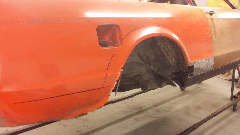

Had some time off during the week so managed two full days on the car.  The plan was to replace the inner and outer wheel arch if time allowed...
First job was to offer up the repair panels and draw around them so I can remove as much old metal as possible.  The arch and back corner of the wing always suffer on this side.
The reason for this is all the expanding foam that ford put in between the inner & outer wing.  They did it because stuff in the boot can fall down there and it also acts as sound insulation.  Obviously the side effect is that water and condensation can't get out making the perfect rust trap.  The same is true on MK2 & 3 Capris with the worst being Mk2 Granadas that have the foam in various other places including the wheelarches.

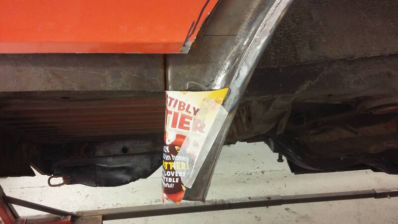

Next I replaced the bottom rear section of the arch which was very rotten right up to the seam with the next panel.  I made up a cardboard template and used various tools to bring the metal into the correct shape.  I then welded it all in using a hammer for slight adjustment as I worked my way along the weld.

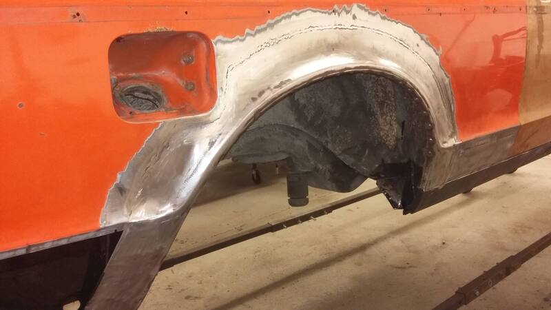

Next I turned my attention to the outer wheel arch.  This side is more difficult due to the fuel filler so lots of adjustment and small cuts were made to get the panel to fit without removing too much metal.
20170722_105915.thumb.jpg.2a7c3215a8b1fc87d25801b1f9e8fb99.jpg20170722_131206.thumb.jpg.00d67f800a4926a9df8c3553f5364bab.jpg20170722_152152.thumb.jpg.1f10d0059a119d2b399afe11564a903c.jpg20170722_142943.thumb.jpg.ab51a7116d85464e88a5a2763ec55fdf.jpg
It takes a very long time to fully weld the panel on.  Any more than 3 strikes from the welder will start to warp the wing.  I held a blow gun hooked up to the compressor allowing me to cool the metal each time I did 3 welds.  Repeating this process eventually gets you a nice weld with very little warping from the metal.  Then the grinding process begins which also takes a long time.

With the arch now finished things are starting to look quite a bit better on this side.  Next job is to fit the outer wing repair panel which will complete the bulk of the exterior work on this side of the car.

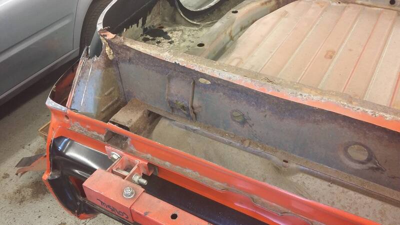

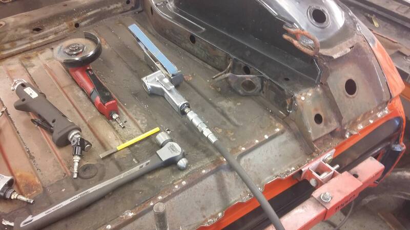

Another day completed on the car.  I've turned my attention to the inner and outer rear valence as its easier to access while one of the quarter panels is in bits.  I've recently finished replacing the inner and outer valence on a mk2 Granada so it made sense to do mine while the process was fresh in my head.
Both the inner and outer needed to be replaced.  The outer has a big hole in which is being covered by a well selected sticker and the inner is rotting all along the bottom where it meets the boot floor.  I hoped that the surrounding panels had survived.  It would be nice if at least something on the car was in good condition.
First thing to do is cut off as much outer valence as possible to gain access to the inner.
20170805_082849.thumb.jpg.71d0c1e3b940cb52444ea7bbc1404f92.jpg20170805_082858.thumb.jpg.e136c0027d4803b8237865e58ce0edca.jpg
Inside things are looking much better than I thought.  The boot floor is good and so is most of the other panels that make up the rear of the car.  There a small panel attached to the spare wheel well which needs attention but everything else is looking very good.  The inner valence is quite bad but I intend to replace it so no worries there.
20170805_090005.thumb.jpg.6b6ebb9dccc9bc9d386dd07f3fa8a888.jpg20170805_090009.thumb.jpg.8e09587bb9f3d6cb22a97f53659ba328.jpg

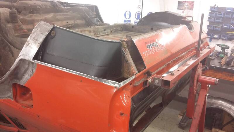

I then cut off as much of the inner valence as possible and set to drilling out all the spot welds so I can remove the seams of the old panels.  The inner valence is quite difficult to remove without causing damage as it has various lips that wrap around nasty little corners and hard to reach areas.  Once complete I got the wire wheel out and cleaned up various areas checking for any additional rust and pitting that may need attention.
The new inner is then fitted.  Many of the seams are not accessible with the spot welder so I punched holes in the edges and puddled welded the panel in place.  This is a genuine Ford panel and it fits perfectly with no alteration required.
20170805_134736.thumb.jpg.9ac4f14fda1be66e62b19c4ab680e926.jpg20170805_153247.thumb.jpg.3a21388c05940a66745582b84a16ee21.jpg
The rear valence is then trial fitted and checked.  I had done this previously before welding the inner but its always good to check again after welding.
I then finished up for the day by painting a few areas with POR and rolling the car the correct way up.  The body roller really helps with this sort of job.  The mk2 I did a week ago was still on its wheels and it took me quite a bit longer and was very uncomfortable.
20170805_163627.thumb.jpg.14227a983e44f357b48e1fb63232fbd8.jpg20170805_163638.thumb.jpg.a3025e6006795f3e6ad6b35217aafd45.jpg
Should be able to get the outer welded on next weekend and possibly get the rear quarter back together.
