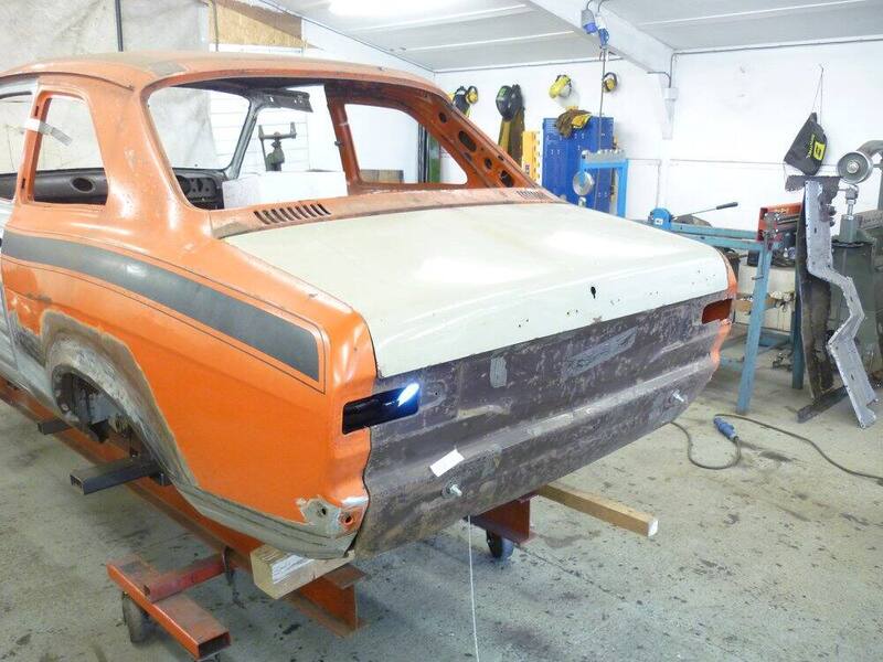

In the assembly shop I've just about finished this lovely 2.8 pre-facelift Mk2.  Finished in company car gold with a brown interior and automatic box.  Even managed to save the original Perrys number plates.

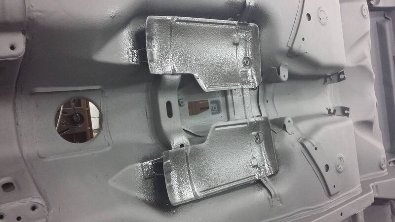

Managed to finish all the little bits and pieces on the underside today.  Finished all the seam sealer and got the last few bits of welding and painting done too.  Focused mostly on moving the fresh paint further into the engine bay.  Did some more of the bulkhead and the last scabby bits of both front chassis legs.
20180407_123049.thumb.jpg.202077f5fdd508625b97129c3c271e71.jpg20180407_124940.thumb.jpg.28c4666a017242f857ac04d01f43b035.jpg

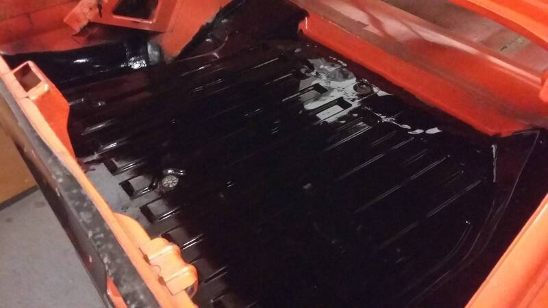

With everything on the underside now tied up I sprayed on the stone guard.  Prepped the underside first by rubbing it back, blowing off any dust and thoroughly degreasing it with panel wipe.  I used black U-pol Gravitex for the stone guard and applied 2 - 3 coats.  Making sure that anywhere particularly rot prone got at least 3 coats.
It's a big car so used five 1L bottles of it.  Have one left over which I'll use for the inside of the front wings.
20180407_152931.thumb.jpg.cd423d9f9e192ae40f64ade1c6e0bedf.jpg20180407_163837.thumb.jpg.b23bf48504c121b3640ca4feae0c4473.jpg
A close up shows the finish you get.  You can change the smoothness of the paint by adjusting the air pressure.  I've gone for a high build which looks similar to factory and also helps soften some of the visible welds.
The combination of POR, seam sealer and stone guard over the whole floor pan will provide excellent protection.  From factory most of this would be just primer so no wonder they rotted out.
All thats left to do under there is to clean and repair the exhaust heat shields.  I've left them off so the whole floorpan could be painted.  Once they're welded back on I can remove the car from the body roller

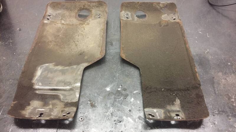

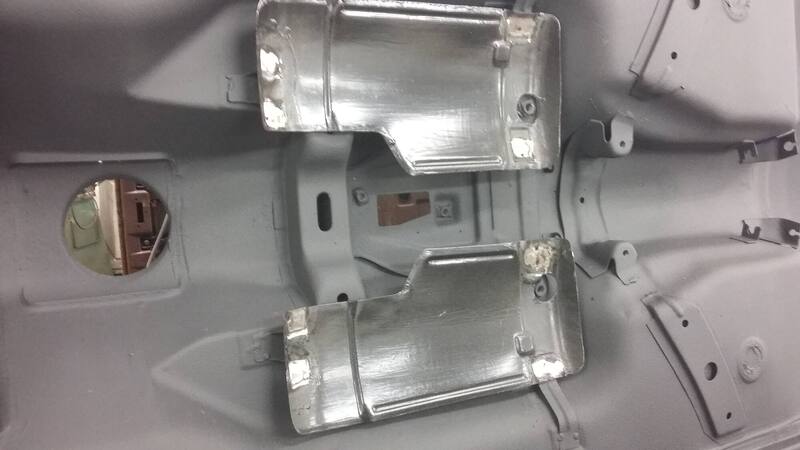

Last thing to do before getting the car off the roller was to clean up and refit the heat shields for the exhaust.  I left these off to allow for stone guard application to the sections of floor above them.
They were rather scabby but cleaned up quite well.
20180421_085937.thumb.jpg.86db26c2318a3072359471dab70e0222.jpg20180421_092214.thumb.jpg.6d8046538eca83d719b77955da05bde9.jpg
Painted both sides and welded them back onto their brackets.  I reapplied paint to the brackets after welding.
20180421_094644.thumb.jpg.8450a72942f72ec8164c95b7d08761e0.jpg20180421_102844.thumb.jpg.202e0e76b45cf67ea5080a284024b8fc.jpg
Bit of stone guard to finish the job.

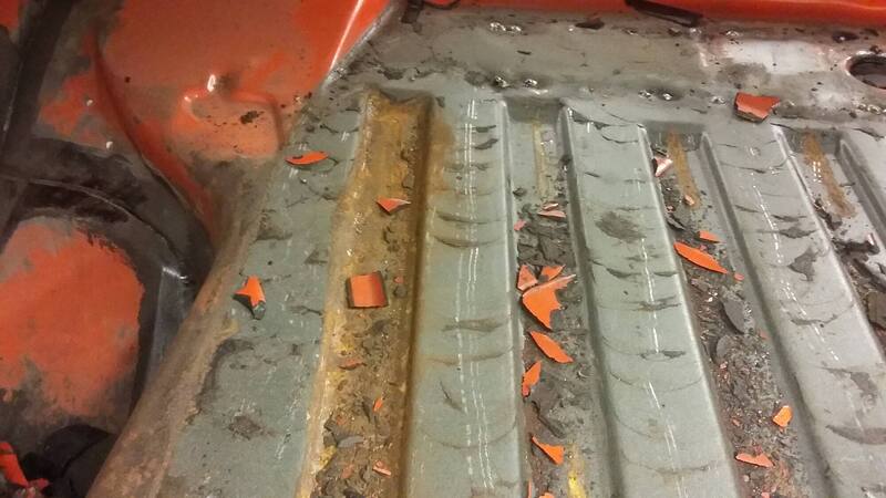

As expected rust has started under the mat but thankfully its minor and just wire wheeled off.  I wire wheeled and paint stripped as much of this area as possible.
20180428_100706.thumb.jpg.792045a2e1bb82142f5c554247b4c287.jpg20180428_141048.thumb.jpg.5208fca291d0c2a20a730ee104bee34a.jpg
While I'm working on this area I also removed a small rotten panel in the corner of the lamp panel which I'll remake later.
20180428_141110.thumb.jpg.f42c096e50876a4428f39ff9c62809c3.jpg20180428_154008.thumb.jpg.126227e43d4a9f920290df0e568cd270.jpg
I then continued to remove old seam sealer, paint and tar from the boot floor.  I also cleaned up some repairs I'd done a while back and painted the area with POR.  As usual I cleaned the area with panel wipe first.

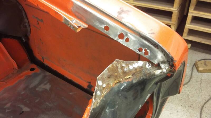

Made some progress over the last few weeks.  Mostly smaller jobs, but they take a surprisingly long time to complete.
Started off sorting out the rotten corner at the rear.  I have another rear panel in storage which allows me to salvage the part I need and save some time.  The rear is where the coupe differs most from the saloon so I'm fortunate to have a spare panel.  It needed some work once removed but cleaned up alright.
20180505_100551.thumb.jpg.62c629dca234be858a24c3924b50c44f.jpg20180505_110052.thumb.jpg.97b82ca4fc99445849e3bed03bbe059f.jpg
Fitted to the car in the usual way.  It's a tight fit so took a while to line up.
20180505_113848.thumb.jpg.1e20cea27faa8216d8b237849be85550.jpg20180505_131046.thumb.jpg.9b9e698d56b4465ec3b281ba17ee7e9c.jpg
Painted as usual.  The other side is fine so that’s everything here finished.

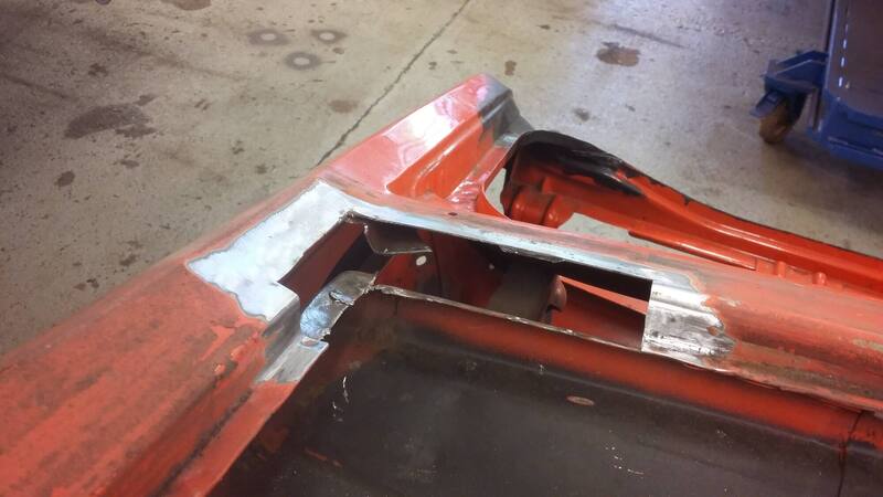

Next issue to address is the corners of the rear screen.  It’s a common rot spot as the rake of the window, shape of the rubber and lack of drainage means most Mk1 & 2 Granadas rot here.
It’s not easy to remove as the various panels are brazed and loaded with lead in the factory.  It’s done to ensure it won’t leak and hide the joins of the various panels.
I made up some repair sections and started welding them on.  Later the joint between the two bits will be brazed as per original.
20180519_113930.thumb.jpg.6352868dcc7249ab76a9bcbff206961d.jpg20180519_131322.thumb.jpg.7e574ba24fc1e00650d2c471bdf6c622.jpg
Came out quite well considering the access issues.  I'll need to do the same repair on the other side.

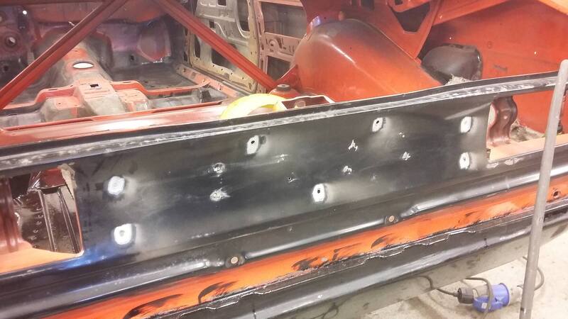

Started off today with cleaning up and adding welds to the areas around the sills in the back of the passenger compartment.  The quarter panel needs to be welded to the outer sill and the various layers of inner & outer sill need puddle welding.
Access is a bastard here and I'd been putting this job off for ages.  Even with all the tools I'm using I couldn't find anything that worked well.  Just finding an angle to get a decent weld going was difficult.  Despite the issues I got it done on both sides and managed to leave both sides reasonably clean and tidy.  The visible welds further up the quarter will be cleaned back at a later date.

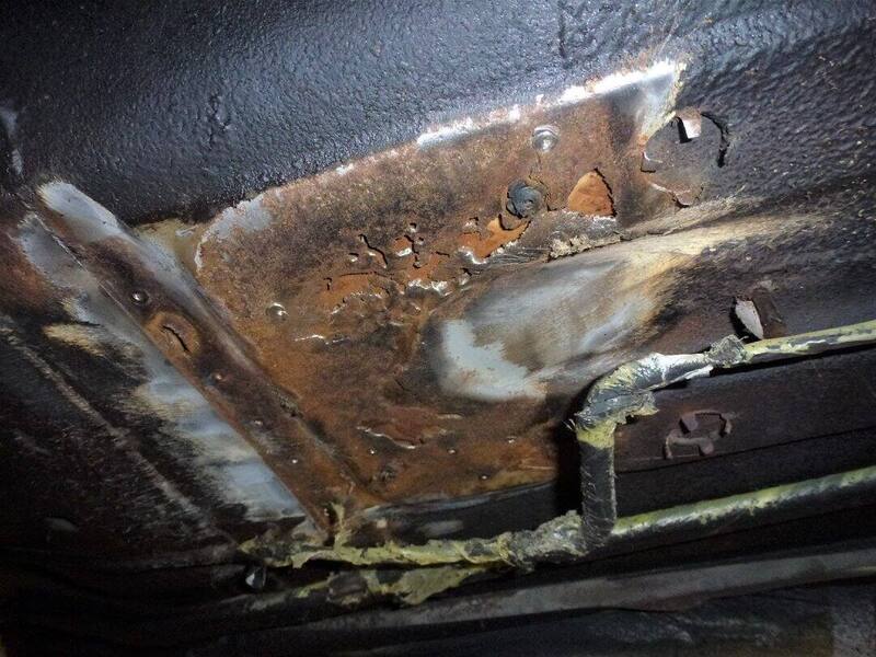

Had an 05 Jag XK8 in for waxoil and stone guard.  Things were going well until I found rot in the floorpans under the dash.
397444403_Jag1.thumb.jpg.8e5f201a81f3ceb112a7c4f95c51efff.jpg68780934_Jag2.thumb.jpg.6dfddbf95ab4bf08f771204fc3dfa227.jpg
A rather difficult job to sort out that required an interior strip down to reach.  Still it cleaned up well upon reassembly.  The repair is under the brake pedal and had to be done on both sides.  I ended up with that as the fabricators are flat out on everything else.

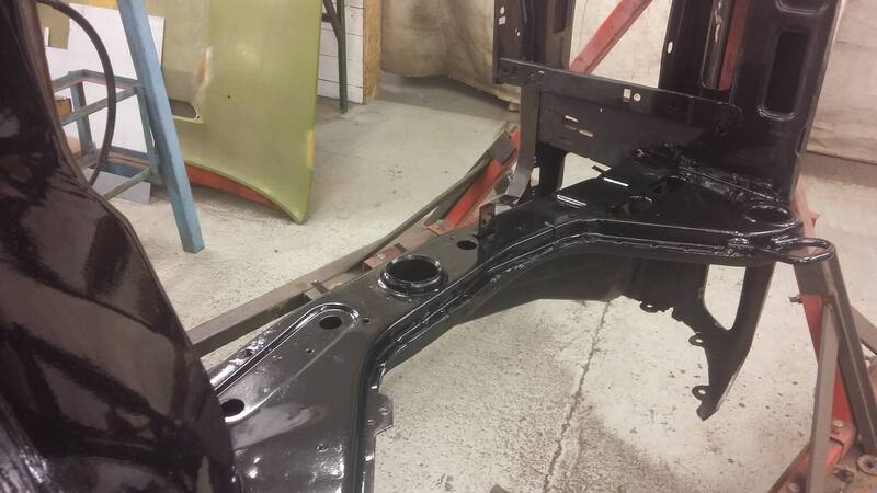

Mexico is nearing completion on metal work.  Saved one of the doors, rebuilt the rear end and repaired the rear quarter panels.
1533442918_Mexico1.thumb.jpg.e8c3a1861130dea3df5ae9ecafd9bf8f.jpg1917408424_Mexico2.thumb.jpg.c421d02f5e0a06c92734eb4f33622189.jpg1131546385_Mexico3.thumb.jpg.e95fade68df4cd32db78813e005f0e46.jpg629607059_Mexico4.thumb.jpg.4cf18eb43a82167ce1d29c6644ef10ef.jpg

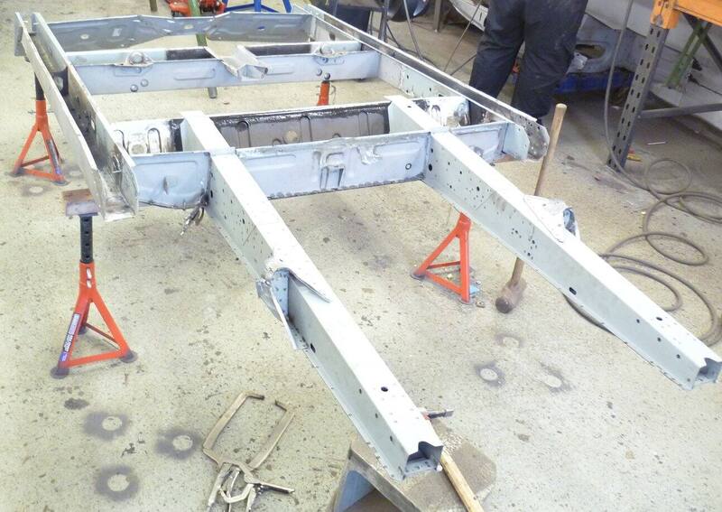

Elsewhere complete repair and reconstruction of a Renault 4 van chassis is going well.  Very little of it survived.
46650383_Renault1.thumb.jpg.133e4c00e85330e1c9991a38655c45f1.jpg1266889992_Renault2.thumb.jpg.12751e95b637a3f259c702e06ad5378d.jpg
