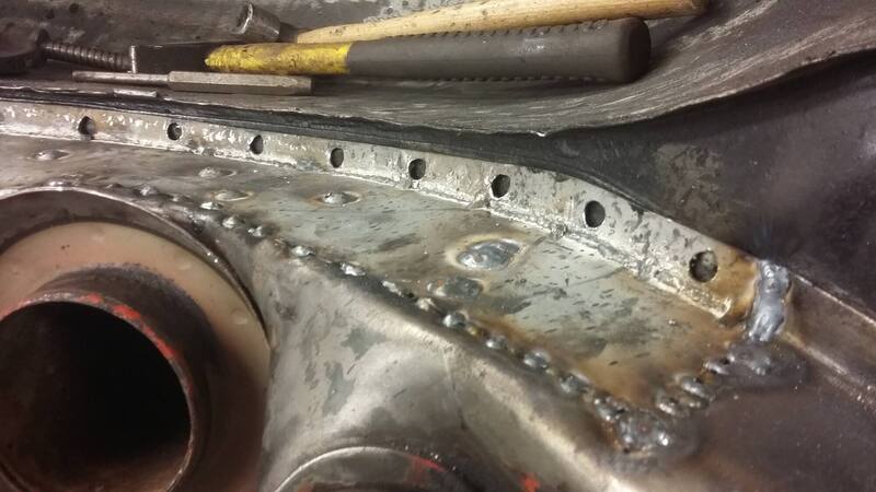

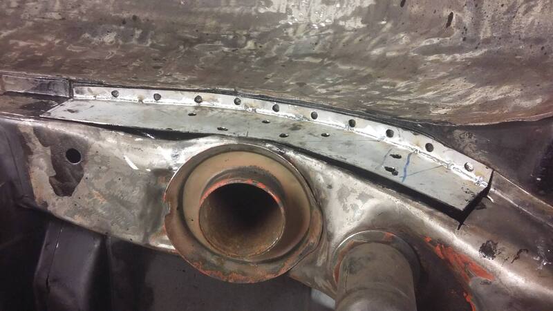

The diff box is now complete and marks the end of the major underside repairs to this car.  I've still got more to do before the stone guard can go on but that day is now in sight...
Started off finishing up the welding and also added some holes and clip points for the fuel line which runs along it.  Kept hold of the ruined original box to make sure I put these in the right place.
20180217_110729.thumb.jpg.56487c86aa29a6edc03eaeda6dee9869.jpg20180217_130721.thumb.jpg.ef7cfa383779740bd8f919e85f7fb989.jpg

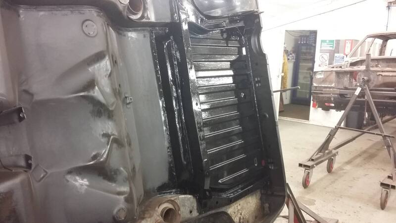

With that finished I took the boot floor back to bare metal.  Given how bad the rest of the car was the boot floor is in excellent condition.  I'm told the Cologne built Mk1s survive well in this area compared to the Dagenham built cars.
Took a long time to clean up but was rewarded with no rust.
20180217_151008.thumb.jpg.dcb0bdfe81d433e8d6b4c675b115247a.jpg20180217_151024.thumb.jpg.8af0c5f5380cd7ee1532768f16586dc8.jpg
Next I wiped the panels clean and painted with POR.  Just work on the passenger side chassis leg and inner wheel tub remaining.  After stone guard I'll get it off the roller and continue with outer panel work repairs.
20180217_153559.thumb.jpg.14fe0dc9a9da6ee7f91ec1a0ccbb9f25.jpg20180217_153635.thumb.jpg.96aef1eadbe221c99428325d606cfd8f.jpg

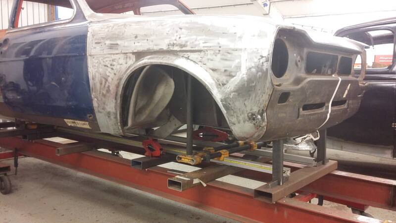

Front end is mocked up and the front wings have been repaired.  Having some alignment issues now which all stem from the aftermarket bulkhead and A posts not being right by a few mm.  The aftermarket chassis legs were also wrong and we have now corrected them.
Plenty of fiddling and adjustment left to go but it does at least look like an escort now.

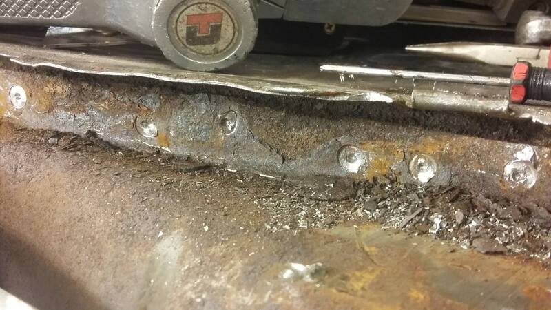

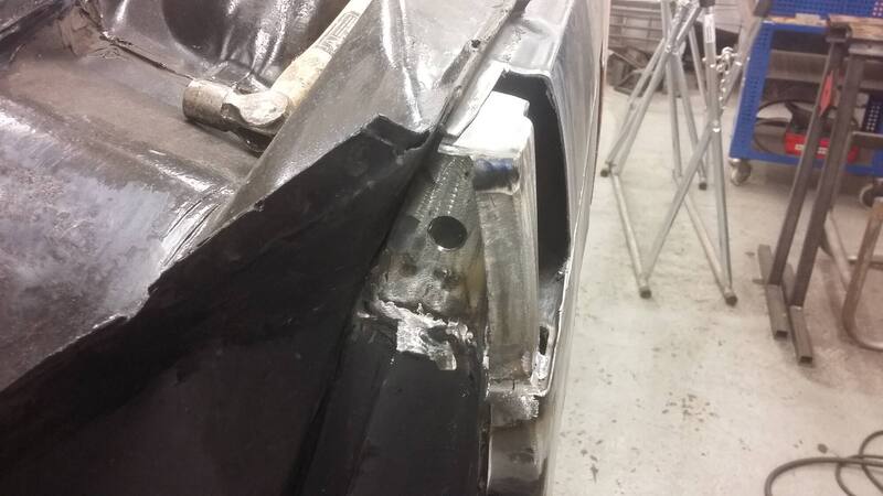

Another day of welding completed.  Sorted out the last chassis leg today.  I suspected this leg wasn't quite as bad as the one I did on the other side and luckily it wasn't so got it sorted in a single day.
I spotted issues here some time ago while removing the original under seal.  The area where you have two skins spotted together (supports the coil spring) was rotting inside.  You can spot this stuff by feeling the surface with your hands.  If you have lumps and bumps its rotting and needs attention.
I cut the outer skin off the most suspect area first.  All the rot is in the outer skin as usual.  The inner is a little pitted but requires no further attention other than some cleaning back and painting.
20180224_094359.thumb.jpg.890467a105726223434515f8781dfd1f.jpg20180224_095024.thumb.jpg.f24634100d6a6d5e0a7e4a321b868501.jpg
Still rot to the left under the outer skin and was beginning to look similar to the other side.  I decided to remove all the outer metal from the strengthener including the flange just to be sure.
20180224_121016.thumb.jpg.08834339bd58fd0c080593bea6189861.jpg20180224_121026.thumb.jpg.2e9a935778f794474fc8c9d2233864d8.jpg
I then cleaned everything back and was pleased to see I'd caught it in time.  The other side was worse and I ended up doing part of the strengthener and replacing a section of the floor.
With easy access to the inside of the leg I checked its condition and then painted inside the leg as much as possible.  I also repaired any slices and damage I'd done to the strengthener while cutting out the rot.
20180224_132713.thumb.jpg.2b519c805072a4ebe8a6203321637876.jpg20180224_134819.thumb.jpg.c60a73e5d3a81a39c686ca892a42cdc7.jpg
Made up a repair section for the outer skin.
20180224_145752.thumb.jpg.02d4c47869581807feb3642416571faf.jpg20180224_152707.thumb.jpg.37d51c4894b745ed64ccfec88161efde.jpg
Then puddle welded it back onto the strengthener and proceeded to tack the edge into place using hammers as I went to ensure a seamless fit.
20180224_155701.thumb.jpg.c7284a02c9b85a0694466f0e6ec0911b.jpg20180224_162832.thumb.jpg.920f1e7cdfc5f5d7b575e5976679fa6b.jpg
After grinding down the tacks I competed the welding and ground those smooth.  The leg is now strong again and I'll paint it on the outside next time.  Need to order some more POR first.
20180224_171821.thumb.jpg.1c24e2265d17135caf0c8b89c68edecf.jpg20180224_172002.thumb.jpg.98a675ae3837b15b3cc94d81fb324075.jpg

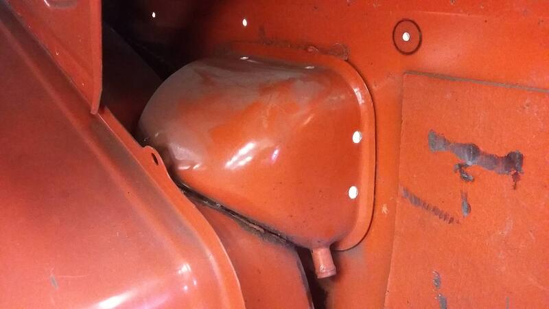

With all the major rot in the car now repaired I've moved onto smaller areas.  There are plenty of little holes and small bits of corrosion left to sort so I'm sure I'll pass 550 hours of fabrication time.

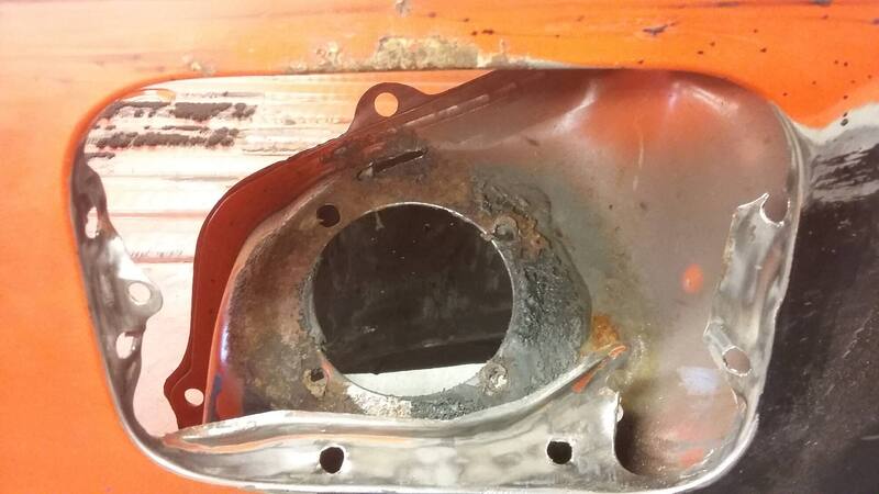

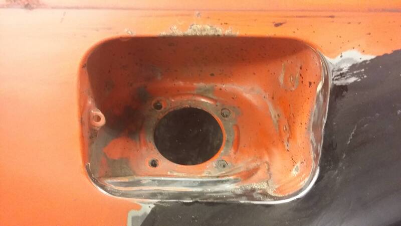

One of the more difficult areas was under the bucket for the fuel filler.  The wheel tub under it has rotted through but access is very poor.
20180310_101909.thumb.jpg.6518bb04f3b41d7d7b6261547b05ea05.jpg20180310_103926.thumb.jpg.02cf315b82ff61e858a91975a9291d66.jpg
To get better access I removed the bucket from the quarter panel.  Its held on with 9 spot welds and seam sealer.  Getting it out took a while but wasn't as hard as I thought it might be.
20180310_111508.thumb.jpg.111a2c6ab84715e73934d6946428da9d.jpg20180310_111545.thumb.jpg.796ea029bfd348e281286fe16d166276.jpg
The rot can now be seen more clearly but access still isn't very good.
I cut out the worst of it and made up a small repair section.
20180310_132620.thumb.jpg.4ede43c2d902e4d8a7444e9221b36b3e.jpg20180310_134948.thumb.jpg.a93124f414928ba9acfa80b0b5b4d45b.jpg
Managed to weld it in ok and also had enough room to grind the welds down.  Finished up with a coat of the usual stuff.
20180310_155216.thumb.jpg.55a24719112c8ce160abe28dfee1b4f3.jpg20180310_155627.thumb.jpg.5d9debfb75568ff4561419f867bd203f.jpg
Then underneath in the wheel tub I cleaned up the other side of the welds on the repair. I also removed the remaining under seal from this area and painted it.
20180310_131257.thumb.jpg.bddc9f0f45e92d7f8327b1e0b852ff52.jpg20180310_174324.thumb.jpg.6460c5c1eece9754dc811f7a1d76032f.jpg
Finally I cleaned up the bucket and painted it on the bench.  Squeezed it back in and welded it on.

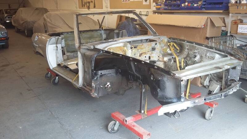

Just after the first stages of metalwork in July 2016 prior to being dipped.  The body contained the most filler I've even seen.
Completed car in February 2018

It sounds a lot doesn’t it, £40k!? But, the way I see it is that no car manufacturers now can or will produce the car I want so the only option is to spend that sort of cash refurbishing an old car that I do want. If it’s done right and it gets looked after once the work is complete there’s no reason whatsoever that car can’t last another 40 or 50 years.
If you look at it like that it’s actually good value! Some people spend that sort of money every 3,4 or 5 years on new cars!
I’d say your figure is about right for what I’ve spent on the Capri tbh, maybe a bit more with parts on top which I’d been buying over the years before getting the car stripped. The panels alone on mine added up to just under £10k!
It’s now in better condition than when it was new though, Ford just threw them together quickly and punted it out the door but now it’s effectively hand built. All the cheapo mass production work is gone and it’s been done properly this time. Plus it’s had much better corrosion protection and paint this time around so it’s bound to last better this time.
Is it worth it?
To me yes it is but many other people would probably think you’d be mental spending that on an old car. Depends what you want at the end of the day.
Spot on Dan.
If I had the money, I'd have something built for daily use; E32 750i, a Series 1 XJ6 or a pre facelift 2.8i Granada Ghia.  Start with a car that is still solid (I'd get the Jaguar from Texas or California) but strip it to a bare shell and start again. Ivor Searle to rebuild the engine, a brand new autobox from ZF or wherever (bollocks to 3 speed autos) and a heap of new bits - everything involved with suspension and brakes (apart from pedal box and crossmember), ever y single hydraulic hose, starter, alternator, sensors etc etc.
I reckon a 1990 750i would cost close to the £65'000 it cost when new but it would still be a tremendous thing to drive and it would have a value when the current one is sat in a breakers on flat tyres because the battery control probability control unit that cannot be reused and costs £2876 plus VAT new has fucked itself. Similarly, the XJ and Granada with a few upgrades (ABS, proper air con, cruise control and a 4 speed auto) would be great everyday cars.
In the case of that R107 Merc, that's already money in the bank. The Mexico also. They're both 40 -50 grand cars and to hazard a guess the restoration bills will be covered by that.

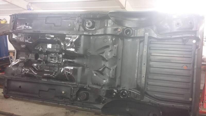

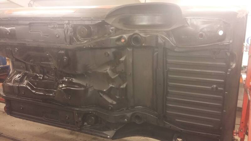

Continued on the underside today doing various small bits and pieces in preparation for stone guard.
Started off by removing the last of the old sealer & paint towards the rear of the car.  I also cleaned up any welds I missed out previously and generally just checked everything I've done under here.
20180324_105338.thumb.jpg.9ae1babe0044401dd1a9d9a832f7ea36.jpg20180324_105347.thumb.jpg.88f8fdadfc8b9f073828f1aa54966692.jpg
started cleaning off the old paint from the bulkhead.  I will eventually end up removing all the original paint from the bulkhead as its blistered all over.
I then painted these areas with POR and blew any dust off the underside.
20180324_113831.thumb.jpg.3ed52b4bcf8a4758ccc49ffc76126fc6.jpg20180324_114556.thumb.jpg.544341349d97efbaa741c50be1a8f351.jpg

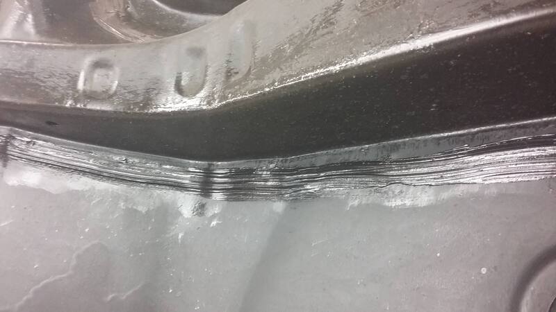

Next is seam sealing as I've removed all the original stuff.  Its very important to do this properly otherwise all my hard work will get impregnated with moisture.  You should seal all joints and seams both outside and inside the car.  Ford sealed most of the joints but used a poor quality sealer which only worked for a few years.
I'm using black tiger seal and a bit of scotch brite to replicate the original finish.
20180324_115430.thumb.jpg.d6f6d88cc091fd78f9f0b2dd0f3a5443.jpg20180324_115532.thumb.jpg.cf9d49e49875037cb5e11eabdfc73d3e.jpg
It's a time consuming and messy job.  As I went I also cleaned and fitted the original floor bungs as they are held on with sealer.
I've got another two days or so of little jobs and additional sealing to do under here.  Below most of the sealing is complete but being black its hard to see.

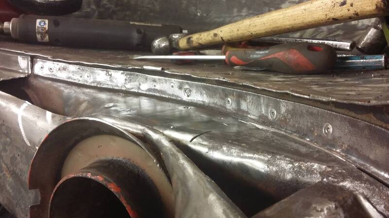

Some corrective work completed today.  Ages ago when I replaced the first sill I thought adding the sill closer after fitting the sill would be easy.  I thought wrong....
It was a pain to do and not having done one before I had no idea what I was trying to recreate.  When it came to the other side I made the closer correctly so knew I'd end up re-doing the first attempt.
Started off cutting out the crappy closer and part of the sill.
With that gone and everything cleaned up I took some measurements and made a cardboard template of what should be there.  What I'm actually making is the bottom of the outer wheel tub but it also forms the closer for the sill.
Its a bugger of a shape but after a while I had the correct piece made up.
20180331_133030.thumb.jpg.4bd3405721cec0d8c7d5724fce4c3ea1.jpg20180331_133040.thumb.jpg.9c513cb777b9bb27e2c7bc848f384c23.jpg
Despite the bad access I managed to get a nice bead of weld to hold it in.
20180331_133128.thumb.jpg.1ee47edd9d0ce64b2666a056ee4a1c25.jpg20180331_141234.thumb.jpg.365be565bc53ec02062495f165395da7.jpg
A good coat of paint both sides.  I've also drilled the hole that all Granadas have. I'll use it for cavity wax application.
20180331_141621.thumb.jpg.72340da0d5ee781ea82d20582ad443ba.jpg20180331_141629.thumb.jpg.c1e0939513c833ae5588f6d556e18c67.jpg
Then I cleaned up the outer sill section and let it back in making sure I painted it on the inside first.  Some compressed air and excess paint through the hole I drilled ensures the welds are painted on the inside.
20180331_142453.thumb.jpg.47408e05ff36c644de15c64df357e919.jpg20180331_150214.thumb.jpg.24ee271731879eba446fb5a4bccce56d.jpg

The alignment problems with the Mexico have been solved (we think).  First was the incorrect shape of the aftermarket bulkhead and front chassis legs.  Second was the front panel below the radiator being far too wide.  That was a genuine ford panel but it turned out to be a rejected panel from the factory.  Rather than being melted down it found its way out the back door to be flogged for good money 40 years later.
Its been giving the fabricators some sleepless nights but the front end is now fully welded.  I would have run a mile so fair play to them for getting this far!
