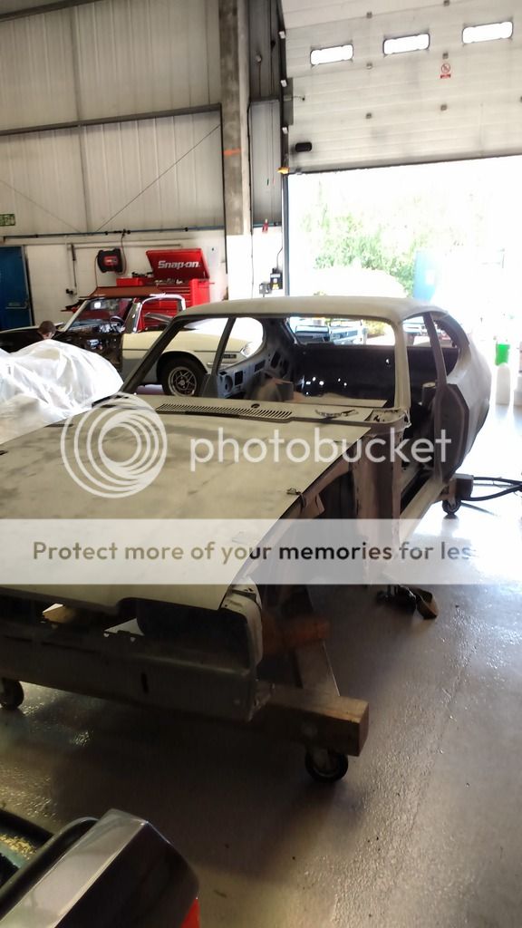

danthecapriman Posted September 19, 2016 Posted September 19, 2016 I'm possibly going against the grain on here a bit.Bodging is fine with me on a car I'm not bothered about as long as it's not stupidly dangerous. I've done a few works of art on old shitters before with filler and chemical metal! However, on a car I like and want to keep it gets done properly no if's no but's.If the damaged area was metal originally it's repaired with metal. If the joins were originally spot welds it's repaired using spot welds as a minimum. If a welded repair goes in it's seam welded and done right, you get the idea!I've spent a lot of time on my 'keepers' fixing them properly because it's the right way to do it. I've done loads of welding on the Granada for example, yes, stuffing filler in certain places would probably of done ok but I'd know it was there and I just can't do it or live with it. This is another example of doing it properly!I did consider doing the Capri at home but decided against it in the end and instead go all in for a full on bare metal resto. Cheap it ain't, but it's getting the treatment and it'll be far better than what I could do at home and that's what I want.I'm sure there's many on here that don't agree or think I'm mad but I want things done right and done once.The other thing here is the safety aspect. Filler and adhesives or chicken wire, or substandard repairs do not behave well in an accident. Old cars aren't ever going to be good here but some of the past MOT style bodges I've seen wouldn't hold up at all if it came down to it.My Capri above had patches on top of patches, spot welded (bird shit welds) and seam sealer and under seal covering structural rot and I didn't know it was there, even after owning the car 15 years. It so far hadn't got any worse but in the event of a crash it would of just crumpled and made a bad situation worse. Like I said, I want things done well and done once!That's not to say I don't like rough old cars, I do and my Granada is a battered rough old thing but it's good and repaired properly where it matters. Magnificent Rustbucket, hennabm and Joloke 3

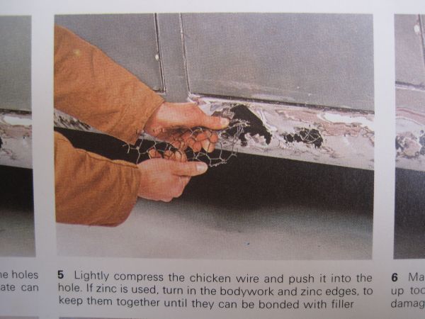

r.welfare Posted September 19, 2016 Posted September 19, 2016 ^^^ AA Book Of The Car, 1970 edition! What a tome. Eddie Honda and Landy Mann 2

danthecapriman Posted September 19, 2016 Posted September 19, 2016 Think it depends what it is and old Fords are on the up If its something that's worth it like your Capri I get that but I just enjoy my old Merc as it is a bit like your Granada Fair enough, but even on my Granada I wouldn't for example, find a small rust hole in the sill and stuff some fibreglass into it as a fix. It's just not good enough IMHO. I'd cut the rust out and seam weld new metal into the hole. Then cavity wax the inside of the repair and patch paint the outside. The repair is proper, but the paint finish outside still reflects the make do and mend approach the rest of the car has. If that makes sense! I don't think brazing is a suitable repair tbh. As it's not actually fusing the metal surfaces together. It's more like soldering in that respect as your laying two steel sections together then bonding them with the molten filler rod. I guess that if there was enough flex or impact in the area of the brazed repair it could separate?Obviously welding does melt and fuse the steel surfaces together so they effectively become one piece.I can't say I know much about brazing though, I only did a bit of it at school and quickly got into mig welding instead. Having said this, there are old cars where brazing was used from new. I'm sure the E type used it on the front end sections? Joloke 1
