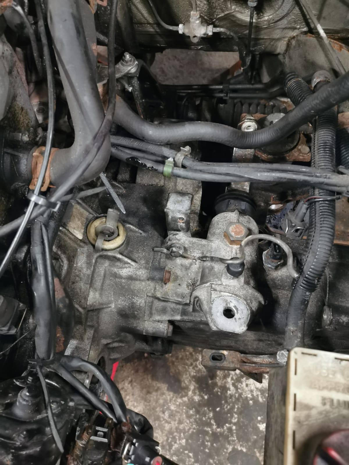

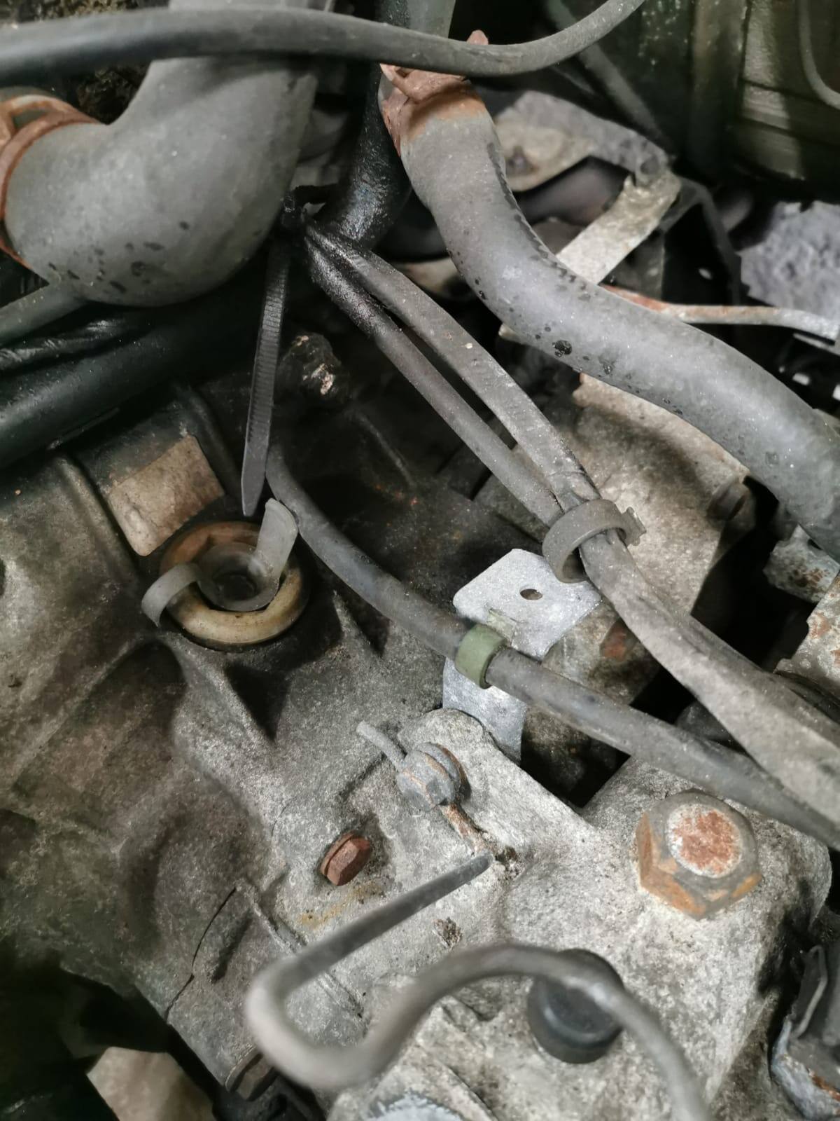

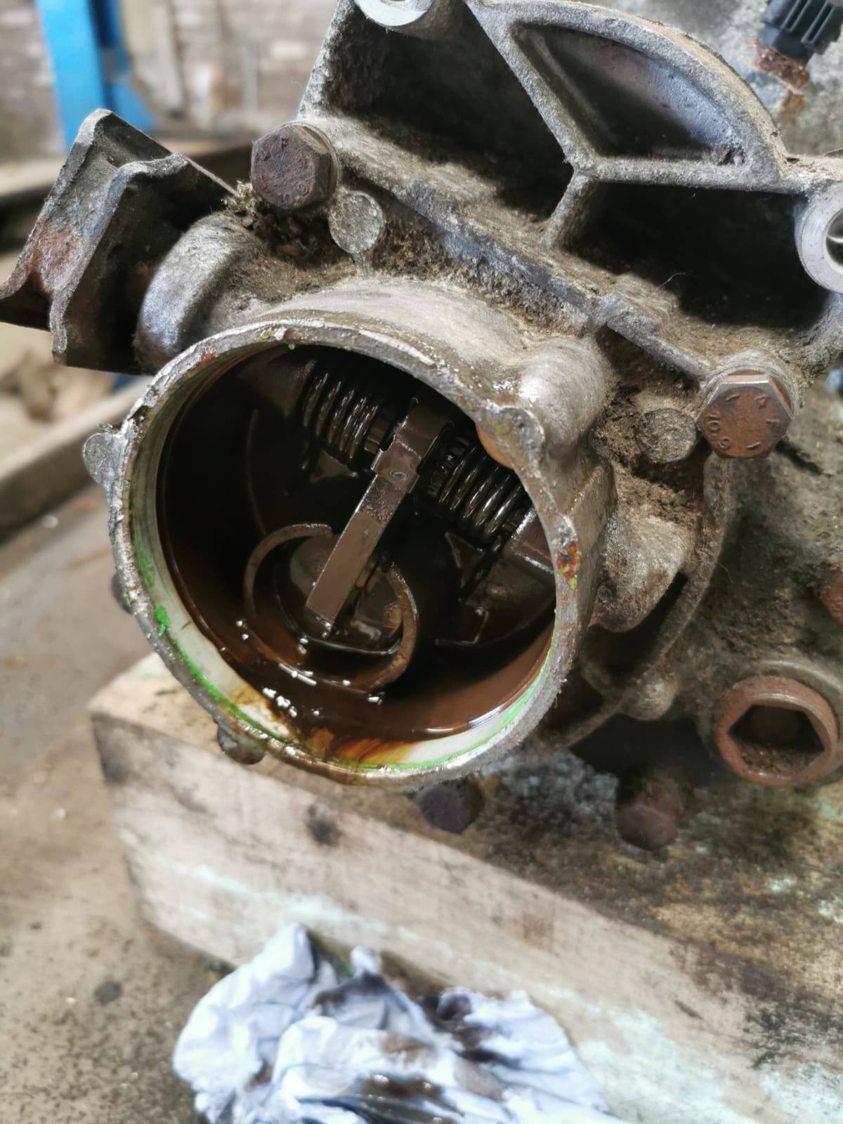

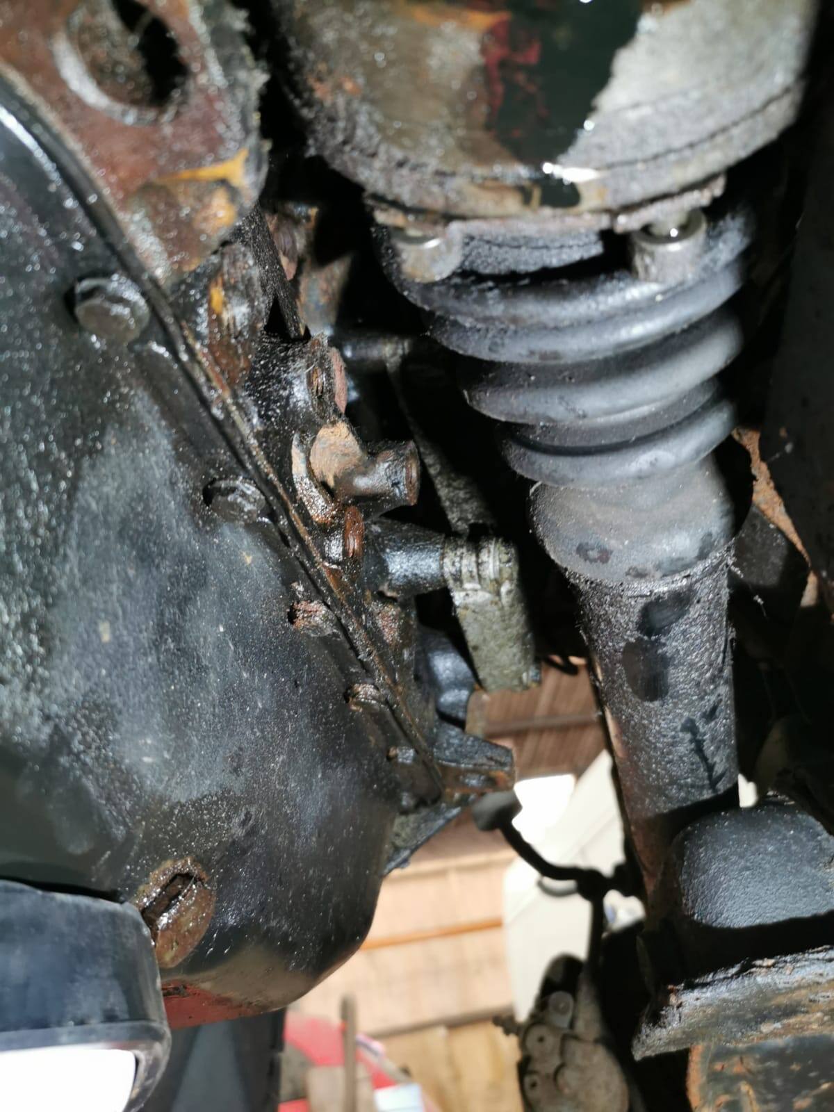

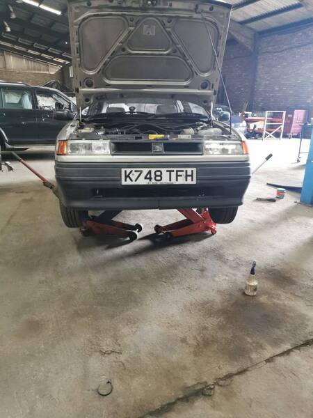

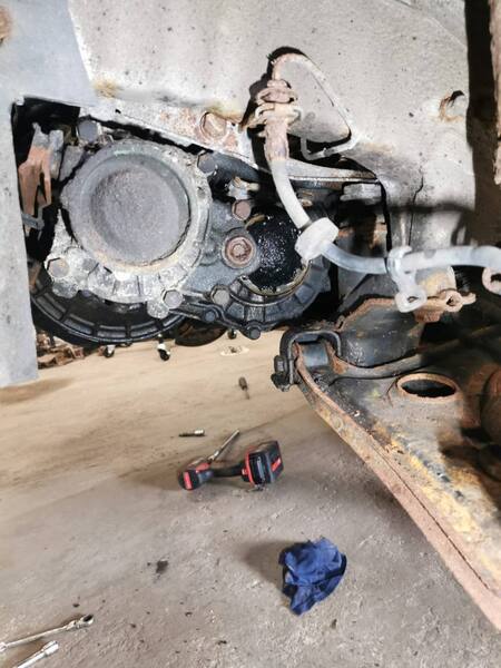

In short order, the gearbox was on the floor
Looks ok from this angle.
Not so much from this one:
It's hoachin with oil!

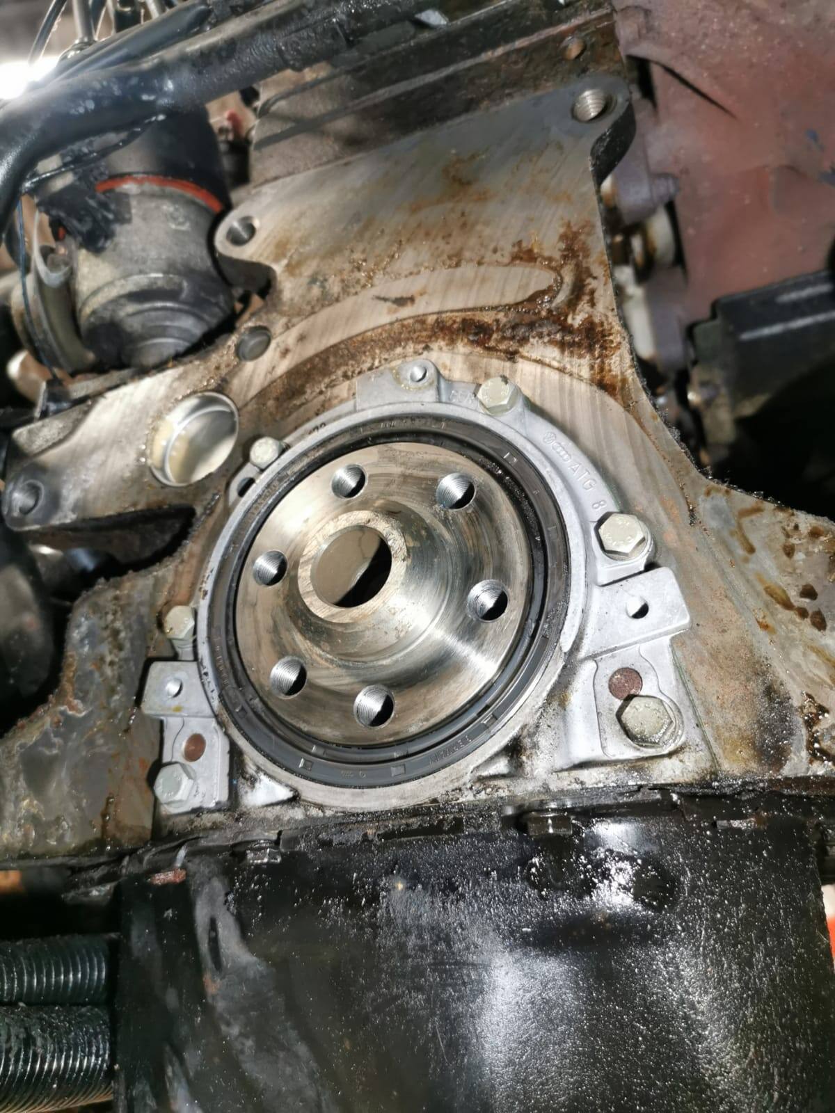

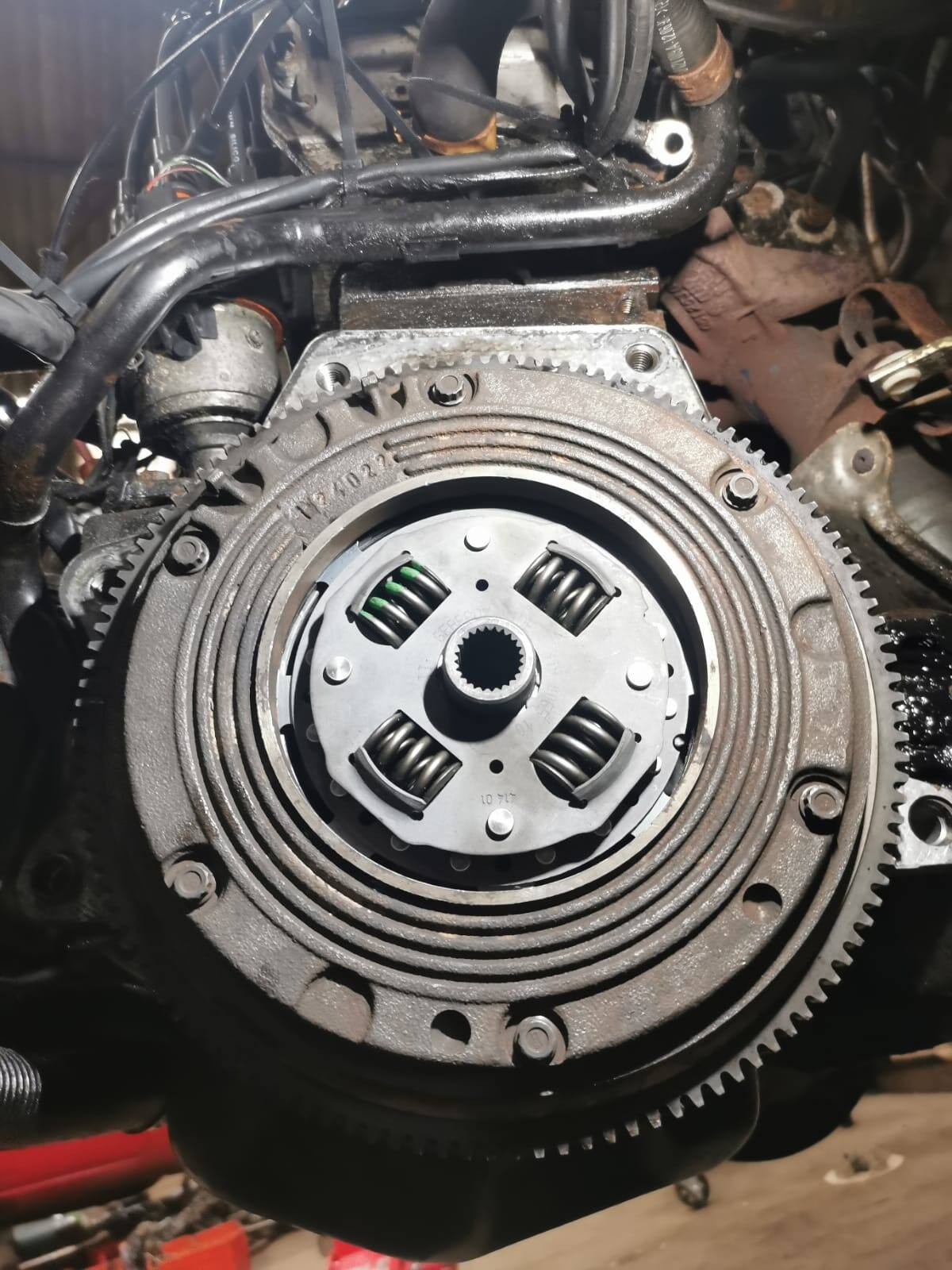

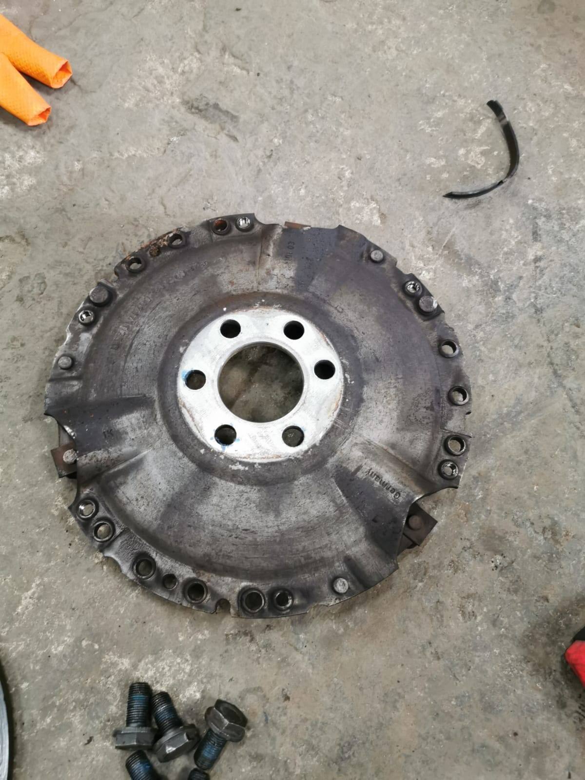

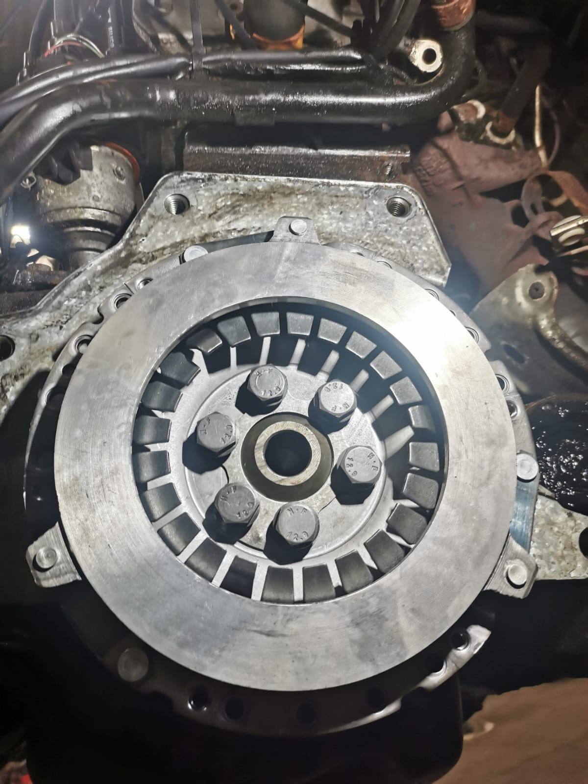

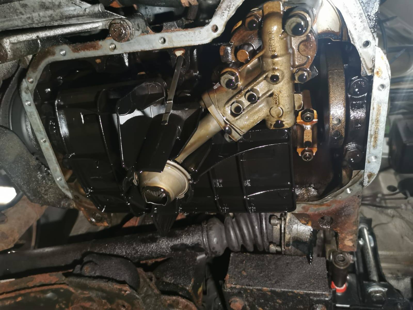

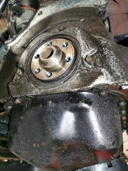

Initial thoughts were that the crank seal had failed..
A dry crank seal area, and flywheel face of the clutch pressure plate suggest it was not at fault.
IMG-20200702-WA0020.thumb.jpg.95974039a0cd4aa74d7f4d5e9e160120.jpgIMG-20200702-WA0018.thumb.jpg.0711f2df656f86d0be11e27ec963e22e.jpg

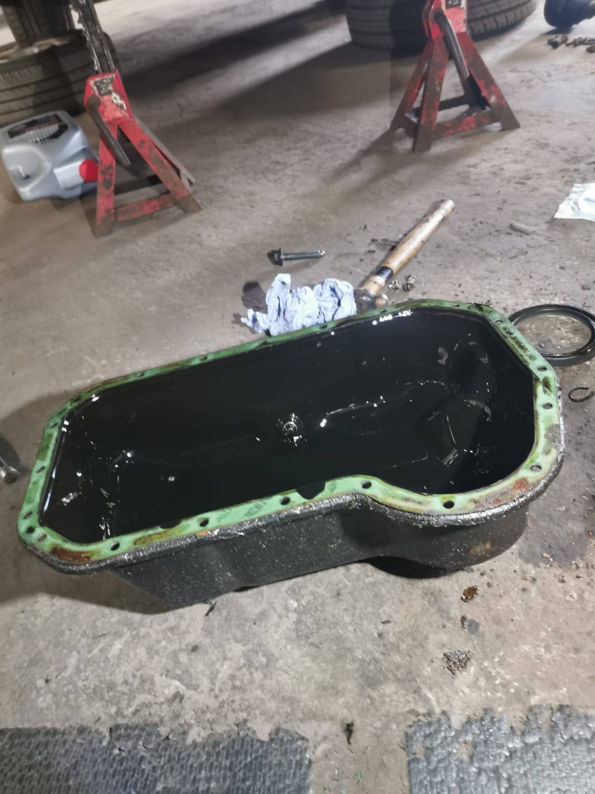

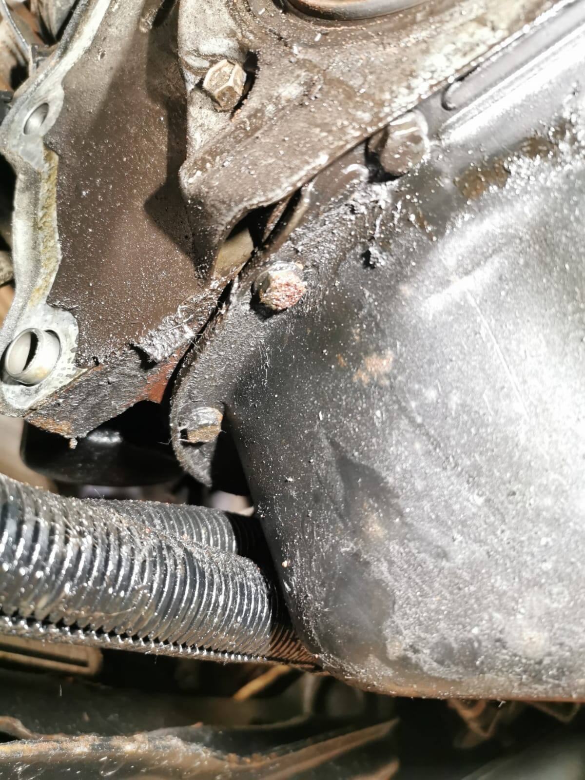

Further investigation suggests 'ats yer sump gasket DEID'
IMG-20200702-WA0021.thumb.jpg.3af04fc5a4b80576fa19dfc83081b38c.jpgIMG-20200702-WA0022.thumb.jpg.2793768fffad2d71a6f8958954576dad.jpg
a new one has been ordered at terrible expense (£9+vat) and is on its way.
nae bad graft, drap sump, gie it a guid wash oot, new gasket, fresh oil and job is braw

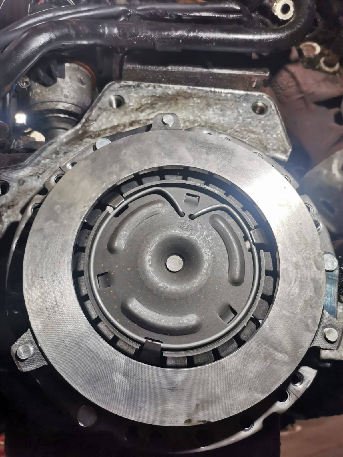

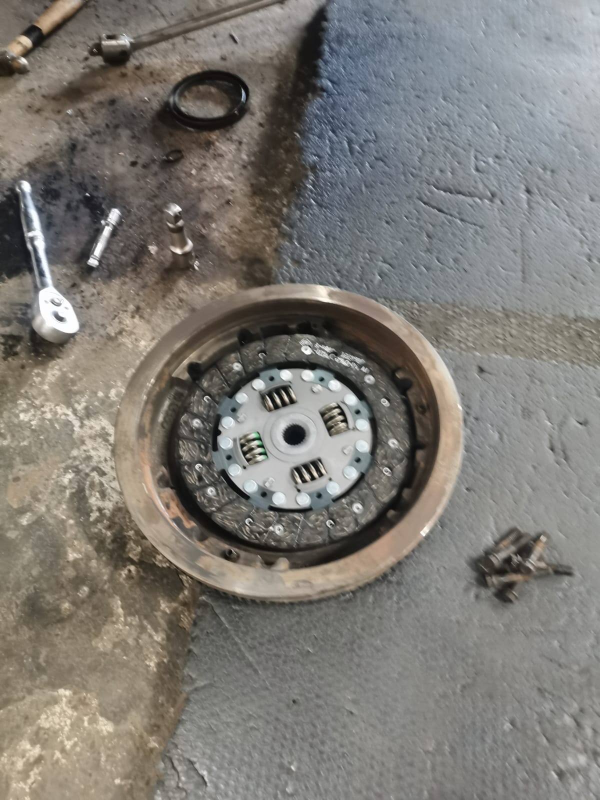

Shiny new LUK clutch - the early 190mm version. Later toledos had a 200mm one.
Next up is the release bearing - on the 020 box this is away at the opposite end from the clutch - something Maestro owners will recognise.

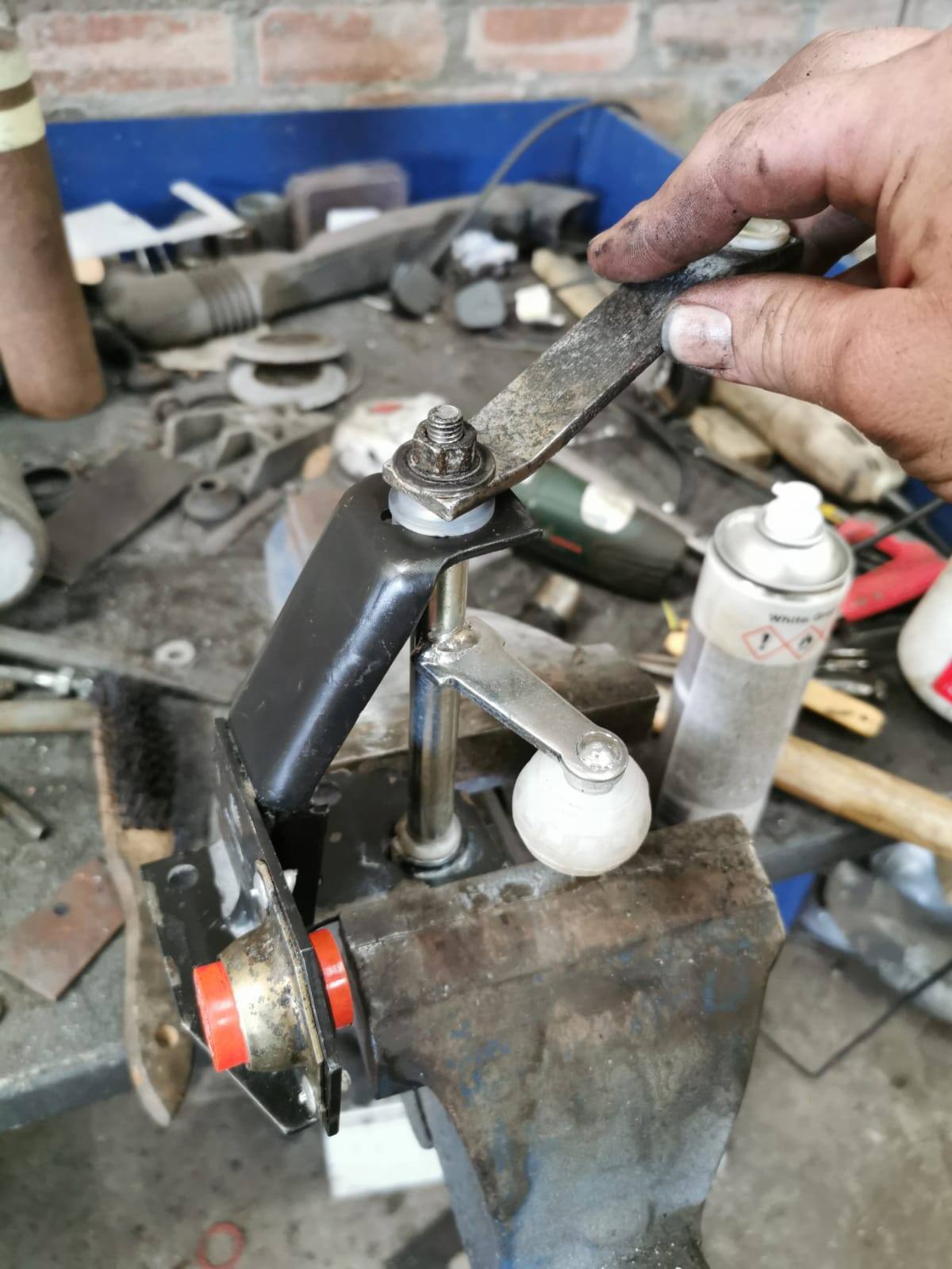

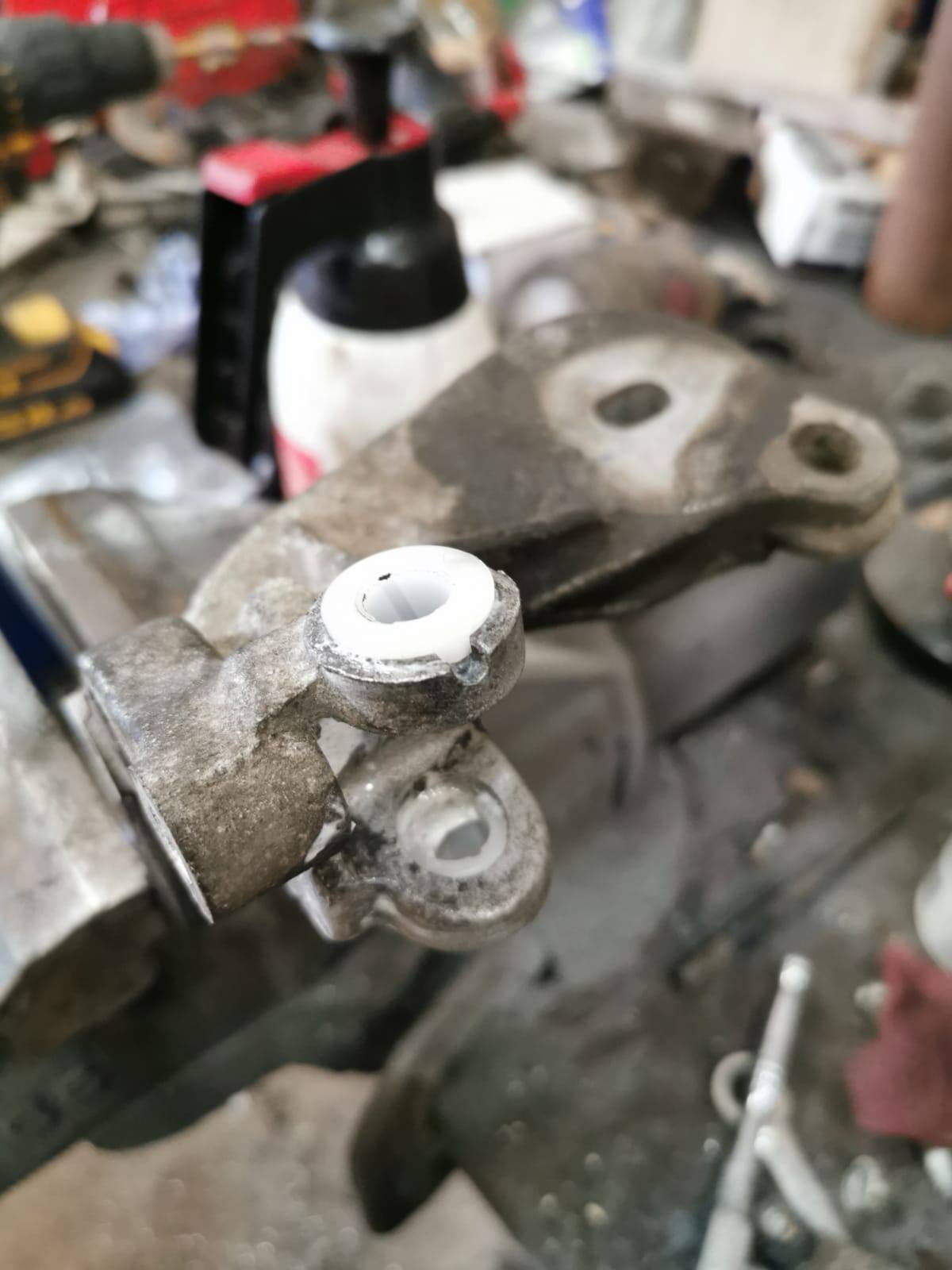

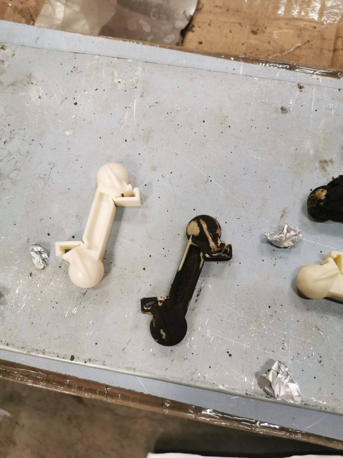

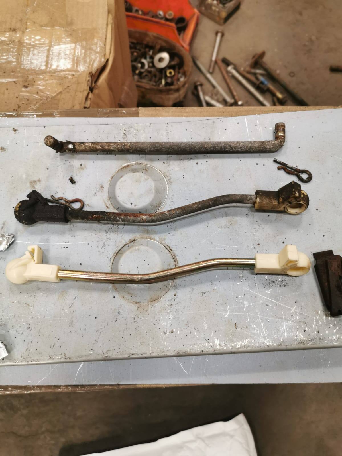

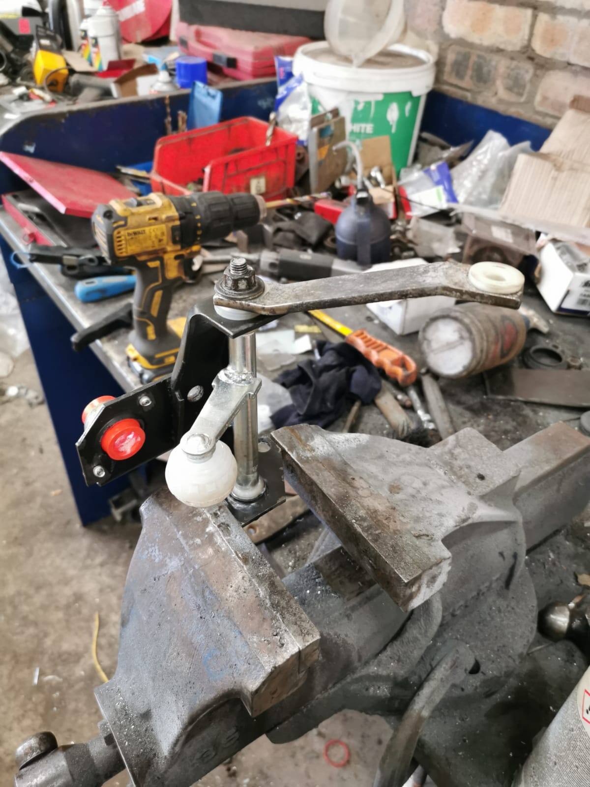

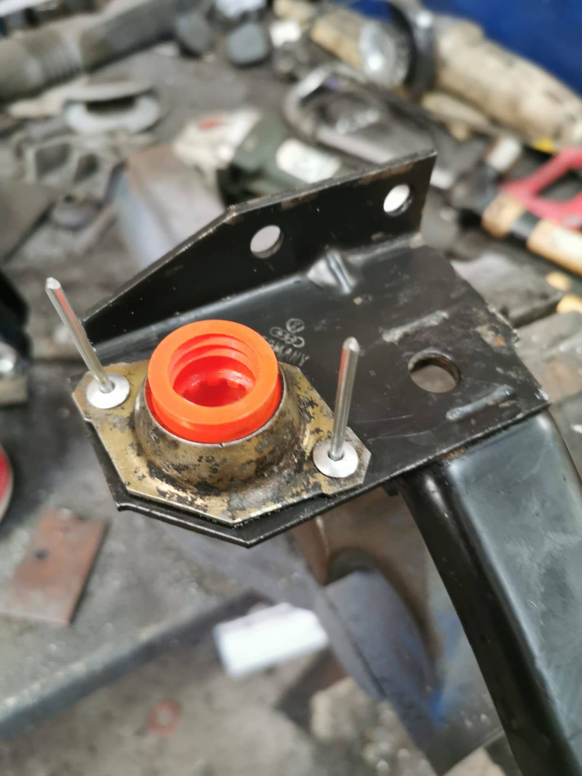

Gear linkage time!
There was some* slip in the old mechanism.. missing bushes and tired cups saw that was a given.
How much?
Find out here:
Aye "ATS YER GEAR LINKAGE FUCKT"  as they say up here.
Nevertheless, this was all forseen, and new parts had been procured.
IMG-20200702-WA0041.thumb.jpg.43a68e28b078bce231576f2f4a460444.jpgIMG-20200702-WA0042.thumb.jpg.f35c0b4375b15823d9281f429696d940.jpgIMG-20200702-WA0037.thumb.jpg.b1ceb3fd86f9396b2526180d75080374.jpgIMG-20200702-WA0044.thumb.jpg.51fcbcbd9cf778d22378597d4aab20be.jpgIMG-20200702-WA0043.thumb.jpg.627f58787138ace114fb65b32dd234f7.jpgIMG-20200702-WA0036.thumb.jpg.2e5096be23a23353d431d81b1055bc3e.jpgIMG-20200702-WA0034.thumb.jpg.98bb214cff44ba11b0c5b1a9836ab8c9.jpg

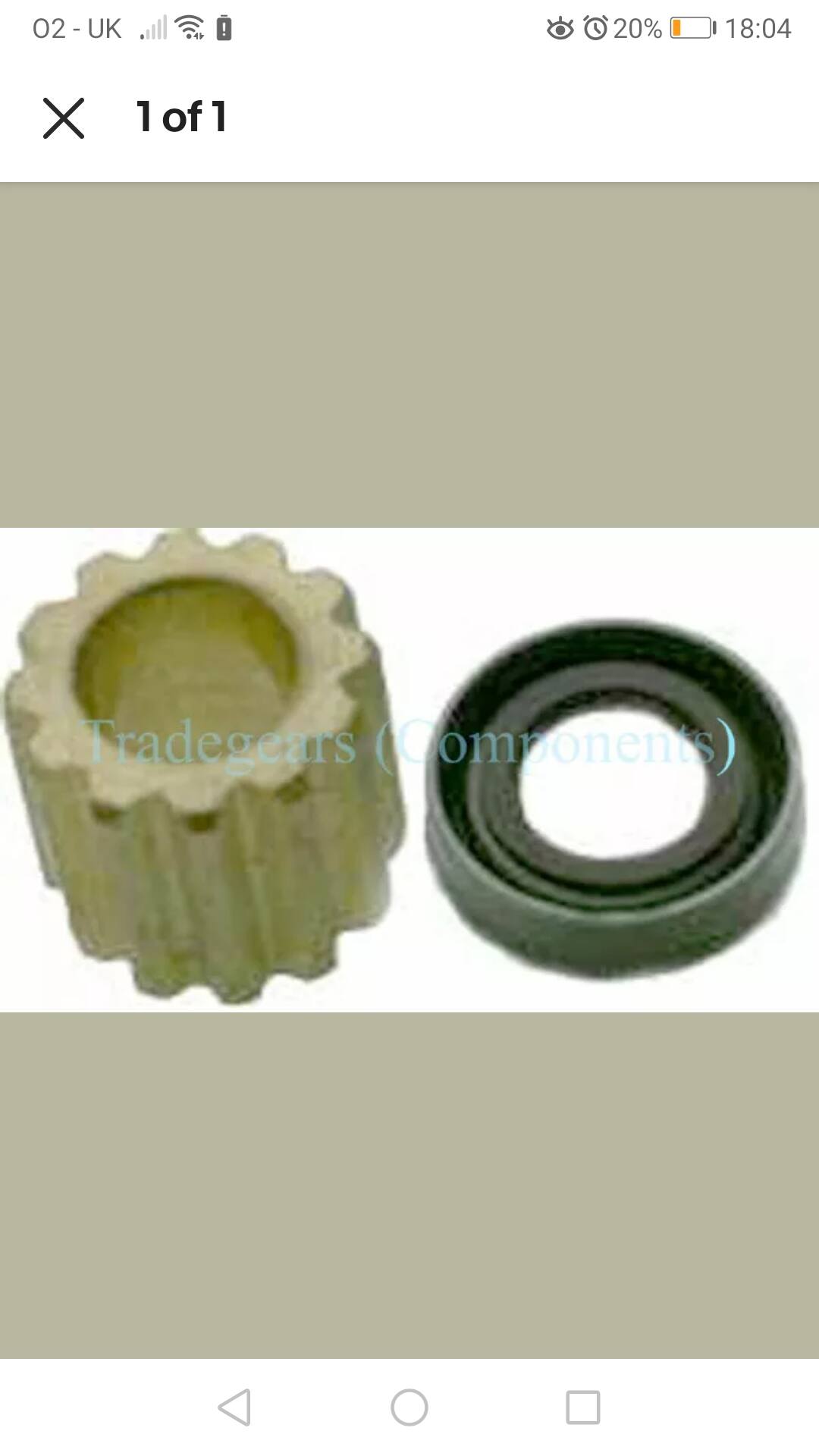

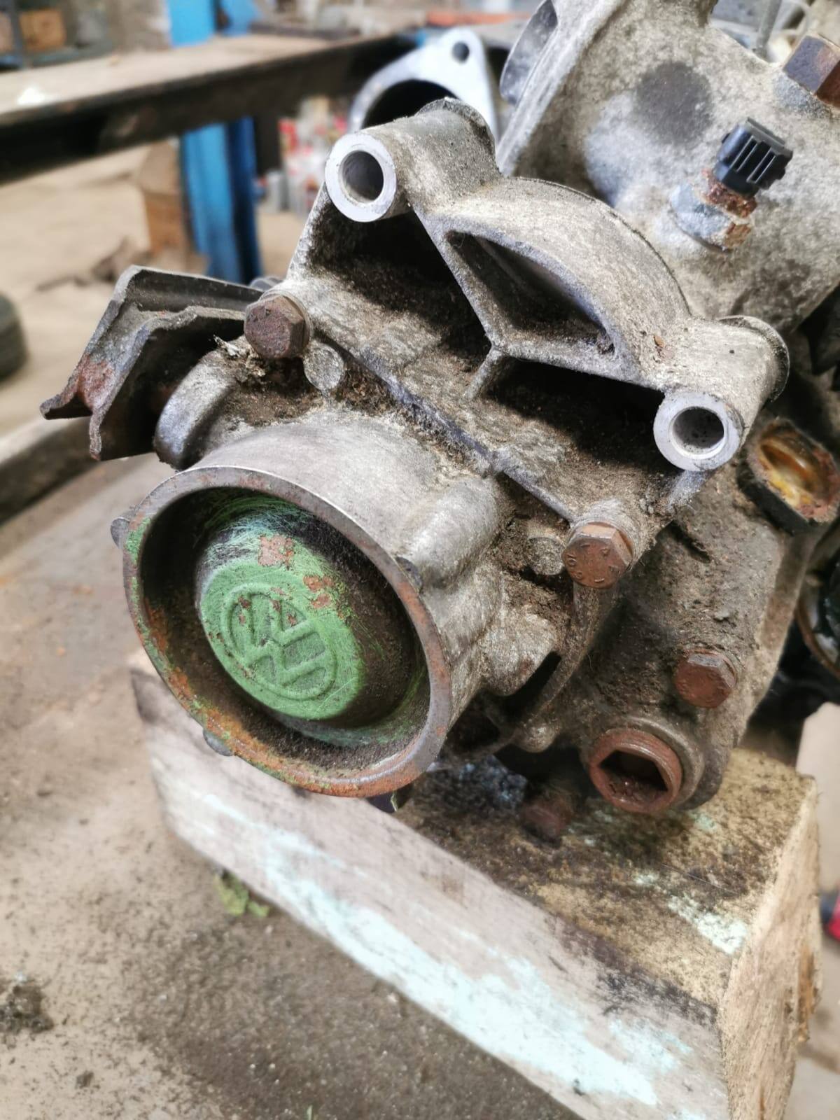

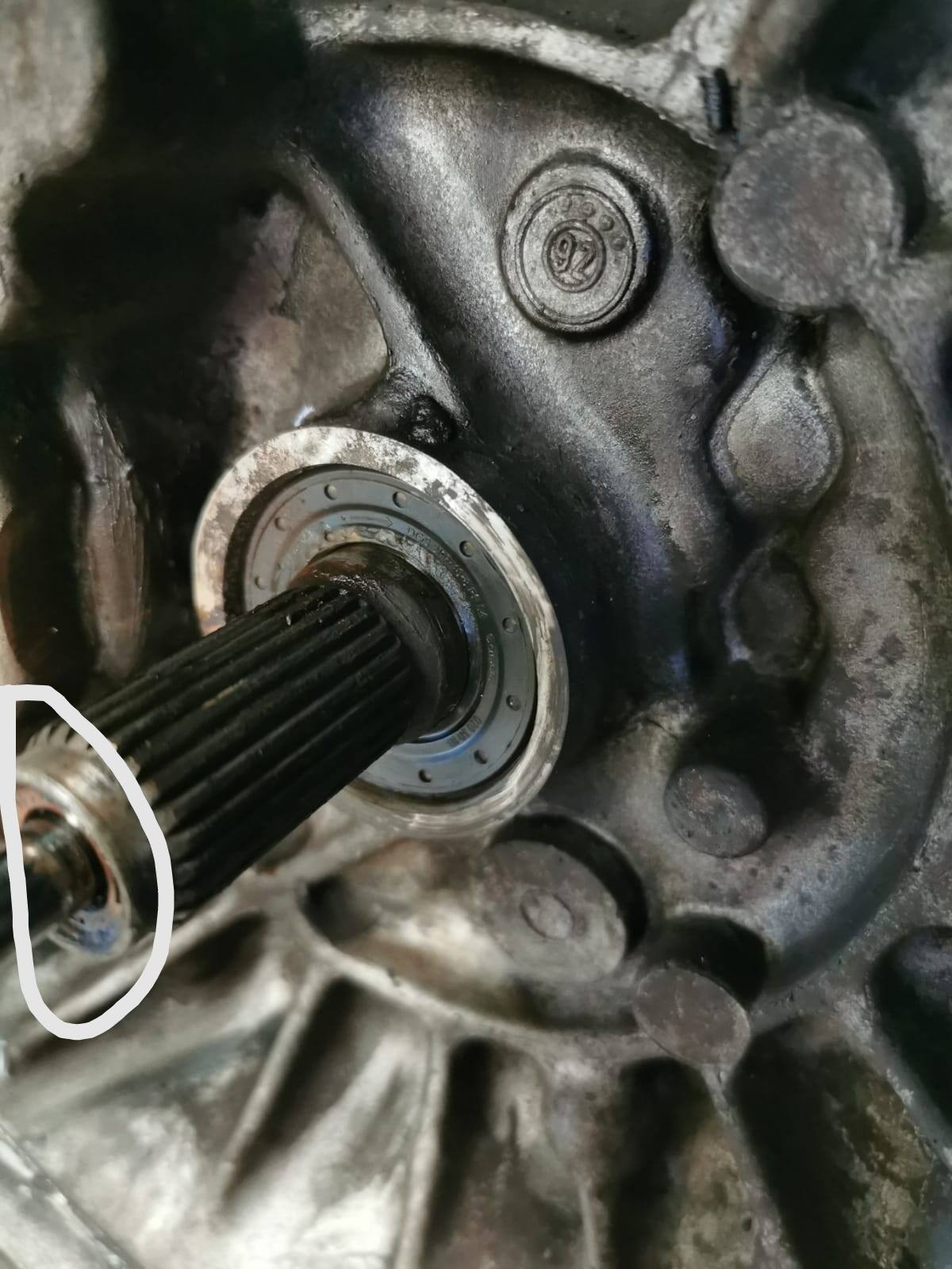

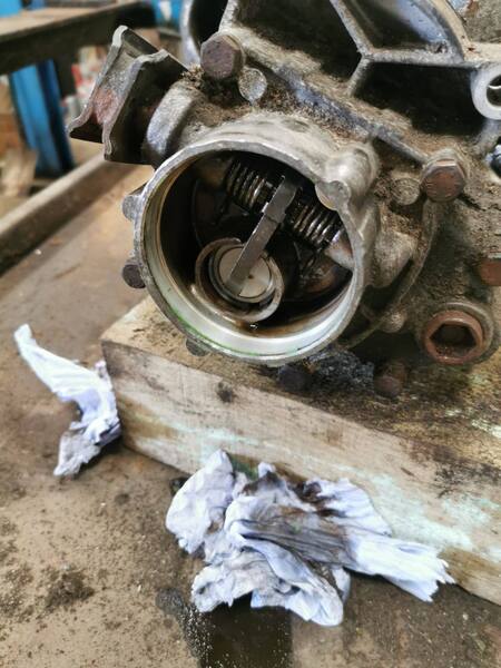

The end of the input shaft has a small bushing and seal in it. It looks like this.
Screenshot_20200702_180408_com_ebay.mobile.thumb.jpg.2fc4a26fc5d5a5bcbcaf3fa7d1a6fb60.jpg
And is located here:
Sayeth Dom: (lightly edited for flow)
There are 2 seals on the input. The main, and the one that seals on the clutch pin. There is brass bushing behind that, this wears out and allows the pin to move and seep oil too. They are easy to replace.
O20 and o2k have the same diddy seal. Input seals have 2 sizes
It's worth replacing If its leaking. Or if he has waggle on that clutch push pin. Super easy to do. Trade parts supplies should have some in stock. If you have a local branch.
I call the chap doing the work, and he has a look. It's the last clip in the video above.
Let's look in a bit more detail:
To Quote Dom:
"That looks moist and floppy"

The gasket was humped on this - it broke off in chunks when being cleaned off, and was dry and brittle.
Craig says that when the last two bolts were removed it just fell off - no resistance at all!
The engine's nether regions look pretty decent tbh.

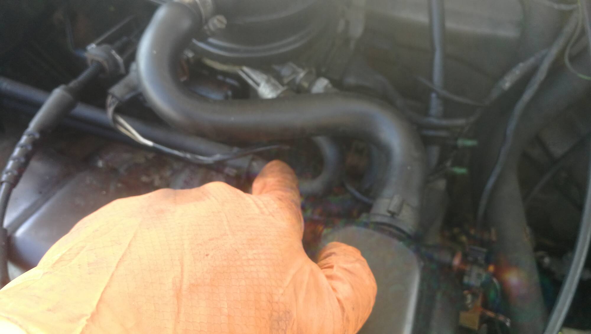

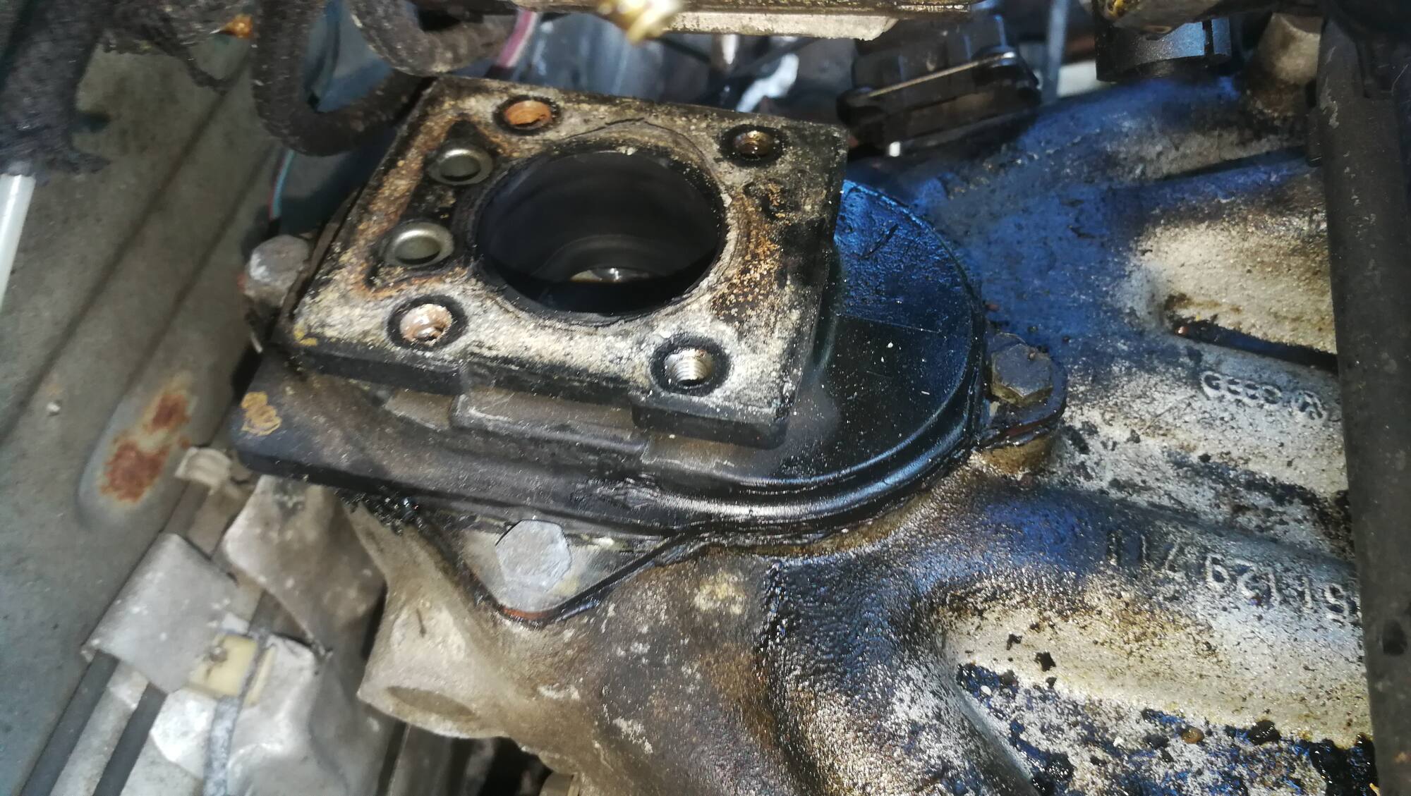

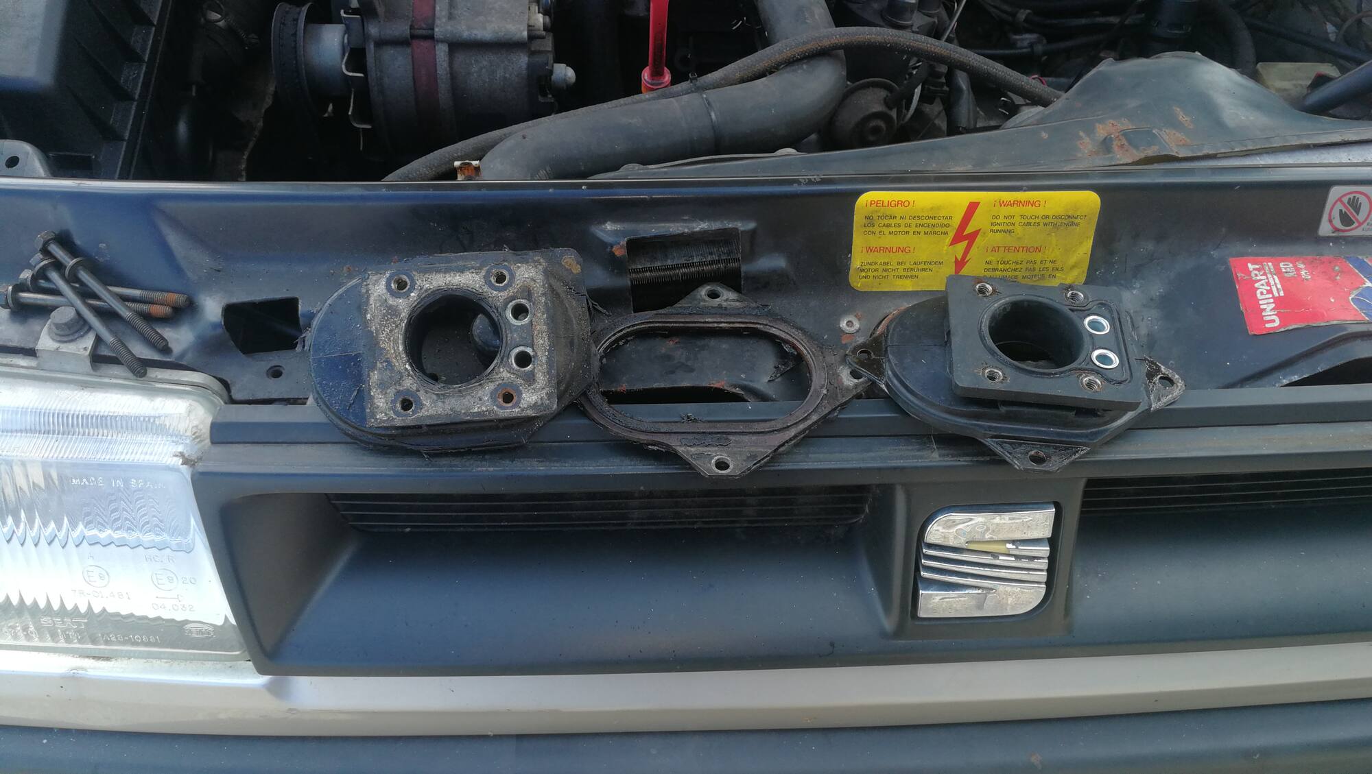

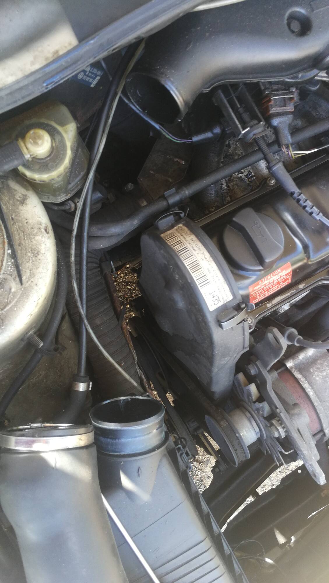

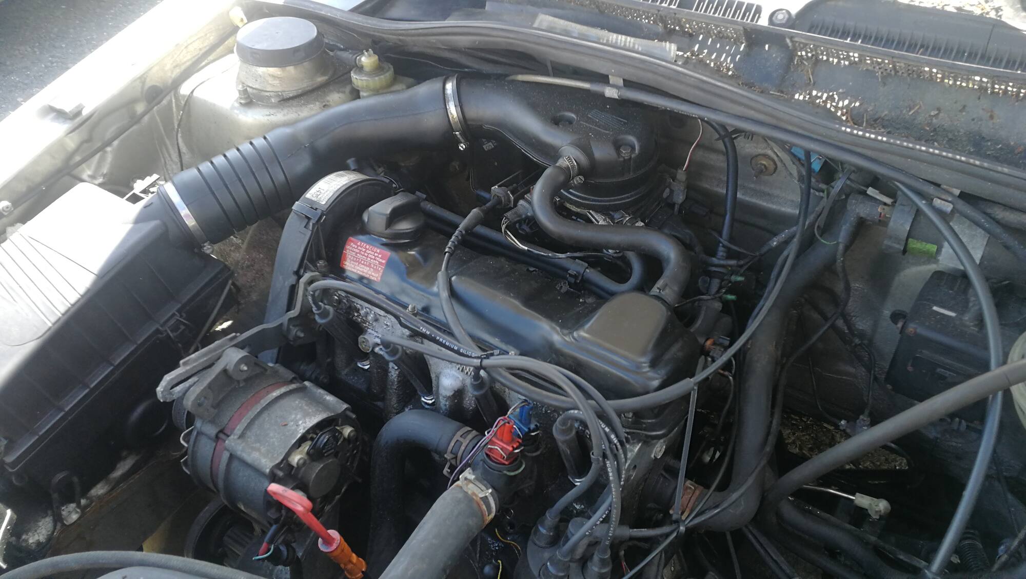

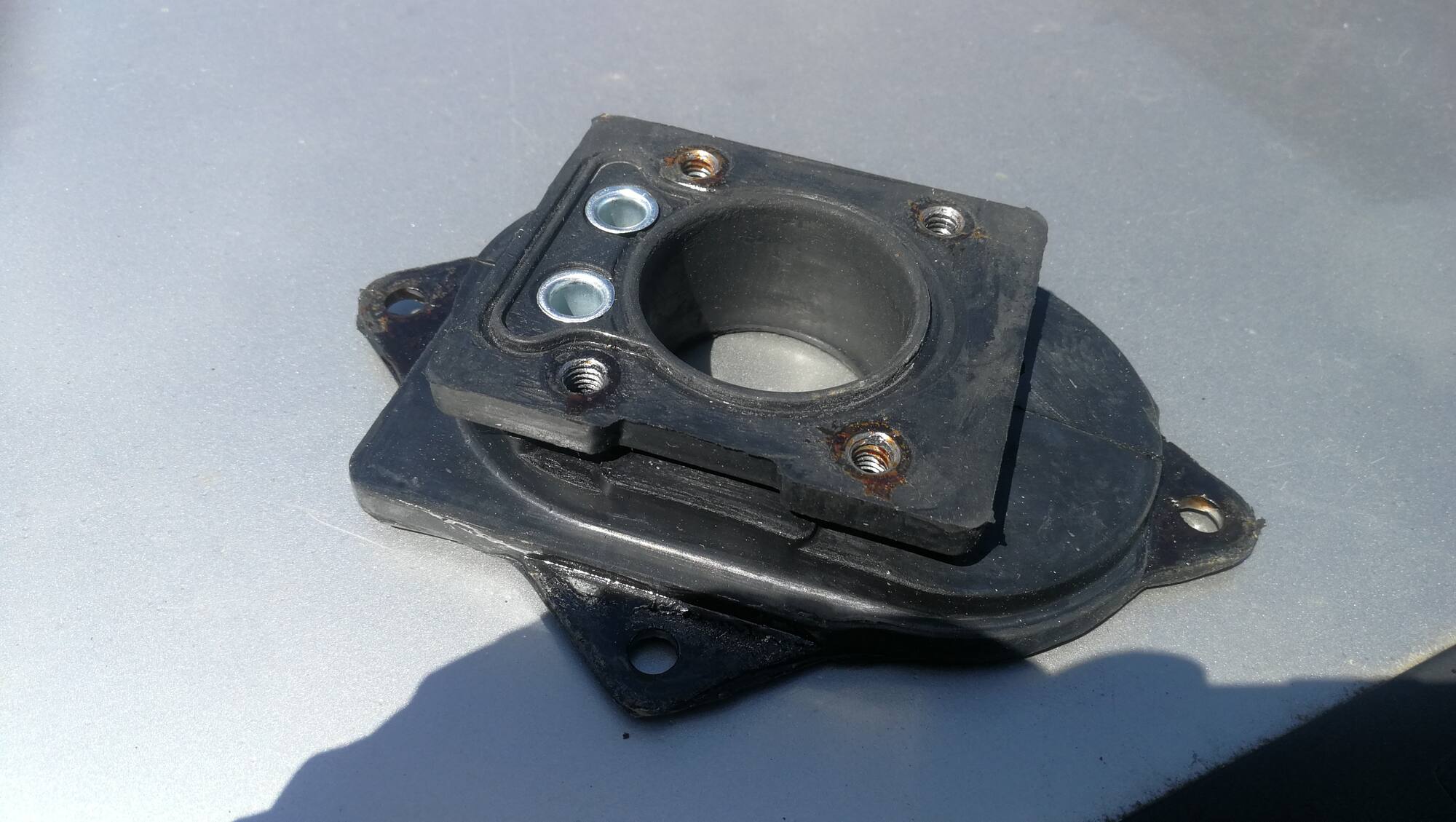

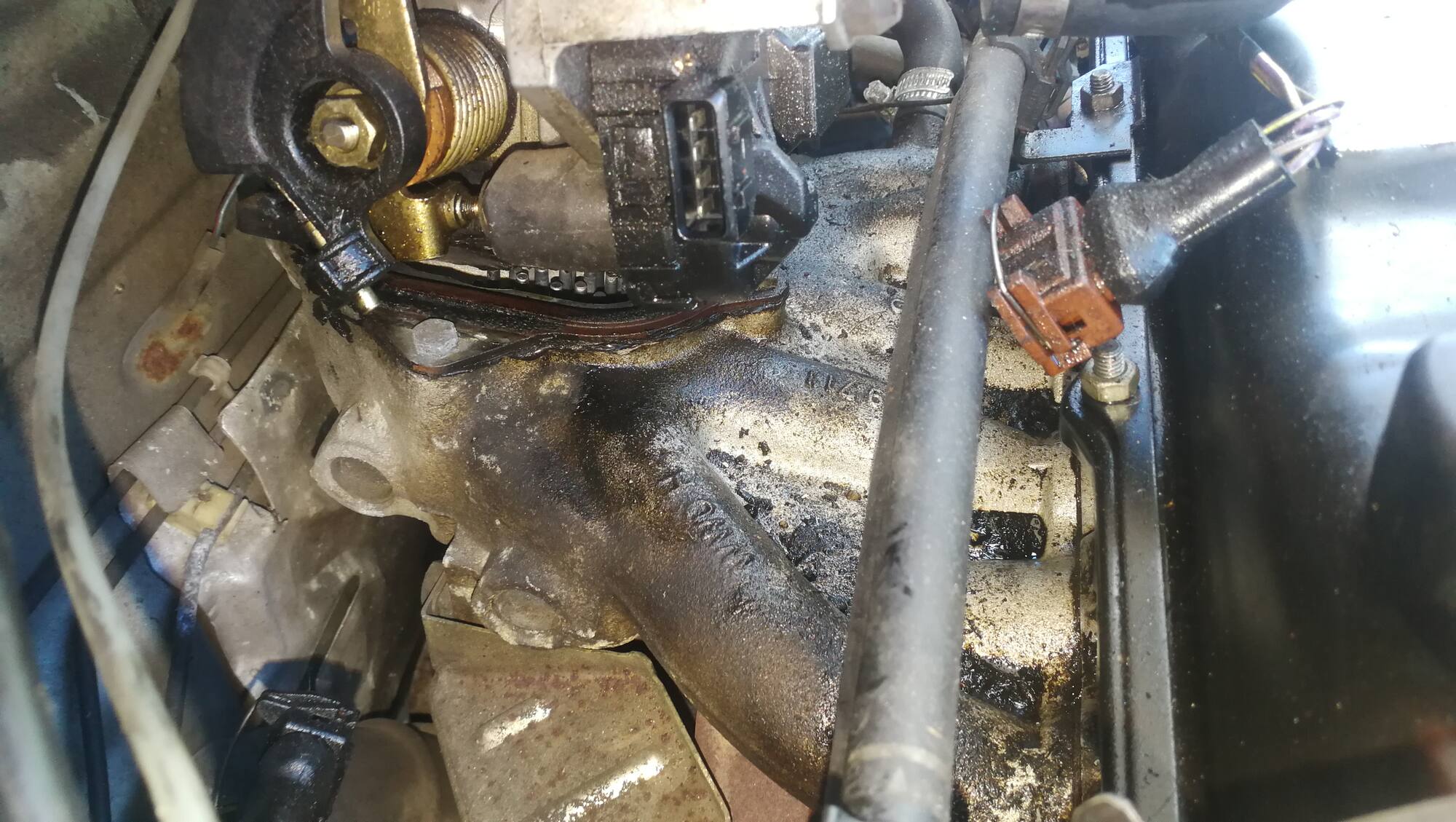

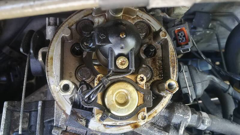

When Craig had the car to do the clutch, he mentioned that the hesitancy of the engine was likely due to the gasket between the injection unit and the inlet manifold.
This is it. The diamond formation bolts to the inlet manifold, and the square section is where the injection unit bolts in.
Installation isn't particularly complicated. Just footery.
First, locate your quarry:
Enhance
Errits err annat.IMG_20200718_122426.thumb.jpg.1ec94e195f7a544626552c36efc913eb.jpg

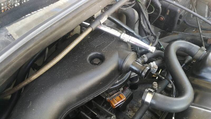

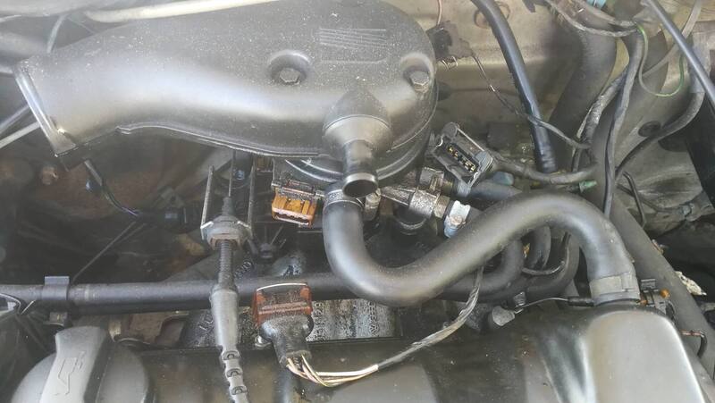

Remove the air inlet pipe so the 'hat' of the injection can be removed.
Then the rocker breather can be removed and the electronic connections can be removed.
Deploy the titchy 1/4" drive Rodentia Excreta on the top 3 bolts.
And remove the 2 vac lines on the back of the hat.IMG_20200718_122928.thumb.jpg.bcaeb06c593dfa1a8e799358c9da29b7.jpg
With the hat off, you can see the 4 10mm bolts holding the injector unit on.
These go right through the unit and into the gasket.
Before undoing them, I tilted the unit to see how much of a gap there was..as you can see, it's a fair bit.
The 4 long 10mm bolts were removed, and the injection unit lifted up
Not looking too bad.
Right up until I touched it.
Aye, that'll be fuckt then.
Fitting the new one was a doddle, and the jitters have gone. It's improved the drivability a fair bit.

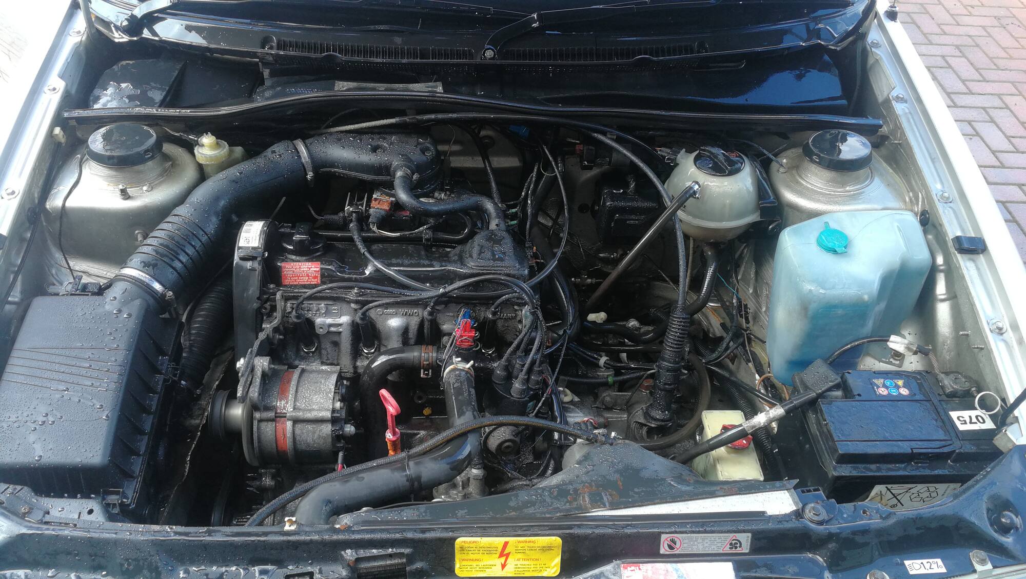

The exhaust was adjusted,
IMG_20200718_143645.thumb.jpg.5e369c0232622717a23d2ffb98e35252.jpgIMG_20200718_143703.thumb.jpg.a364fc7578f70b33eace32e9c9b4e54a.jpg
and the car was washed and waxed, including the Engine bay..

The available de-gungifier was wash and wax car shampoo:)
Fancy! I always try to wash an engine bay though. Looks smart etc but also stops you getting filthy just having a little nose/squeeze of a hose/topping up fluids blah blah.
Much prefer washing diesel engine bays as no electroniks for the h2o to interface with..
