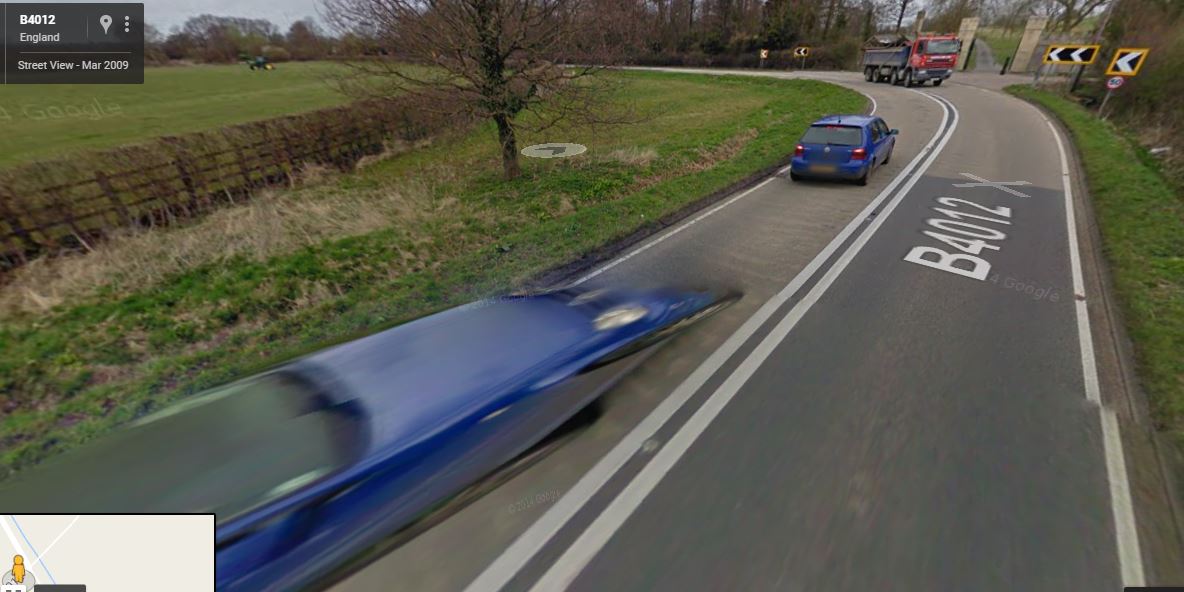

So, driving home from work, traffic was quite light etc, 10 minute takeover was playing a decent tune, all was well. Until I came to this corner, changed down from 5th to 4th, and the engine cut out...
No fuss or drama, it just turned off, and the stop light turned on. My buttocks firmly massaged the seat foam, and I assessed my surroundings, aiming to just go straight ahead and hope the dead accumulator sphere had enough pressure to stop me before hitting the wall you can see in the distance, and that no cars came around the corner the other way.
Whilst doing all this though, I popped the clutch down and turned the key and it turned straight back on again. Radio went off, and I drove the rest of the way home feeling a bit tense and confused...
This is the second time it's done it, the first time I assumed I stalled it as I was slowly approaching a junction, but I was doing 45 this time. My only possible theory is that it idles at just below 800 revs now since Arthur de-tuned it, could the sudden de-acceleration have dipped the revs briefly down enough to stall the engine? I have been meaning to wind the fuel back in 2-3 turns and swap the LDA pin around, was going to message Arthur actually to ask for his advice on this.
I popped the bonnet when I got home to have a look, and all was in order. No streams of bubbles in the fuel line, no fuel pissing out of leak off pipes, all was in order, it was it's usual, clattery self. I have been meaning to replace the fuel filter as it's possibly quite old and has probably seen alot of veg in it's life, but I get none of the symptoms whilst driving I had when the ZX had a clogged fuel filter...
Very odd. It's low on fuel, the stall and restart popped the fuel light on, but only just, so I can't imagine it's that.
Most odd, I shall see if it happens again.
